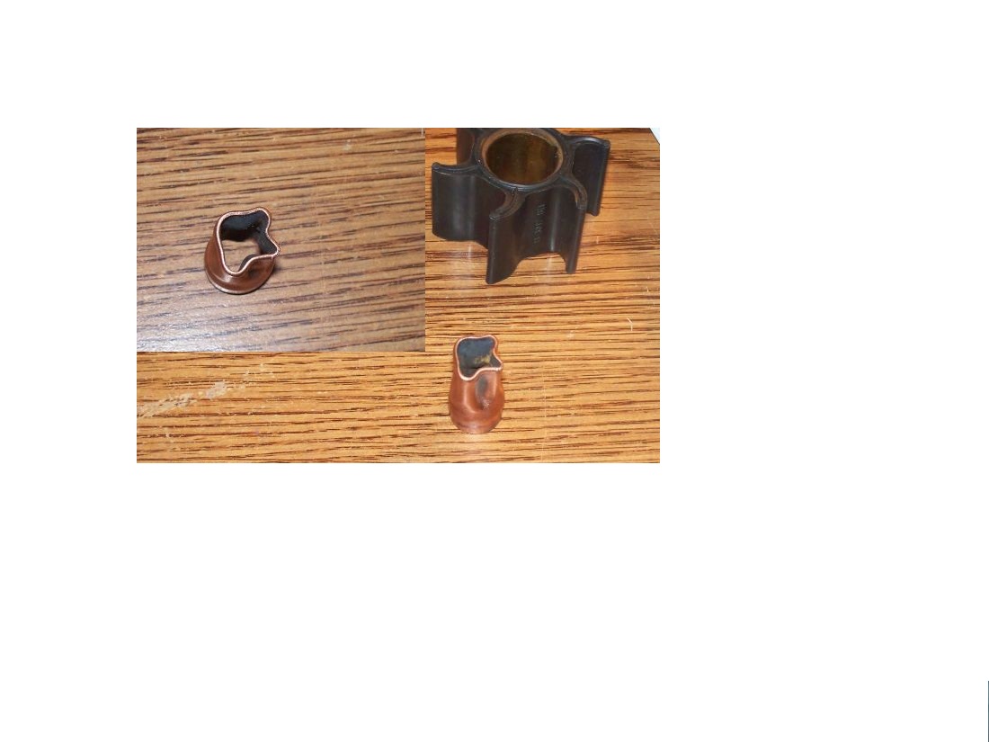

I'm sure that many of you never experience the evils of salt water's powerful electrolysis on seriously under protected outboard motors like classic Mercs, but it is real.
I have attached a picture of the top end of a water tube I removed from an inline-6 Merc of the '60s. This is something to be very aware of if you have a problem getting a healthy tell-tail (or pee stream) out of a classic Merc that has been in salt water.
I am betting that you guys have lots of other pictures of various salt related failures that can be added to this post that will encourage salt water boaters to be very aggressive in their battle to combat salt destruction.
I would also encourage anyone to post chemical solutions or procedures they have used to combat salt water - Like 'Salt Away', 'Corrosion Guard', etc, etc.
As time allows, I will add subsequent pictures of what salt does to kill our beloved classic Mercs.

Seen more of my share of those! The salt builds up around the rubber grommet and squeezes until it's crushed, sometimes completely shut.
Merc small twins have that problem (along with the plastic water tube washer under the powerhead that distorts and blocks water flow), and it's also very common on 9.9 and 15hp Johnrudes.
Whenever I get a motor in for water pumping issues, I always puff some compressed air up the water tube to make sure there are no obstructions to water flow.
The best barrier I've found against the Evils of Salt Water is Permatex No. 3 brush-on-type gasket dressing. Coat the grommet, coat the water tube, and a little on the recess the grommet's going in. Thus keeping the nasty crud out of there.
Any kind of salt barrier, even waterproof marine grease, would be better than nothing.
But the mfr's won't spend a few pennies per engine doing that to vulnerable parts & hardware. Guess they wouldn't want them lasting too long, eh? And it would cut into their profits, can't have that!
Cheers.....ed

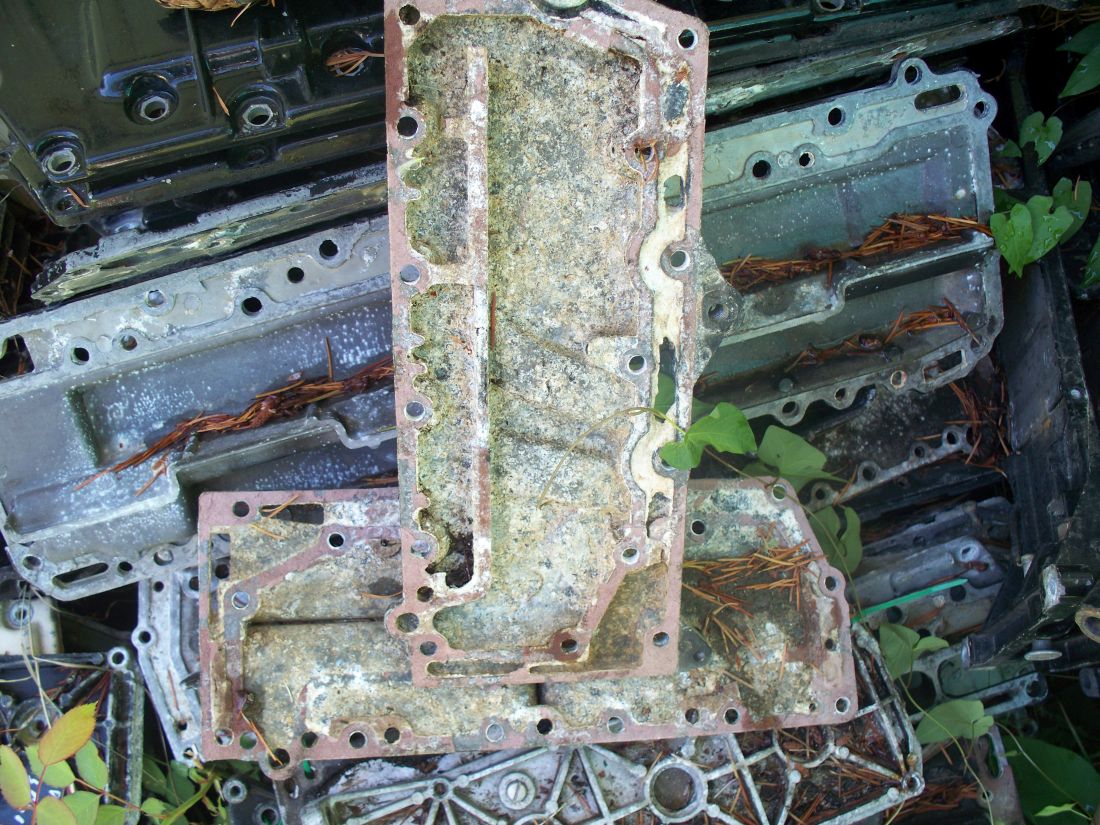

Here is another very too common example of salt water's power. Note not only that it has pushed clear through the baffle plate's cover, it has blocked off the cooling water's ability to flow any further towards the bottom of the baffle plate.
doc

OMC used Glyptol or something like it in the water passages but I doubt it'd hold up on the exhaust side of the baffle. Might work pretty good where water touches the parts. I'd imagine you'd have to get a used part very clean in order for the stuff to stick.
www.eastwood.com/glyptal-red-brush-on-1-qt.html
