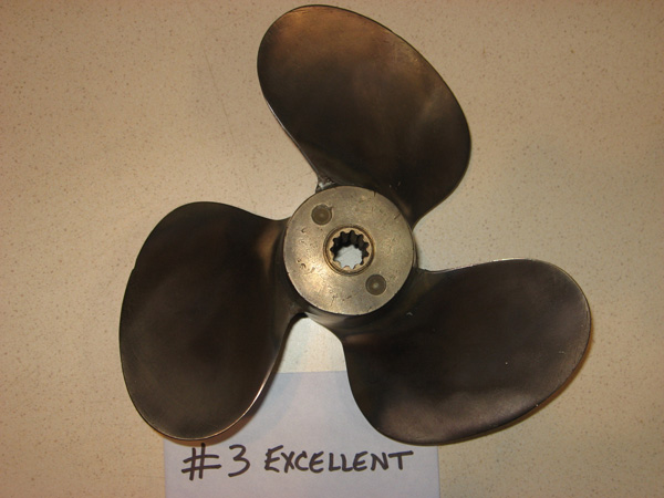

The only thing I haven't changed back to before this started is the prop. I replaced the prop after our first trip. (it planed then) The prop hit a rock and so I tracked down (with the help of this board, thanks again) a prop matching the same quicksilver part #.
48-22105A2-10 Is it possible two props with the same # have different pitches/angles?
Re:Same stuff, different day. Still won't plane. A 16 years 3 months ago #11338
one may have had some cup added , however I dont think its your problem

If your points are slightly out of synch, you will still plane, but it will affect your WOT performance. It sounds like a spun hub in the prop to me.
Re:Same stuff, different day. Still won't plane. A 16 years 3 months ago #11348
thats a real possibility , didnt you just put on an unknown used prop...you would have lots of throttle and no go feeling with a spun hub,or it can feel like you get to a certain speed and it feels like you loose traction like spinning the tires on your car, you generally will hear the rpms jump when this happens
or is it just plain lagging with insufficient rpms to get up on plane

Oh by the way,is the hub your talking about the center of the prop with the splines?

Not a spun hub then...
A spun hub would rev high...just wouldnt push you much, if any.
