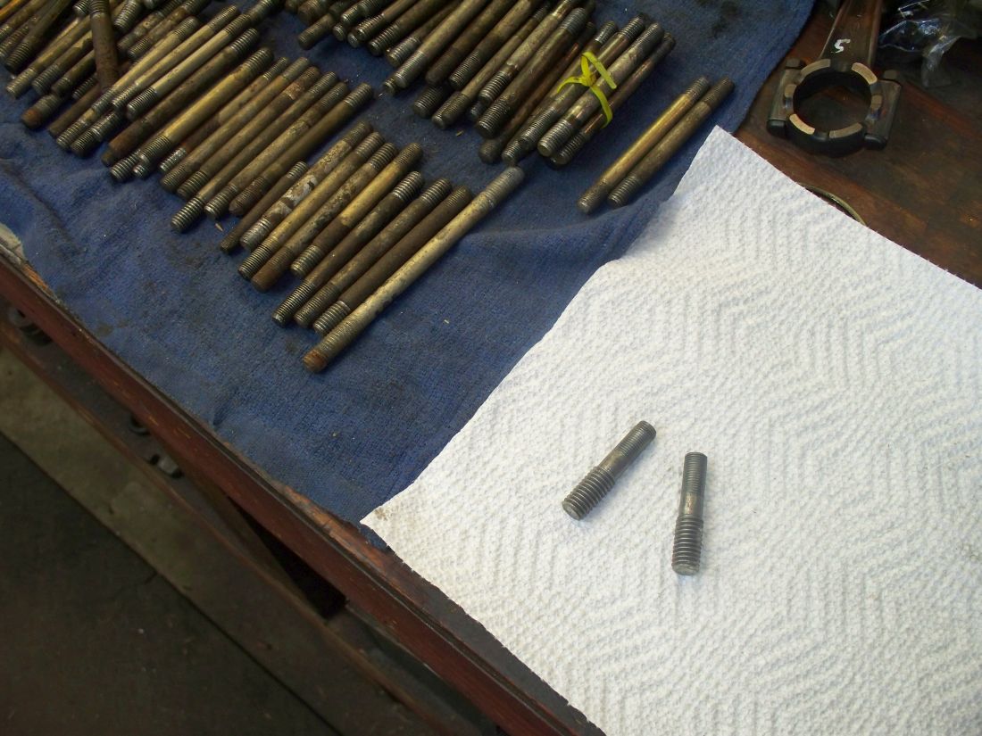

Although the studs in my picture are not for sale (project of my own) they give you an idea of what is needed for the transplant.
doc
