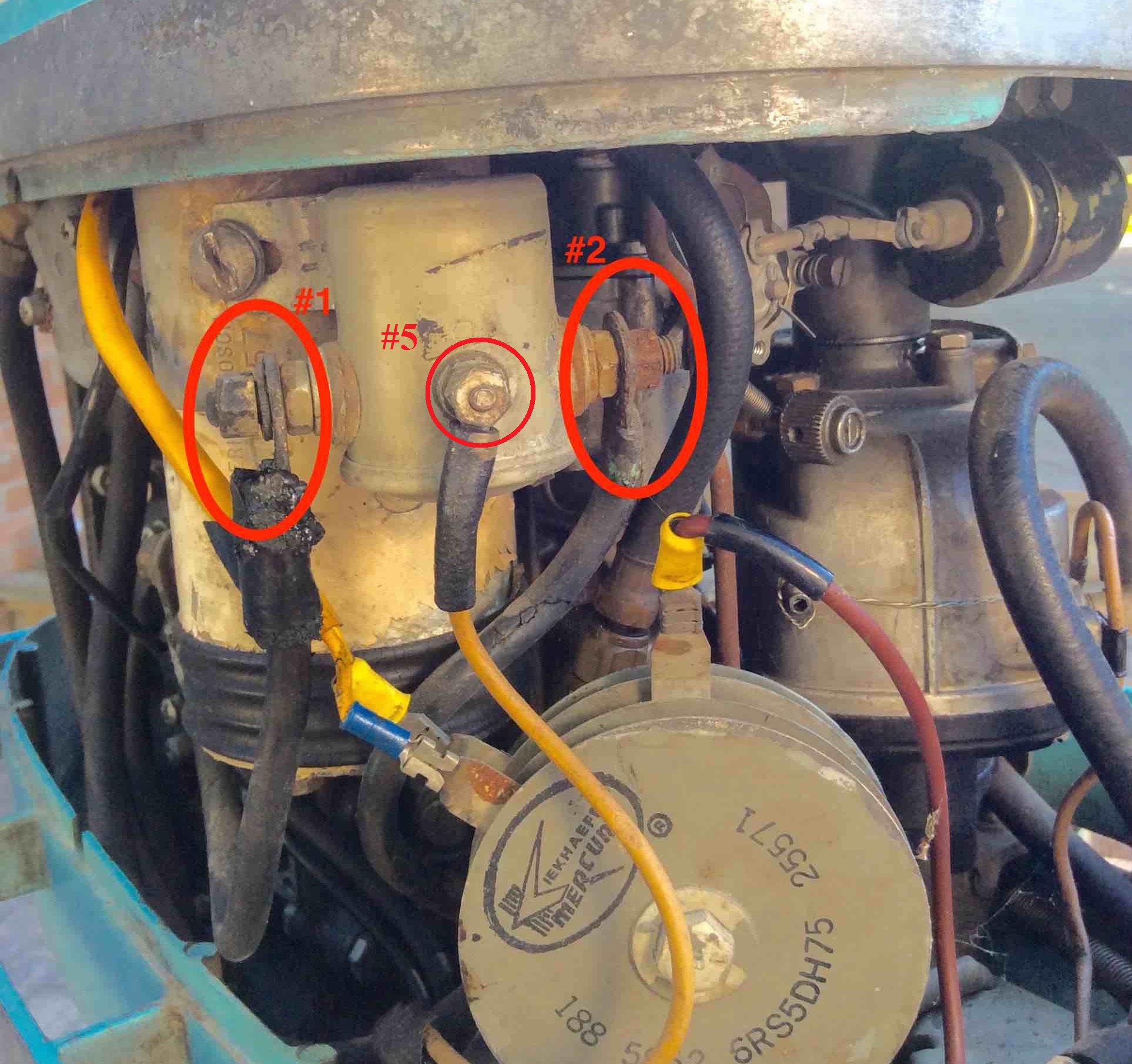

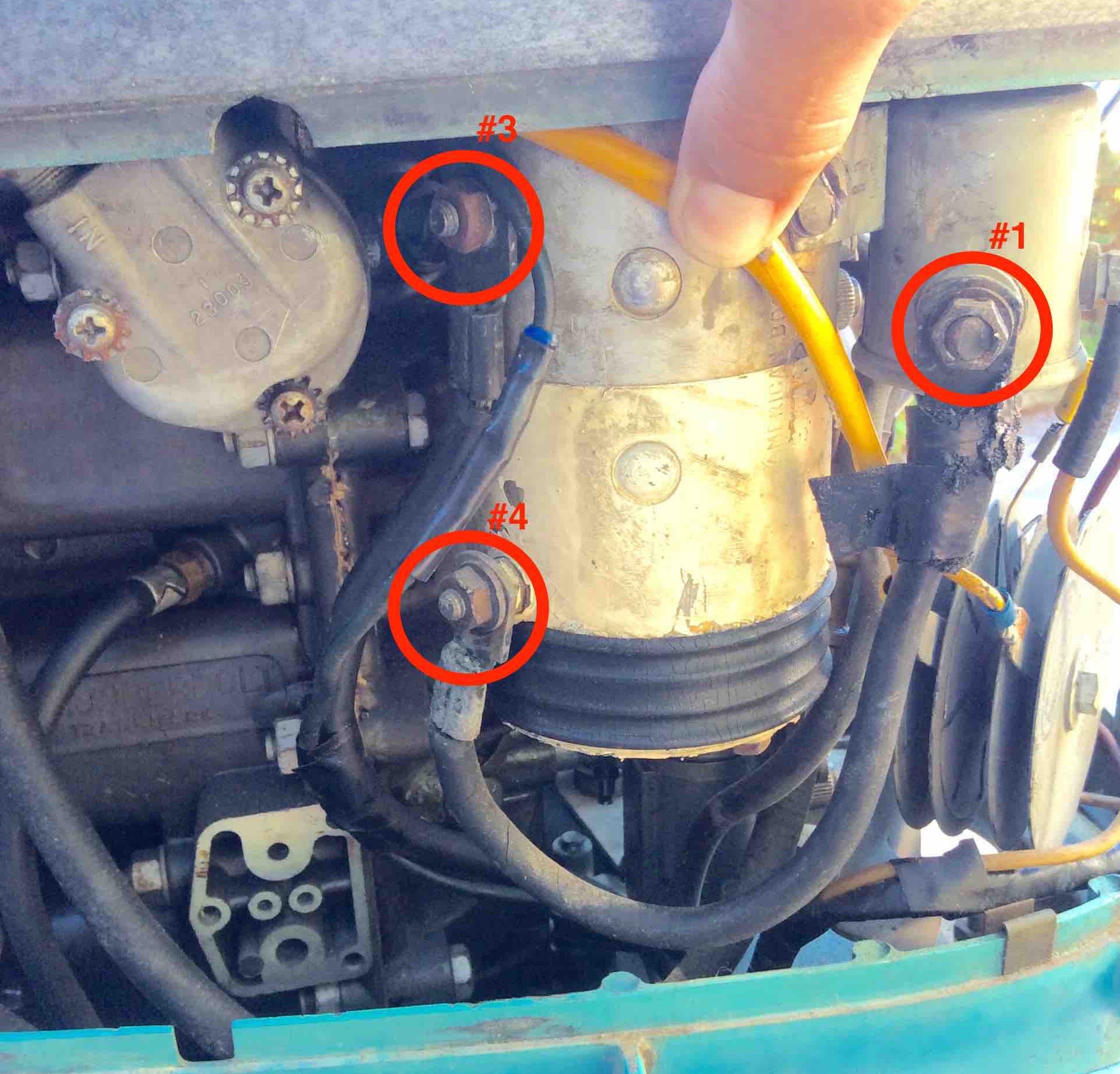

OK, just to be sure..
#1 goes to #4
#2 goes to the harness
#3 goes to the harness
So start it:
>>>> attach NEG to the engine block
>>>> attach POS to # 2
Just to be safe, I'll make the attachments on the engine with lugs/nuts and, away from the engine, tap the battery terminals in order to engage the starter.
Re: 1956 Mercury Mark 55 E - how to "jump" start it. 11 years 3 months ago #112829
If you attach Battery (+) to #2, you will also have to connect a small jumper wire between #2 & #5.
That will be using the solenoid.
To bypass the solenoid, attach Battery (+) to #4.
doc

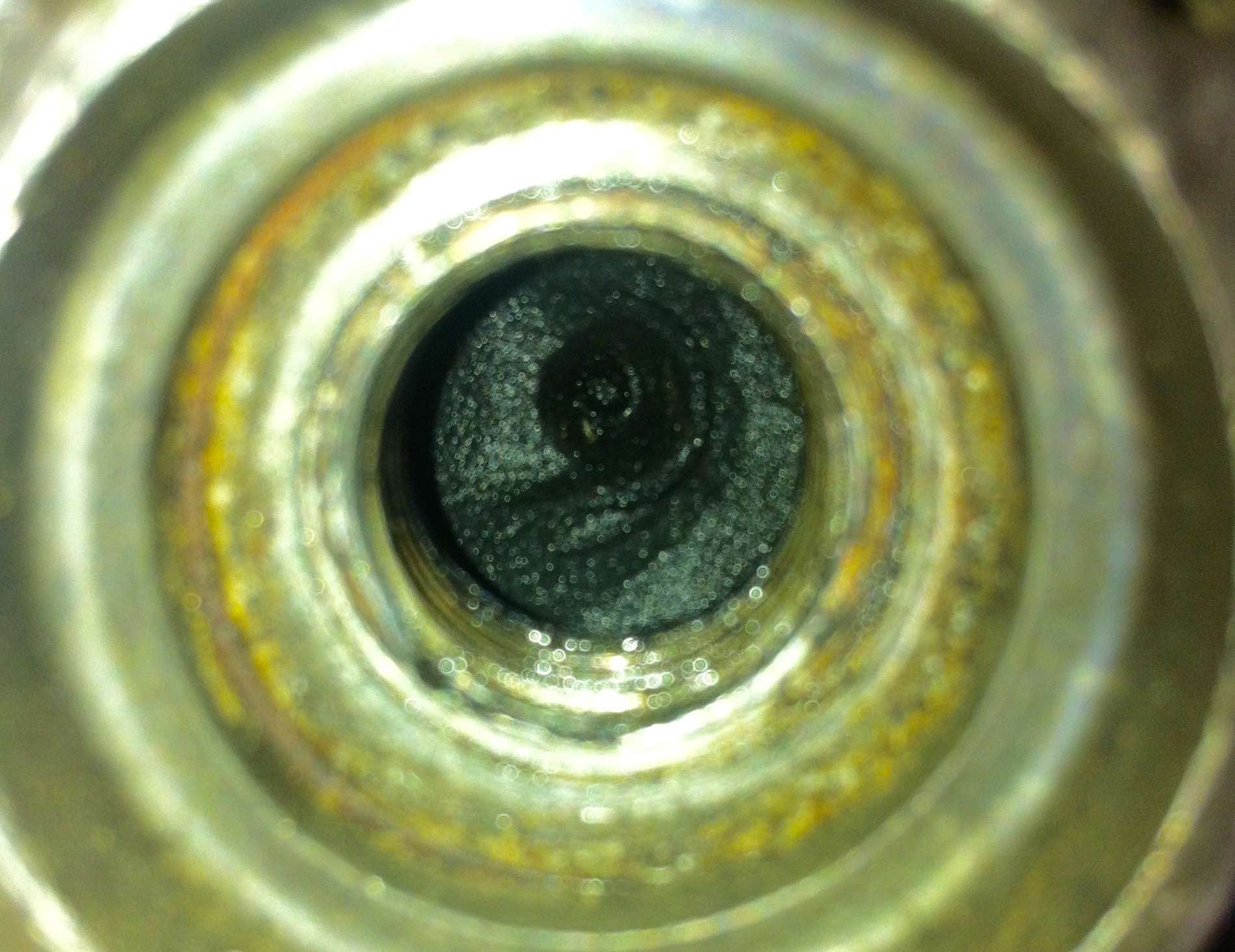

On a side note, and maybe I should start a different thread for this, I took the spark plugs out to take a peek at the cylinder heads. I could only see 2 and 3. They both looked sort of the same but I had troubles seeing 3 clearly. #2 did't look normal to me. below is a picture, the best I could do given the light and camera. Does this look normal? (I did a compression test and each one was right about 120 except #2 which was about 118.
Re: 1956 Mercury Mark 55 E - how to "jump" start it. 11 years 3 months ago #112842
  • ed-mc
  • Posts: 1482
  • Karma: 235
  • Thank you received: 131
You're just seeing the machined top of the piston with a bit of carbon buildup. Nothing unusual there!

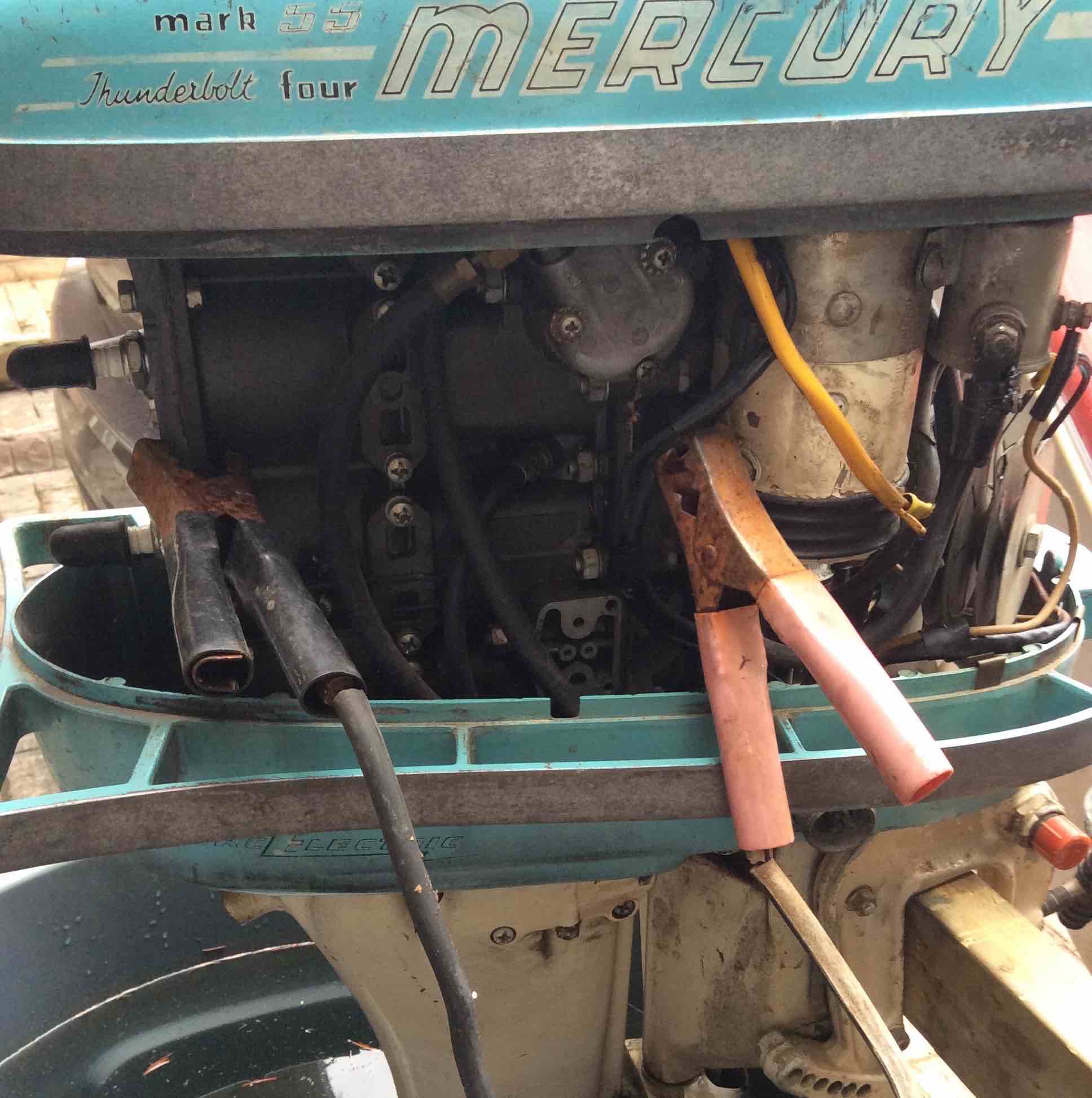

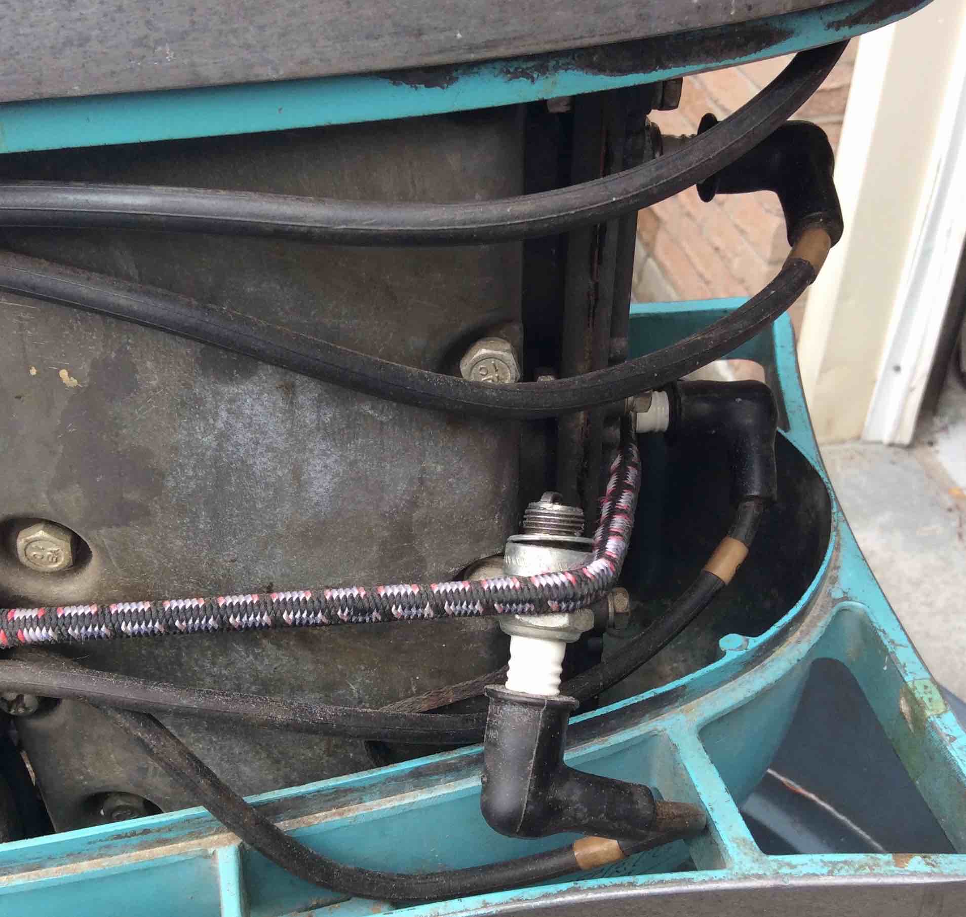

I was very optimistic about this engine running but it turned out to be a joyless occasion when I tried to start it as it didn't give any sign of catching on. I took #4 spark plug out to check for spark and didn't see any. So before I attempt to work on the distributor, I thought I was ask one more time if I'm jump starting it correctly. Here is how I connected the wires and how I checked the spark
Re: 1956 Mercury Mark 55 E - how to "jump" start it. 11 years 2 months ago #114131
yes. don't forget to disconnect the yellow wire on the rectifyer

Hey Dave, yup, I disconnected the yellow wire.
It turns over well but there is no spark. I just wanted to make sure that, since I don't have the controls at this point, there is nothing else that needs to be done "turn it on" in order to allow it to start when jumping it.

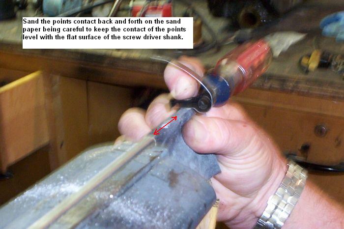

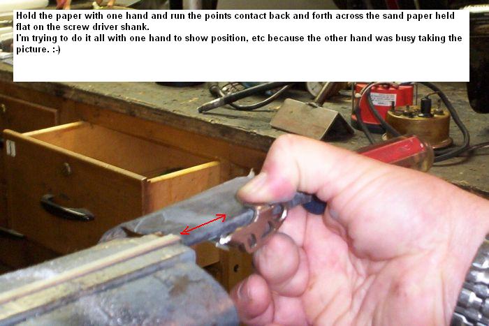

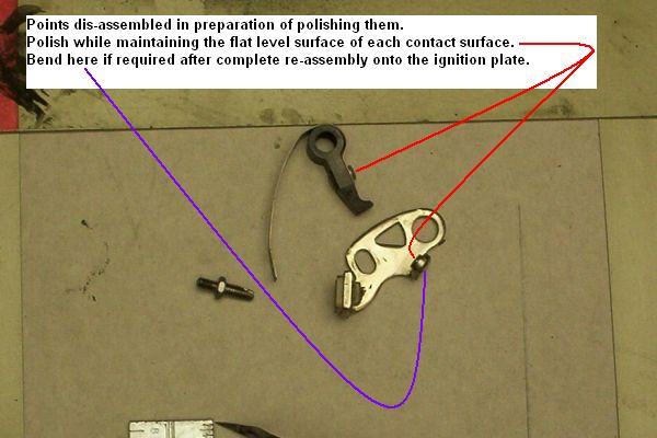

The attached pictures show how I polish the points.
Doc
