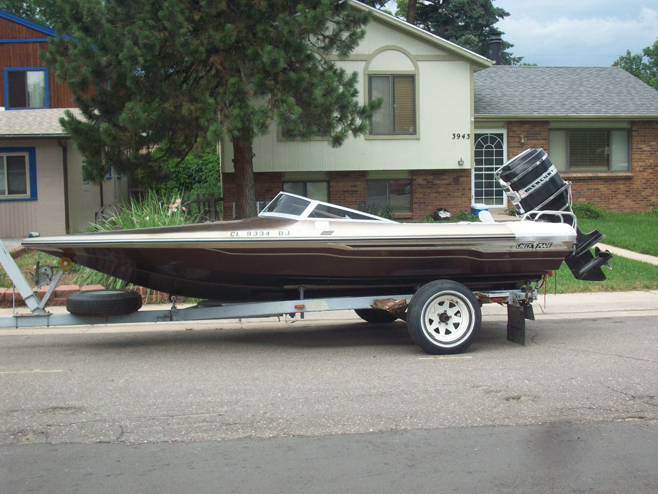

A neighbor down the street brings me a wheelbarrow full of Mercury 150 parts. Near as I can peg it down, I believe the motor was manufactured sometime between 73 and 77.
I am basing this off the CDI Part # 114-2986
They left the PT/ T unit attached to the boat....and consequently the serial number plate.
God knows why
Should mention, the boat is not accessible to me.

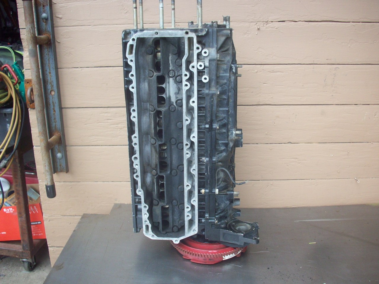

The crank turns freely, but, I can see at least two pistons thru the head with significant scoring.

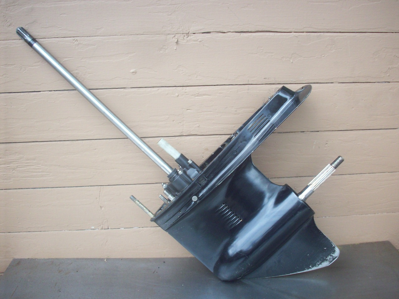

Good news is, in the collection of parts is probably one of the most pristine lowers I've ever come across.
My next question is, will the lower fit fit my 66?
The lower unit casing # for the 150 is 1623-4934
If it would fit, I could eliminate the possible need to go the thru the current lower.

it will fit check the gear ratio. the ignition will be a bear to retro fit mounting and all.

Re:I think I know the answer...... but 16 years 3 months ago #11315
You bet it will work, if it has the small location pins either drill acceptance holes in the mid or grind them off like I did.
A 1500 only came with 2-1 gear ratio like you had on your 1100 unless it got changed but that is a small chance. Easy to check put the lower in gear mark the prop shaft and mark the drive shaft turn the drive shaft and the prop shaft should turn exactly 1 turn to 2 turns of the drive shaft.
If it is different gear ratio yes it can be used with different props...
If you want to loose the 1500 block someday let me know. I have a 1500 that fried some pistons.
Ltr
Conrad
Do you mean this block? See attached
I am ready to send it down the road right away
Make you a good deal!
