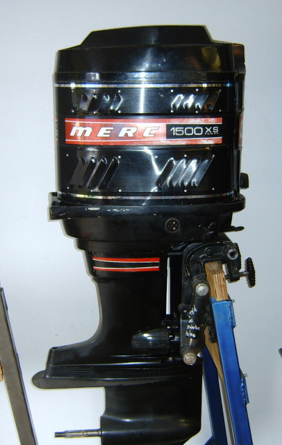

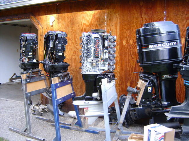

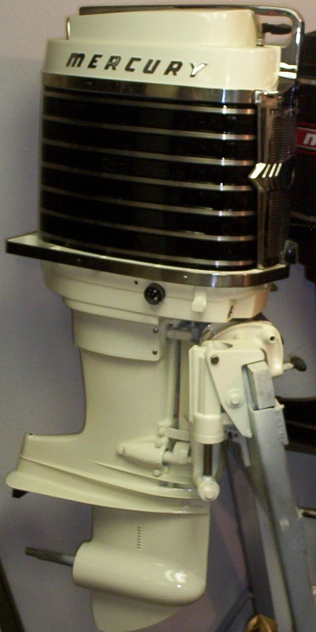

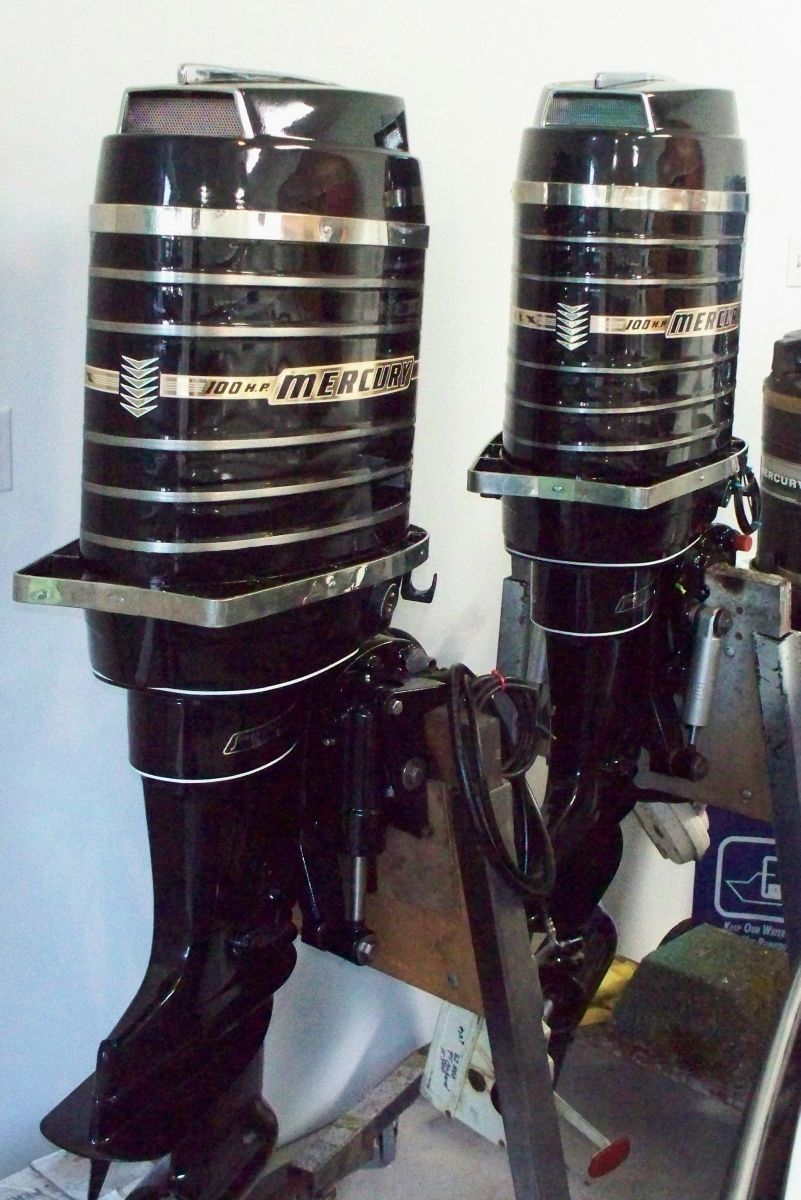

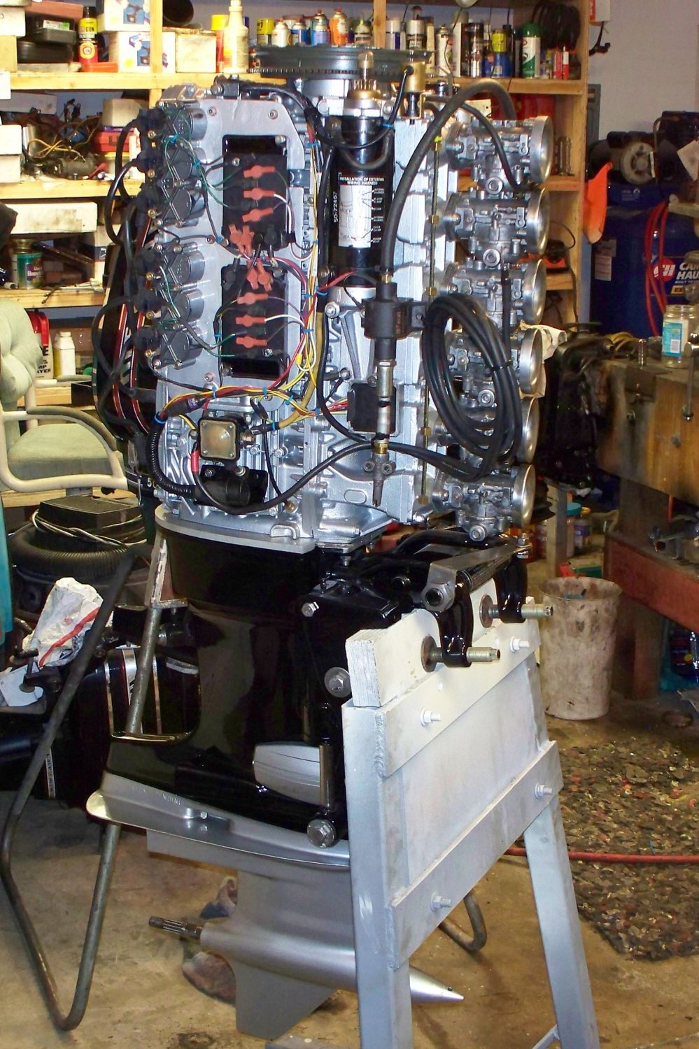

The Doc is Most Modest; he does some Awesome work.
Behold, just a smidgeon of the Masterpieces emerging from the Doc's skunk works:
