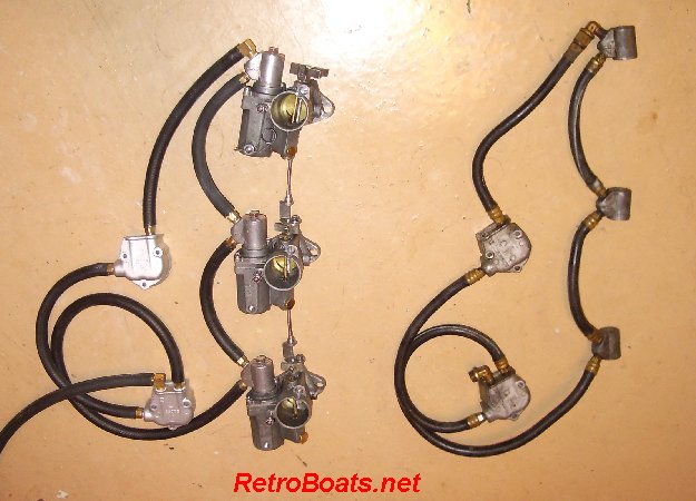

Good day! I just picked up a 1967 Merc 950 SS and am in the process of going through it. I am replacing all of the fuel lines inside the cowl. I ordered all six from Oldmercs, but three of them were wrong. The hoses between the three carbs connecting them were far too short. The official spec in the books says they are 6-inches, and the new ones were. Does that take into consideration the threaded connectors as well? With my connectors they are 7-1/2 inches each (the old ones). Am I missing something?
Have any of you ever built your own fuel lines inside the cowl, or are the factory type better? At this point, I would rather just head to the auto parts store, get a few barbed fittings and hose clamps, and build my own. Pros and cons to doing that?

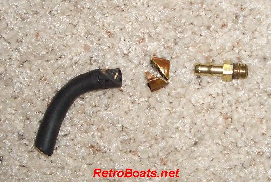

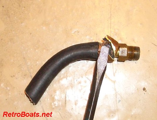

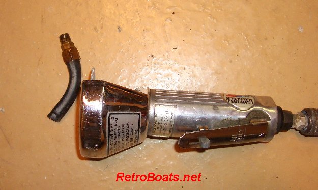

Agree with the wizards here, but maybe you don't need even the barbs, just new hoses! Heres pix..slice'em off.
