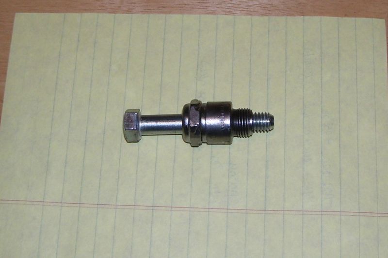

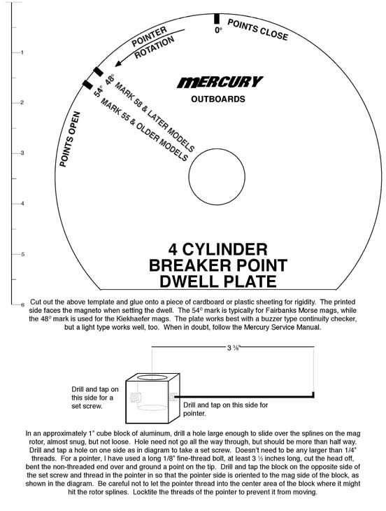

if your pinging/rattling noise started immediately after you changed your points Id be more inclined to think your issues is pre-detonation ping from advanced timing.
pinging at the rpms you posted and is it usually during accelleration?
check your points again before you get to excited
you can make the timing gauge from a spark plug
Re:I found the pinging noise 16 years 3 months ago #12133
Thanks for the reply, good sir.
The pinging started that last infamous trip last fall, when the points started to close off. We were 12miles from the wharf and we had to limp home, with the poor girl missing and stuttering and yes starting to make this horrid noise. It makes the noise above 4500rpm, either at steady state or accelerating. My tach registers a steady 5250rpm wot, and Dad's old meter clipped on registers the same, so i think it's pretty accurate. I did set btdc with a very cool dial gauge from Mr.Bernard, and subsequent max advance etc. as well as carb sync. When I set my point gap with my brass blades, I went on the sticky side of .0010(book says .0010plus 0/minus .002) and this yielded my 45deg. according to the old meter.
Thank you for posting the dial plate and directions for making it. I'll do my best to replicate it and give it a try. I do have the proper Merc. manual (courtesy of my lovely bride at Christmas) so it should be able to walk me through the process. I'm stripping the mag. down this weekend to double check points etc. (cause I don't trust myself fully yet)

Frolic
thread the inside of an old spark plug to accommodate a bolt so you can count the number of turns to find your timing spot BTDC
