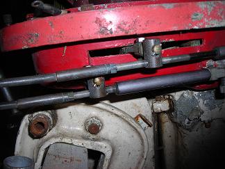

Yes there is a rollr in the box, but due to the not comparing neutrals of the box and engine there is nearly impossible to feel if the box is in neutral or the engine.
There is no more adjusting to do eiter the box or the engine.
Going to machine a 1" longer extension and se if that works.
Picture shows inside lowerhouse.

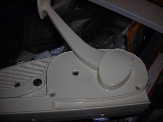

Getting the cntrol box to work nice whith out the cables. :)
Getting the cables to work nicely at the engine. :)
Putting it together, not working. :angry:
Sounds like metal grinding in the box, worn out? :woohoo:
Ripped the box and cables and tossed them as far as possible. :angry:
Now installing the teardrop box, man if this doesn`t work. :laugh:

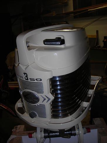

Man what a different, works like a dream.
Everything in position, neutral drive and reverse.
And the small extra gas handle really helps.
