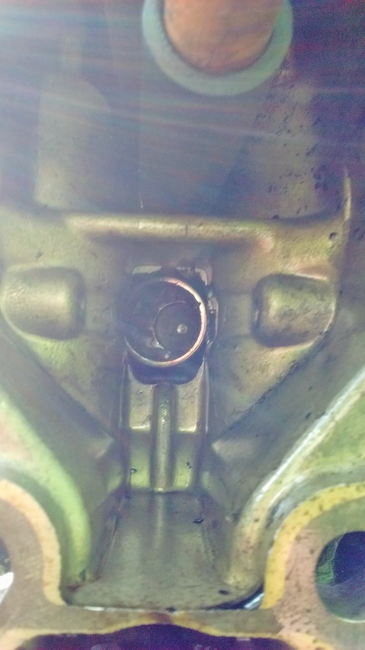

This is a special problem ! I was a negligant boat owner and didn't winterize last fall, my l/u didn't take this well and popped the prop out. To get back in the water (hopefully soon) I decided the best course of action to be removing a sound lower from a 73 115 I got last summer and haven't got running yet.long story short, my old l/u was a short shaft with extension kit. I did not realize until recently that the driveshaft extension peice is actually residing in the driveshaft "shaft". It is loose but will not just fall out. I am hoping someone has a smart idea here. Really really don't want to pull the power head to access this thing. If I can get this ting out I will be boating soon . my only ideas are using job weld to attach a screwdriver or something to pull it out .... Or some type of drill/tap scenario. Thanks for the help boaters

  • ed-mc
  • Posts: 1482
  • Karma: 235
  • Thank you received: 131
If it's loose, it should come out. On some motors, they catch right where you see in the pic. It's entirely possible that the P.O. had to pull the powerhead and install the stub extension shaft from the top, then reinstall the powerhead. You'd have to do the same to get it out.
Maybe you can get some kind of small burr grinder, etc on an extension shaft up into the cavity, and "excise" some of the interfering aluminum on the sides. Probably won't take a lot to clear.
Worst case, pull the powerhead, it's just one gasket and not too bad a job, especially if you have an engine hoist or a come-a-long and place to lift from.

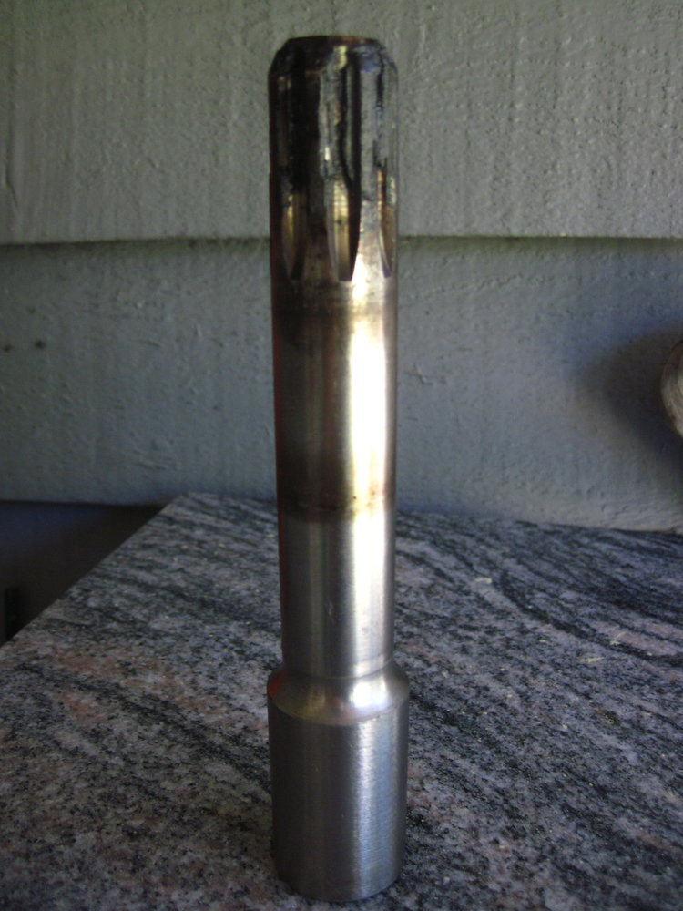

Thanks Dave ,and ed, the powerhead must have been removed previously, as the driveshaft extension that is stuck could have only gone in through the top. Otherwise I would have given removal from below a more serious attempt. However it quickly became obvious this was not possible. The extension piece could not fit through that opening. Had to have been dropped in from the top. Seems like too much work just to run a longshaft on a short drive outboard . I will order a gasket asap. As I am not a gasket reuser type. Thanks again for every post fellas all helps.
Oh, Yeah, I forgot, silly me, the whole reason for this thread! :S
I agree, an awful lot of work to install a longshaft kit and plenty work to remove it, too!
The only redeeming thing in this whole sordid ordeal is that the longshaft kit does have value and you can probably get some good $$$ for it on eBay!!!!
Most of the newer inlines are wide enough in the exhaust tower to let the stub pass thru the bottom. It is pretty irritating though, when you go to take one of those down and the stub sticks itself in the driveshaft.
Usually I'll seal the splines of the stub to the driveshaft with RTV and this keeps the dang thing from falling off when you go to reinstall it.
Any way you cut it, those kits are a pain in the Arse! :angry:

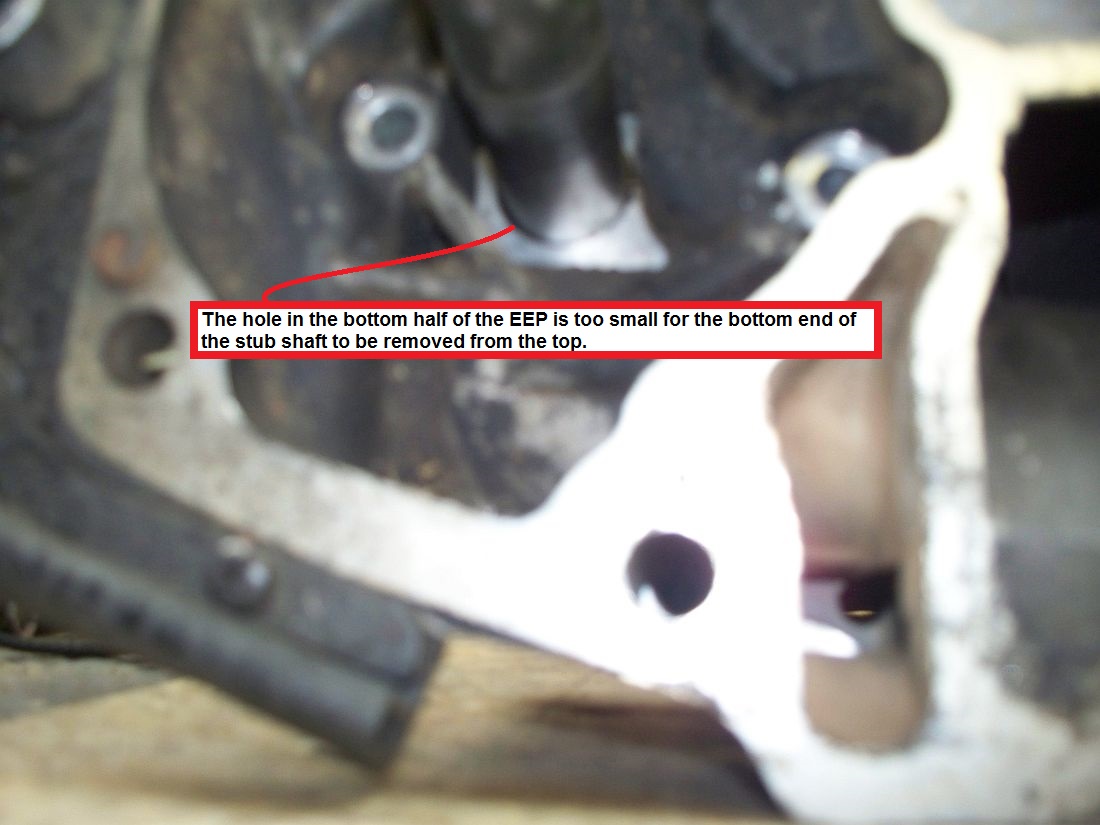

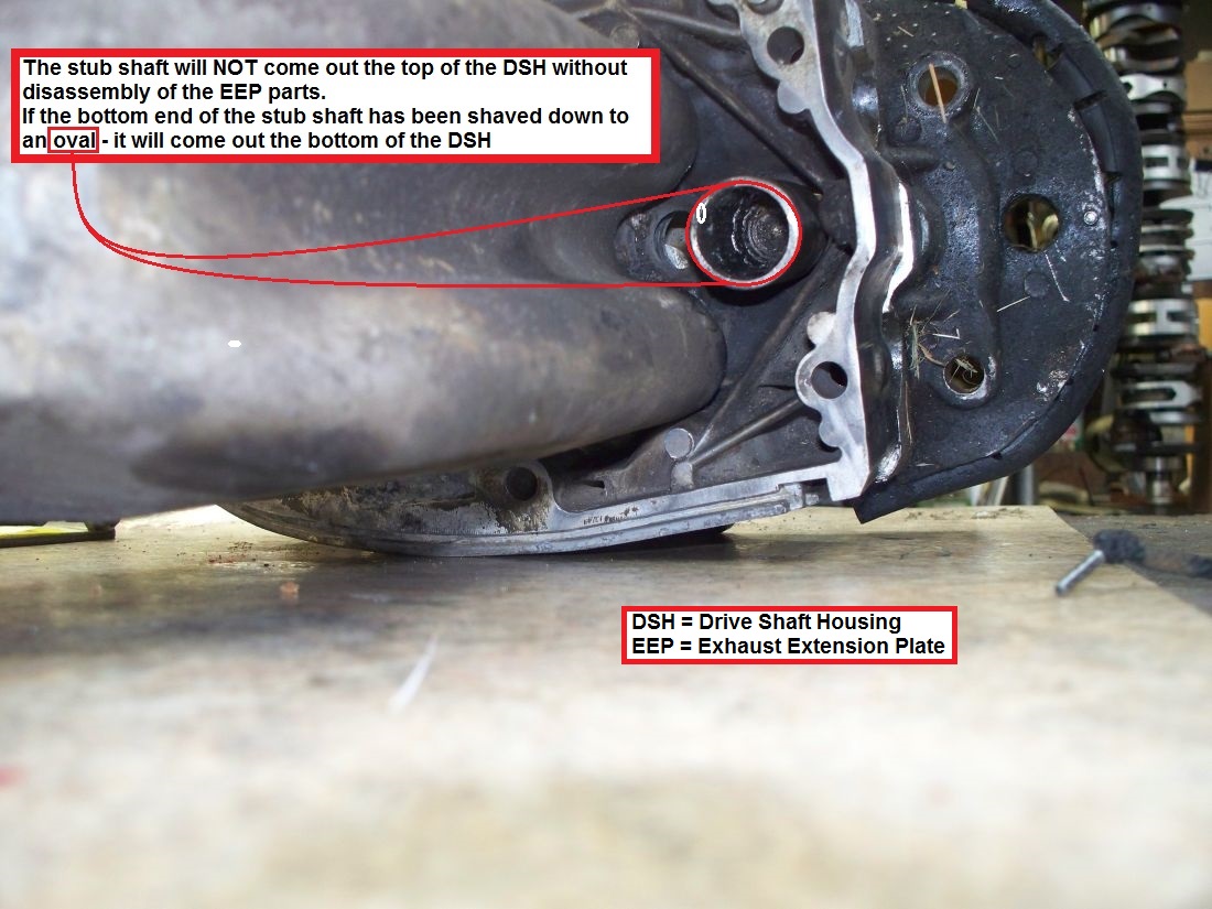

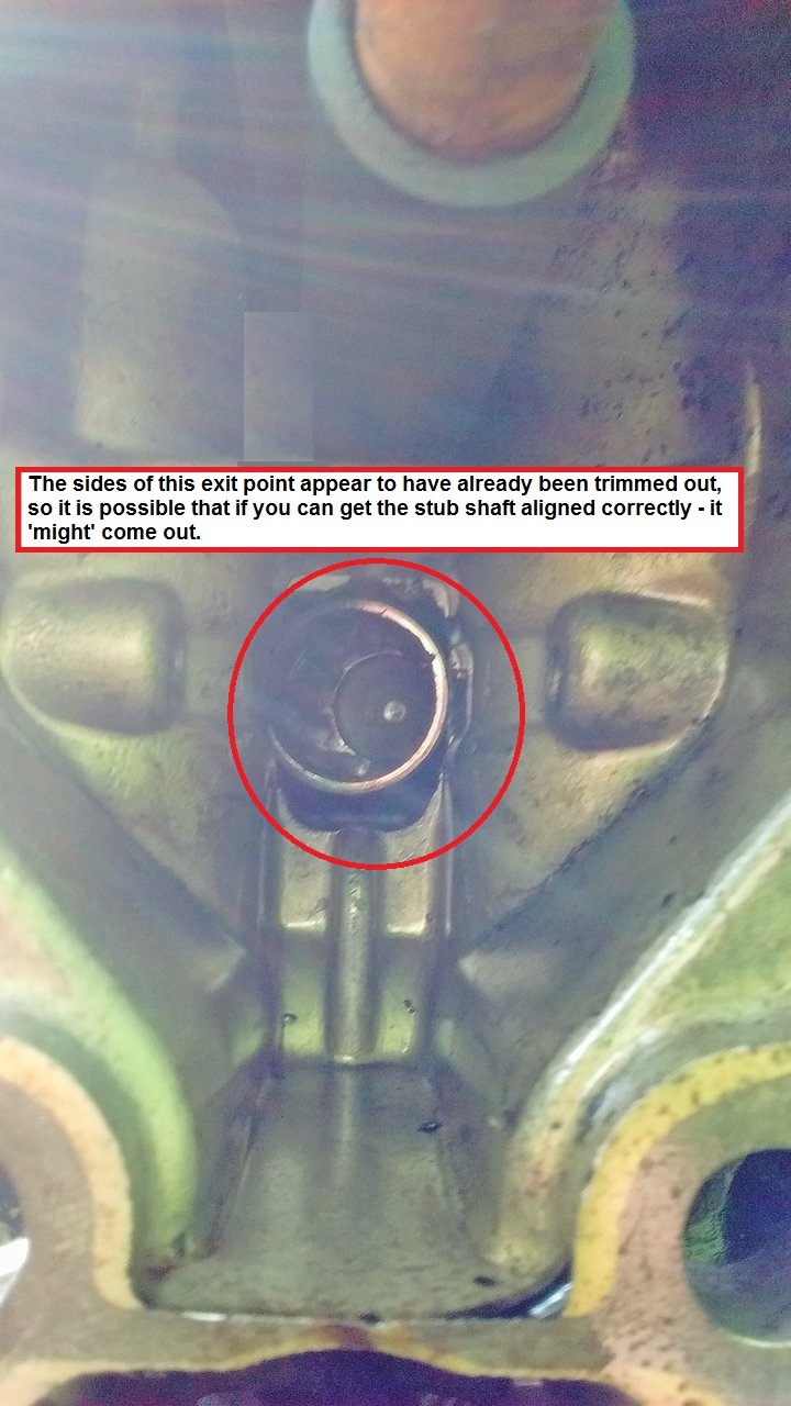

Re:Crucial extraction on 65 1000 11 years 4 months ago #111248
It looks like someone has possibly already shaved the exit point for the stub shaft, and you might just need to rotate the stub shaft a bit to slip it down and out.
It will not come out from the top (engine removed) without a TON of extra disassembly.
See attached pictures for details.
doc
OOPS,...
Pictures were for the later dual square port exhaust Mercs.

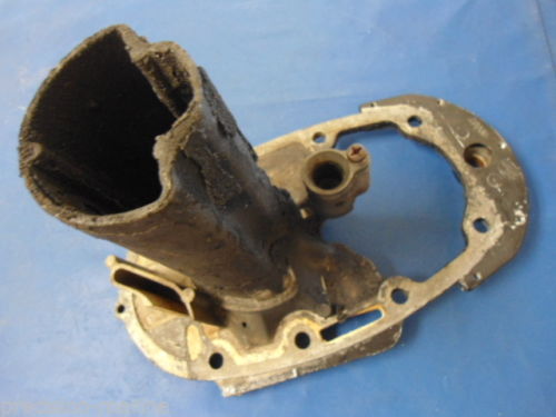

Hey, Doc, that pic of the exhaust extension plate looks like a later-model, split tuner-plate? This old Beastie wouldn't have that piece, with the skinny hole in it. It would just have the thin tuner plate sitting on top of the full-length exhaust tower.
Just wonderin' what my Lyin' Eyes are seeing!.......ed

The good doctor (me) was totally full of Prunes on this one & I do apologize.
I somehow was focused on the later model Mercs - even though the entire post has been about a 1000.
AND,...To top it off,...Xfinity - Comcast internet has been down here since yesterday afternoon when I realized my fooh-paw, and I was unable to post a correction.
I tried until after 3 A.M. & finally surrendered to my pillow.
It is 6 A.M. now, but now that I admitted my goof - I'm back to bed.
Sorry all, and I to my good pal and Mercury Guru - ed mc - I humbly eat my crow at your feet. :)
doc

If it won't come out the bottom, it has to, and will come out the top after the powerhead is removed.
I wonder if you can get a long file up there and file a bit off the sides of the exhaust tower, until there is enough clearance for the driveshaft stub to drop. Might work better than a grinder.
That's about the only alternative to pulling the powerhead, that I can see.

Your the best ed! Thank You. I am going after it tomorrow afternoon. Gonna use a long file , that extractor thing (bearing tool and slide hammer) that I rented before and lots of patience and optimism !
Re:Crucial extraction on 65 1000 11 years 4 months ago #111553
UPDATED :So I rented the same tools again, and bought a set of files (as the lady would not allow me to use hers for this !) After filing for few moments I noticed that the file was able to push the extension quite far into the shaft housing, at one point I also noticed that the area were the water tube resides that is next to the driveshaft vein was open enough for me to put another file in there and basically move the extension piece out through that water tube area without further filing. Took me about 5 minutes ! I had to post a picture of the object of my dismay !I put the nearly removed powerhead all back togther. Then decided to put the new water pump impeller bought from one of the finest fellows on this site Mr. Joe Poole. However call me a fool , but when I got the pump housing off I could bring my self to replace those parts ... they look brand new, gaskets plates housing, impellar all of it looks new, so I left it. Today I returned the tools unused again, went home and attempted to install this other L/U.I kept coming up with an extra 1/2 centimeter gap between the plates, narrowed it down to the water tube I will likely shorten it a touch tomorrow. Then hopefully a test fire on the muffs. Will report tomorrow
