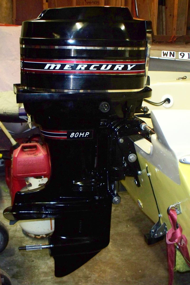

Well, as I was just curious, the meat of this is Doc its Ted's 800 on the Dorsett so you know all about the motor. He's finally getting around getting it fired. I drained all the gas out the front tank (about 13 gallons), smelled great and he ran it in his truck no problem. Its still sitting all this time his (old Swiftys) heated shop so moisture should not be a problem. He wants to go ahead and fire it but told him drag in here so I can oil the piss out of it and do it halfass right first. I did cut the gas hose to the motor. I'll put a inline small filter later but for now use a portable tank for gas so not have to go through the hassle of pumping out the front tank again. He's already got the Searay in the water, and I'll keep bugging him to get the damn thing over here. If any problems ya know damn well it "going back to the Doc".

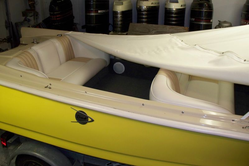

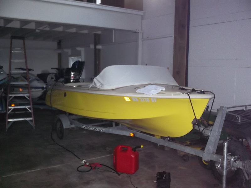

Doc. Pix the boat. For those who do not know, Ted saw this side the road outta here free. Simple derelict no trailer boat. Grabbed it and now total restored and cost so far? $15,000!
The boat and the shop pix. (Doc, try Tuesday you?)
