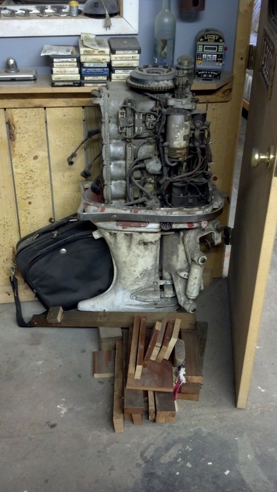

I just got a really nice 59 78ael the other day.110-115 psi all cylinders. Older repainted. Everything is in great shape. It does need a forward starter solenoid and the impeller pump. From what I've read there are 2 rubber "duck bill" pieces in the water pump. Is there a source for these old parts. Or does anyone have the proper name for them. I've also heard from an old man and read something online about modifying the key way on sierra# 18-3052 impeller and it fits the old dock busters. Does anyone have info on this? Could mean cheap replacements that are still made. 14$ vs 50-60$
Hopefully I'll have it up and running soon. Then it's getting put on a 61 alumacraft queen merrie 18' runabout.

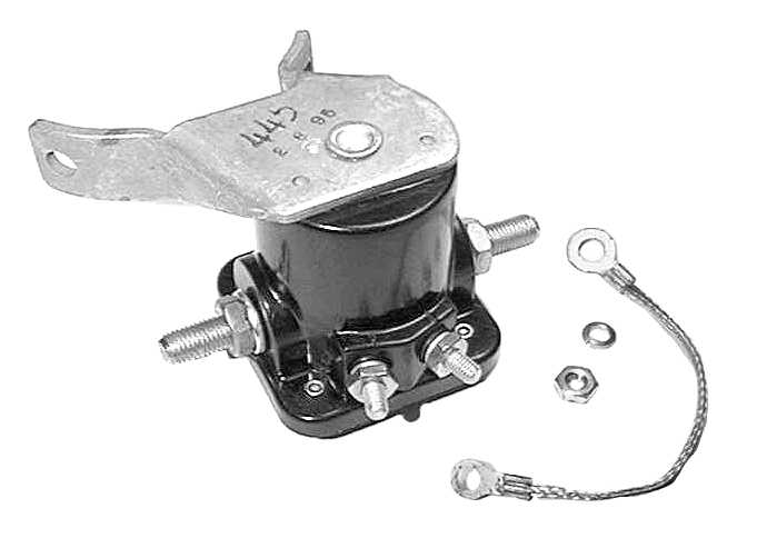

What does everyone use for starter solenoid on these. Original had been discontinued a long time.
Re:59 mark 78a parts 11 years 5 months ago #109747

Pretty much just the starter solenoid. I'm sure a newer one could be rigged in it's place though.

they take 2 starter solenoids
Re:59 mark 78a parts 11 years 5 months ago #109761
I know. My forward one isn't working.

One thing I was wondering is if anyone has modified a readily availability solenoid for it. I'm not looking to just Jerry rig something together. I'm looking for a long term replacement for discontinued parts. If it's hard to find something now I'd hate to try in another 30 years.

The ebay item id given is invalid, no result has been sentI think yours takes the "32445" solenoid which was used on other motors as well. Although it's now NLA from Mercury. Found a few in an eBay search:
I've also attached a pic, take a look and if that's the same bracket as your solenoid, it should fit. Most of these old solenoids are the same except for the bracket.

Re:59 mark 78a parts 11 years 5 months ago #109774
craveman85,
The solenoids you'll need are different inside than many of the other Merc solenoids that look the same.
Your solenoids have 12vdc+ going between one of the small terminals & the front coil to supply a full 12vdc to the ignition during starting.
Most other Merc solenoids that look the same have a wire going to engine ground rather than having 12vdc+ during starting.
This is an internal difference between your style solenoid & the others.
The other small terminal on both style solenoids has the yellow wire to engage the solenoid.
I have quite a few used DR solenoids and would bench test them before mailing if you decide you would like one, or two.
If you are interested, and Dave Bernard doesn't have what you need, just send me a PM (private message) and I'll hook you up.
doc

Doc is right about that! Attaching a wiring diagram which shows the connections from solenoid to coil.

Darn I was hoping for a long term replacement. I just ordered a dockbuster starter with both solenoids from johns old mercury parts for $54 shipped.
