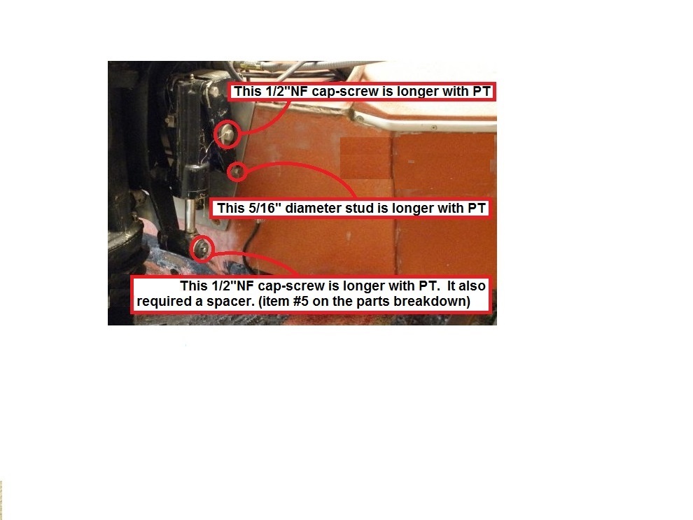

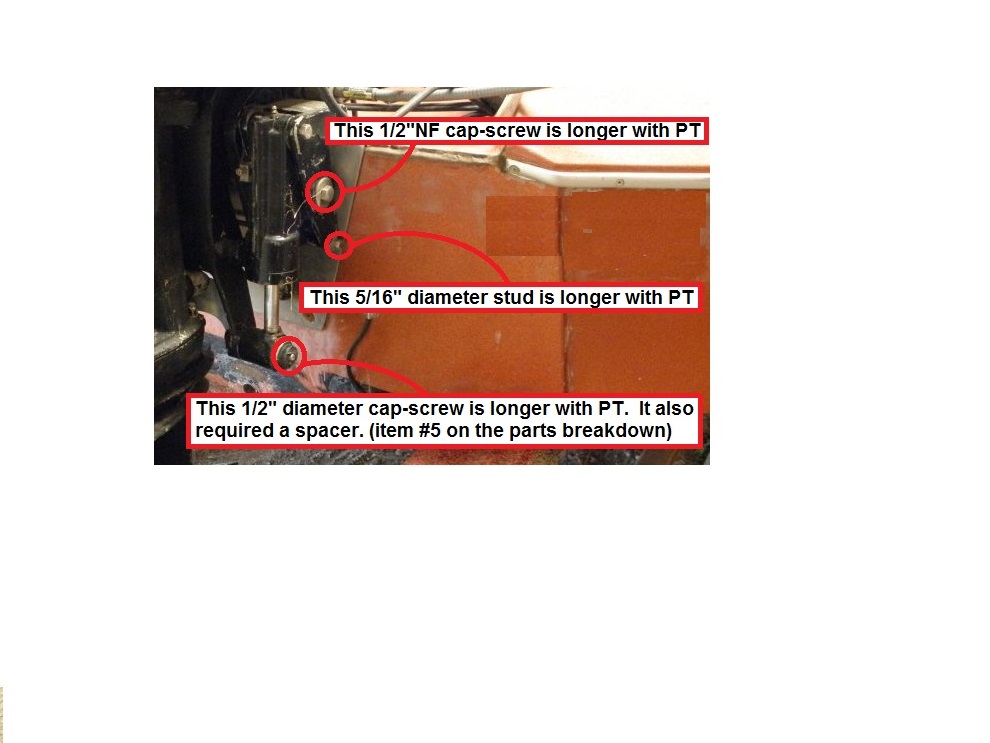

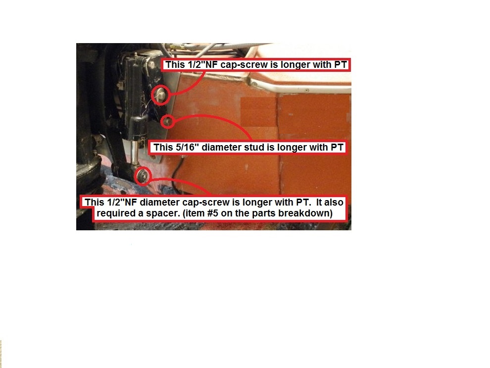

My question is, can I use the non tilt/trim transom bracket (swivel bracket) and just bolt the pistons in place of the old shock absorbers? Do I need a longer upper bolt and intermediate bolt to put them in correctly? Looking at the CMC PT130 and how it all fits together, it seems as if I have to replace them and either move the motor onto the transom or buy a jack plate as well?

use the brackets. the brackets bolt to the upper shock mount first then to the transom. motor does not have to be removed from the boat.

I'm going to have to look at it again. I thought the bolt underneath and the upper main bolt would have to be much longer.

Re:Tilt and Trim Conversion 76 1150 TOP 11 years 6 months ago #109596
doc
