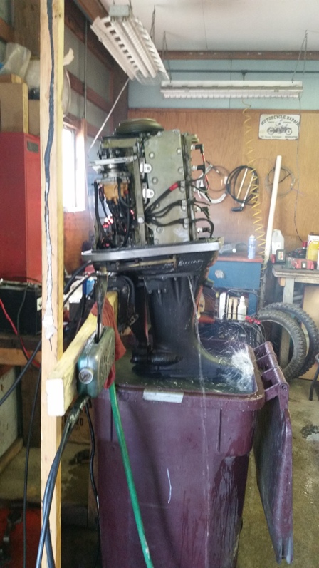

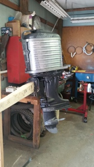

Hey All,
I've been posting on here quite a bit lately during the progress of my Mark 75 that I picked up a few months ago with a seized power head and cracked lower unit for $80. I installed new rings, new gaskets & seals, new impeller, and did a fair amount of welding and machining on the lower unit to get it right again. Finally this past weekend all the hard work paid off and I got to hear it run. It fired right up and starts easier than any outboard I have. I literally touch the starter button and it roars to life. Must have gotten the point dwell setting pretty close. :laugh:
Just wanted to say thanks for everyone that helped me out through the project. Now I just have to rig it up on the old crownline and see how she runs on the water.
Scott

running in the barrel

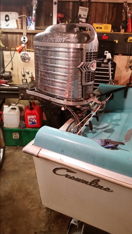

Well, as a little update i got the motor rigged to the boat and it looks good :)
The weather was terrible on Saturday with rain and drizzle, but i decided to bring it down to the lake by my house and try it out anyway. The entire trip ended up being an epic failure :(
I last ran the motor last week in the barrel and it started great and ran awesome. I figured it would do the same thing at the lake, but i was mistaken.
First off, i went to prime it like usual, and the bottom carb was just puking fuel. I had gone through the carbs when i assembled the motor, and it had never done this during all my test runs in the barrel. Next, like an idiot, i must have bumped the key to on when i was mounting the controls earlier in the day and the battery was pretty much flat dead. Long story short i didnt get to make a run.
When i got home i dissembled the float-bowl of the bottom carb (PITA) and found that the float was "half sunk". this just goes to show how bad the "modern" fuel really is. After only a week or so of sitting with fuel, the float got saturated. (im sure it wasnt the greatest to start with either).
Anyway i am in the process of removing all of the floats (luckily i have spares) and am going to coat all of the replacements in airplane dope.
Will post some pics of the motor on the boat as soon as i resize them
Scott
