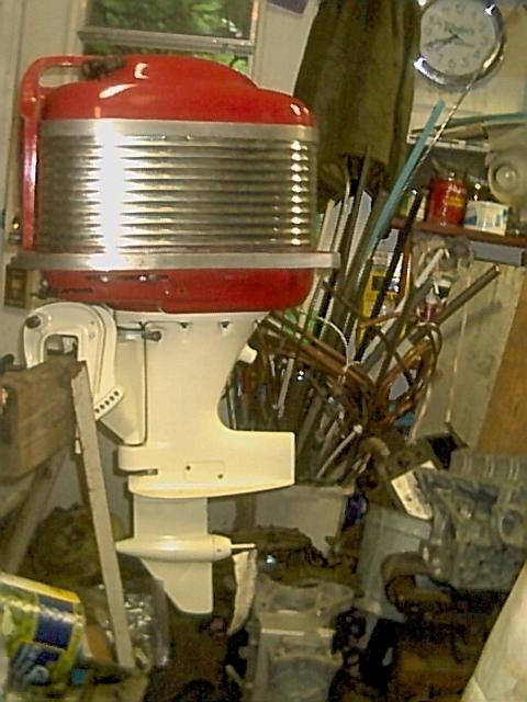

I picked up a 1956/1957 Mark 30 yesterday that is in good shape (no dents, sounds great), but I've been reading they have weak lower units. Is this true and why?
I have two Mark 25s and I noticed they have the same lower unit as the Mark 30, does this have something to do with it?
I'll post a picture tonight.

Re:Mercury Mark 30 weak lower unit? 11 years 6 months ago #109197
Unless someone else knows differently,...The Mark 30 lower unit should give you good service provided you keep the gear lube water-tight, and don't hit any logs or dig any clams with it.
Typically, the steel drive shaft & prop shaft can develop rust issues where the seals need a good smooth surface to seal against, but you can 'fix' those areas by installing stainless 'speedi-sleeves' & new seals.
Looking forward to seeing pictures.

That's a cool motor! Years ago I picked up a MK30E and was impressed at how smoothly those teeny weeny pistons ran & how it revved up smartly. Wished I had kept it, but do have a couple other non-electric ones kicking around in pieces!
You may have heard talk of a weakness in the MK30H mid-section, the slot for one of the lower unit studs is deeper than the A/B & D Shortie mids, and tends to crack after hard racing.
I also remember a posting about the "C" racing unit breaking driveshafts at the pinion gear and resultant destruction of the lower unit, but again you're talking about racing stuff which is highly-stressed.
Can't recall any big issues with the standard MK30, nothing out of the ordinary.
Cheers.......ed

That's not mine, just a pic I gathered from the internet....ed

Sweet looking Mark 30 you have there, your looking at a racer in that pic Mark 30H. Great job on finding that Mark 30. Looks like it's about time to change your avatar!
