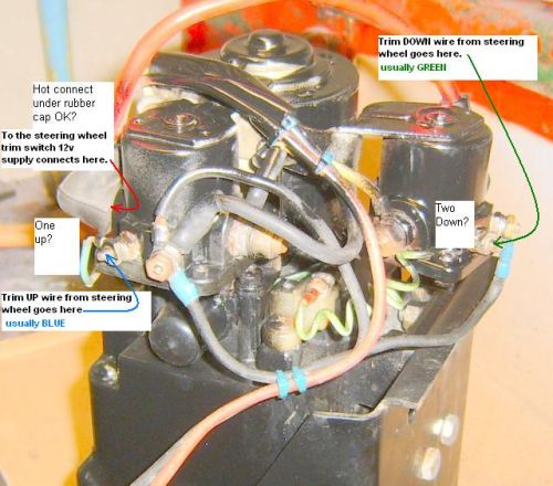

If the trim pump is in the boat, there are (3) wires coming out of the trim motor.
The Black is ground (-)
The Blue is UP when jumped to 12vdc (+)
The Green is DOWN when jumped to 12vdc (+)
If the trim pump works for UP, but not DOWN,...Odds are it is a dirty or corroded wire connection issue - OR - if there are (2) solenoids (one for UP & one for DOWN,...It could be the solenoid.
Connect the larger Black wire coming directly out of the trim motor to a good Battery (-) Negative.
Then using a jumper wire - touch the larger Green wire coming out of the trim motor to a good Battery (+) Positive.
The trim motor should run in reverse & lower the Merc down.
Not all of this generation of trim motors had (2) solenoids. Many had just (1) for UP, and for DOWN the Green wire went direct to the trim switch without a solenoid since DOWN typically doesn't create the load that UP does.
doc
If you have only (2) wires coming out of the trim motor - don't proceed until how to test is explained.

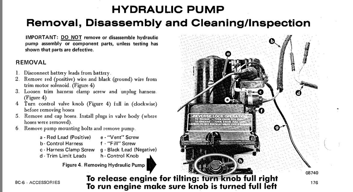

I just been messing my Merc and was getting up, but no down also. Simple loosen the wires and rotate to scrub a bit.. tighten and try it. Worked for me. Heres a pic Doc sent me long ago. You have the same pump?

The reverse lockout knurled knob on the power trim pump is used to allow the motor to be raised manually. To do this you would turn the knob full clockwise to release the locking function.
Unfortunately, this only lets you raise the motor, starting from the "down" position. You can't lower the motor without disconnecting a hydraulic line, or pulling one of of the allen-socket "bleed" port screws on the PT&T cylinders which will also relieve oil pressure.
Note that if the pump and controls are working properly, you have to have the reverse lockout knob all the way CCW for normal operation.
