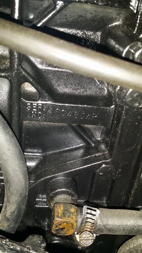

the boat is a 17' 1971 Kona. The motor cowling is for a 72 Mercury 1150 ELPT. no serial number on the transom bracket (not surprising). The stamp on hte block is 4604854P. I looked it up, and the list I found said this is a 1977 1500.
Is there a better way to know just what I have here?
Will

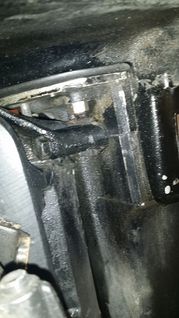

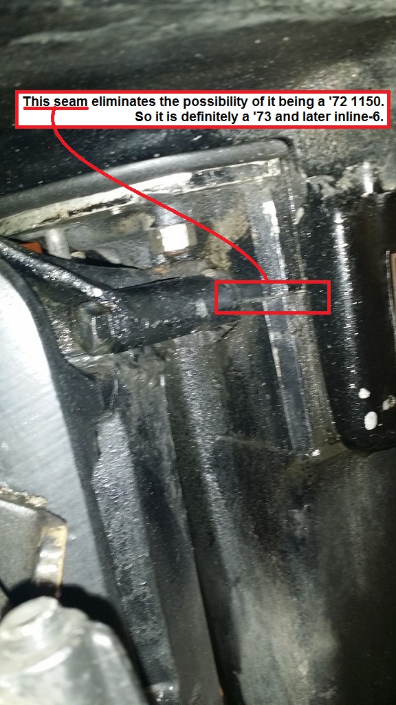

The wrap and cowlings will interchange as has been noted, but the '72 1150 powerhead can not simply be swapped out for a 1500 using the '72 drive shaft housing (DSH). Different exhaust configuration.
A '73 and later 1150 can be swapped out with a 1500 using the same (DSH).
Underneath the lower engine pan is a 'U' shaped cowl that covers the powerhead studs. Please take a picture of the area just in front of the front edge of the U shaped cowl.

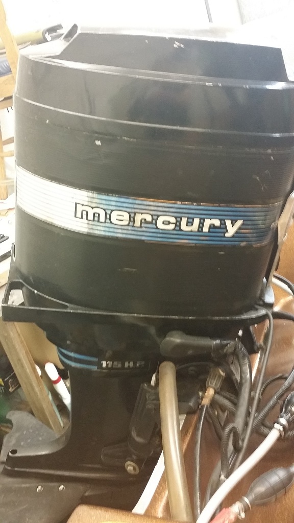

Motor right side

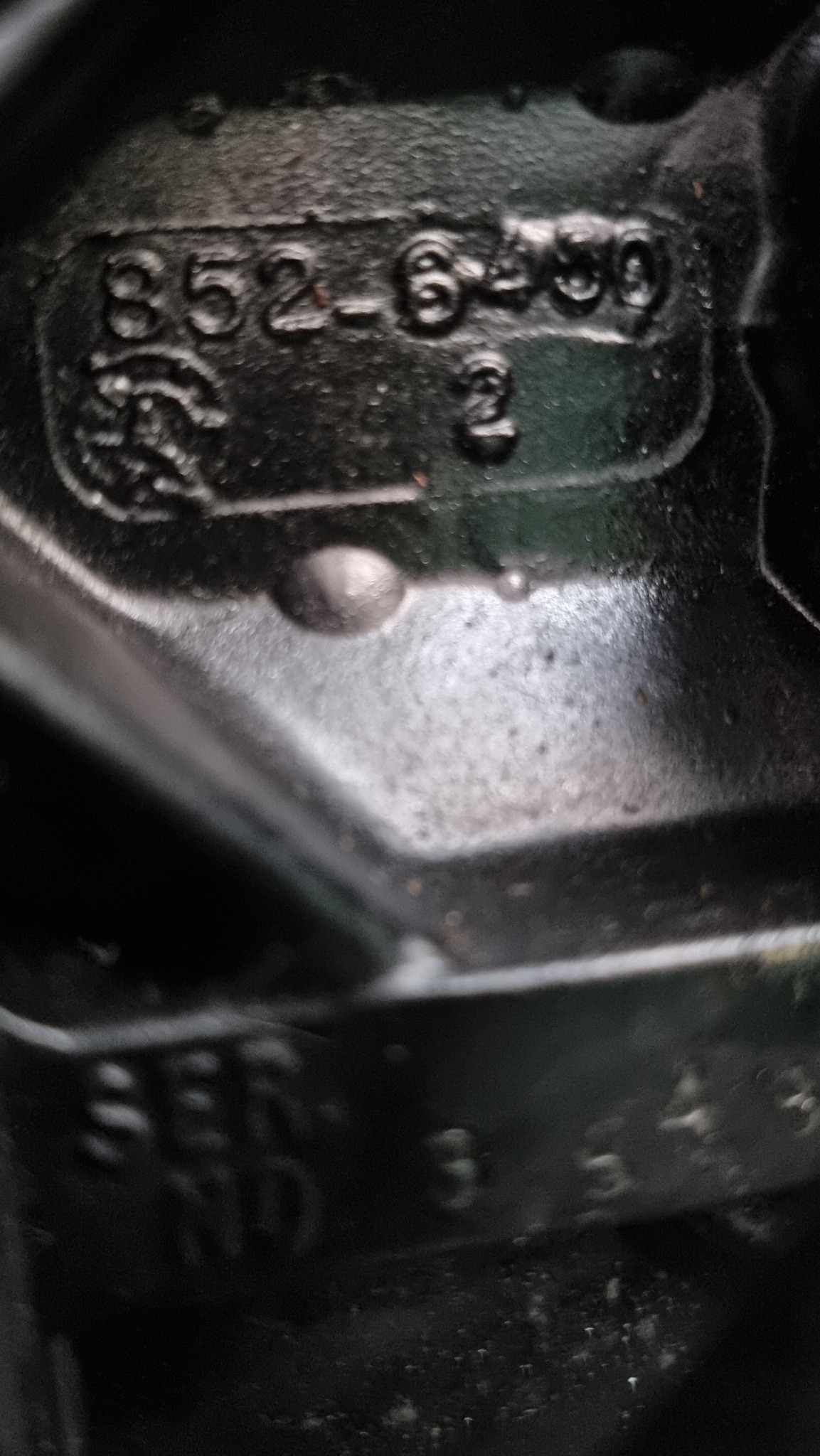

On the starboard side of the block is a cast number that starts with 852-
What are the follow (4) numbers?

Re:My Merc has an identity crisis 11 years 6 months ago #109122
The attached picture has eliminated it from being a '72 1150.
doc
Anybody know the significant of the 'P' at the end of the serial number??

On the starboard side, number 852- 6450. One black tube, coming up from behind the fuel pump, running straight up behind the flywheel.
What the P indicates? I have no clue.
Will
Re:My Merc has an identity crisis 11 years 6 months ago #109166
852-6450 is a casting number on (2) of my confirmed 1500 Mercs.
So-o-o-o,...It looks like you have the beast of inline-6s!!
COOL!!!
doc

The P on the serial number most likely means Pace Maker. It was a program where Mercury rebuilt problem engines then re-sold them. Ive got a 1972 800 with Pace Maker stamped into it.
Conrad

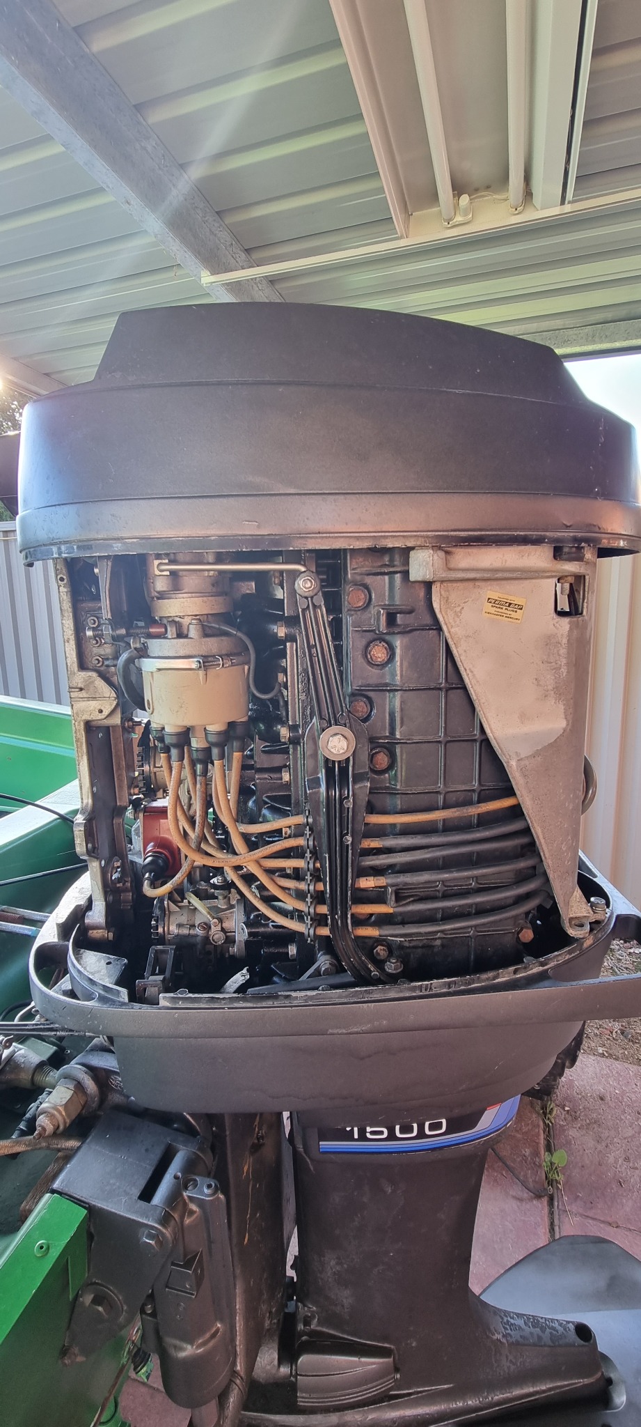

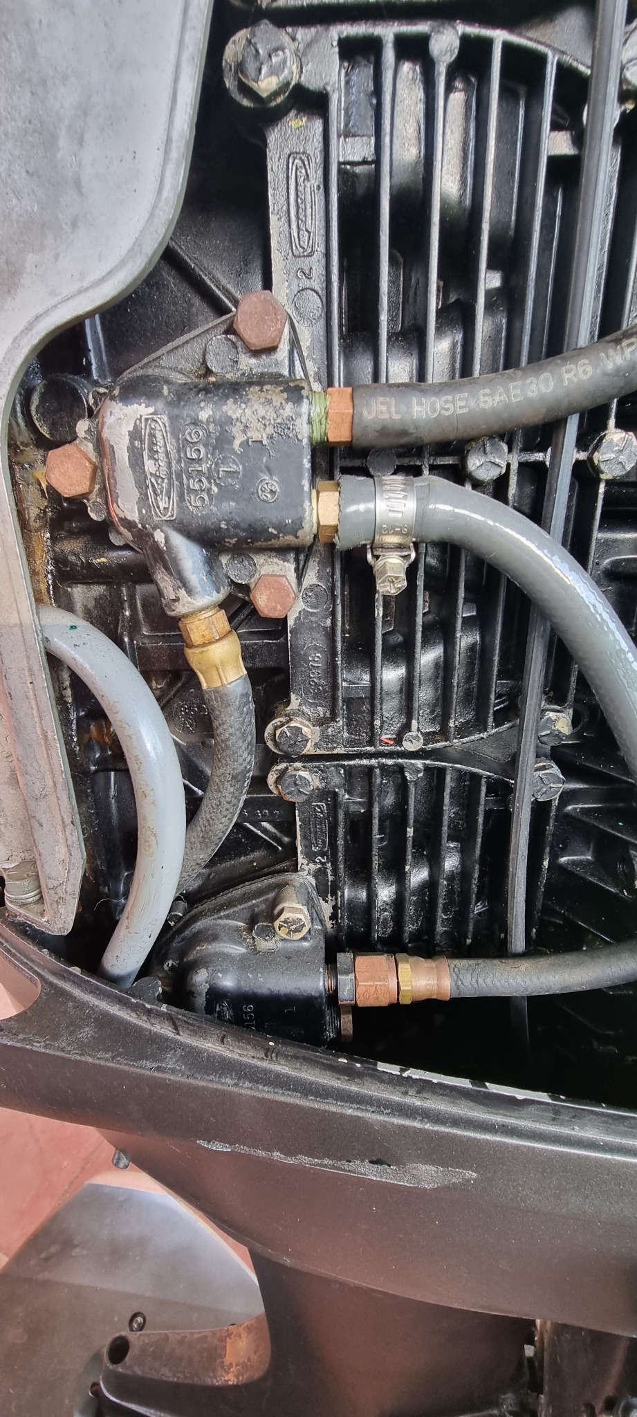

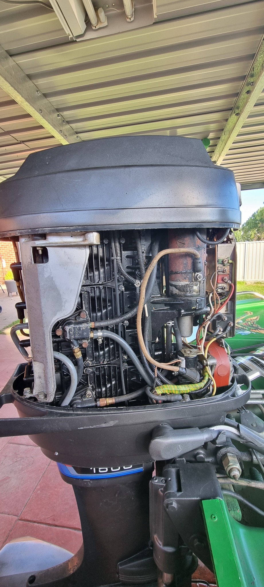

Re:My Merc has an identity crisis 4 years 9 months ago #146187
Hi I am reading through your comments, i am just wondering if the 852-6450 could be something other than a 1500 i have a motor that i am trying to identify, and the serial number looks like it was stamped by a blind school kids, and oesn't match with anything, but just above that is the 852-6450 which i can't find listed on any Mercury parts list.
sorry to jump in on this thread, should i start a new one?
Re:My Merc has an identity crisis 4 years 8 months ago #146270
I don't see any harm in carrying on with the same topic, but a different inline-6.
Based on your fuel pumps, it is either a first serial group 1500, or possibly a '73+ 1150, or possibly a 1972 1400 - which is the only model inline-6 in 1972 that had the later exhaust configuration.
Trivia note: The '72 1400 was a one year only, but when the 1500 model was discontinued after 1977, the 1400 returned in 1978.
The 1978+ 1400, 140, was actually a 1500 internally, but was designated a 1400 to avoid competition with the up-n-coming 1500v6. The 1978+ 1400 & 140 are a true beast. The late 1979+ 140 has the later ADI (6 coil) ignition, and my all around favorite inline-6. The later 1980s 115 is virtually the same beast, but with low dome pistons, and HP rated at the prop - not the flywheel. They run like a scalded dog too, and are a little more forgiving with the low dome pistons.
Block casting numbers, like Conrad pointed out, don't tell the whole story.

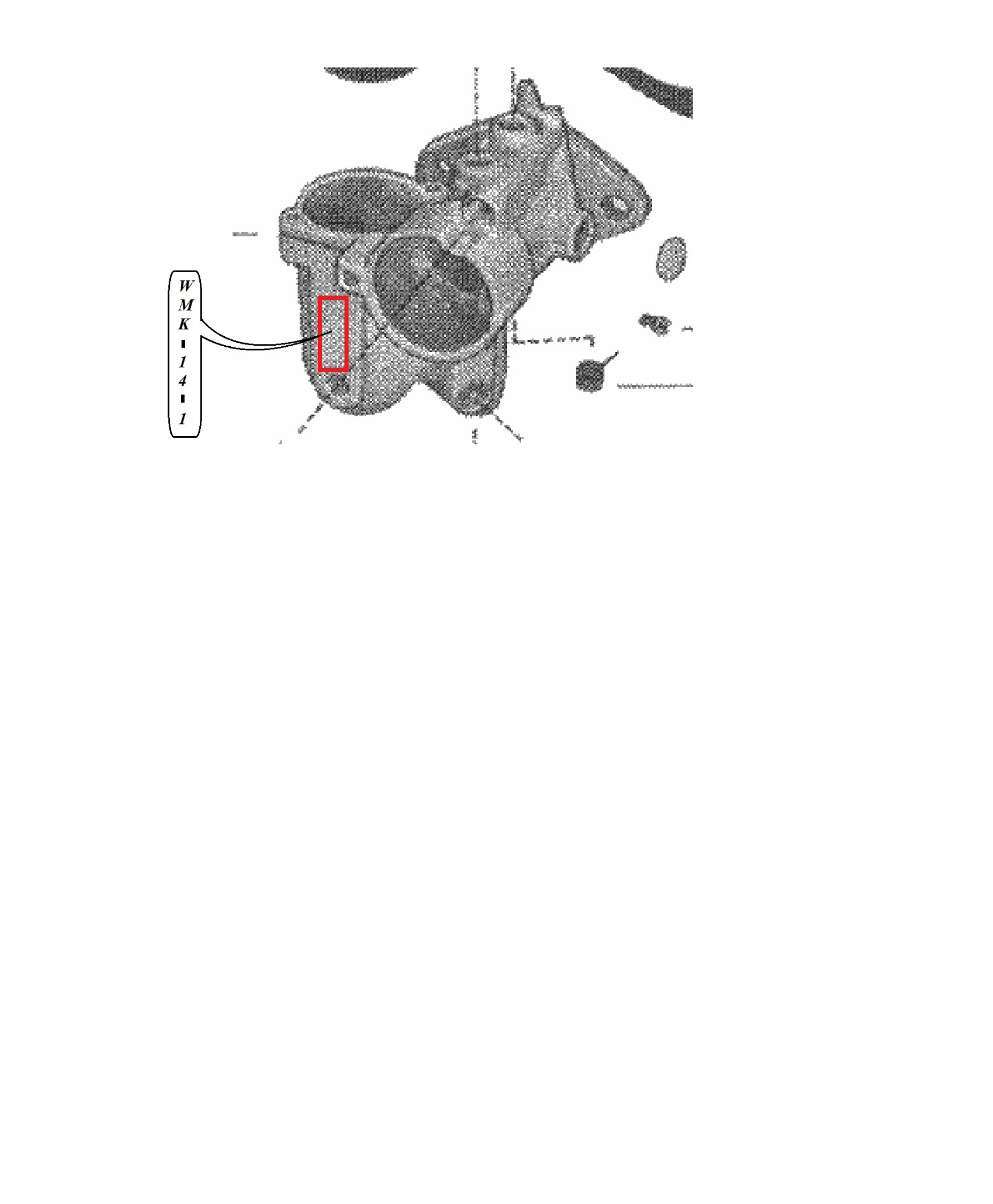

Check the carburetor ID numbers on your Merc.
They are stamped vertically on the face of the float bowl chambers and start with WMK followed by (3) numbers.
Example: WMK-14-1. The last number designates carburetor placement. 1 (or T on some means the top carburetor, 2=middle, 3=bottom.
To identify the horsepower. or model, I'll need to know what you find where I have "14".
AND,..Your lower cowl decals are from a 1976-77 model 1500, but like so many other inline-6 external parts, the lower cowl fits all model inline-6 and some inline-4.
There will be a test on Monday!! LOL
doc
