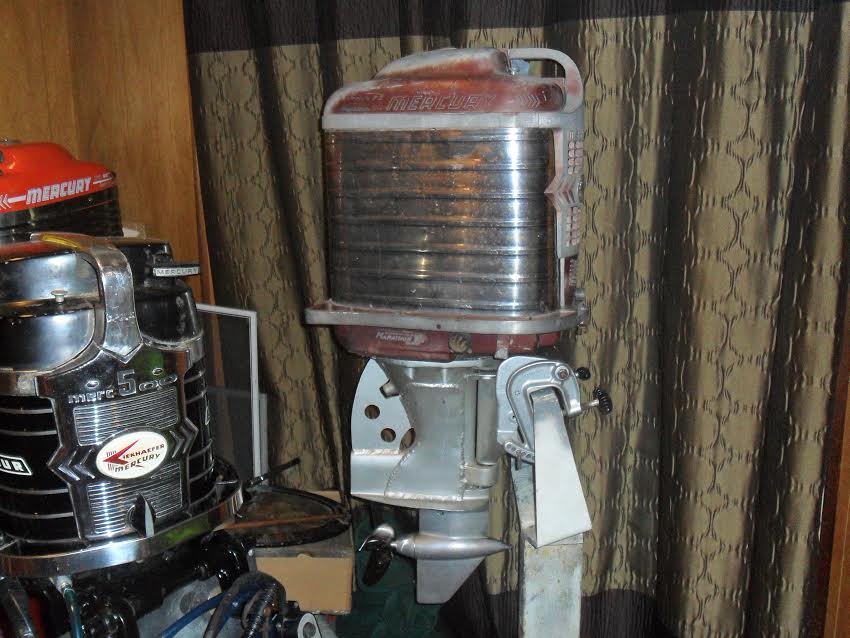

Re:mark 75 progress 11 years 6 months ago #109480
I'm working on one also. Custom.
