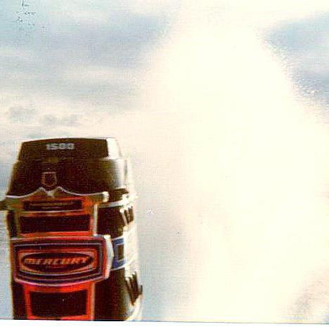

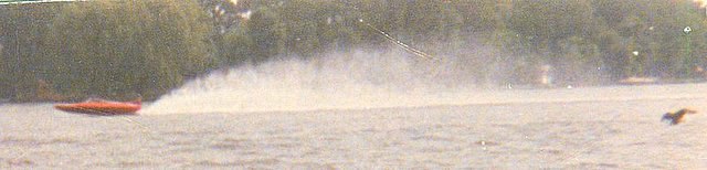

Pete, post that PM ya sent me about the prop grab still I sent ya, as some maybe can learn something. Plus the S+F thread sent about "cup or not". Anyway, My old XS Swit ran 73 with it trimmed out. There was no tilt, just horizontal "race rams" and ran it full full up trim. Surface prop, 14x28 SS 2B cupped and wish I had more pix it. The gearcase was 1/2 out the water and that slapping 2B? REALLY tore up the nose cone end the shaft bearing carrier Even drilled and set screwed in to hold so at least I would not lose the "guts" as M/T cases easy find and not that expensive as compared the price the guts! Went through two before sold..(dumb DUMB move!)
But. heres a pic it. See the taller tail smaller spray, and below that ya can see the thrust off the surfacing blade"? "Props and boats are a WEIRD science, "and I like it!" And Pete? Again thanks as for me sending you that prop? I asked a few bucks for prop and shipping. Pete, your a honest man as...(guys, he's sending me TWICE what I said asked)!

Ya know? Looking at that first pic the "tail"? I wondering if that little spray off top the tail is from the cup in the prop? And as hard to see the real thrust off the slapping blade out the water now. Seeing it real time people on shore said "man ya shove a better Tail than a jet boat, nozzle up!" And NO "squirt boat could get near me either! Had a LOT of fun in that boat, 30 PLUS years ago!
