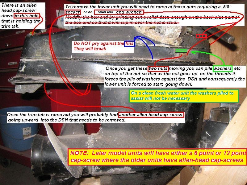

The lower unit will already have s 20" driveshaft and uses a stub shaft on it to obtain the 25" modification.
I have seen a 25" driveshaft in an inline-6, but I believe it was a modified 20".
The unit will also have a unique set of studs, water tube extension, shift shaft extension, and exhaust tube extension that you will be removing.
If you end up with a complete extension kit, it is easy to sell.
I have attached a picture showing how to remove the lower unit.
The picture is of an older unit, but the instructions are the same.
doc Frankenmerc

Oh I like the "how too" sketch tips on a picture. Says it all on one page I honestly have spent hours researching how this is done, if I should give it a try without destroying this sweet 115 Tower of Power Thunderbolt Ignition!!!! It has served me well and now has moved and gets to push a smaller 17ft Larson Sea Lion.
Now how cool would that be to have the modified drive shaft with the extension kit. I'll keep my fingers crossed because it looks to me, how I understand the Seloc manual, (Prefer Clymer)that you have to pull the propeller shaft assembly to remove the drive shaft...Im curious is that true?
more
Re:1984 115 hp lower unit removal 11 years 7 months ago #107623
YEP !
