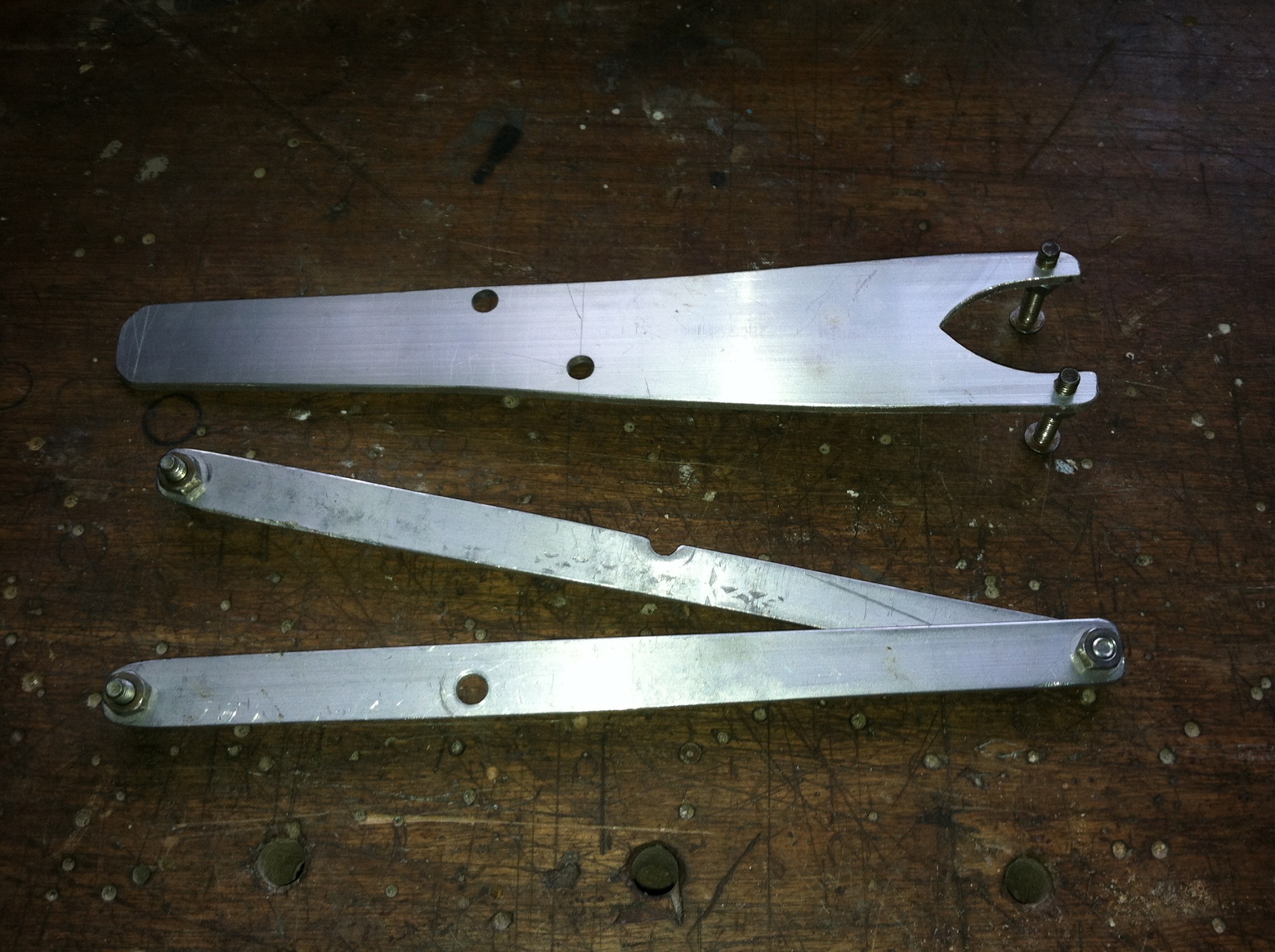

Made some tools to get the impellor cover plate and the lower gear housing plate off. See pics.

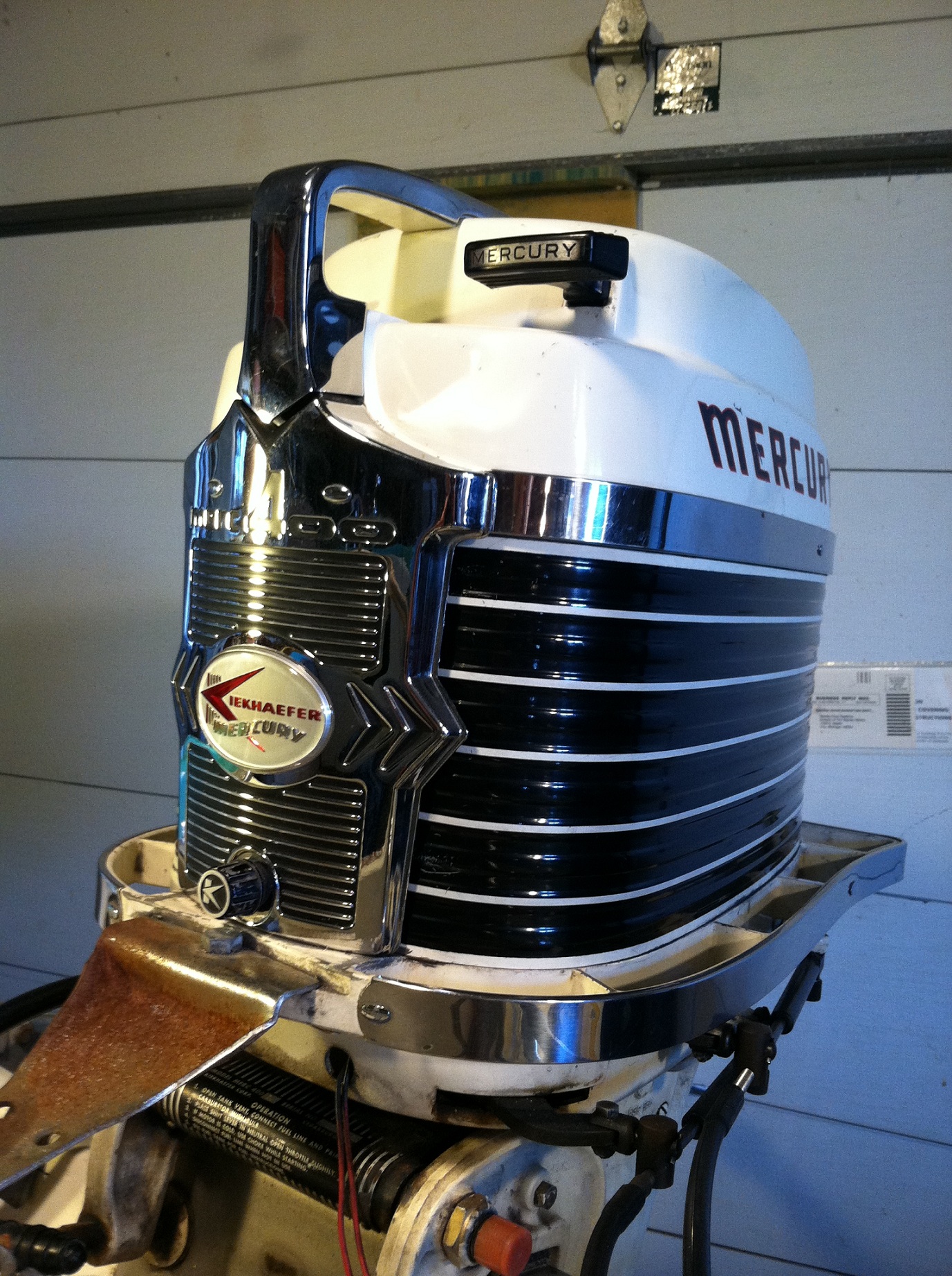

Put the top cover and cowl back on as well after cleaning those up a bit and she looks pretty good if I do say so myself. (Definately going to have to have that stearing plate rechromed now that everything else is looking good.

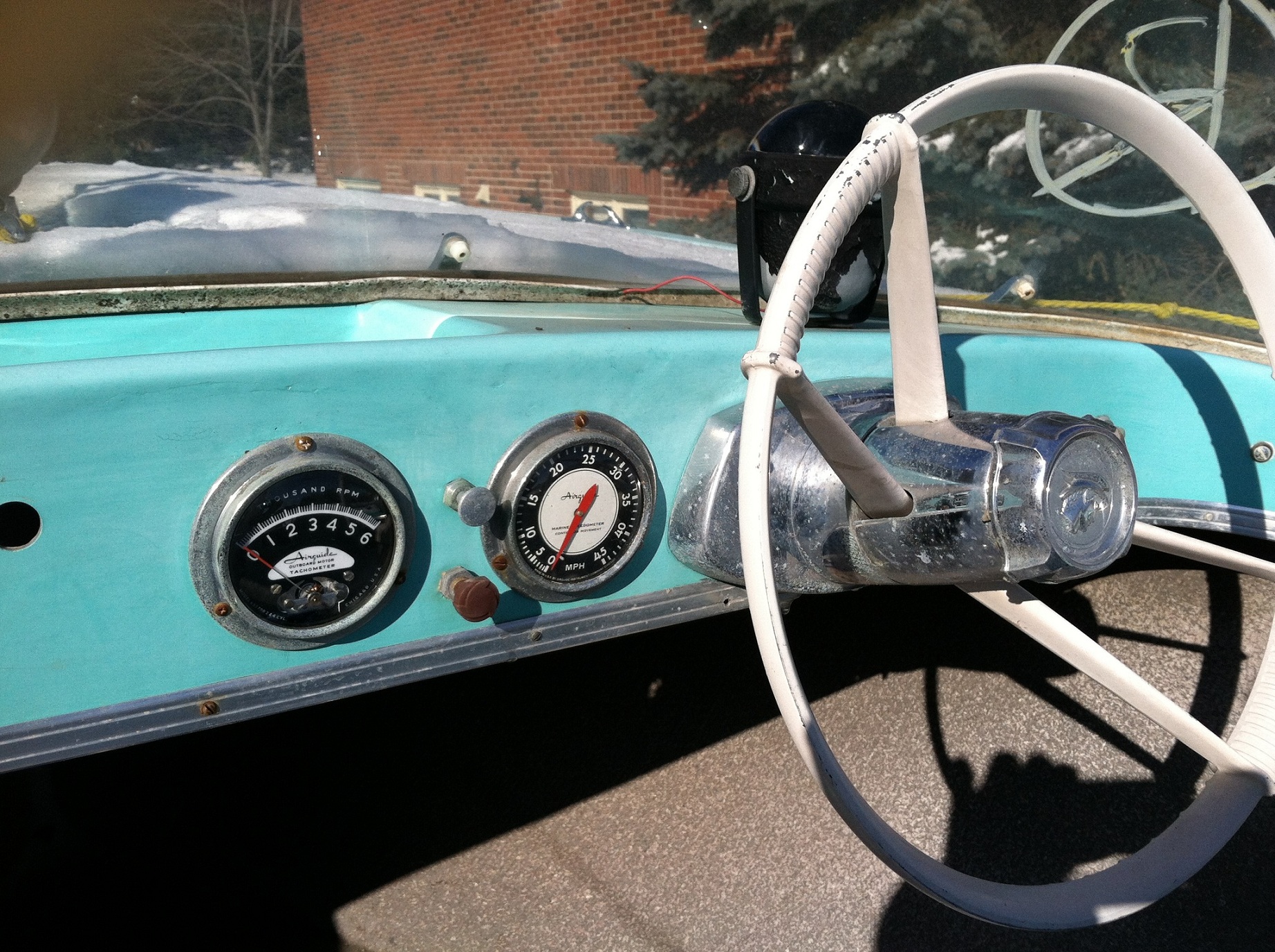

Thanks Hugo. I got the tach wired up and got her started on Sunday. She was a little hard to start (I had to put it in forward and give it gas with the main control handle - the small high idle handle did not seem to be enough), but once I got her started, she seemed to run well.

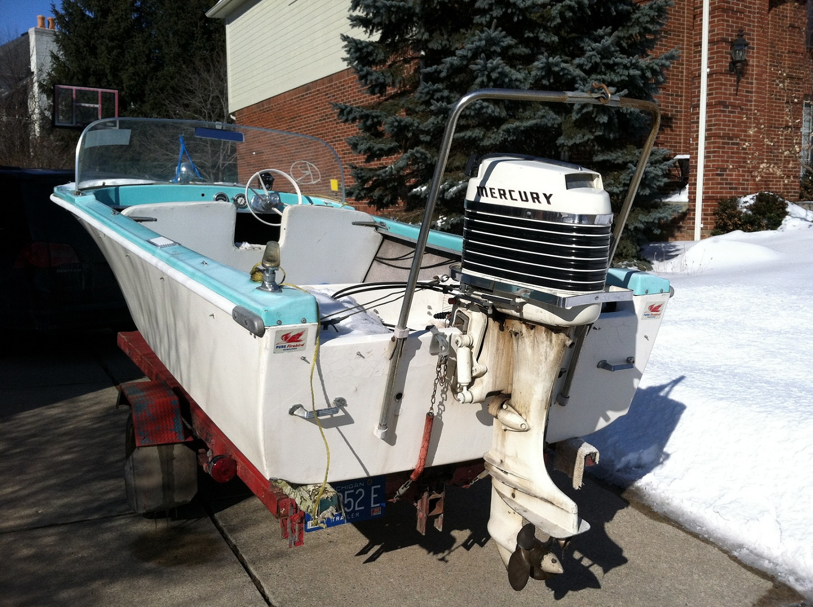

The boat is a 1966 Gad-a-Boat made in Detroit. It has been neglected for a long time, but is cleaning up well.
Sounds like you have quite a collection of the old Mercurys. I'm jealous.

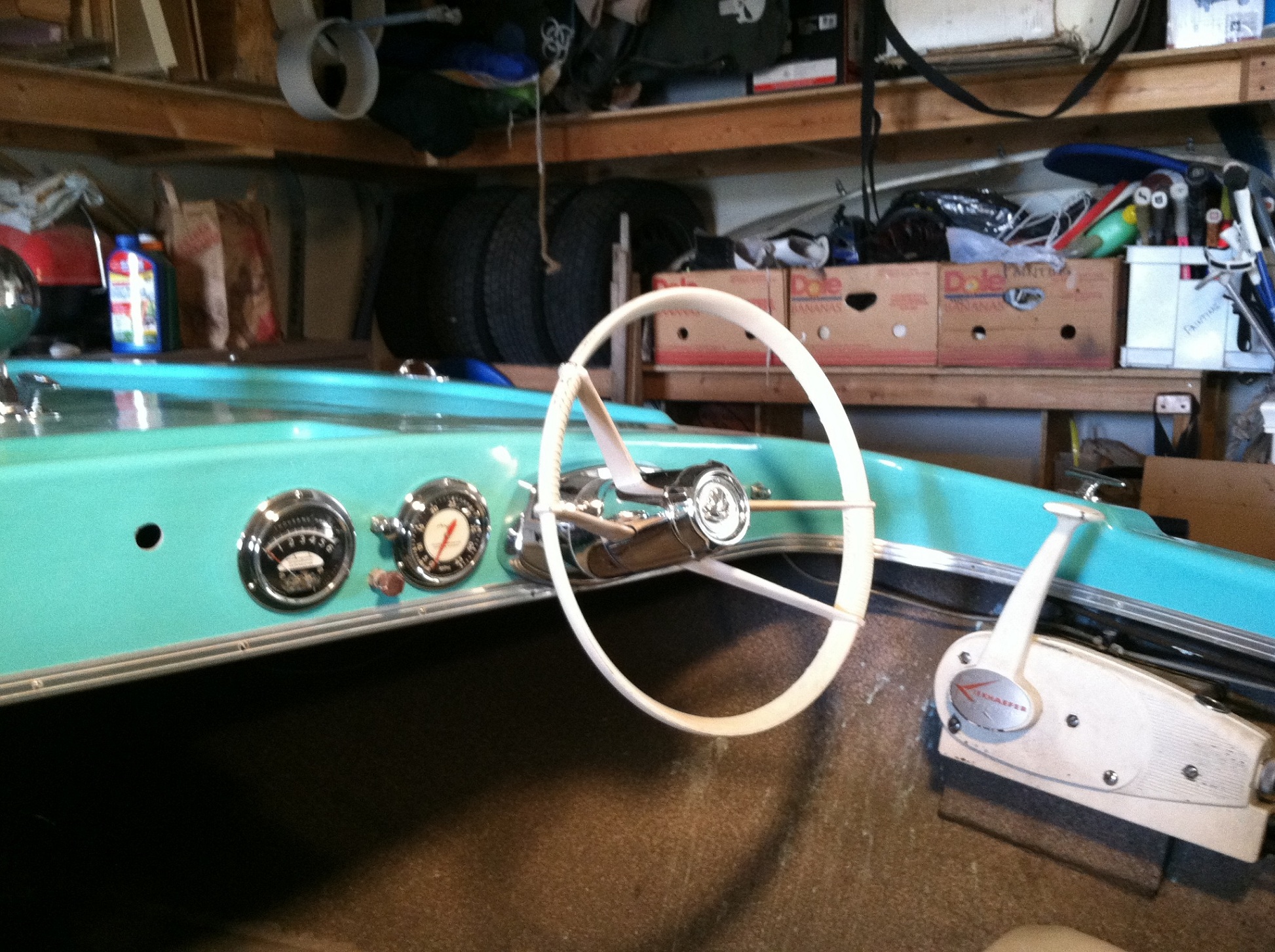

Here are a couple more pics...motor and dash after clean up.

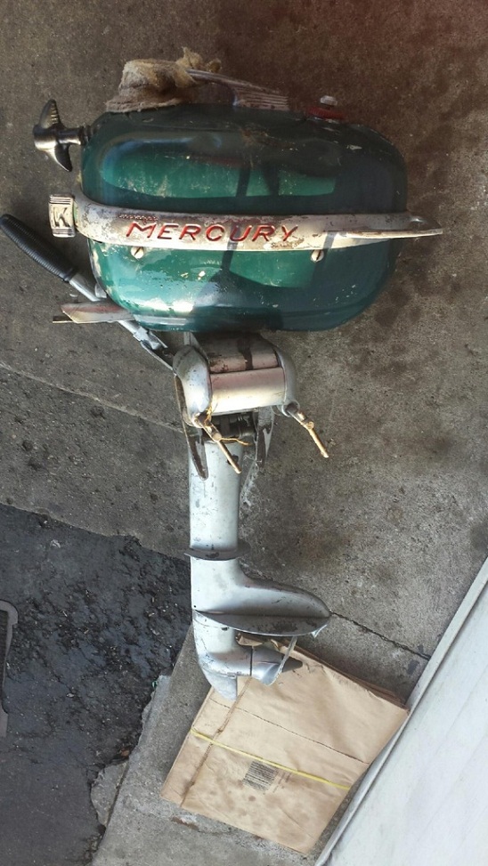

Hugo - did you see the motor I posted in the "Glassifieds". Its an old twin cylinder model. It has a boken tiller, but the guy claims it was running a couple years ago? Who knows of course. Looks like a good addition to your collection.
He's asking $100, but I got the impression he'd let it go for much less. Whats a motor like that worth anyway?

Yes I saw it. I had a nice one last but let it go. For the smaller outboards I am more into OMC's and such. The 4 cylinder's are my main interest in Mercury's, but thanks for the thought.

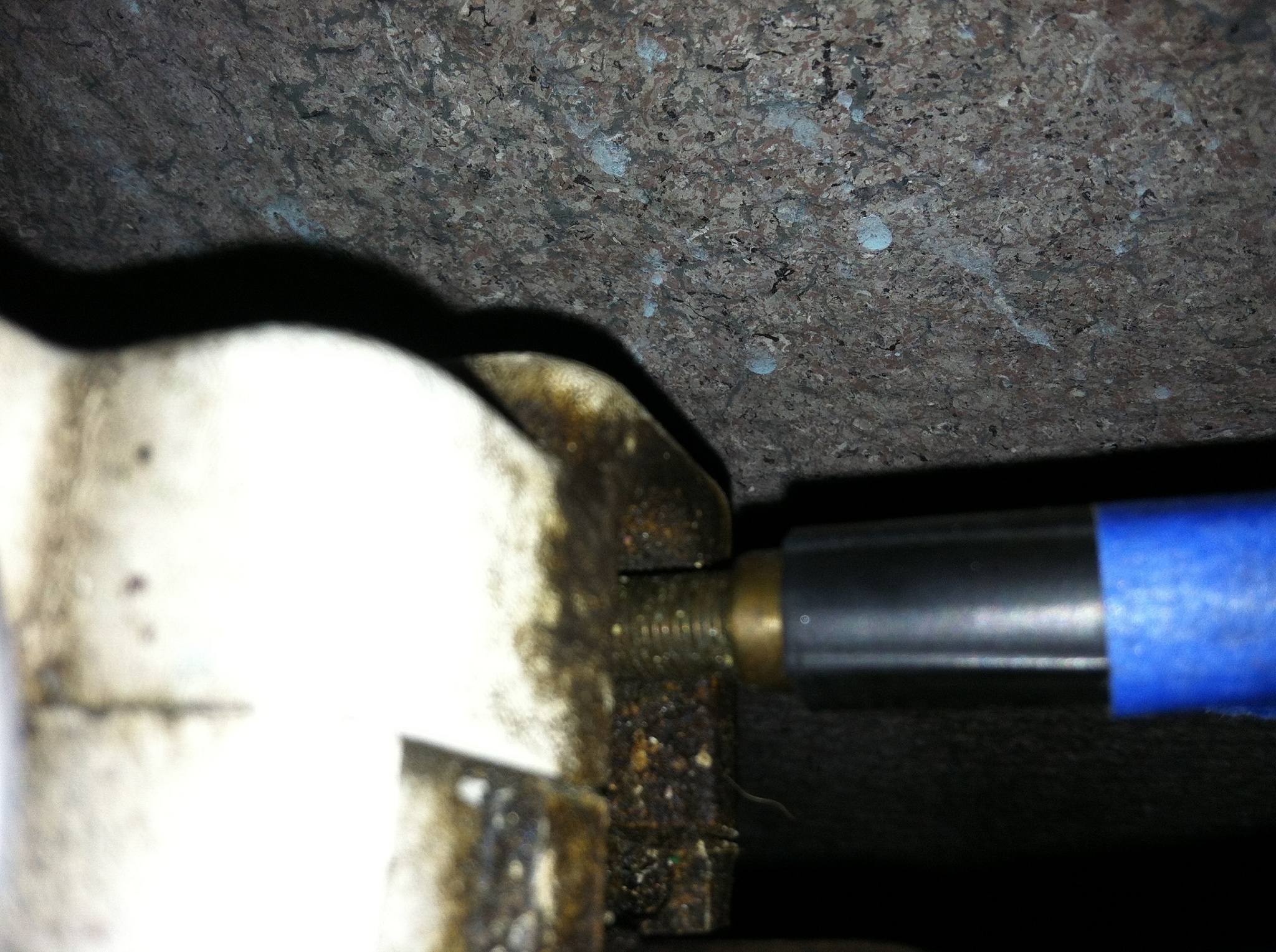

Another question for you all you experienced guys out there. I have a problem with my high idle not being so high. I started to dissassemble the control handle assembly and chickened out once I cracked it a bit and saw how many cams etc were inside. Is it a pain to get it back together correctly after opening it up completely? Is there an adjustment in there anyway?
Also, my problem seems to be that when I lift the hand throttle, the cable backs out of the case about 3/4 inch. Is that normal? Could that be causing my high idle to be more like a mediocre idle? I don't know what's normal here.
There seems to be threads on the end of the cable housing. Should that be screwed into the control housing, and if so, how do you actually do that without taking the whole cable loose on the other end?

"Also, my problem seems to be that when I lift the hand throttle, the cable backs out of the case about 3/4 inch. Is that normal?"
Yes. And don't crack the box open if ya do not where what your doing. Pretty convoluted! Can't help ya much rest with seeing a vid or pictures..

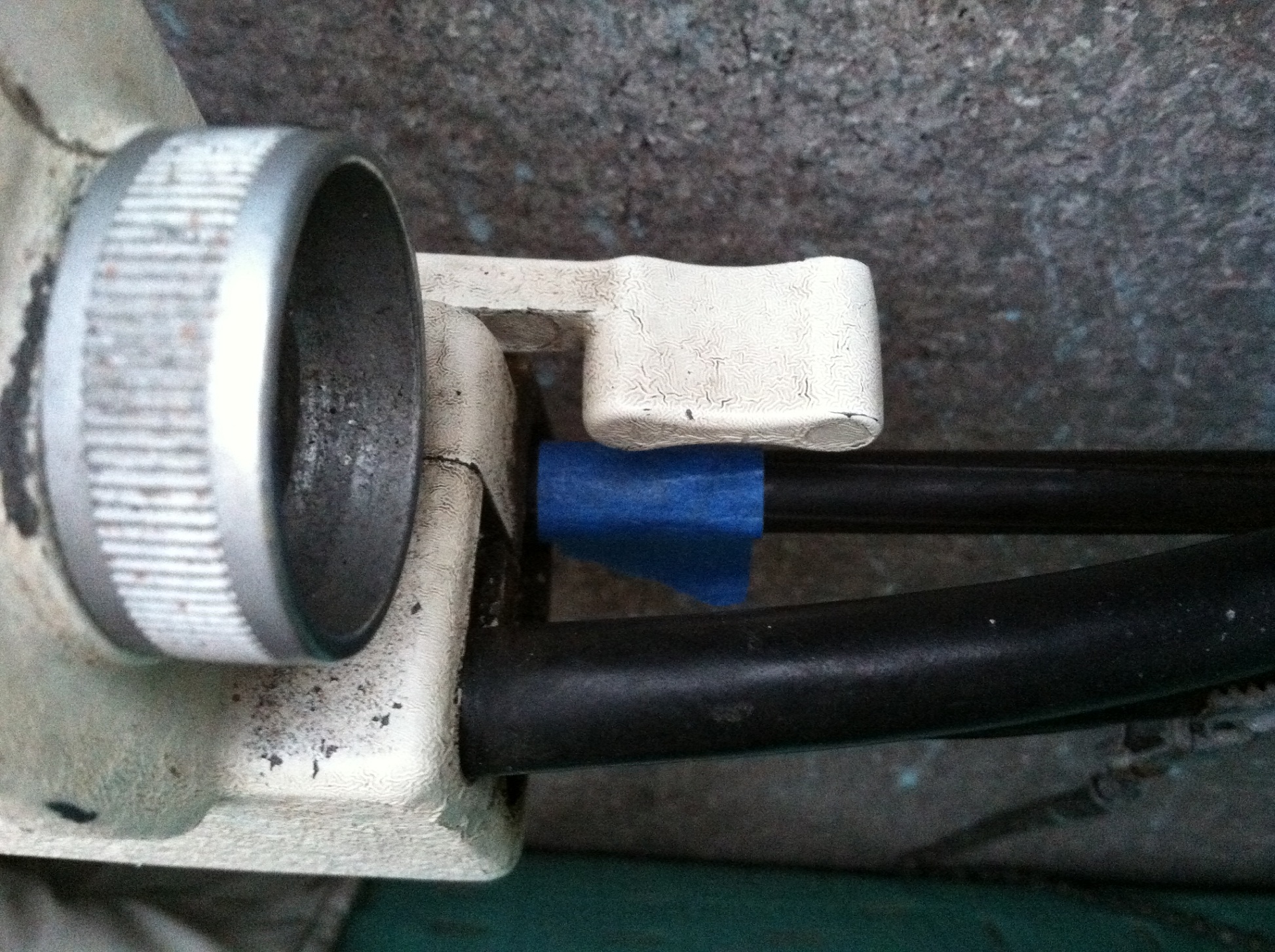

Here's a pic with the hand throttle closed - blue tape added for visibility - tape is against control housing
Re:1960 Mercury 400 11 years 6 months ago #108447
Couldn't Edit and add another pic for some reason, so just did a new post...

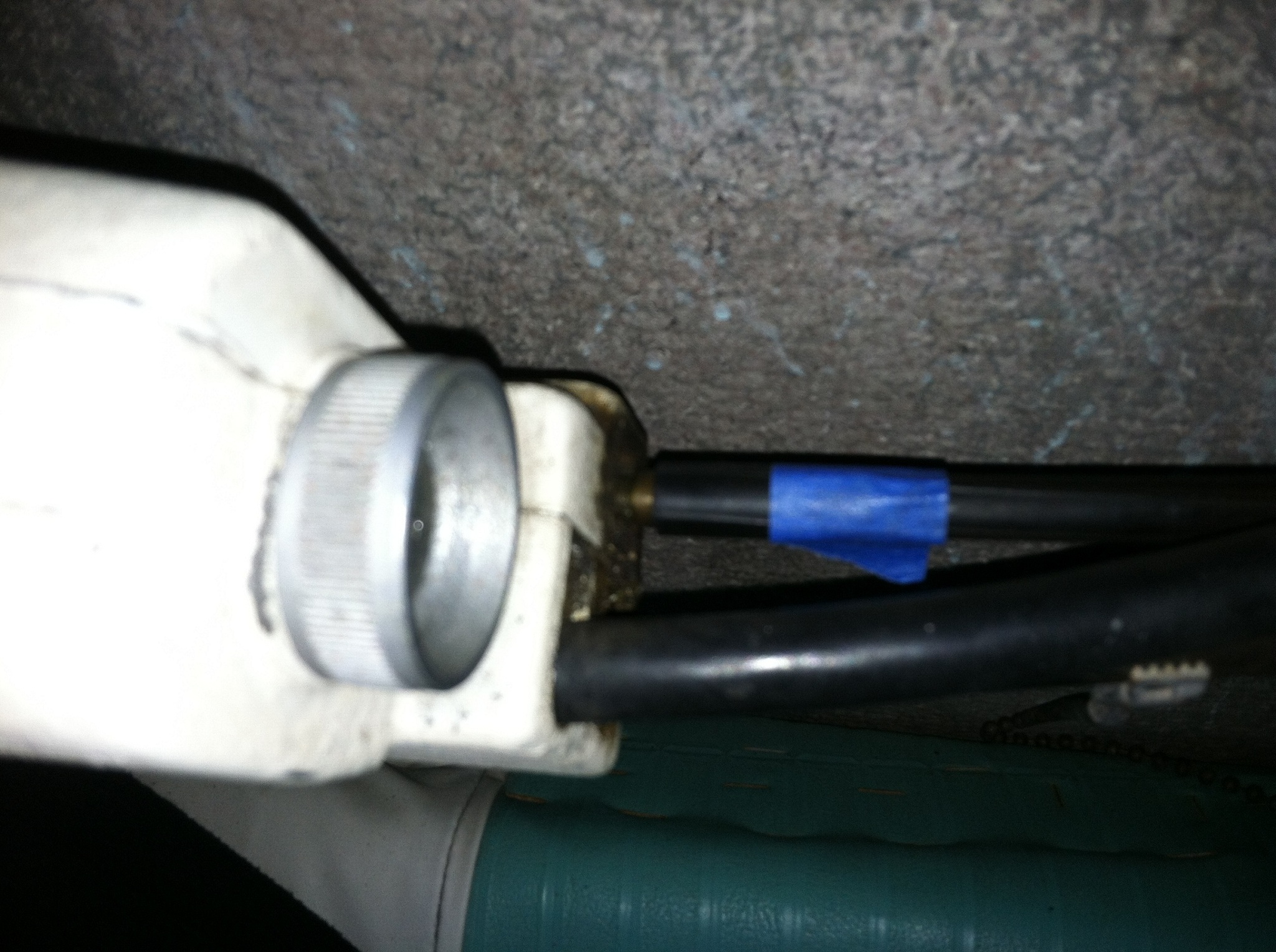

Here is a pic with the hand throttle fully open - cable has moved rearward about an inch. Butterfly in carb is just slightly cracked open.
Here is a close up of the front of the cable. Fine brass thread is showing. Shoud this be screwed into the housing, and if so, how do you accomplish this?

Like Robby said, don't open it up if you don't have too. I have spent a lot of hours with 4 units making 2 good one's. They are hard to get a handle on how they operate.
My Chrysler controls are sooooo simple and work so good, why can't they all be like that?
Re:1960 Mercury 400 11 years 6 months ago #108553
Hugh, I hear you - don't fix it if it ain't broke.
Re:1960 Mercury 400 11 years 6 months ago #108593
Yes. That motion is normal on this style control box.
- and -
Opening up this control box for service can turn into a small can of worms if you are not careful, but it is no where near as complex as some of the mid-to-late 1980s control boxes.
doc

Thanks Doc. Good to hear that this is normal.
