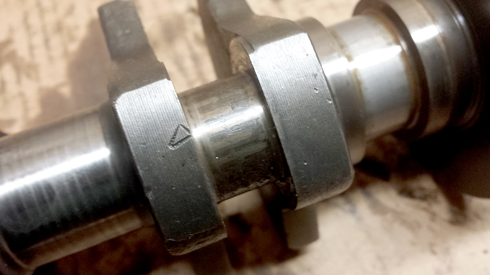

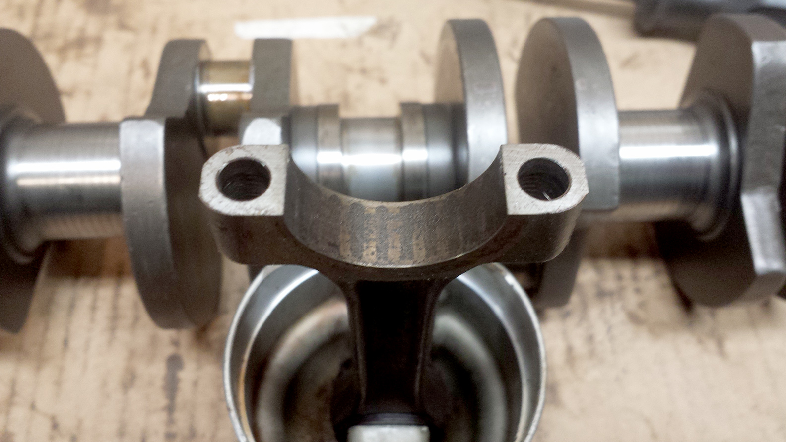

Well, I might be hozed.... Opened it up tonight. Every journal shows signs of water. 3 of them are pitted badly. I think this motor was under water possibly before I purchased it. All spark plugs look used and normal. No steam cleaning action, which you would see if it had a water leak.

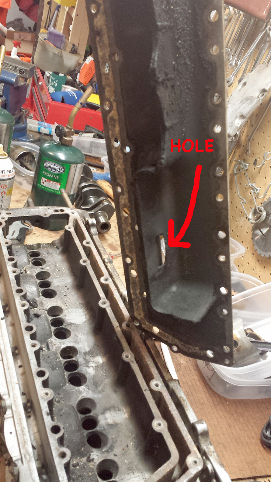

hole in one. inner plate let water into cyls. bummer

Yup, she got "steam cleaned"!
Maybe check with Doc Frankenmerc, he probably has a decent 70hp Dockbuster crankshaft kicking around. At least the pistons and rods are commonly used in 700 FGS models and 44-cubers.
