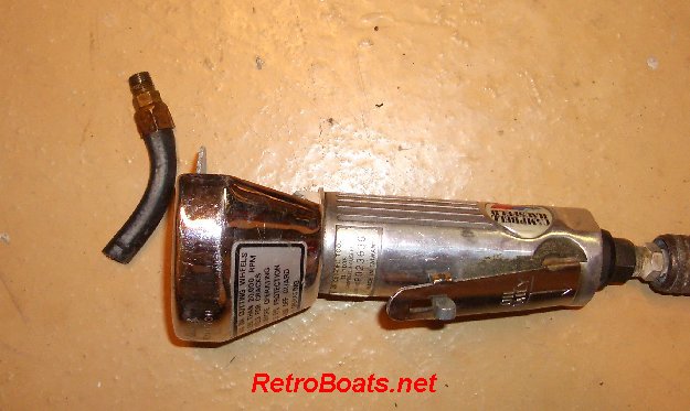

Re:Mark 75 found 11 years 7 months ago #107089

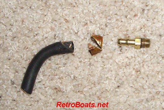

I think the fuel hose fittings can be reused if you carefully dermal the crimp off. Then put a hose clamp or some other compression fitting back on it.

if your not looking to make a restored show quality engine... i have been using PEX clamps for all my fuel lines... i use these clamps on everything with a metal fitting..
and the tool...

Don't know if this well help or not on fuel lines, but in my Merc stash of info.

Thanks for the fuel line tip. Those pictures really helped to visualize what is actually under the crimp.

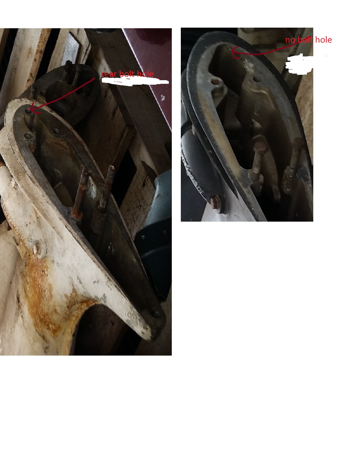

Hey All,
I started looking more closely at my lower unit parts this past weekend and I noticed a difference between the Merc 600 lower unit and my mark 75. The difference is a 3rd rear mounting stud at the back of the lower unit. The 600 has it, and the mark 75 doesn't. All of the lower units I see pictures of for dockbusters all have the 3rd stud.
Does anyone know at what point they changed? It looks like all of the other holes will line up between the merc 600 and the mark 75,so I assume I can run it by removing the rear stud?
here is a picture to try and better explain what I am talking about.
Re:Mark 75 found 11 years 7 months ago #107380
The 1957 Mark 75 didn't have the front stud, but the next year Mark 78 did.
The parts break-down for the '58 Mark 75 & Mark 78 suggest that they all had a front stud, but I don't have a '58 Mark 75 to go "hands on" to confirm this.
If the distance between the other (4) studs measure to be the same, and the driveshaft placement measures to be the same in the two drive shaft housings (DSH),...My guess is that you could remove the front stud from the 600DR lower unit and use its lower unit on the 75.
You can't simply drill a new hole in the Mark 75 DSH to accommodate the extra stud, because of the way the reverse lock rod is shaped where that front stud would come through the top of the DSH.
