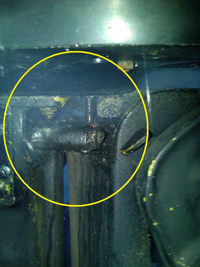

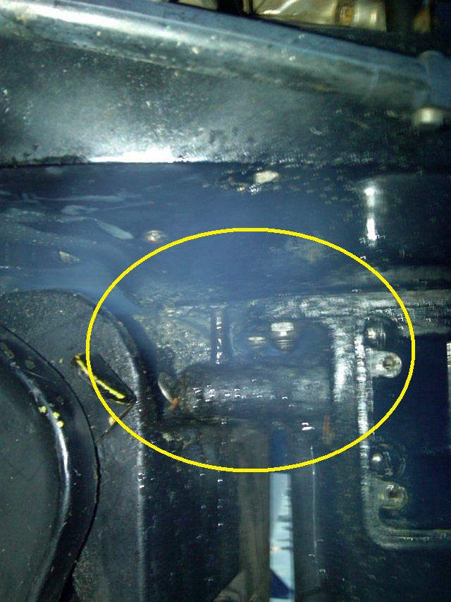

OK - finally had time to go down to the dock and tinker with the motor. I think I found the leak. It appears to be coming from the upper pivot under the lower cowl... see pictures. Any ideas how to fix (translation - without taking the boat out of the water and spending lots of money or tearing the whole thing apart).
There's also water gurgling up along with the exhaust from there as well.
And to answer a previous post, yes, there's a hole on the bottom of the lower cowl under the carbs and you can see when the exhaust smoke makes its way up there, the engine definitely behaves differently.

Exactly Nessman! just like my 500 did. Exhaust comes out that top swivel shock area and leaks right up into the carbs messing up your idle.
I belive to get that o-ring that is bad on each side fixed the darn block and leg have to come off.
THere is a rubber oring type seal that seals that mount area to the leg. Either it rotted out or was forgotten on re assembly at some point.
This year I took some carb cleaner and cleaned up that area well so that RTV/Silicone could be made to adhear to that area. Its a hard area to get silicone in to but it works as long as its clean. Mine I think will last years until I decide to pull it down to replace the seals.
