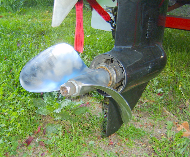

I want to give an update on my set up (work in progress) to those interested and would gladly accept any and all critiques or advice.
I mentioned in my other post that I raised the motor 5/8". Here is a video of the 23" pitch prop at that new height. Got a little faster than last time.
The boat settles down at about 47mph. Still trying to figure out the tach (you can hear me call out rpm numbers periodically).
Thank you for looking,
Pete

You are getting there. Try a 21 incher and get the revs up. Engine does sound like it is lugging somewhat.

The bouncing/hopping is the boat trying to get fully "on the pad". You want the bow to be slightly up with the engine at neutral trim, as in having the cavitation plate running as close to level with the lake surface as possible. This gives maximum engine thrust to achieve the fastest speed. Setback and weight shift are the methods to get ideal setup. Once you figure out the lowes and highest speeds where the hopping occurs you can try minor setup tweaks to narrow the range a bit. On the negative side, it means lots of testing. On the plus side, testing means water time. Keep us informed, and if possible, have someone on shore take a pic of the boat at speed. Trim angles felt in the boat can be deceptive, so a shore shot can be revealing. Happy boating.

Very good advice, I do have a 21" and I'll give that a try. It's a 2 blade, so I was hesitant to try it.

Remember that Mercs love to rev, and you will not get the full rated horsepower out of that engine until you can achieve redline at WOT. I think a 21 will awaken the beast, and give you a better holeshot to boot. Don't be afraid of the two bladers, I have them on all my engines.

I ran the numbers. Id say your turning 5000-5100RPM and thats about what Id say it sounds like too. I use .09 for slip as a baseline for the calculator most of the time.
21 pitch would probably be pretty good. and get you into the 5500-5600 where that motor will be a bit happier.
A good 2 blade brass prop will be nice.
But modern 3 blade props like Laser II's and Choppers will out perform the old brass most days of the week.
Aluminum usually does not do well for speed runs. Test as many props as you can get your hands on. A 20 or 22 chopper. Or Laser II would be nice .
If you have a water pressure gauge start raising the motor up as well.
