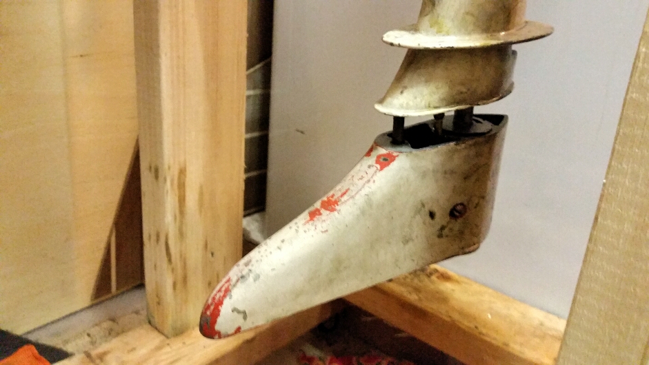

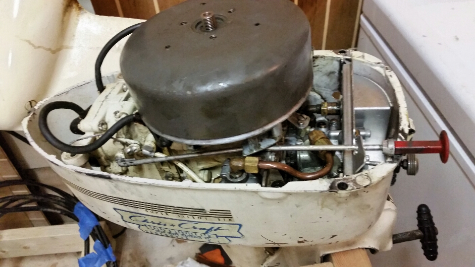

I'm starting to take this baby apart hopefully I can restore it but I'm having a hard time removing the power head. I got as far as taking the big bolts in the center out and the leg is pretty stuck I can't pull it out.basically I just want to remove power head to paint it and remove legs to do the impeller. Any help from the pro would be good cause I have no idea what I'm doing.
Re: 1959 merc 6a what to do now? 11 years 8 months ago #106110
loosen the shift cable and it will come out.(2 screws)

Re: 1959 merc 6a what to do now? 11 years 8 months ago #106130
  • commando
  • commando's Avatar Topic Author
  • Posts: 271
  • Karma: 18
thanks,i got that lower parts of the leg off now how do I got the power head out?
Re: 1959 merc 6a what to do now? 11 years 8 months ago #106143
keep working your way up the tower to the power head. the power head slides out of the swivel bracket.
