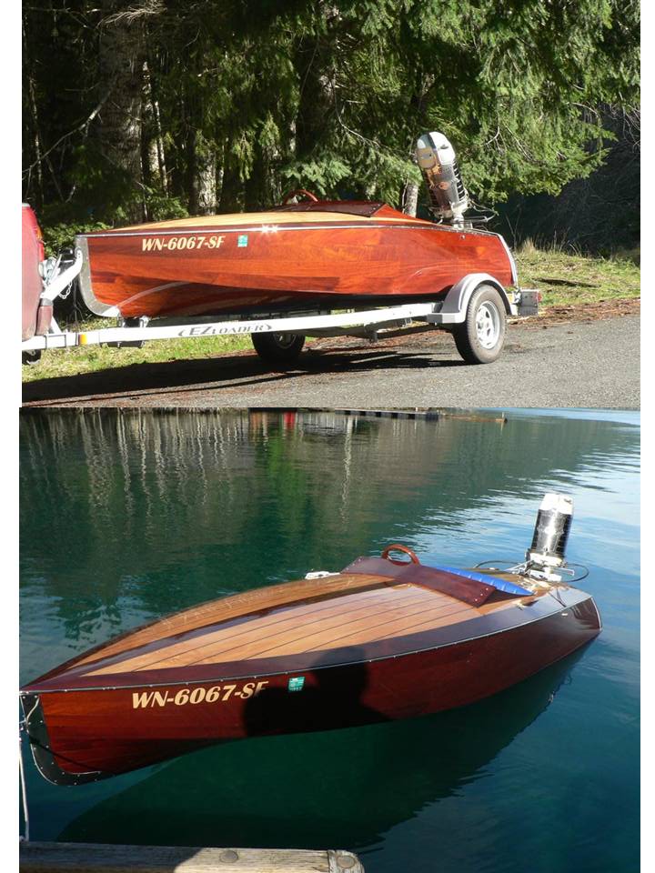

Hello,
Thought I'd post two videos of a boat I just built, as mentioned in the subject line, it's running a 1961 Merc 800 FGS. The videos below are taken at Lake Crescent and Lake Sutherland, both just outside Port Angeles, WA.
The boat is just over 14' long, shallow V with a padded bottom. Planked in mahogany and maple.
I have a 19"P four blade vented aluminum prop on her. Top speed with this prop is just over 42mph which is just about right for this motor.
I have gone 48mph with a 23"P 3 blade aluminum running at 5000 rpm. I could trim out a little further for a few more mph's, just need to get used to the boat.
Darryl of ClassicMercs did the paint job and the whole package is beautiful!
Special thanks go out to Joe at Ferguson Poole Marine - he's been instrumental in helping me finish the rigging of the boat.
Doc FrankenMerc has been very generous with his advice also.

Beautiful boat and a fine Merc Peter, congrats on a job well done!
Re:1961 Merc 800 11 years 8 months ago #106081
Nice setup I would bet it could be tilted out 2 more holes from the look of it . the cav plate should be at least even with the bottom and parallel

Thanks Mark, took a long time (years) and its a relief to finally drive it.

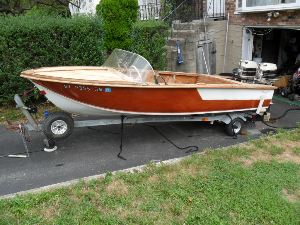

here is a pic of my 1958 16ft Prywing with 2 1962 merc 500's should be close running with yours. should be finished this spring.

pete, I really love the looks of your boat, looks like it is a blast to drive. frog

Very pretty Rascal. I have a set of these plans also.

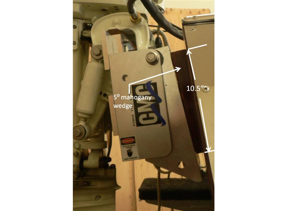

Re:1961 Merc 800 11 years 8 months ago #106141
Pete,
Would you post a pick of your setup with the CMC and where the cavation plate on your motor is set from the hull.

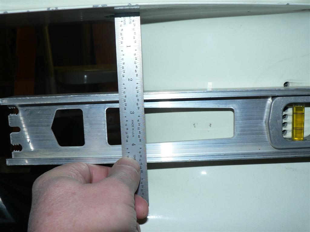

Hi Travis,
Here are a couple of photos. The wedge is 10.5" deep as shown and is 15" wide, solid mahogany. The perspective is odd int the photo, but the top of the wedge is even with the top of the transom and the top of the tilt/trim is even also.
The top of the level in the other photo is in contact with the bottom and the cav plate is about 2 3/8" above the keel.
In the first photo you can see that the tilt/trim unit pushes the motor away and down from the transom. That is why the cav plate needs to be so high to run efficiently - raising the motor gets the geometry back to original, non-setback configuration. It's an empirical thing now and I'm not quite satisfied yet.
I get good water pressure at this height, and I think I can go higher, but need to modify the tilt/trim unit as the motor bracket holes will interfere with the hydraulic fluid sump. Boats runs okay now and I'll save that for later :)
