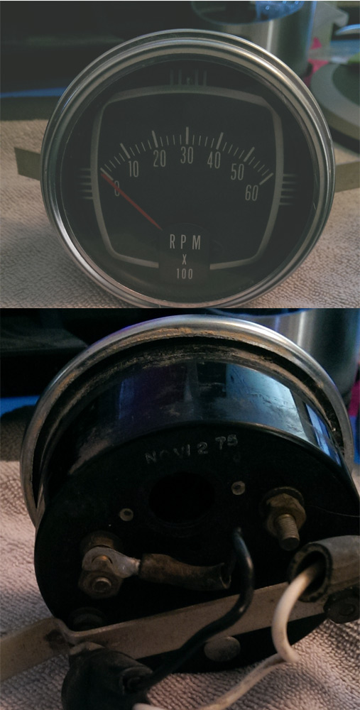

Pulled this tach off my other boat, it says "POS" on one terminal and "NEG" on the other, Does the POS still need to come off the yellow on the recifier? do I have to run another wire all the way from the motor or can I tap in somewhere on the cable or throttle box?
