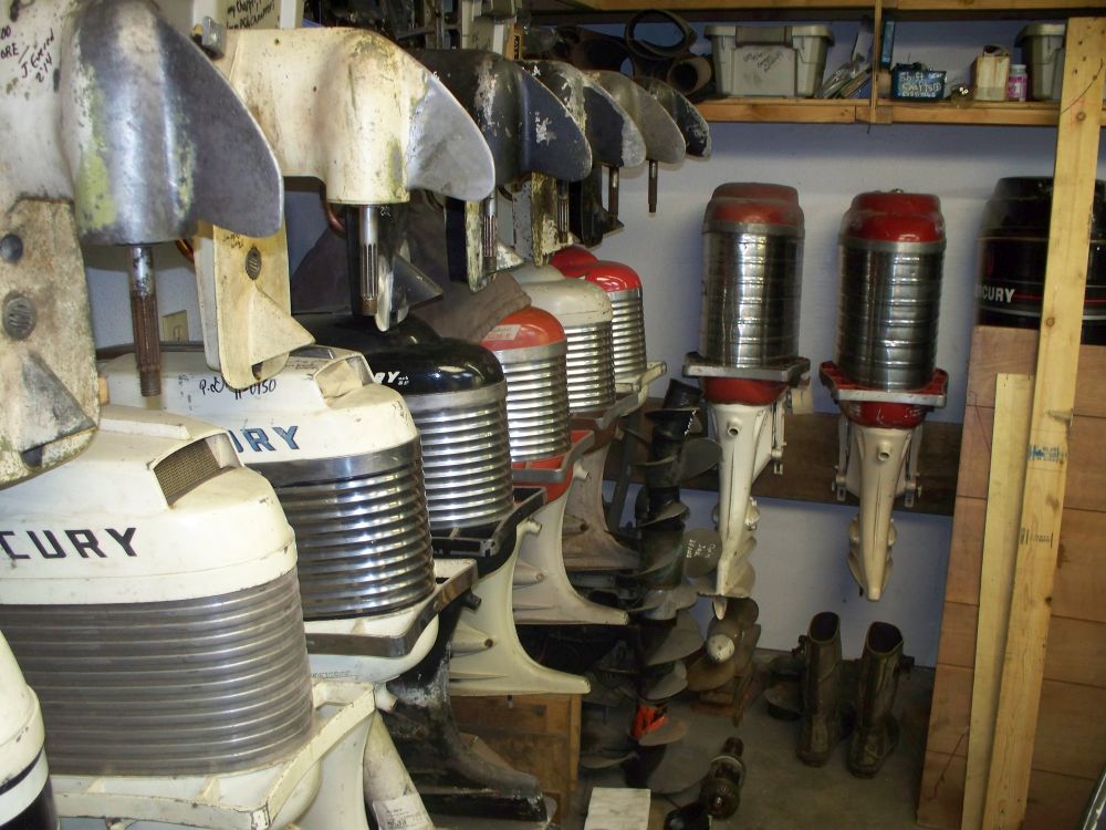

Very good.The 500 Super Thunderbolt is a top engine in the vintage Merc line up and is without par in my opinion. How the Hell should I know? Well, I own twelve of them from the Thunderbolt family, from a 1955 Mark 55 to a 1967 500 and all years in between. The 40 cube engines are known as Thunderbolts, and the larger 44 cube is called a Super Thunderbolt, both have the same DNA.

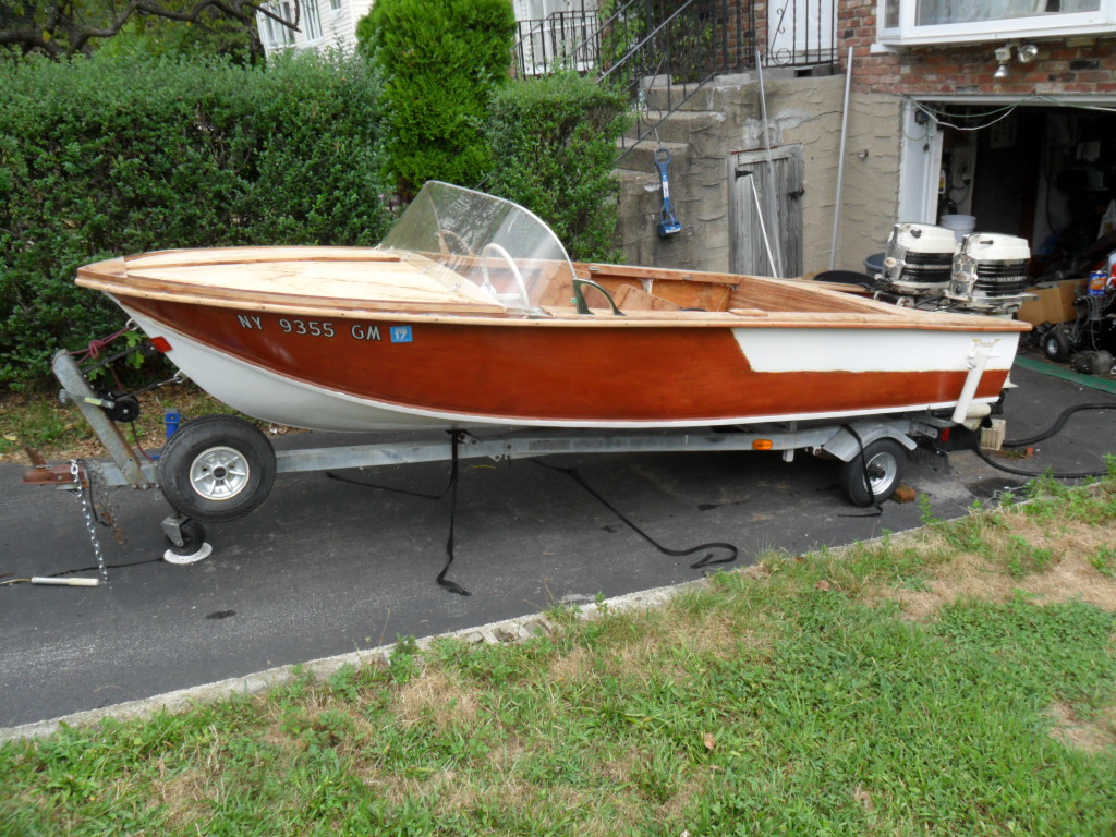

two more 500's on a rare 16 ft Prywing hope to finish this spring.

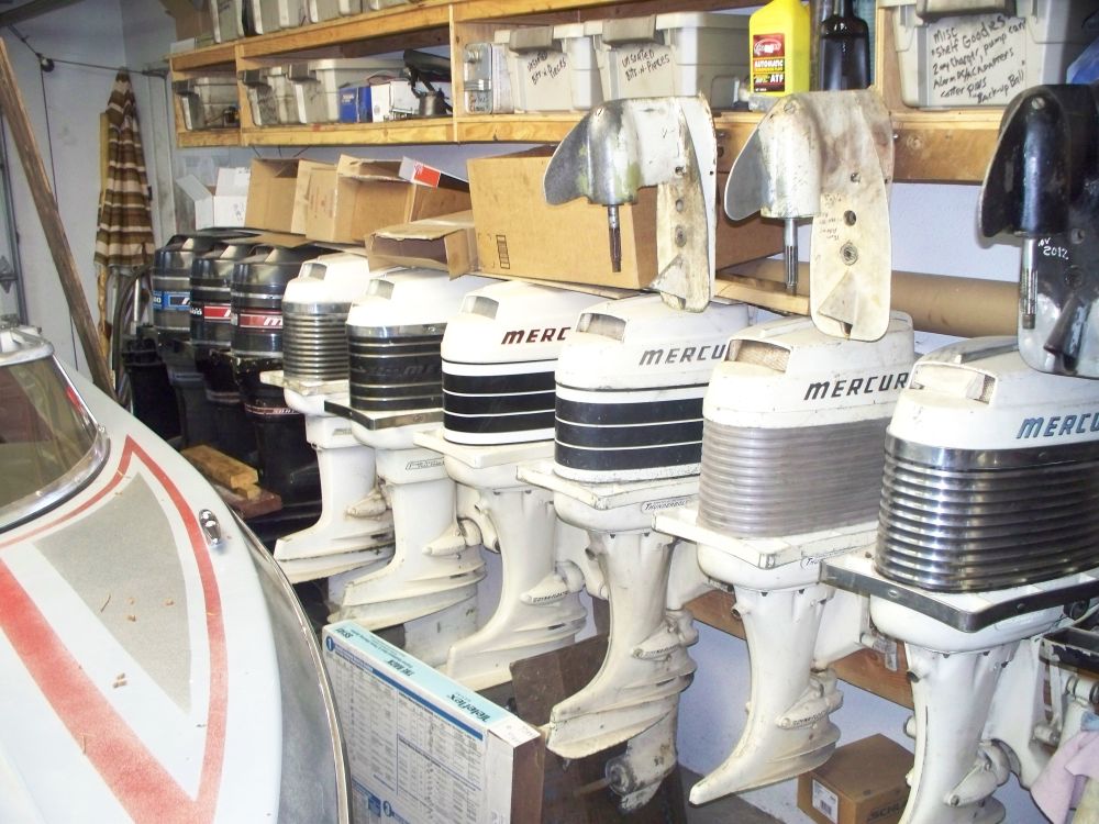

Re:merc 500 missing 11 years 8 months ago #105901
I have a 'few' too :laugh:
