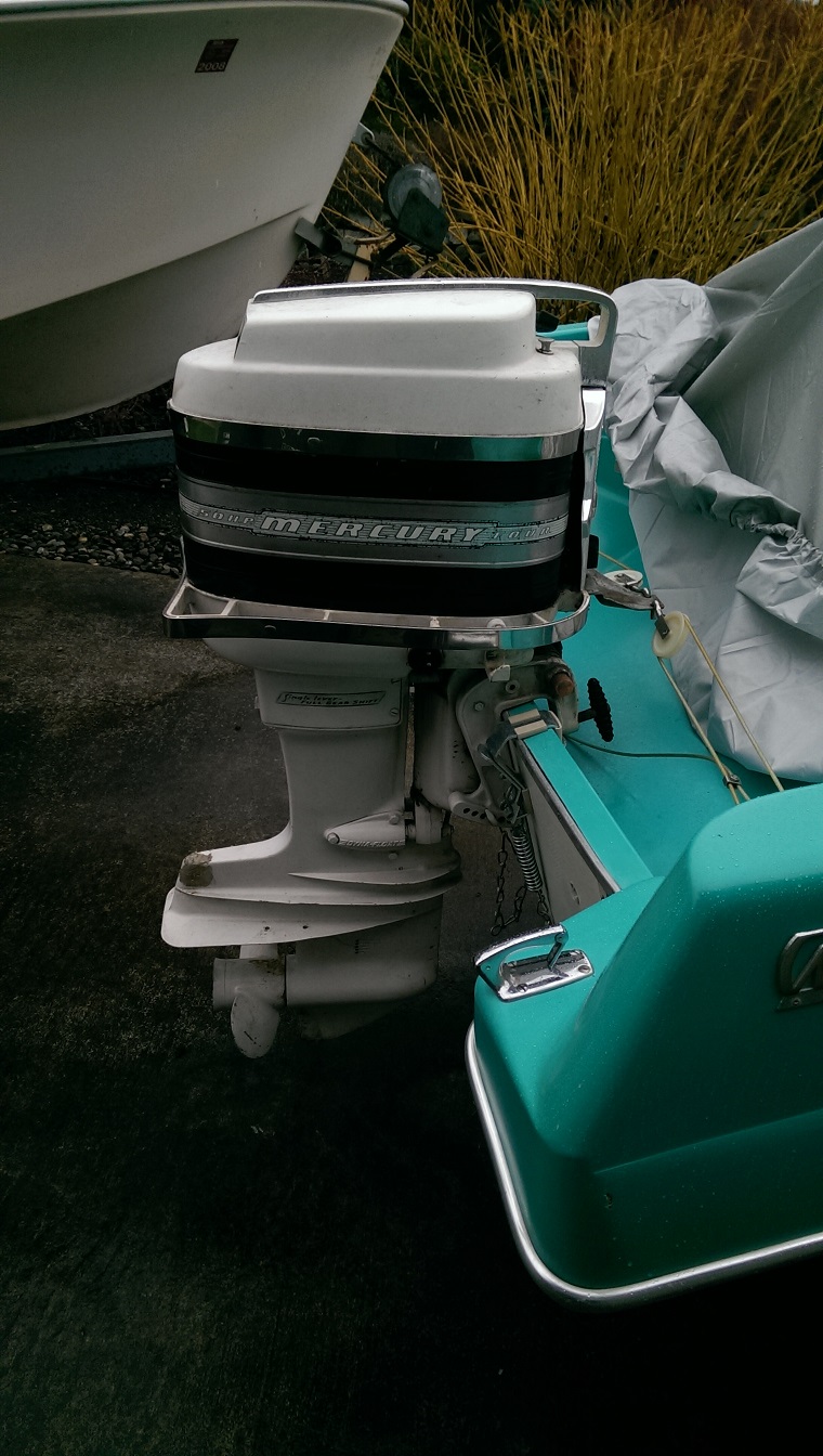

Lucky I got their early, now I have a motor to power my Wacanda and I can get the lower from Doc and fix my 450 for the Pacific Mariner and the 950ss for the Stiletto, hope to have a boat in the water this weekend for my first fiberglassic launch.

Well, you won the Craigslist Lottery on that one! I saw it and couldn't believe they were selling so cheap. Nice, clean motor and it looks like there are a few decent days coming up, weather-wise. Have fun on your "maiden voyage" & be sure to post a few pics, so we can all drool!
