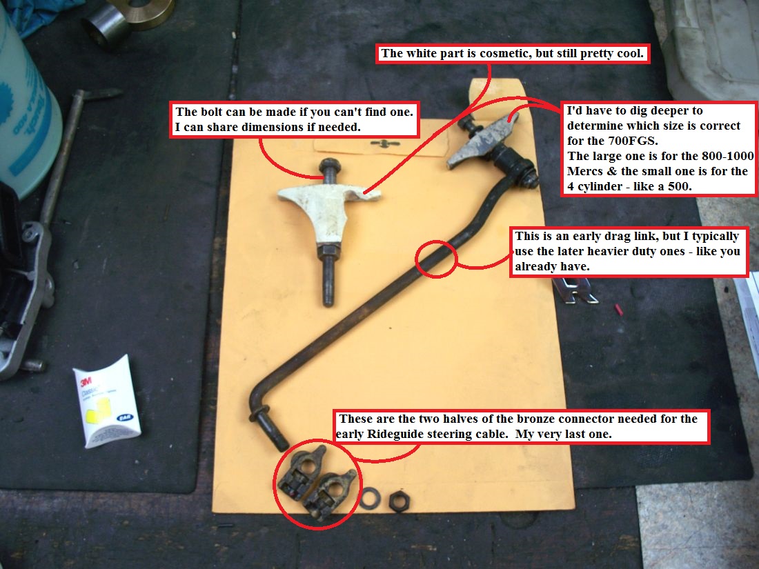

Ok I sort of put it together but didn't tight everything in place yet.can you look at the pic and tell me if I have the stainless rod correct or is it upside down? And what do I need the conect the 2 end together where the green masking tape is.thanks

It looks like you need a first gen rideguide steering rod and grooved cable connector. Your steering rod is a gen 2 style and not compatible. A gen 1 setup is on eBay now. Also regardless of gen 1 or 2 the curved end goes to the cable, flat onto motor. It looks like you have a tilt tube that adapts a gen 1 cable set up to your motor so someone already swapped this out, I think Dave was thinking you needed this but that was before you posted last pic.
You are also missing the piece that bolts to the motor as the steering rod connection point.

I have attached a picture showing the parts you still need.
doc

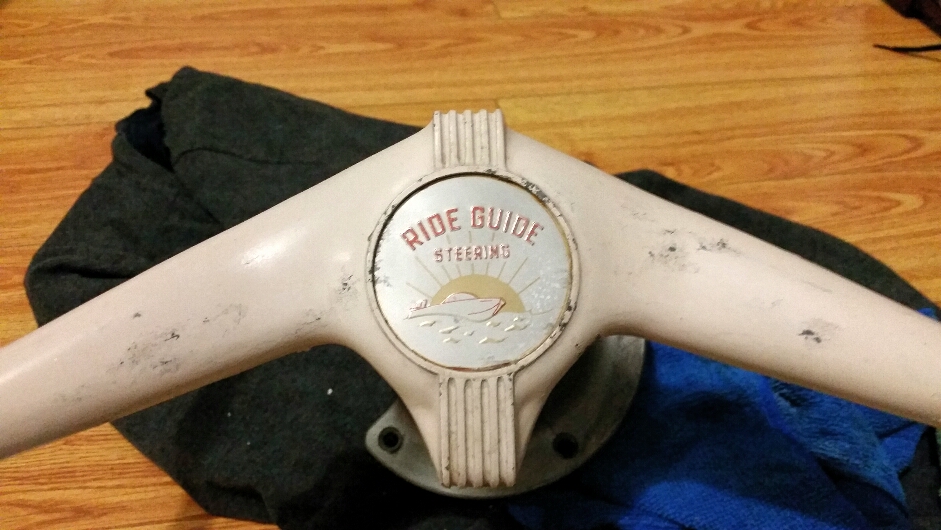

what is the best way to take this logo off I manage to take the plastic cover off but don't want to break the logo And how can the logo restore to orginal look? So the paint color on the wheel is original does this mean the engine in those day is the same color?
Re:Merc steering wheel? 11 years 9 months ago #105105
heat and push the long bolt behind it. just a thought.

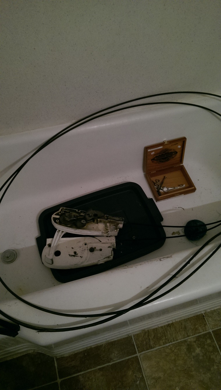

Great find there. Word of caution the way you have that motor in the bedroom use caution when moving they can get away from you, use caution .

that's is our laundry room I just want to keep it close to the dryer so she can be warm.hihihihi

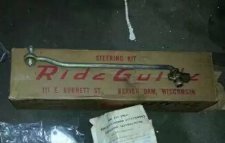

will this work on my steering connection? I think it is perfect.
Re:Merc steering wheel? 11 years 8 months ago #106370
YES! it will.
Re:Merc steering wheel? 11 years 8 months ago #106396
RIGHT ON Bill!!!
You have scored the most difficult piece of the set up.
Now I can fill in the rest of the needed goodies.
Doc
