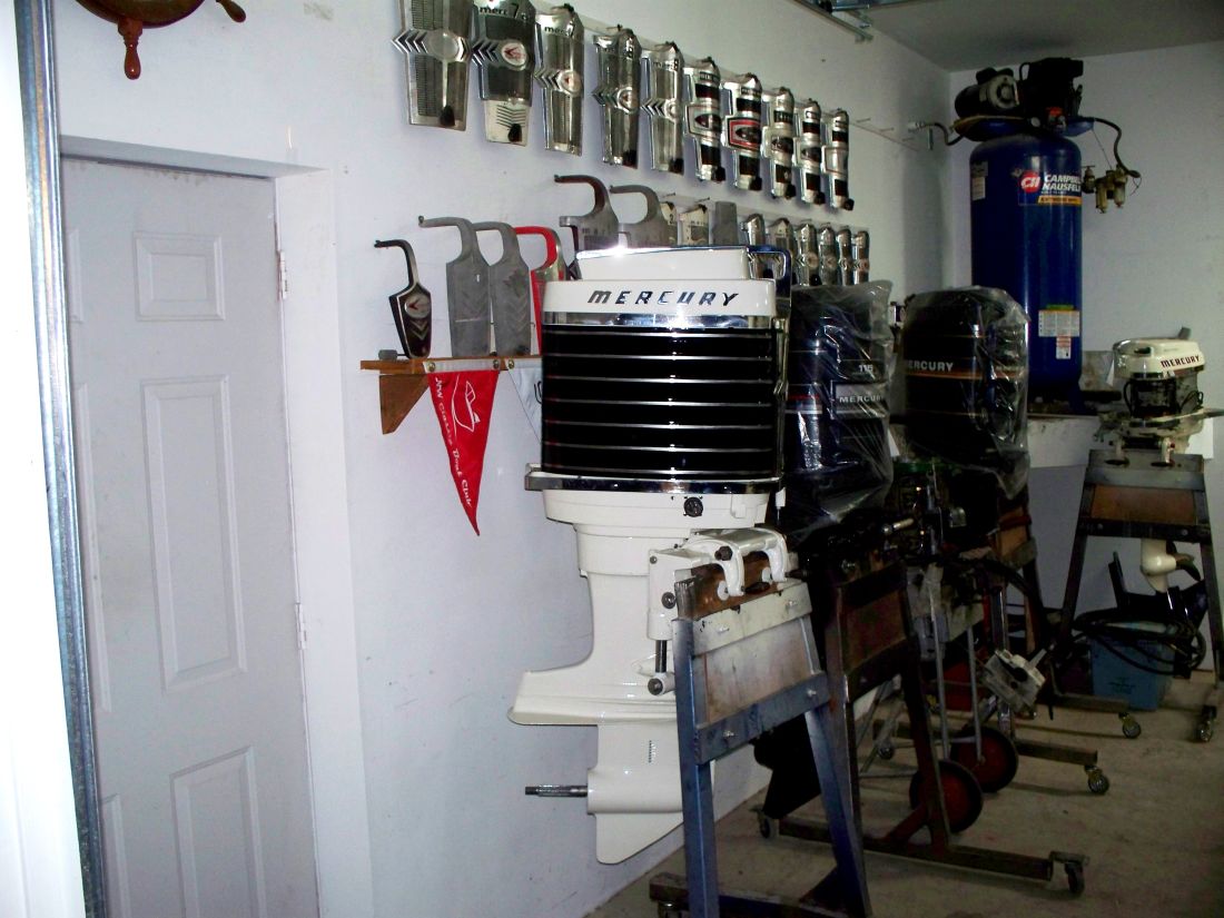

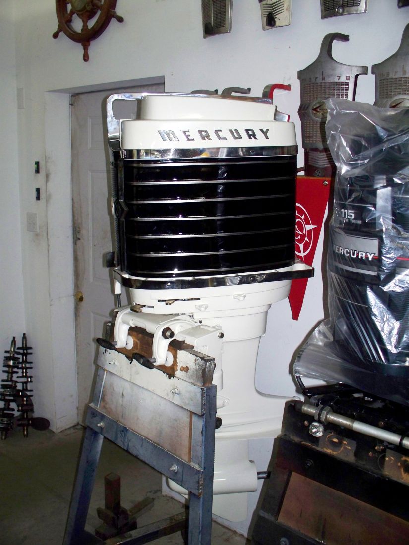

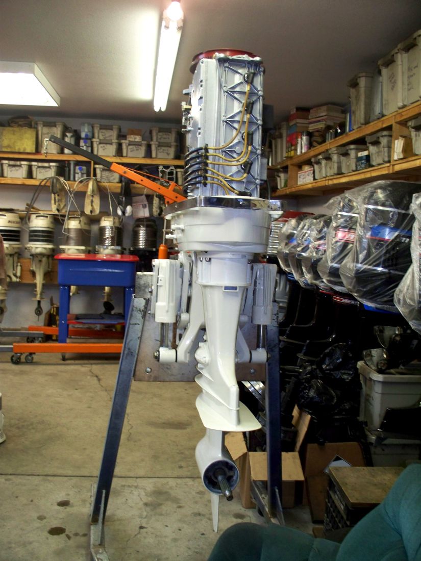

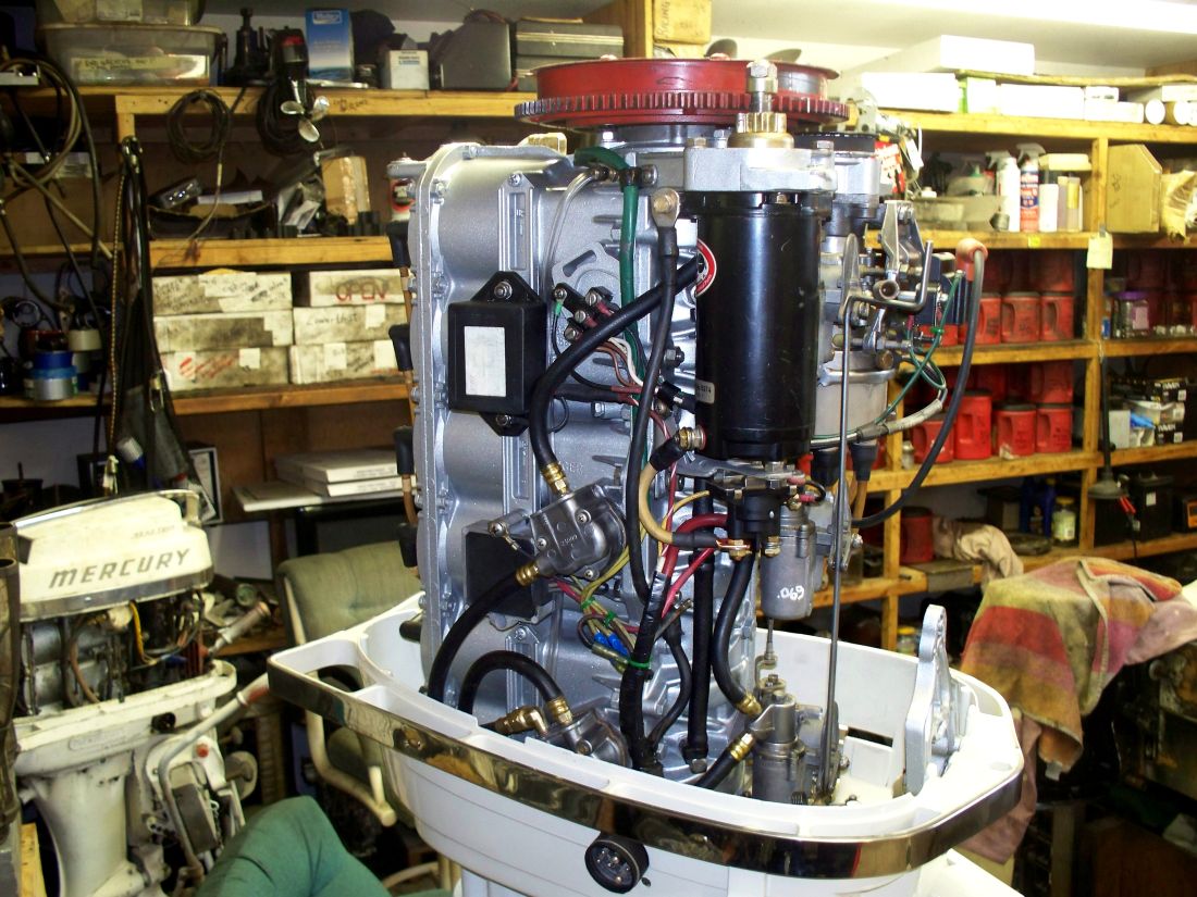

Attached are pictures of my latest Cloud White Frankenmerc.
'61 800FGS cowl wrap, lower pan, and drive shaft housing, early 650-4 cyl lower unit, mid-'70s power trim, topped by an 800DR top hat.
The powerhead is a '64 1000, with '68 1000ss crankshaft, mains & end-caps, 1000ss stator, starter & flywheel, 1500 distributor, cdi/rapair ignition components, and a v6 regulator with built-in rectifier.
Doc :laugh:

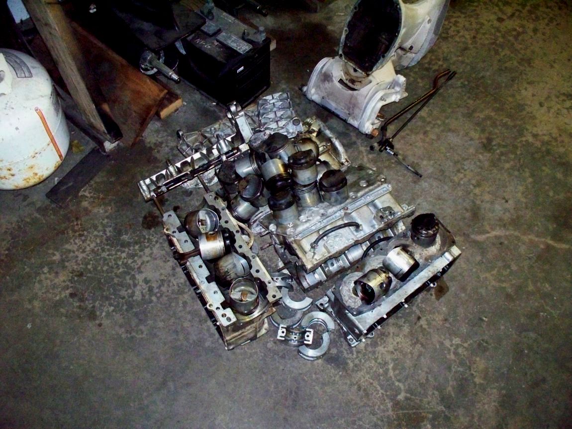

The first picture shows the pile of dead parts that piled up during my latest hunt for sweet internals for a couple Super Thunderbolt builds.

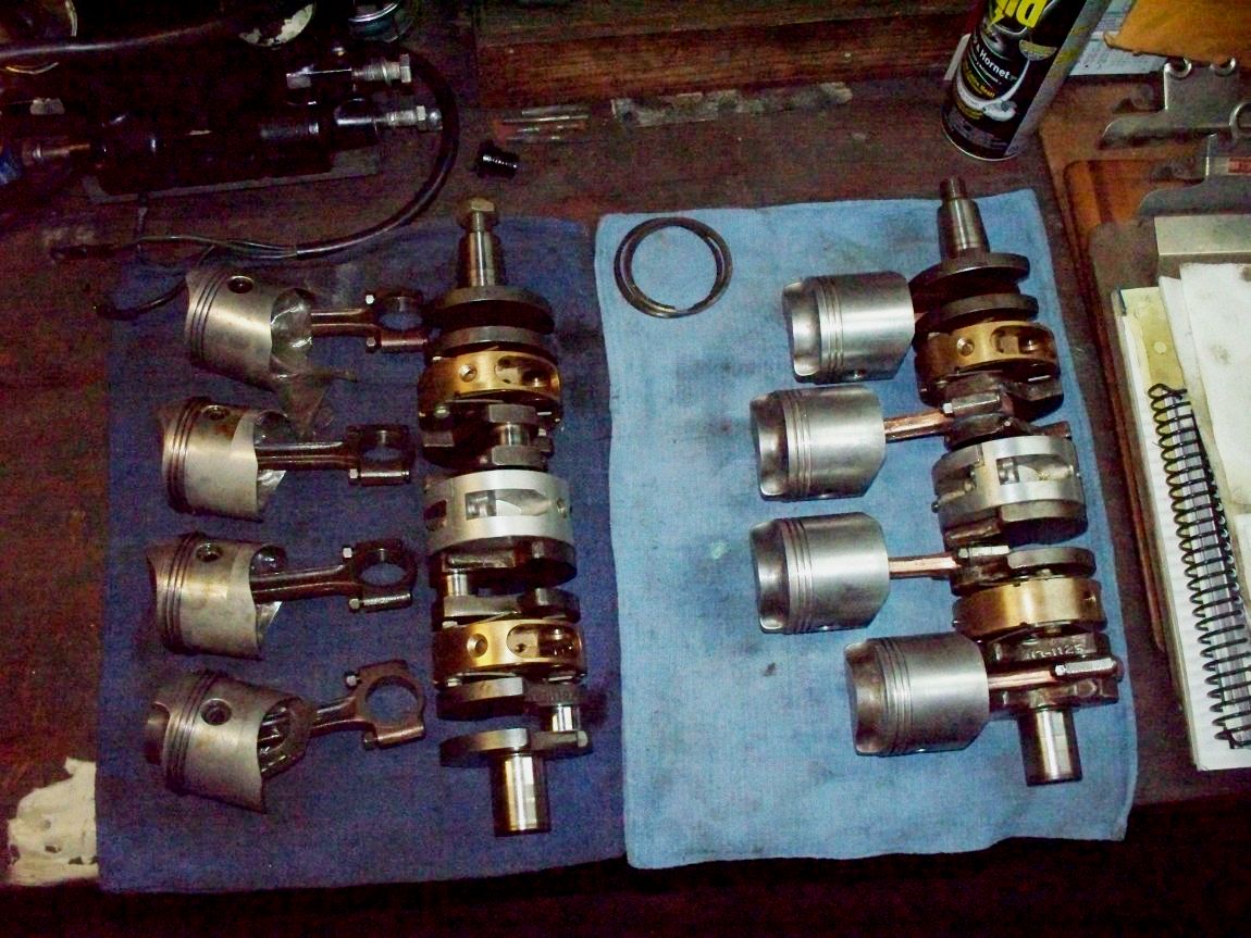

The second picture shows one crankshaft assembly awaiting rings, and another crankshaft awaiting cleaning and final inspections of the (4) piston & rod assemblies selected for it.
The most prevalent cause that damaged the rejected parts included pistons and blocks is damage caused by failure to keep a good water pump installed.
The other primary cause of defect to the connecting rod journals or crankshaft journals is the presence of moisture - whether ambient during long times of the motor not being used when not properly fogged or stored, or due to water intrusion of the crankcase area caused by either cracks in the block, corrosion holes between the water-jacket and the exhaust or combustion chamber, or failed gaskets or seals. It really sucks to get down to the last journal on an otherwise sweet crankshaft and find the journal of the crankshaft etched from rusted needle bearings.
