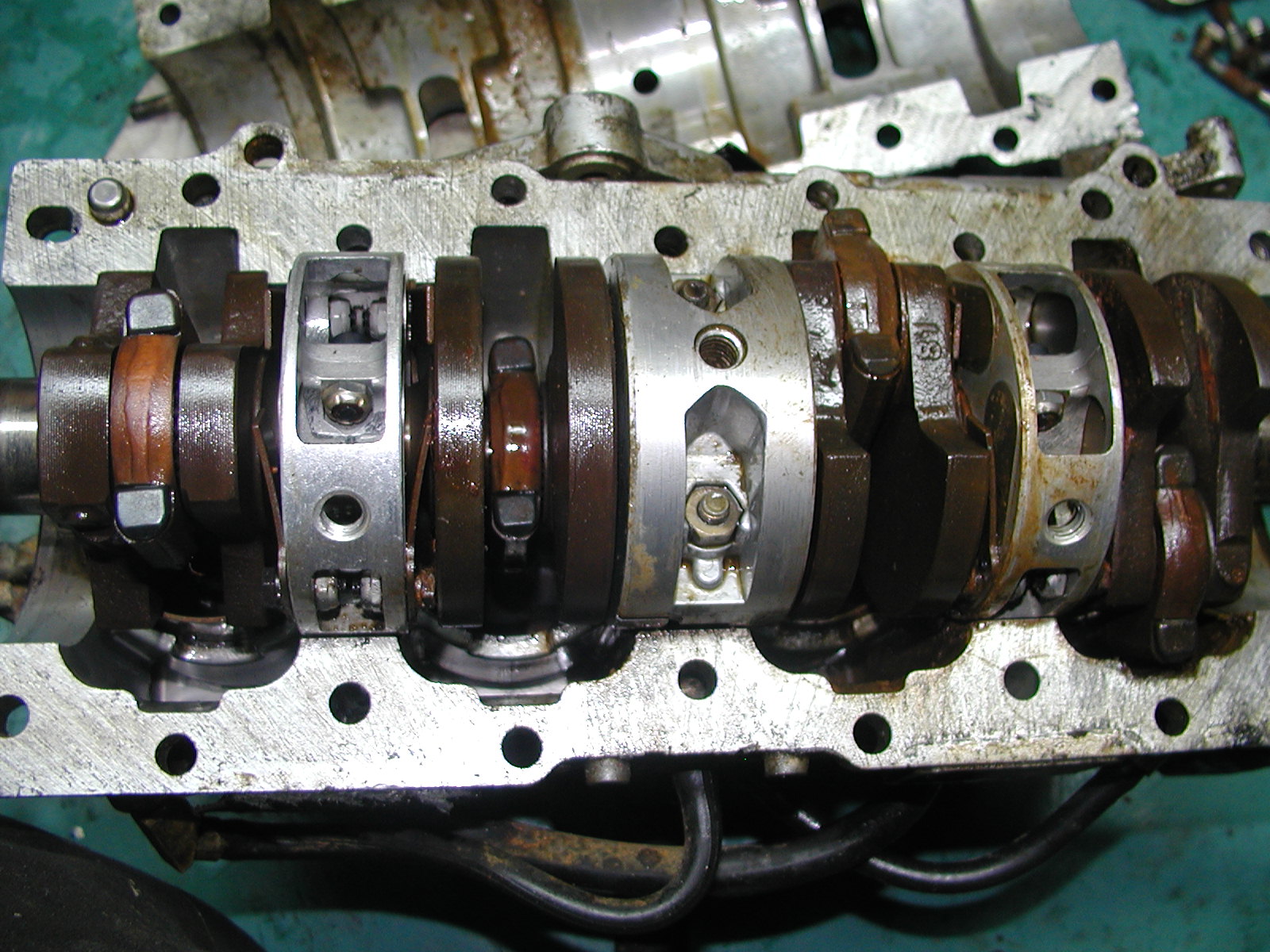

Hi, i am hoping to get some advice/opinions. I have 1971 50hp powerhead that was partially submerged in salt water for a few days. I did start it a few days after it was retrieved, it started but it didn't sound to good, at that point i poured oil in the cylinders and it has sat for the past three months.So today i split the powerhead to try to determine whether it is worth rebuilding. Looking at it i'm thinking with a good cleaning and new top and lower bearings and needle bearings it might be ok. I have never attempted to do a rebuild so any advice would be appreciated.

Re:50hp Rebuild? 11 years 9 months ago #104882

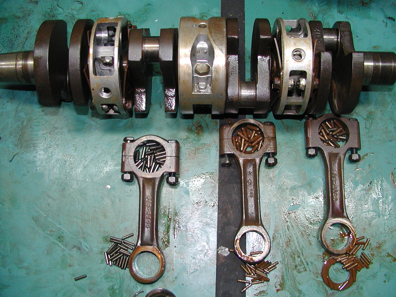

take the rods off and check the crank. also take the pistons off and check the pin bearings. better safe than sorry.
Re:50hp Rebuild? 11 years 9 months ago #104885
I agree with Dave B, there is an awful lot of rust there. I suspect the needles will have etched the bearing surfaces. To be honest I would not hold much hope for a good crank there.
Re:50hp Rebuild? 11 years 9 months ago #104887
thanks guys, i will probably get back to it in the morning and post more pictures, we're getting snowed in here so it will give me something to do.

Both Dave's advice? YES YES AND YES! Seen many the Doc's motors torn down and YES! Yank the rods, and check the crank, as the rest ANY needle bearings. Salt is NOT nice to old Mercs one damn bit.

hi, Thanks robby i was planning on taking it apart as needed. it does look like the crank is etched, so should i give up on this one,would some parts still be usable?, i do have another powerhead that might have a good crank.

Yup, the crankshaft in the pic has had it!!

Yup..that crank is now "shop art"...to bad!

But NOTHING is junk to me. I was a Machinist 21 years at Reynolds Aluminum. Many times I've done same worn out/etched crank journals. Simple stuffed a lathe, cut down to good metal, then the "Red and Green" hand torch out and "spray the Metalized powder" on for a good rebuild journal. Simple me is nothing is "junk", that can't be "fixed" But maybe a good "crank shop" to do right? Probably cost prohibitive..but I got a REAL "soft spot" life heart me "Mercs".
Great job checking the crank as told. That middle crank rod journal is toast! But fixable too! Link...

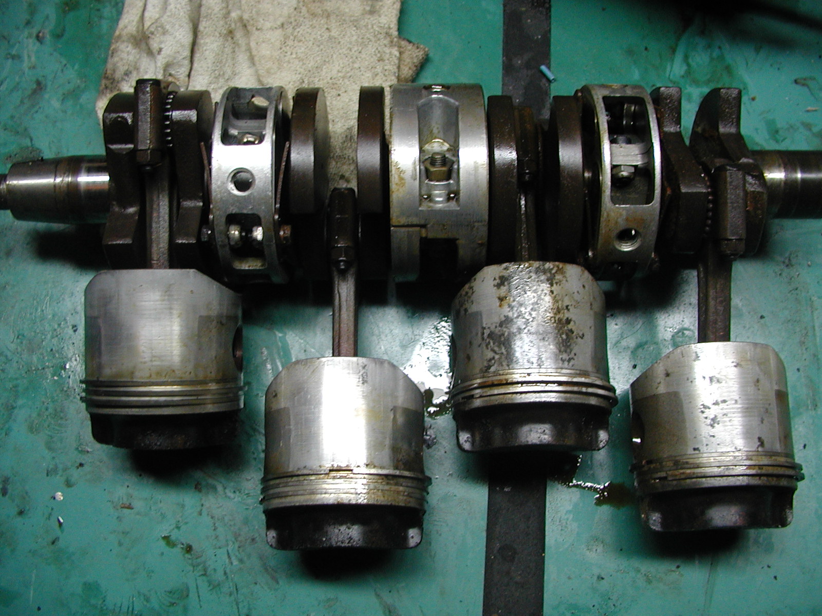

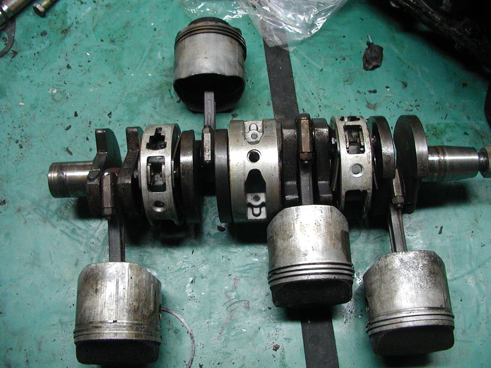

ok here is candidate #2, it looks better, everything moves more smoothly, the #1 and 4 pistons had one stuck ring. Before i go any further is there anything i should check? Also do i need a special tool to reinstall the pistons on the connecting rods?
Re:50hp Rebuild? 11 years 9 months ago #105043
Number 4 piston is toast, number 3 looks like the skirt is damaged but it could just be the angle of the photo. See if you can make 4 good pistons out of the 8 you now have. 3 from the original looked pretty good.
To re assemble the pistons on the rods does require a "tool" but you can make one easily.
