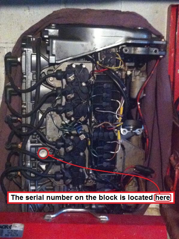

ok guys hoping someone a little more informed can help me..
i picked up a parts motor over the summer and while im cleaning up what i need. i'd like to what year parts im working with here...
the only numbers are
serial number.....A191096... its an inline 6.. mid cover says 90hp
but i cant seem to find these numbers anywhere..????

its all gray.. and mariner decals on the mid section cover..no side wrap around cover..so i'd say its a Mariner..LOL... and not sure what to look for on the block itself...if there are any special numbers to check???im guessing its around mid 80's it has the 3 wire trim and tilt i wanted..

Its a 1985, all parts are compatible with older ADI motors. The switchbox part number is likely a new number superseding the older numbers. your older powerhead will also mount on that mid section which is an easier way to upgrade. Good parts motor by the looks of it.

Except for the gray paint, this series of Mariner is identical to a Mercury. The only differences are the shape of the top hat and the cowl wrap. All other parts are the same.
You really scored at $50!!!
If your Merc is older and has the plug-in for the harness on the starboard side, but your harness (internal or external) have crummy wires, you can use the lower pan that came off this Mariner under your earlier 1150-1500?? and step up to the much better (8) pin with a round dis-connect on this Mariner & same era Mercs that tucks away inside the cowlings.
You will also want to use the Mariner's front cowl support, since it has the PT solenoids and related wire harness on it, and there is no casting for these solenoids on the older front cowl support.
You may need to remove the clamp assembly on the front cowl support that holds the (8) pin male to female plug-in together & just tape the two together, so you'll have room for your earlier switchbox - if your Merc has a distributor. I don't recall if there is room on the inside of this front cowl support for both the clamp & the older switchbox.
I have pointed out where to find the powerhead serial number on your picture.
doc
