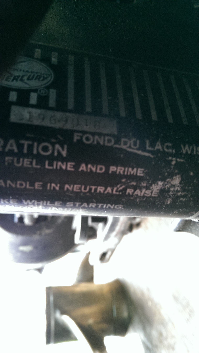

My motor is SN 1969018
This is what I get from oldmercs.com
Merc 950SS/95/1968693 thru 2101742/1966
Merc 1100/110/1935101 thru 1937374/1966
Merc 1100SS/110/1970668 thru 2103722/1966
It's number is in the 950SS range could that be right?
Re: 1100 SS serial number doesn't match list 11 years 10 months ago #103387
check the power head for the serial ####. that will tell the story. decals can be changed.

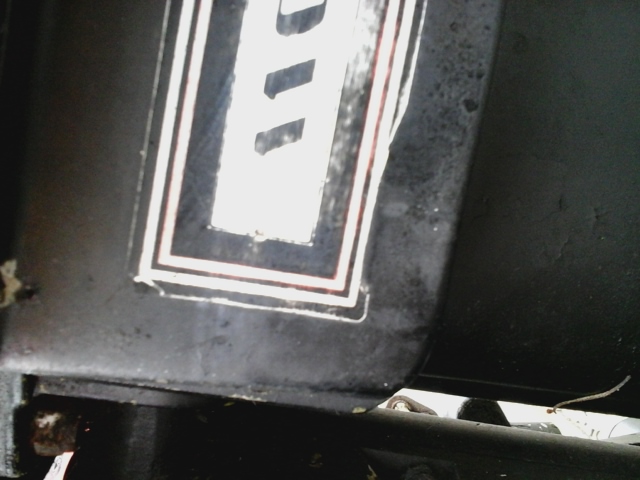

Well the powerhead matches, the face plate says 1100 ss (or thunderbolt) so maybe not an ss model and the bolts mean thunderbolt ignition, and lower decal says "110 hp".
Any experts out there know how to tell the difference, the decal on the stem looks original as there is paint around it where they add black but left the decal taped off.
Re:1100 SS serial number doesn't match list 11 years 10 months ago #103399
If the power head matches the plate then it is a 950.wraps can be original 1100's only 4 screws for the horse shoe.And t 1/4 turn for the faceplate 3 snaps for the wrap. Show us a pic of it.

That part is easy, it's the 110 hp decal on the lower that looks like it's been painted around, it's not new.
Well upon closer inspection, looks like maybe the detail is after the fact, looks like rattle can paint under it not the black it should be.
Also it looks like the engine was yellow under the black.
So did they make a yellow 950 SS?

i will have to try some light sanding or stripper unless they used that yellow as a primer
Re:1100 SS serial number doesn't match list 11 years 10 months ago #103427
Not sure I can see the yellow that you are talking about in your pic, however, most of the mercs were primed with zinc chromate primer that leans towards the yellow end of the spectrum. Likely that is what you are seeing. If the engine serial number matches the midsection serial plate then it would be a 950, many members here would be able to tell you more if you posted pictures of the block with the cowling off, told us the numbers on your carbs etc. It is quite common for these engines to be sporting other decals. For example, my 1974 1500 block sat on an 1986 midsection, and was dressed as a 1975 1150
