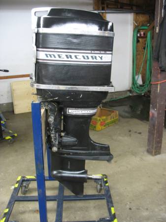

serial 1969018 , the dist to coil wire is broken off, how do you take the wires off and on? I ordered some Packard 440 wire from eBay and now before I break something it would be nice to be edumacated on this. Mercontrol wires are a mess too, think I need to re-wire the whole birds nest but it's not frozen, turning the flywheel and shifting works.
Re: 1966 Merc 1100 SS I think 11 years 10 months ago #103299
The distributor cap wires unscrew from the distributor cap.

So just lefty loosey the wire? also how is it on the coil, same thing? I need to replace that wire and don't want to break those expensive parts.
Thanks for the help
Re: 1966 Merc 1100 SS I think 11 years 10 months ago #103306
coil end just pulls out.
Re:1966 Merc 1100 SS I think 11 years 10 months ago #103309
Everything you needed to know about a merc distributor LOL. If your wire is broken you likely left the brass end that screws into the cap in the cap tower.
That rotor does not come off.
Check the condition of the 3 wires that go into the distributor base. If the insulation is rotted off I suggest liquid tape and heat shrink.
