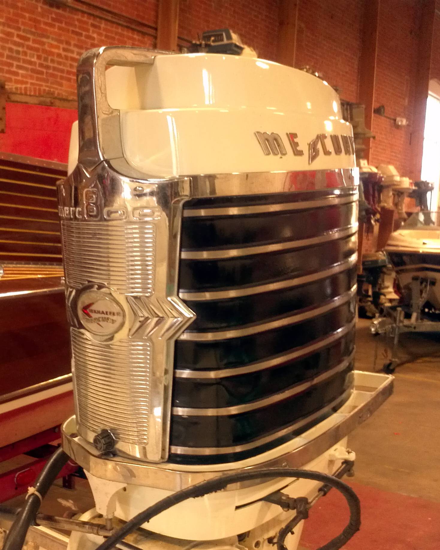

What do you think one is worth. I bought one several months ago,completely rebuilt. I'm not planning on selling it but i'm just wondering.I saw it run, starts right up, quiet and ran for quite a while. Did not overheat and hardly any smoke.
Pics attached

Like what TallTexan says and from what I’ve learned the 800 was available first in 60 as Direct Reverse (DR) only. In 61 the Full Shift became available in both an A & B model.
The A model is apparent by the cast MERCURY letters like your motor has whereas the B has decals. I’ve also noticed the B model has larger rubber mounting bushing compared to the A model. Another difference is a change in the Tillotson carburetor model KA 11A to a KA 14A which has an increased idle supply passage on the B version.
Your motor looks great and appears to be a 1960 DR. The S/N can be cross referenced at the www.oldmercs.com site to determine exactly what you have.

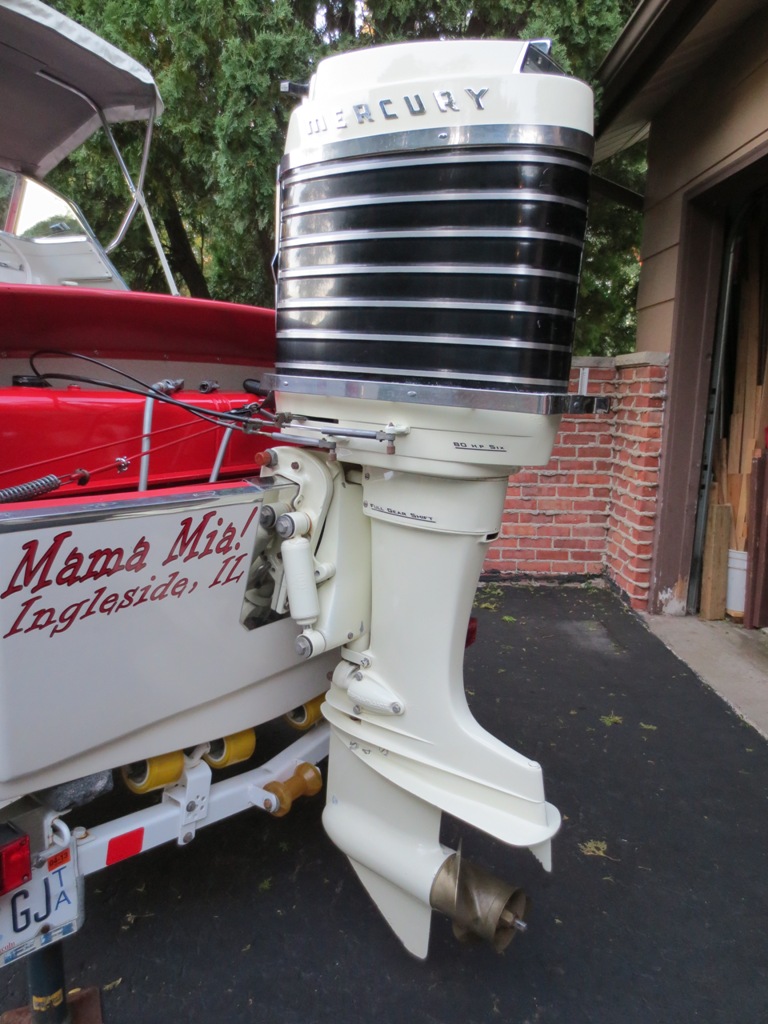

My 61 Full Shift
