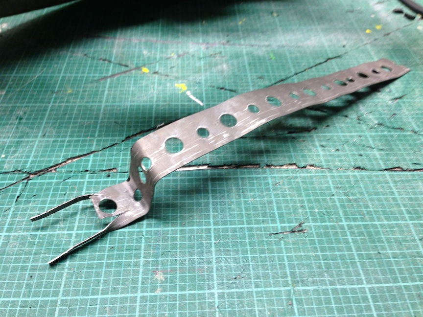

Thanks to Dave and all who chimed in and added their opinions. Thanks to Bill Kelly and the good Doc, Thom for their help. Bill suggested I build a little tube that would help guide the pipe into place. Thom suggested making a little tool that would grab the tube and guide it into the hole (see photo). As it turned out I needed neither. I should have known that Carl's designers would not make it that difficult. As the tube got closer it made it around the lower intake tube and it took just a screwdriver to guide it into the hole. Thanks again to all.
