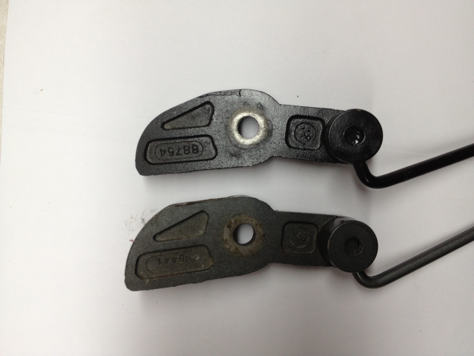

I've seen a couple guys try this, then forget the throttle arms are two different part numbers....I showed that to Doc Frankenmerc a couple years back too while we were discussing this subject
85441 left 90
88754 right 115
