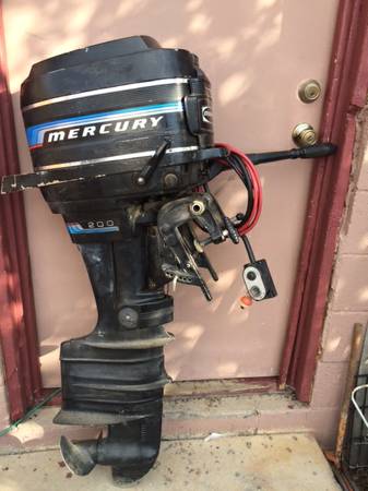

This motor is on local Craigslist. Sadly, too big for my 12 footer and too small for my Delmar, but it caught my eye because of the lower unit. It just looks odd to me. I'm curious, is this some sort of conversion from a short shaft to long? That gearcase area looks like it has too many housings.
Re:Merc 20 12 years 2 weeks ago #101703
That Merc has a 'Bay Kit' installed, that converts a short shaft Merc (15" transoms) to a long shaft (20" transoms)
It also appears to have electric start with is a real bonus to some potential purchasers.

Looks to be in OK shape for its age, too bad it's not the size I'm looking for.
