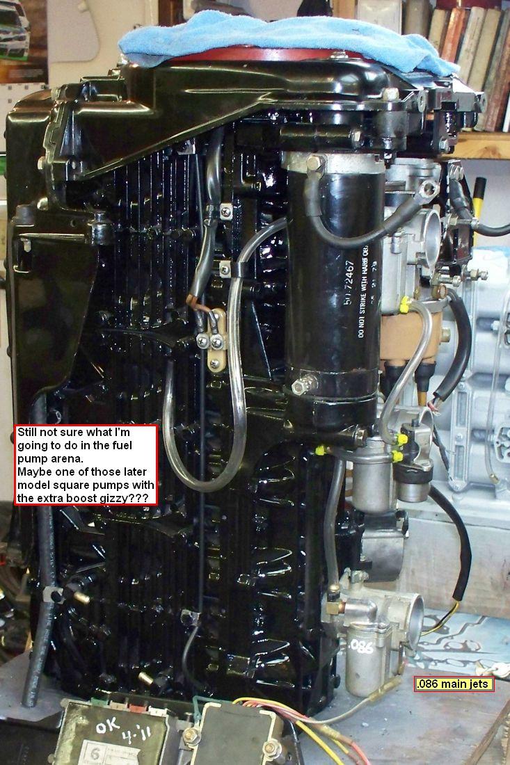

Docs pic shows the standard set up.

The enrichner pictures I posted show where the factory system is connected to the #1 carburetor float chamber & where the enrichner hose is connected to the balance tube system on the front of the crankcase. The actual enrichner is factory placed to port of the carburetors on a boss cast onto the crankcase cover. That boss is not there on the older originally choke models. That is why I positioned my enrichner where I did.
