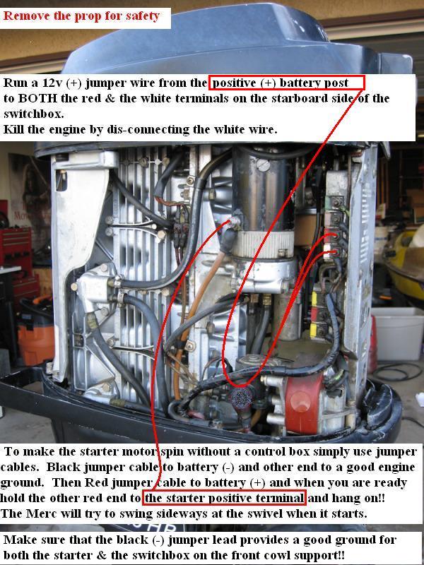

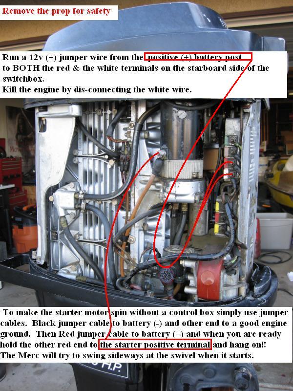

Re:Paging Dr Frankenmerc... 16 years 4 months ago #10114
Here ya go!
Sorry about the delay.
See the attached picture for details.
Without a control box you will also need to just run the (2) jumper wires on down to the (+) battery terminal rather than the solenoid since the solenoid won't have 12v without an external harness, etc.
Thom

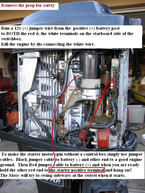

Re:Paging Dr Frankenmerc... 16 years 4 months ago #10170
I failed to add that little tid-bit of important info in the picture, but I put it into the short narrative. Sorry if you missed it.
I have corrected the picture so it can be kept for future reference without the narrative.
Here is the corrected pix.
Thom
