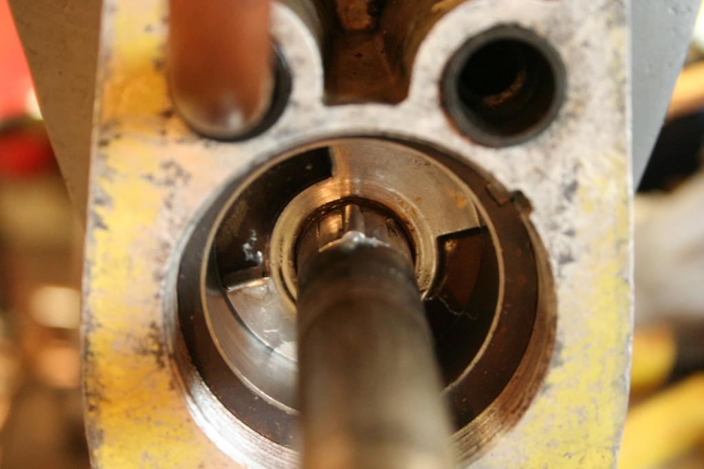

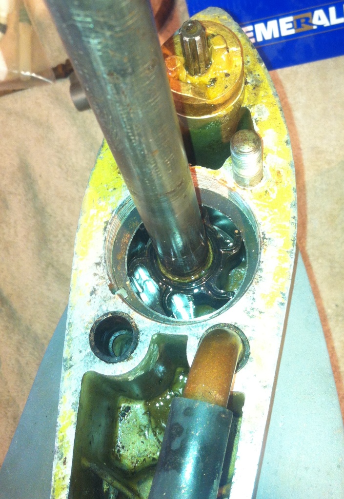

Here is a picture of how it is set up. This is a Merc 300.
What could I be missing?

Re:Still having troubles with water pump 12 years 1 month ago #100546
First time I changed the impeller on my older Merc, I used a Sierra kit that was made to fit several models. There were several gaskets that looked the same but weren't. The gaskets that go above and below the stainless plate are different. The one I used under the pump housing was the wrong one. No circulation at all. I carefully examined all the gaskets and compared them to the plate, and found the error. Works fine now. Don't know if your kit had multiple gaskets, it's a different model than my old 650.
In the photo, the stainless plate is at upper left.

Re:Still having troubles with water pump 12 years 1 month ago #100554
Merccooper,
Your assembly looks correct, impeller, etc, and after reviewing your write-up I find myself struggling for an obvious cause of the problem.
The following are long shots, but things I have come across in the past.
Although the impeller is new, and it sounds like you have restrained it from rotating while attempting to rotate the drive shaft in efforts to see if the impeller key - or pin - is slipping,...Have you carefully inspected the bond between the brass impeller hub and the rubber body? They should be 'vulcanized' together or permanently bonded, but I've come across both OEM & after-market impellers that have failed here.
Another possibility is whether or not the water delivery tube has been bent at some time during assembly attempts, that have left it slightly shorter than it needs to be to properly seal down into the rubber seal in the gear case / water pump area housing. This can easily occur when the lower end of the water tube doesn't get properly aligned - and held in alignment - while the gear case if completely installed onto the driveshaft housing.
Since the water tube has a slight 'Z' in it bends from top to bottom, if the tube is not aligned it can easily and quietly dis-figure and end up too short to seal.
By measuring down into the rubber seal in the gear case to the depth the water tube would seat properly, you can determine how much below the driveshaft housing the water tube should extend.
Although probably not a possibility in your case, there is always a chance the driveshaft has rubbed a hole in side of the water tube about 1/2 way up if the rubber protection sleeve has fallen from position.
The only other thing that currently crosses my mind is whether or not the splines on the driveshaft and in the crankshaft are worn out and not even turning the driveshaft - which of course would result in no water being pumped.
Your parts look so nice and clean, without corrosion, rust, etc that I doubt this last suggestion needs consideration.
Safety note to all: Never grab a propeller and attempt to turn it or the driveshaft while the sparkplug wires are in place. These sweet little 4 cylinder Mercs can start and ruin your day.
I hope these suggestions help, or at least inspire someone else to share another possibility.

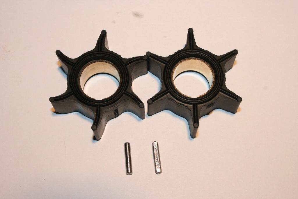

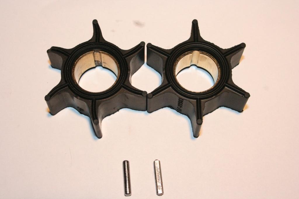

But in the photo bucket pictures, it does look like the impeller seen may have been slipping as the 'key-way' appears rounded at its edges.
Have you considered tracking down a later model 'key' since the driveshaft has the flat area for the later style key?
-or-
I don't recall the difference exactly, but if you have swapped parts around on the port side of the block with other similar parts Mercs, you may have restricted the water movement. I recall that once I had an extremely strong & warm pee stream, but the rest of the water was unable to exit. I don't recall if it was a difference in the port side gaskets or the port side baffle plate or cover. It was a first series 500 with the same style water pump as you are working with.
Not sure if the opposite effect in an assembly could result in the power head getting hot though.
If changing the impeller and style of key doesn't resolve the problem, I think it is time to lift the power head and check the placement of the top end of the water tube & its seal, and do some water movement testing from the base of the water tube to the open top end of the water tube, and then a direct pressure with water to the power head's water intake in the bottom of the block to an open tell tale on the top of the block.
My bet is still on the impeller & key though.

Re:Still having troubles with water pump 12 years 1 month ago #101092
i had an impeller once that had the brass hub was installed a little off center so it was holding the vanes away from one side of the pump body, after grinding it down so that it was recessed it worked fine. just a thought...

yes get the newer key. it is flat to fill the space on the DS with the key molded in. also makes it easier to install the impeller doc is correct.

The flat key is an excellent upgrade from the old pin, especially when the flat area is worn.

Re:Still having troubles with water pump 12 years 1 month ago #101108
Not the flat key I was thinking about. I will post a pic of the style we are referring to. I know why you put the screwdriver against the impeller, however, the video shows a lot of slop when you reverse the rotation. The tiny key that you have is rolling back and forth in the flat spot of the DS. The key I am referring to resolves that problem.
Re:Still having troubles with water pump 12 years 1 month ago #101112
OK, went out in the RAIN to get a sample of the key I am referring to, I do not have a complete one, this is one that I had to cut out to get the impeller off the shaft. You can get an idea of the width of the key and on the one end you can see how the pin is molded into it.

Thanks Dave. I appreciate your efforts. It was a nice day here until the rain set in also tonight.
I'm glad I included a picture of the two pins I had. I would have likely assumed the flat one I have was the one you guys were talking about. I couldn't picture how the flat key I had would have worked better :unsure: but I was going to go along with the experts.
Thanks very much for the picture...makes sense now.
Now, to locate a pin like that. Original part number is C-17-23733 and replacement number looks to be 8M0032837. Hoping the guys that had the impeller will have this also.

Re:Still having troubles with water pump 12 years 1 month ago #101139
Better picture than the one I posted, thanks Thom.

I got a new impeller and new "flat" pin.
Below is a video and picture of the installation. Also, another video of a test using a drill.

New impeller and pin. No slip now:
Pump test of new impeller and pin with drill:

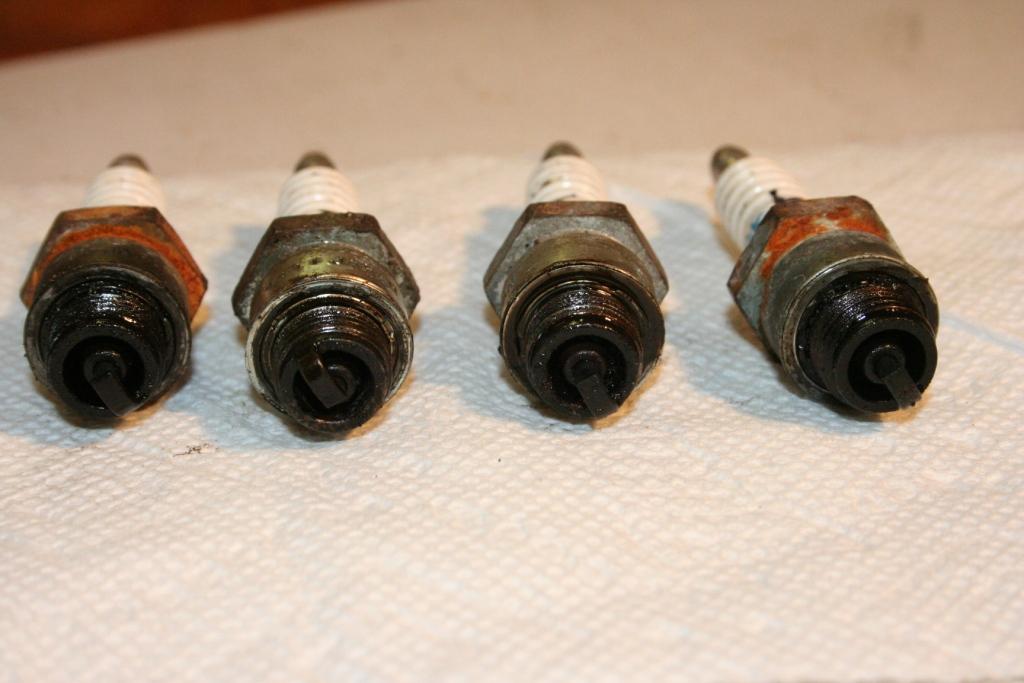

Spark plugs:
New pin installation:
