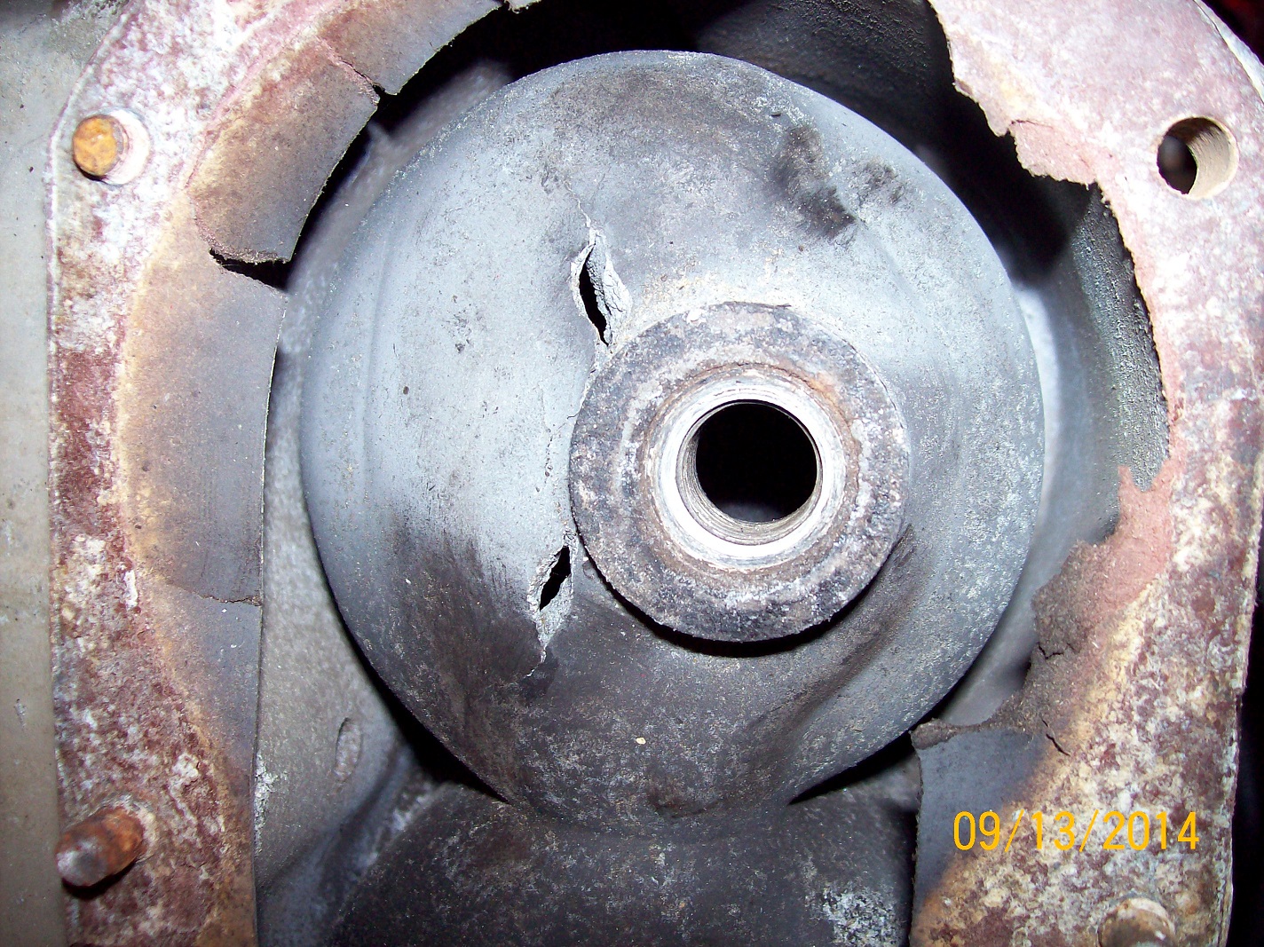

The rumors of me getting out of the inline six's were true, but it seems the addiction to these tall ladies is too strong. I brought this one back from Alberta and thought I would share some pics for my pal Thom.
Never seen this particular failure before, its clear it ran hot on the top cyl, I suspect water pump failure. Interestingly enough there is little to no damage to the number 1 piston and the rings are free. Turns over freely and smoothly by hand.

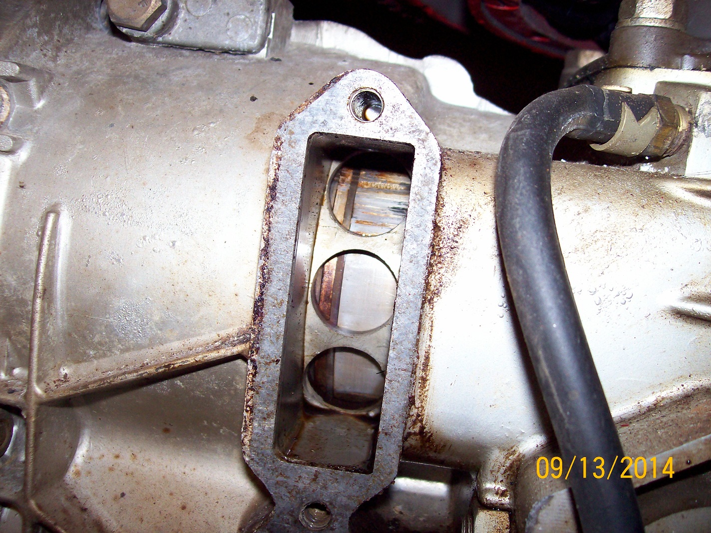

Heres a pic through the intake port.
Re:68 Merc 1000 (Hey Doc) 12 years 1 month ago #100167
Used to see this sort of thing on the triples all the time, but this is the first time I have seen it on an inline. Steam pocket trapped in the top of the water jacket will cause this, we used to drill and tap the top of the block and move the telltale hose there to relieve it.

  • Karma: 36
Agreed George, my exact diagnosis as well. I am working with a company in California to see if I can "stitch" this back together rather than weld. Stitching pins would be used to close the crack and fill the holes. Always looking for new ways to do stuff. This particular block is not valuable per se, but if we can find a way to save a cracked block that is valuable why not.
Re:68 Merc 1000 (Hey Doc) 12 years 1 month ago #100181
Worth a shot. I have used the stitch method to close up cracks in water jackets on frozen engines, works pretty well.

  • Karma: 36
Yup, I have seen it used on crankcases. I was not sure about heads but apparently it is quite commonly used. In this case I will be using a .201 stitch pin, should take about 12 to 15 pins. The plan is to stitch from the end of the crack towards the fissure(s) from both ends and plug the holes at the end of the process. Winter work.
