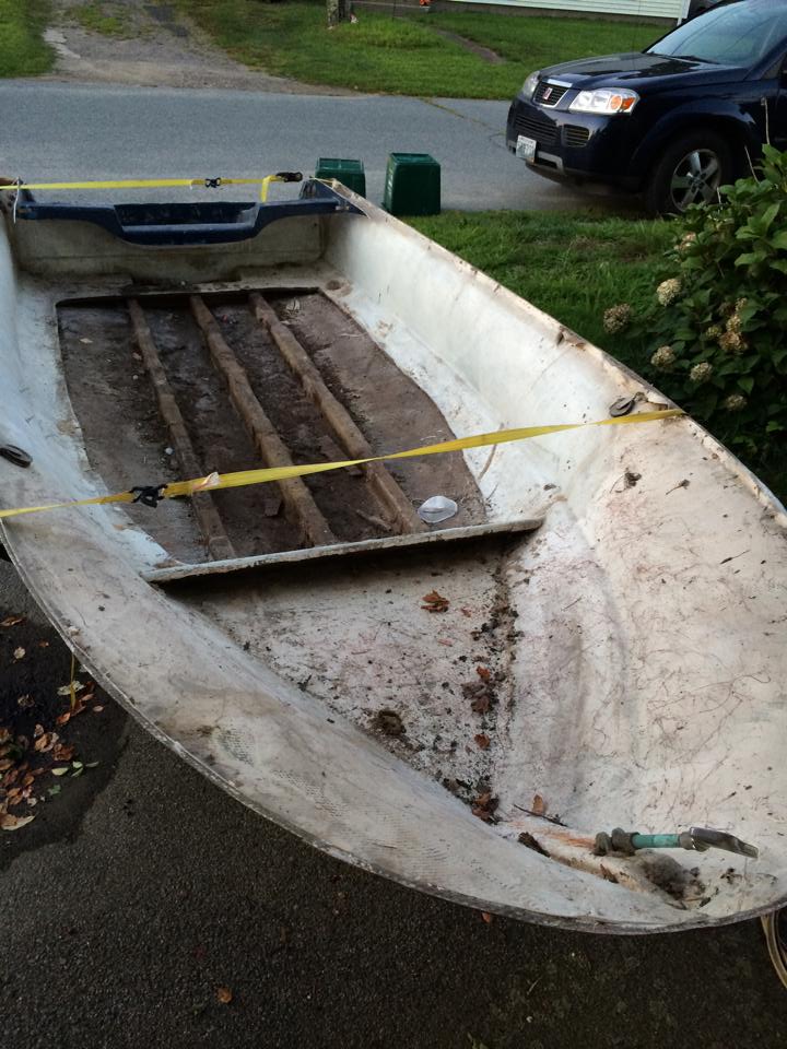

Been on this forum before and no one could tell me what it was. One reason I want it smaller is because I don't have a title for it so I was exploring my options. And no worries I obviously had a plan the cutting comment was a joke kinda. This is what she looked like. And what it looks like now.

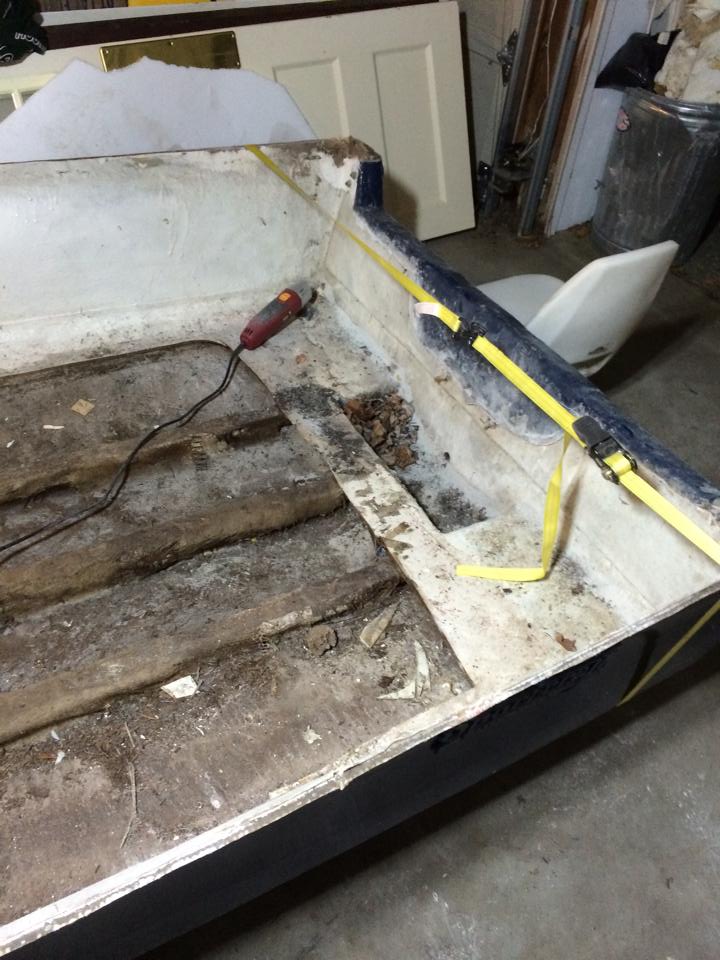

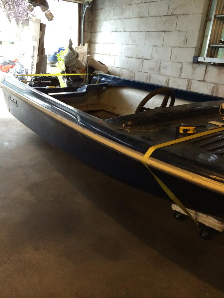

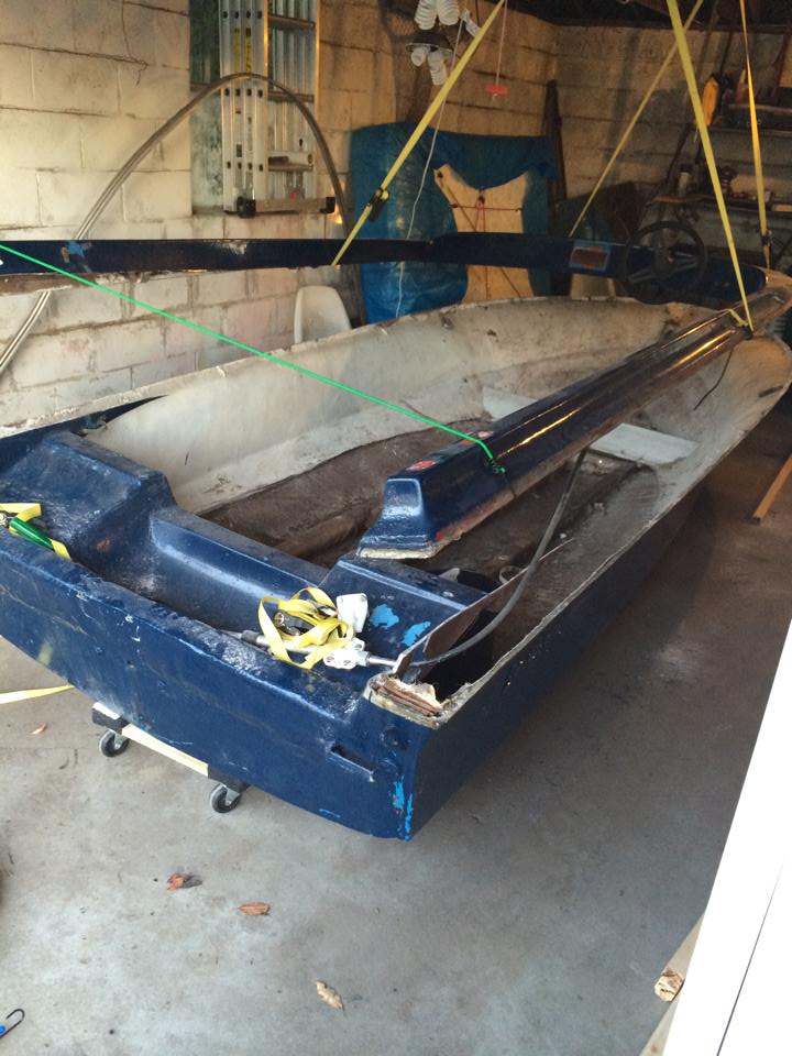

Yes i KNOW and i fully apologize i failed at loading pictures..but i got it now...So let me lay out the entire situation. I obtained my boat for free, with no trailer. I was told the deck and transom were "re-done", however i got it home and realized the deck was bubbling and had cracks in the fiberglass...so i removed the fiberglass decking, and the larger portion of the plywood...which was rotten. I am now looking at rotten stringers. So I decided i was going to turn this into a full blow project and have fun with it. I like to say i am some what eccentric, and decided to take this 1960's something or other and create what people are calling jet boats. So i obtained a 1996 Tigershark 900 and plan to implement it into the hull of my boat. Like in the youtube video here :
So i started taking the two halves apart, come to find out i cant take it off like any normal runabout ie. i would remove the trim pop the staples and raise it up. The previous owner had fiber glassed the two halves together near the transom, forcing me to cut it the two halves from each other. I think the pic will explain more clear.
SO here we are i have my plan however now i dont have title for when i am complete with my project. I checked RI laws and it states 14' and above need a title, and all boats/pwc. need registration...Now to be honest i really dont want to cut the back end off. i would like this to go as smooth as possible. However i am concerned with how the previous owner did the transom as i can see the wood is clearly rot out.

Re:1960s fiberglass boat 12 years 2 months ago #99461
Cool boat I wouldn't change the length, just replace the transom.

I wouldn't get too far down the stringer and transom replacement before figuring out how you'll graft the ski hull and outdrive into the existing boat and it's structure.
Obviously the boat's keel stringer will be partially removed to accommodate the ski motor/outdrive assembly, but you may be over into the area where the existing outbound stringers are. Which will depend on how much of the ski's hull you keep. That might be dictated by it's and your boat's hull contours and how to get them to graft together.
Your motor and outdrive assembly will be attached directly to the hull, and although I wouldn't risk undersizing the transom or it's thickness, w/ the bulk of the thrust and torque will be directed thru to the hull like an I/O rather then an OB, you might save some weight and work by not replacing the existing w/ exactly the same transom setup.
Many I/O have a horse collar transom plywood just at the keyhole, but may also have a thicker layup of fiberglass on the transom.
I'd be sure to fully support the hull w/ a cradle to prevent it sagging or distorting while you're hacking out the bulk of it's structure and working inside the hull on replacing the transom & stringers.

Hi,
I believe that I previously replied and noted that you appear to have a Sport-craft, likely a Ski-Liner model. We sold quite a number of these in the middle 1960's. I do not have pictures at hand presently, but you might click-on a picture on this page of our website: www.fergusonpoolemarine.com/canvascoversupolstery.html (near the bottom of the page) for two storage curtains we still have, where a factory picture is shown. If you look closely, you can see the fake louvers in front of the windshield, and the center racing stripe, both as your boat appears to have. Unfortunately, I am pretty skeptical that you will be pleased with the performance if you adapt the jet to the Sport-craft hull, or graft the personal watercraft hull either. Well performing jets need a hull tailored for them. Understand that I am as bigger fan of jets as anyone, but I believe the work to get where I would want to end-up at, is far too great at best. Still you might think about staying as an outboard, and you might well enjoy the Ski-Liner. A conversion to a long shaft transom would open-up finding a suitable outboard, or you can fit a vintage short shaft outboard.
