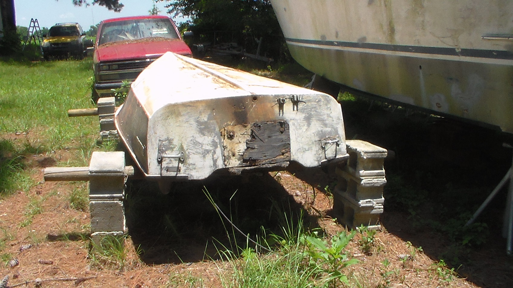

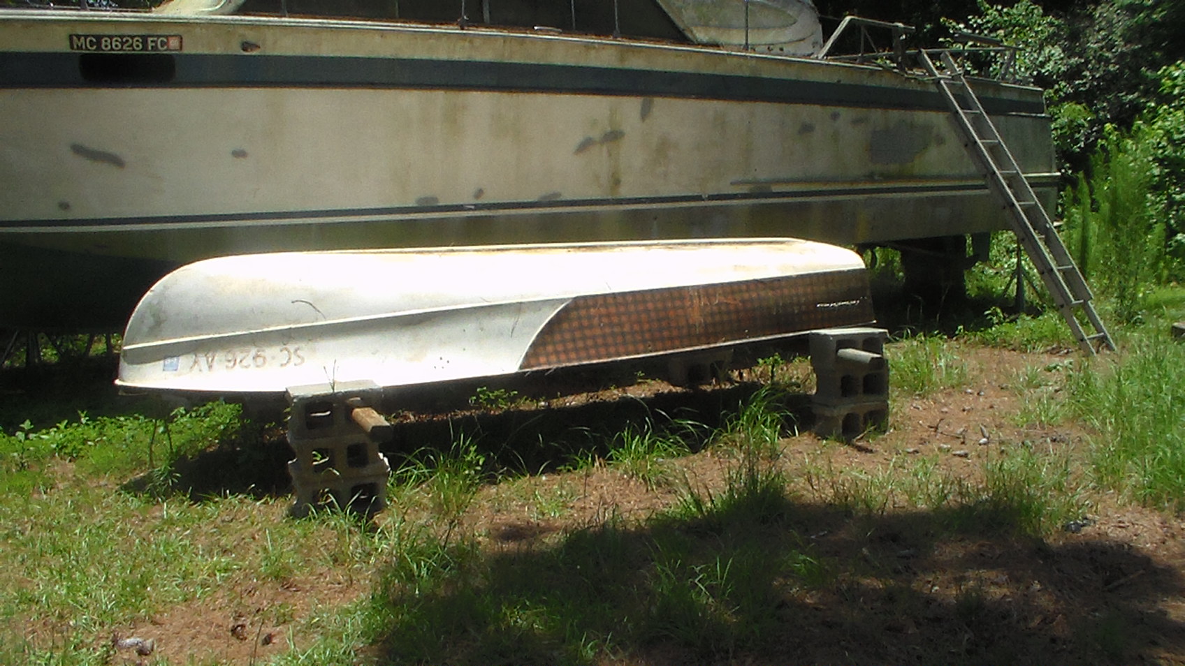

Greeting and salutations! I'm new to your forums and have a project that I would love a little feedback on. (currently it's a disaster.) To make a long story short this beastie was abandoned on our farm at least 10 years ago and I found it about month ago buried under a large about tree debris around our pond. (Still cleaning up the damage from the 2004 ice storm not to mention the 2014 one :P) I digress... sorry...
What came out of the debris pile was {as near as the registration can tell me...) a 1957 Whitehouse It's about 13 1/2 feet long and I am guessing a Capri model but I have no idea. Poor beastie is rough shape all of the wood and metal interior, cabling, and wiring is toast, and it needs a new transom (It been sitting full of water for a very long time) although surprisingly the hull is in relatively good shape, no breaks or major blistering. The gelcoat is chipped and very rough but When I thought of hauling it off to the landfill it charmed me and I decided to restore it instead.
Currently I have it stored upside down on a rack to dry out the inside and clean the gunk out easier.
The large boat beside it is also a classic boat project (1962 Chris Craft Roamer 36') that is undergoing complete restoration and overhaul. That is a seriously long term project since it has to be taken down to bare hull and all the running gear etc has to be rebuilt.
Back to the little boat... I do have a couple of questions.
1) does anyone know where to get a windshield for this boat? or can one be made for it without having to pay 2 arms for it?
2) I was thinking of using Awlgrip and Interlux paint systems on Whitehouse, (I already have some 2000E 2 part primer for the big boat) does anyone have another recommendation for a paint system that is nice but a easier to work with?? (awlgrip has a better topcoat paint selection)
3) Does anyone have some decent pictures of a boat from this era as to what the interior and dashboards looked like? I'd like to restore it similar appearance as to what it was new.
