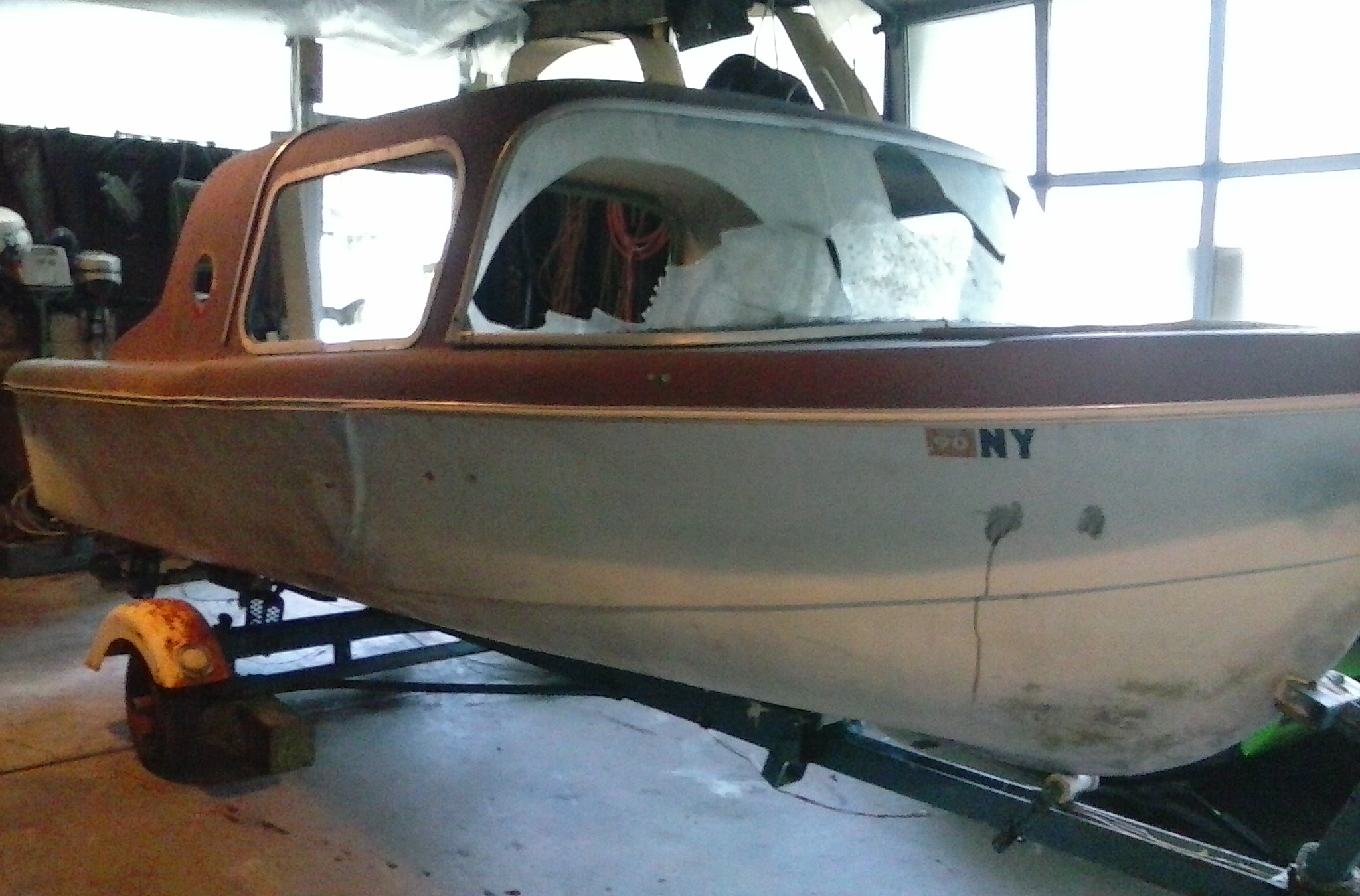

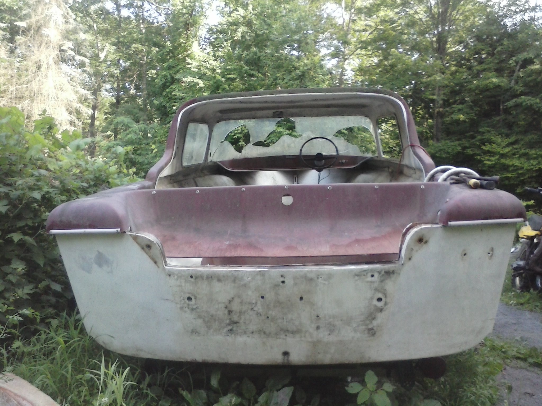

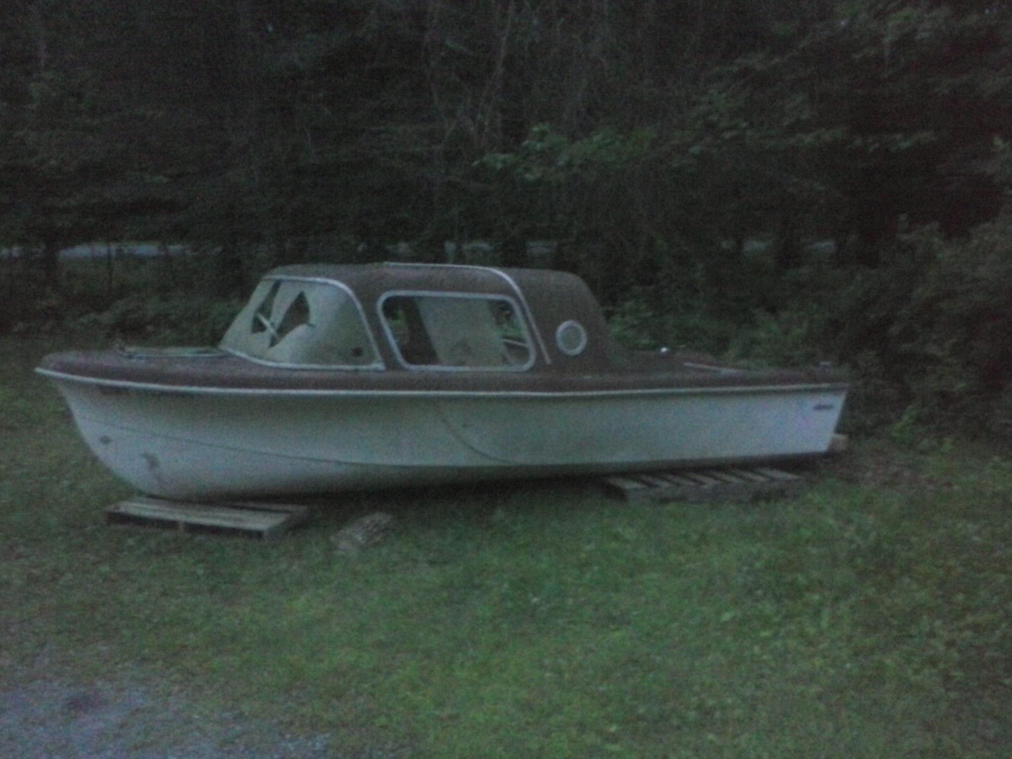

I picked her up last summer, from the glassified's on this site. She's different i never scene anot0her one yet! I will be doing a full restore. I took the winter off to work on snowmobiles but she should be ready for next summer !
1967 Crownline-for the river
1960 Whitehouse-for the lake
1963 Starcraft-for fishing

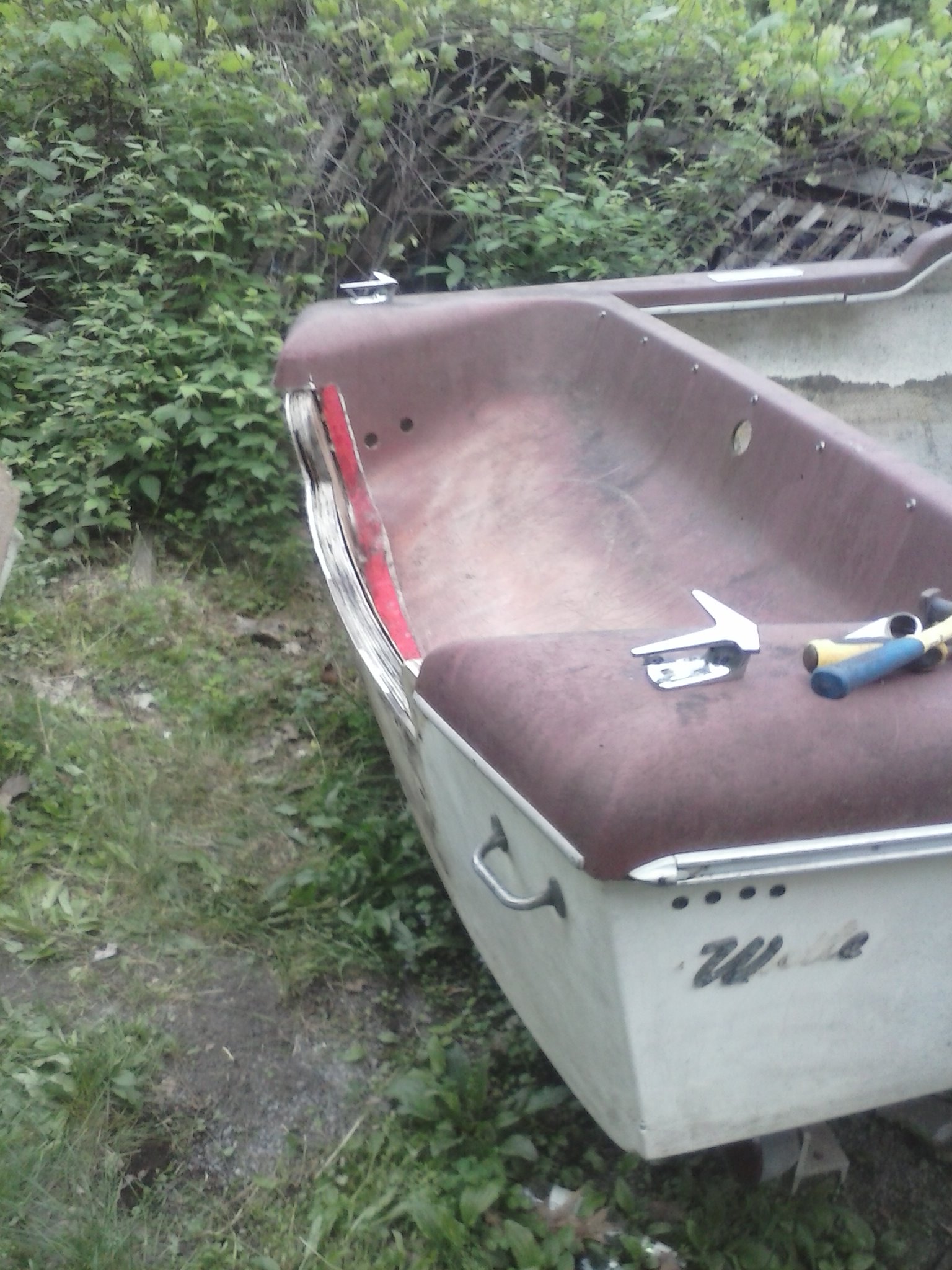

More pics Woops didn't think that was gonna be upside down! Don't know how to change, sorry guys!

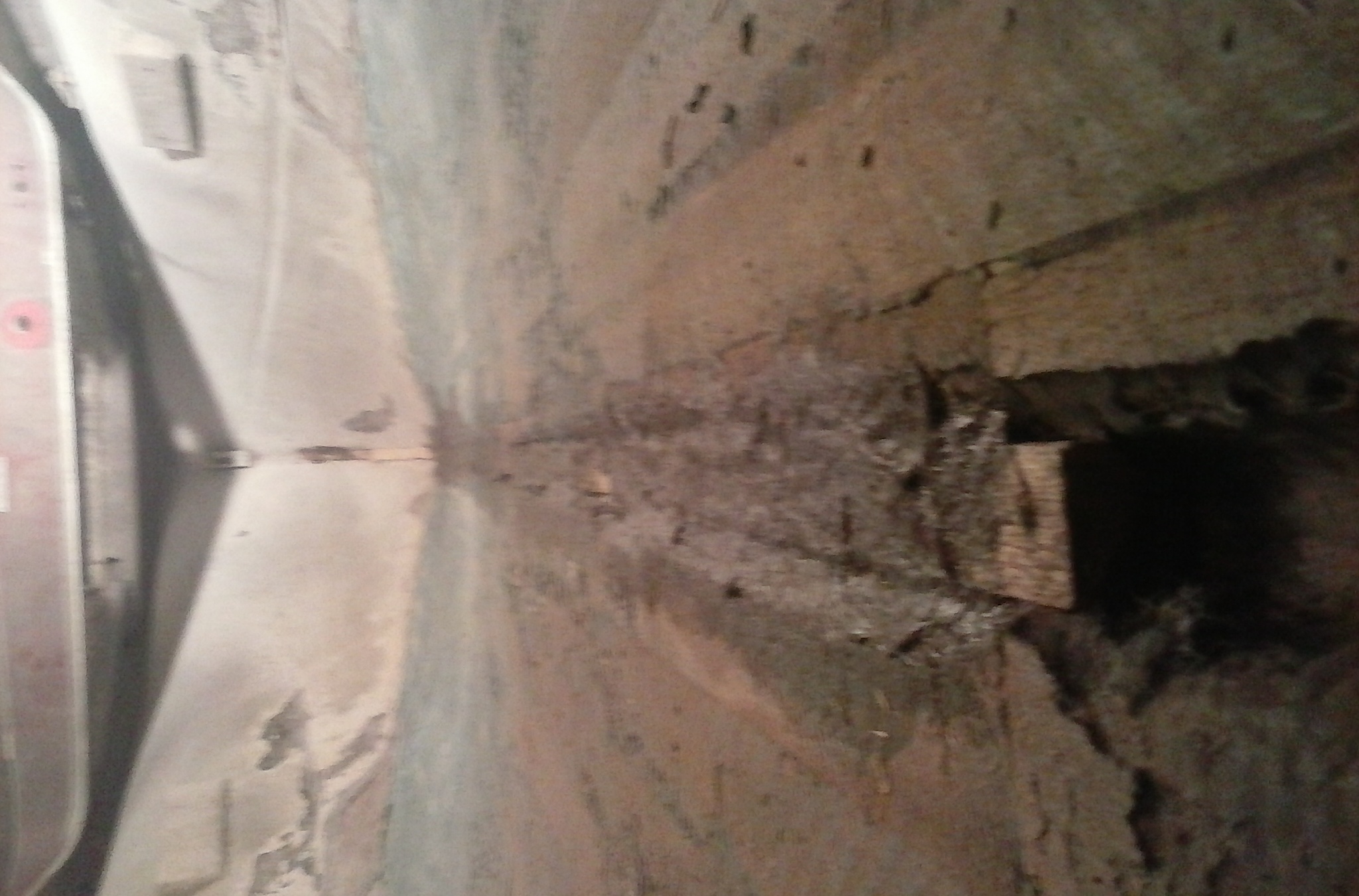

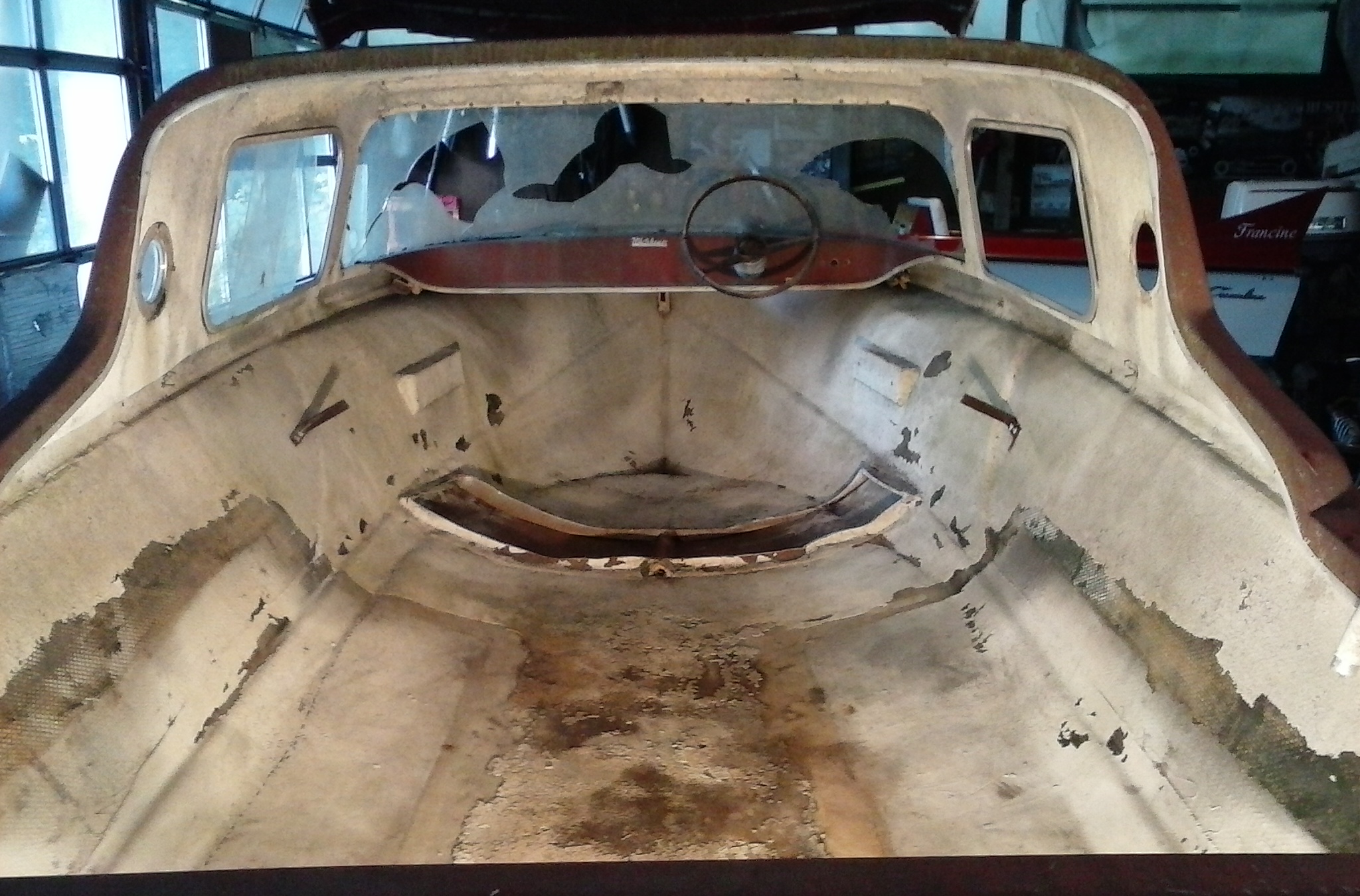

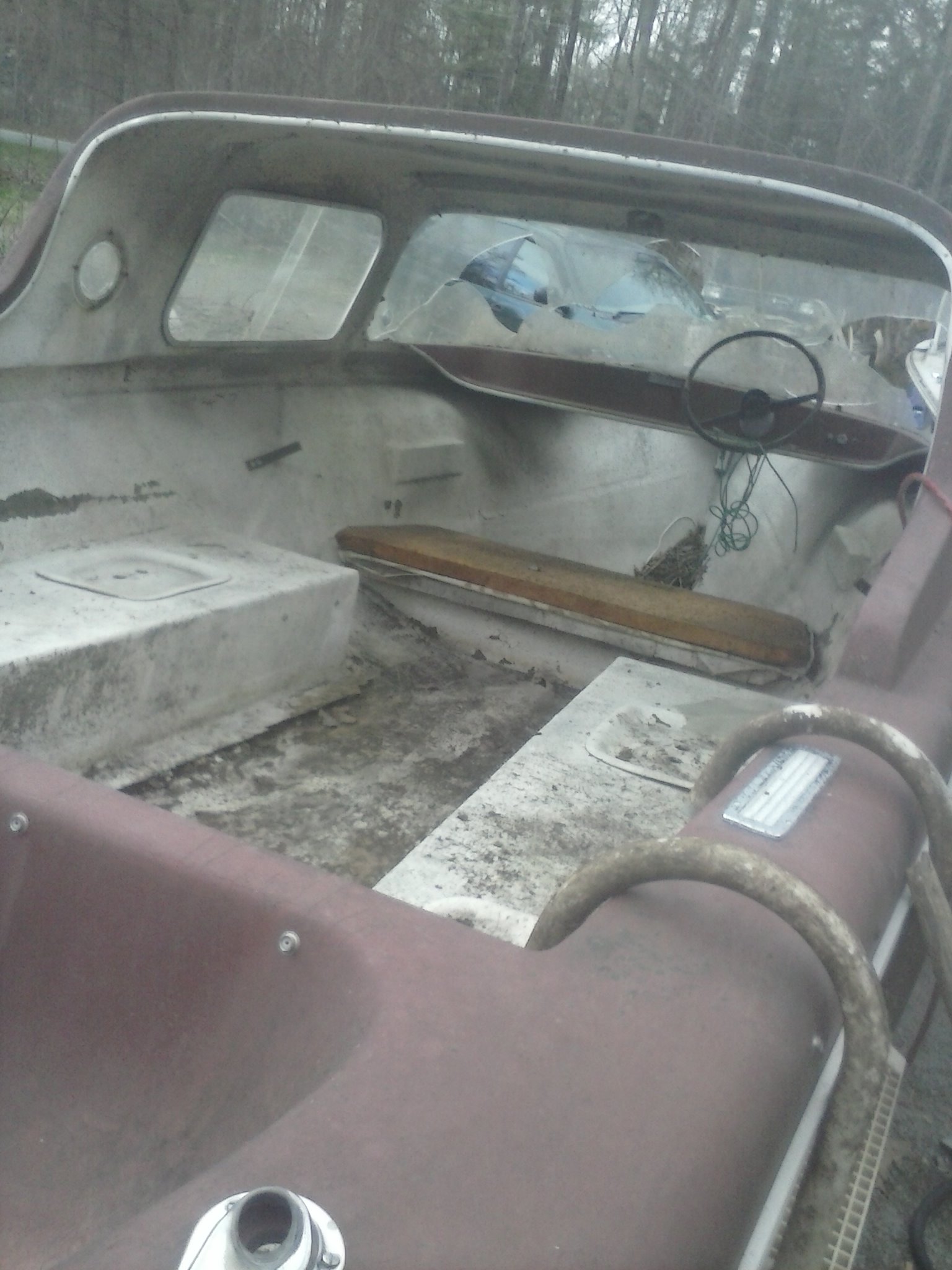

I got the benches out and floors real soft. i guess it has a bolsum floor, so no stringers?
Has anyone done one? I like to research what I'm getting into
I will post more pic's as i go

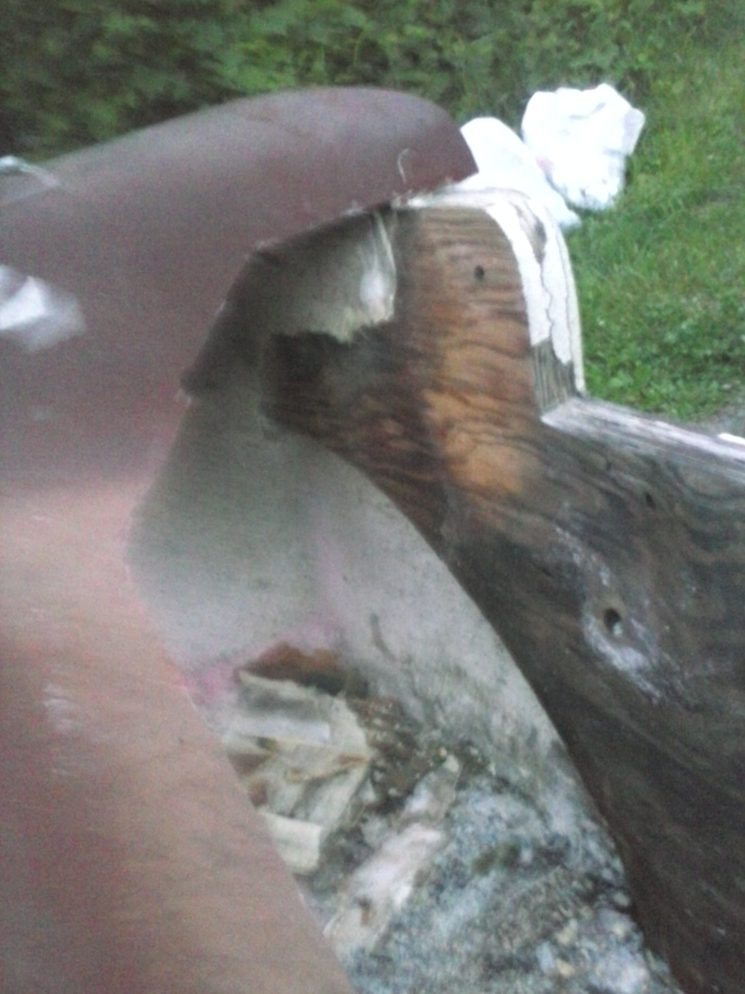

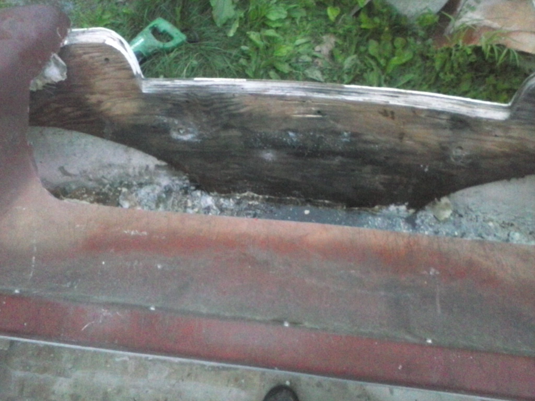

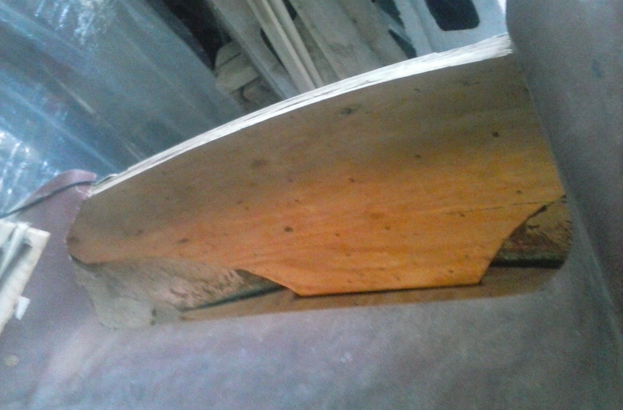

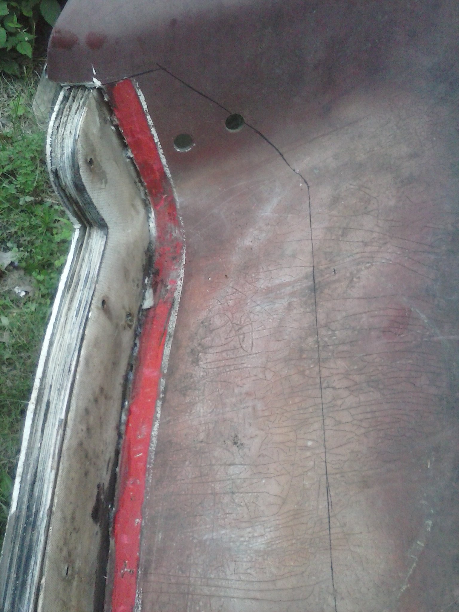

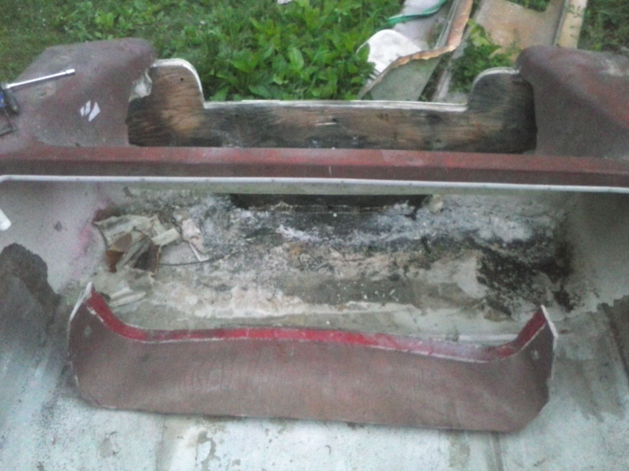

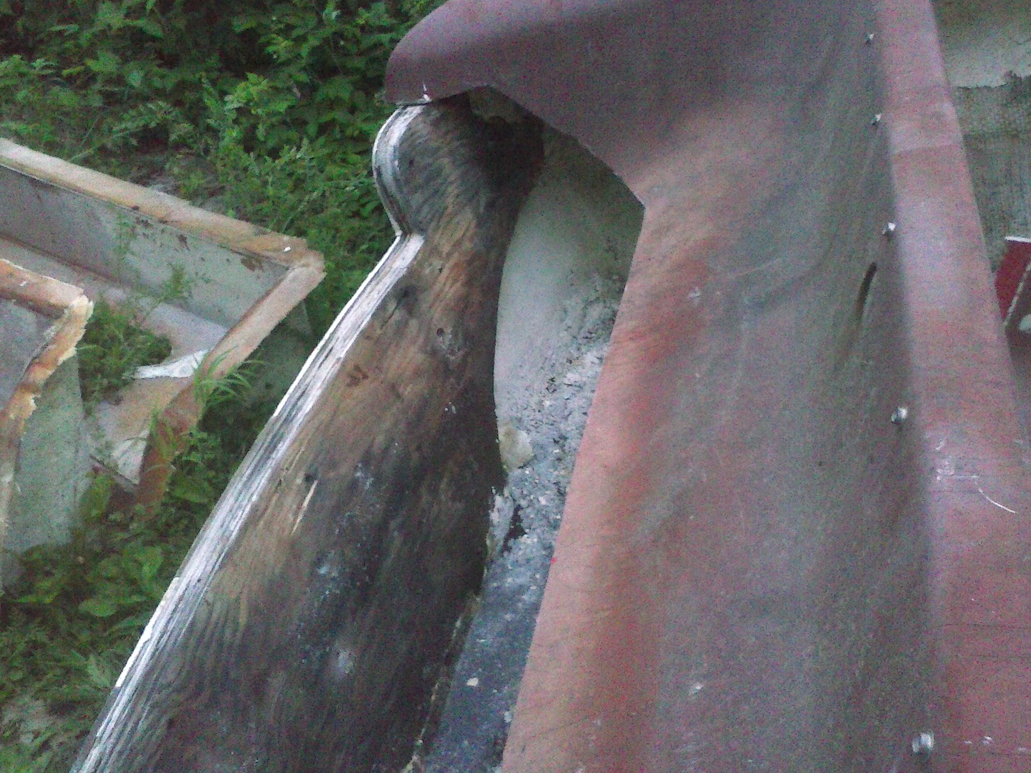

Starting to cut her up, do to the shape of the transum (outward curve). I will be replacing it from the inside.
So the cutting begans! Taking just enough of the splash well out to work and replace the wood.
It's kinda an unusual shape transum. I instead of a "Y" shape I'm going flat across the whole thing? Plus braces, according to the literature I've read, it's rated for 150hp, but it seems a little flimsy the way it was originaly?

Re:1960 Whitehouse victoria 12 years 4 months ago #96871
Wow! what an awesome looking boat. I am very jealous of you, I'm glad to see that you have started working on it. Keep posting your progress I really want to see how this one turns out.
Re:1960 Whitehouse victoria 12 years 4 months ago #96973
X2!
Re:1960 Whitehouse victoria 12 years 4 months ago #97031
X3!
Re:1960 Whitehouse victoria 12 years 4 months ago #97067
X4!
As to the transom, it looks like it was set up for a short shaft motor so should be fine to raise it, but pics can be deceiving. Just make sure you don't go too high for whatever outboard you are putting on it. I'd think it would definitely be stronger, and I don't think it would affect the look at all.
Cool Boat! :)

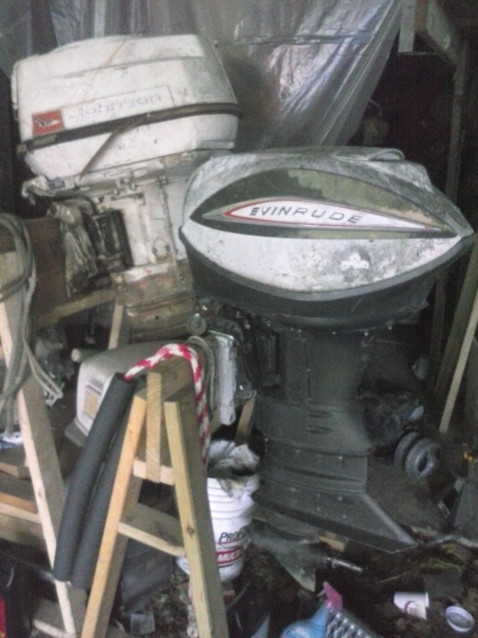

Hey whatsleft,
That's a good point! My plan is to raise the transum 5in in the center for a longshaft. I have an abundance of them kicking around so there's no shortage on parts!
I have this 64 starflite that's in running condition. I really like the look of the cowl! But the e-shift is kind of a bummer! Also have a few 60 sea horses laying around, so who knows? Definitely going long tho! [img]http://www.fiberglassics.com/media/kunena/attachments/legacy/images/CAM00132.jpg[/img [img]http://www.fiberglassics.com/media/kunena/attachments/legacy/images/CAM00129-20140701.jpg

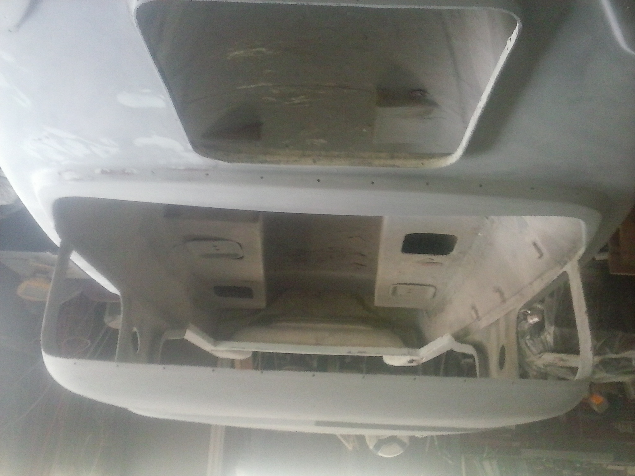

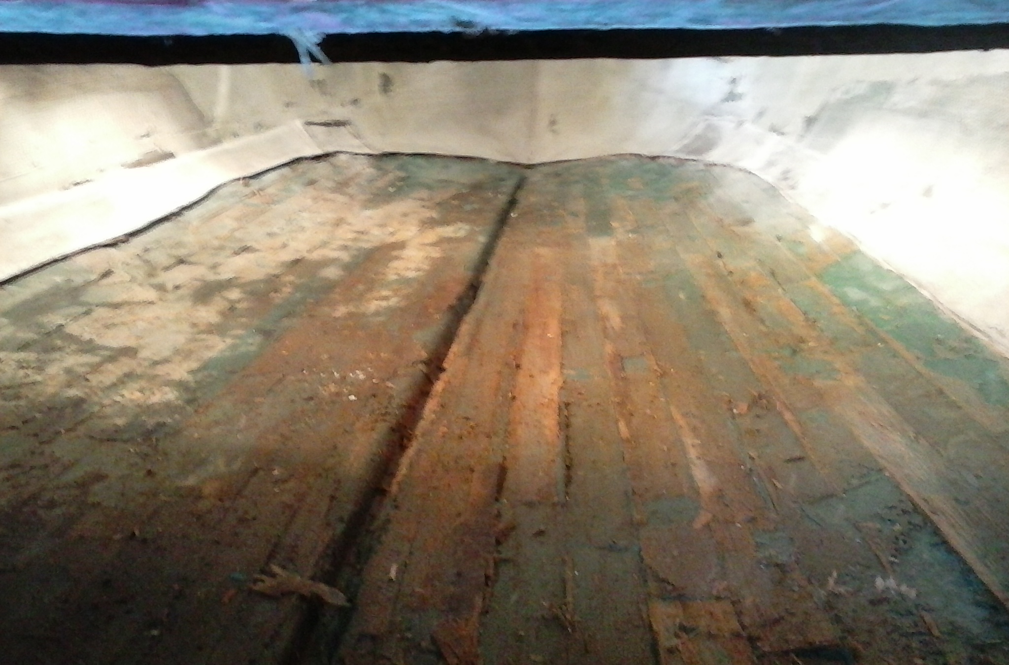

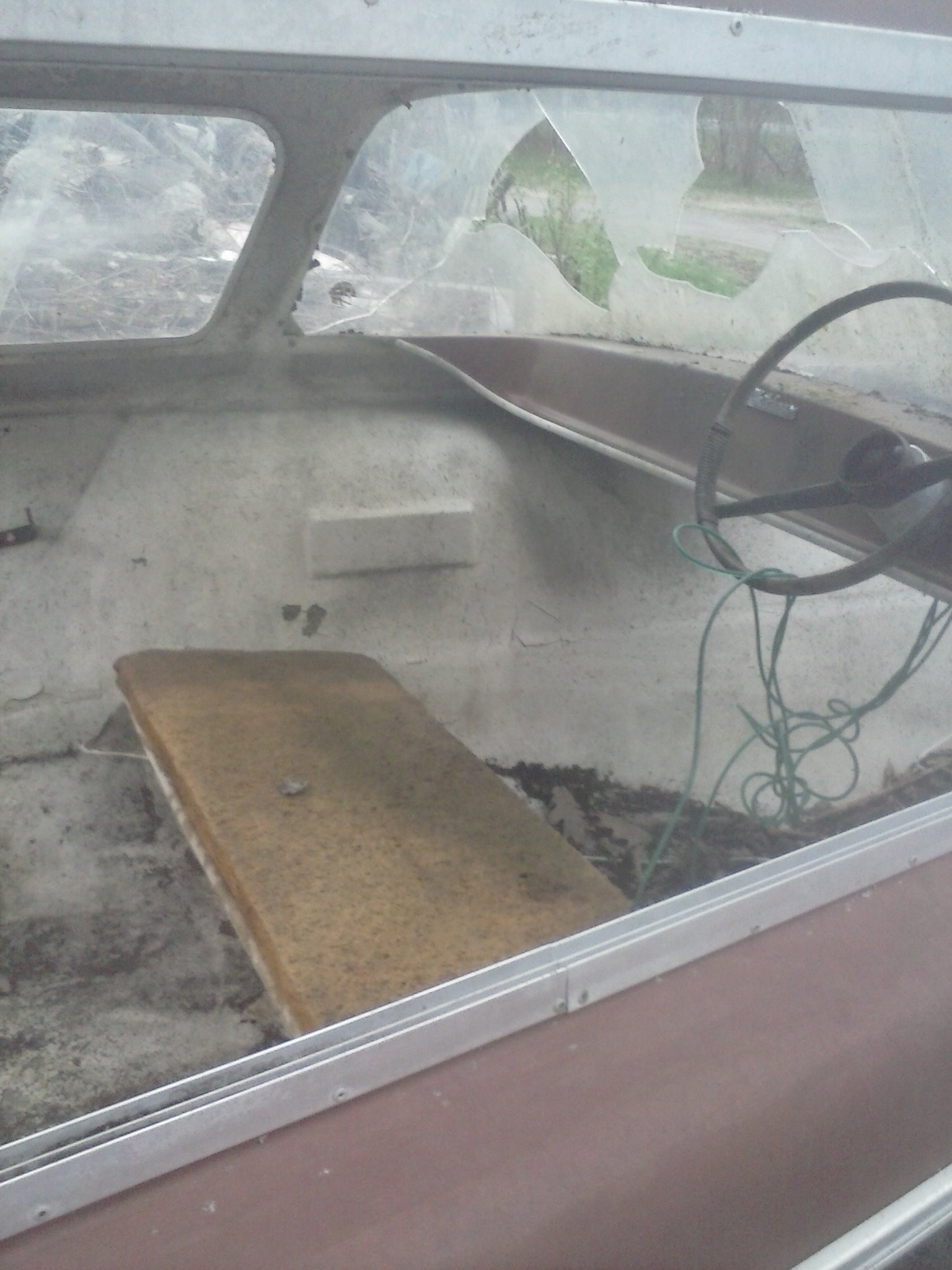

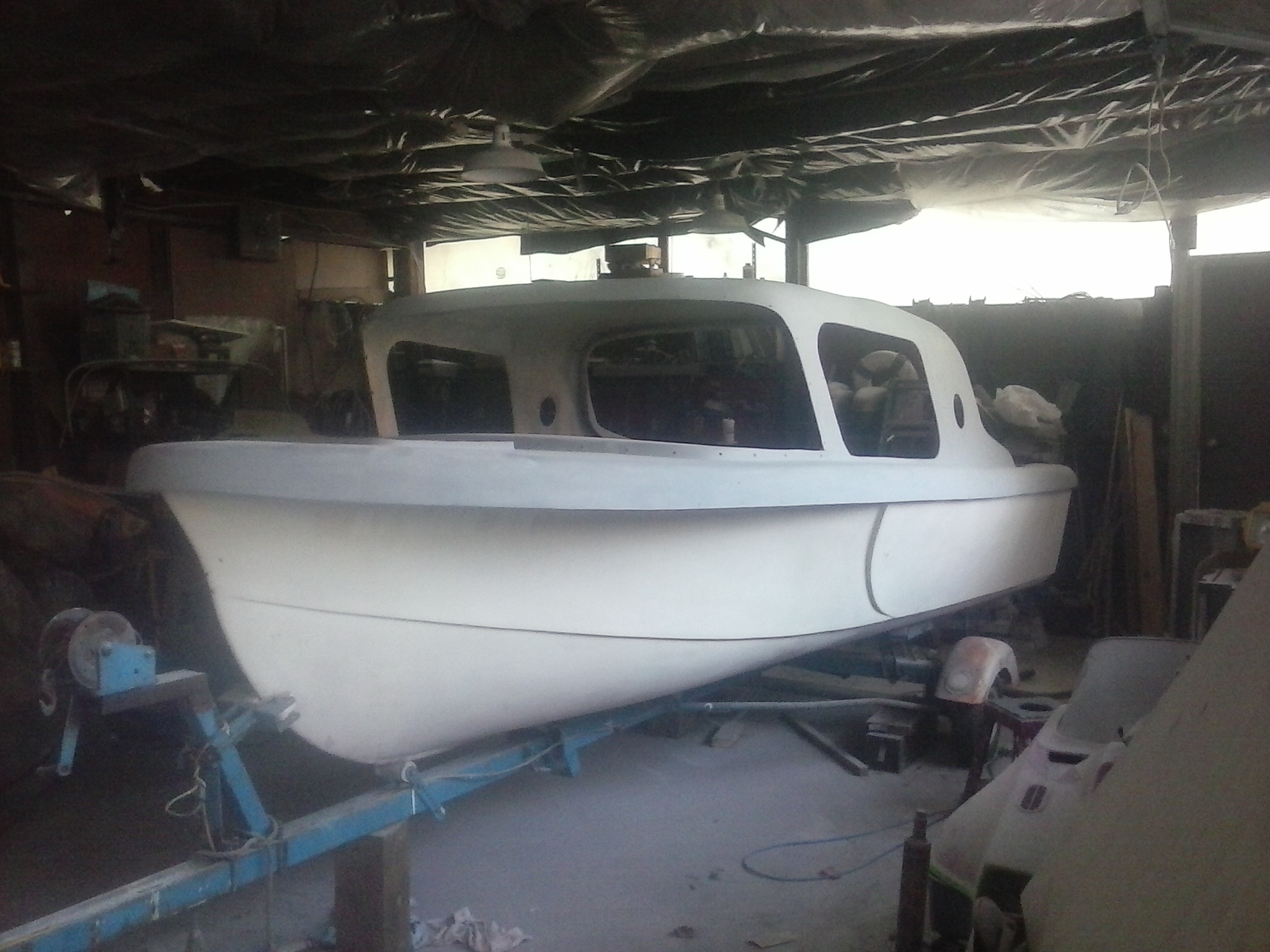

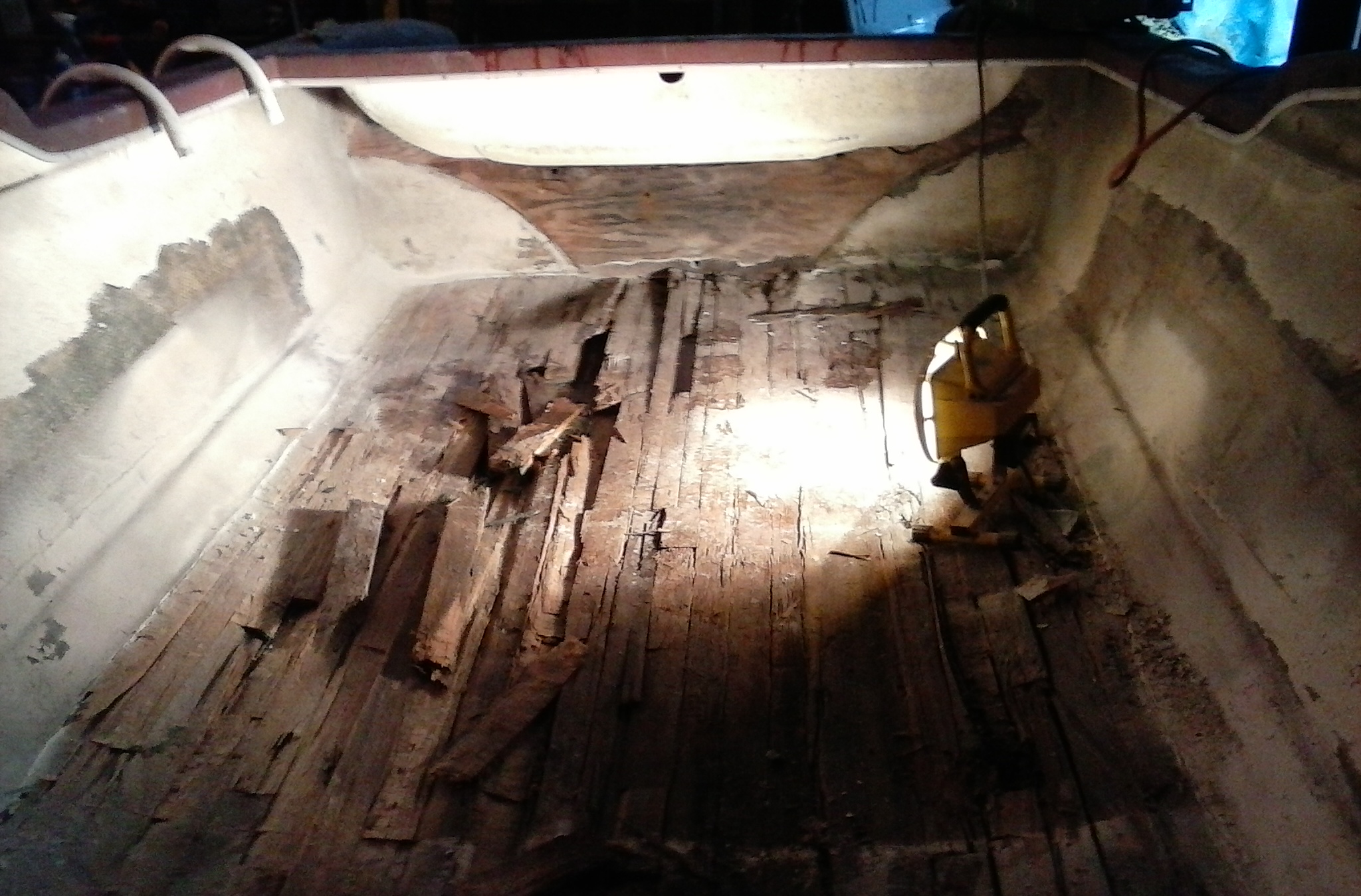

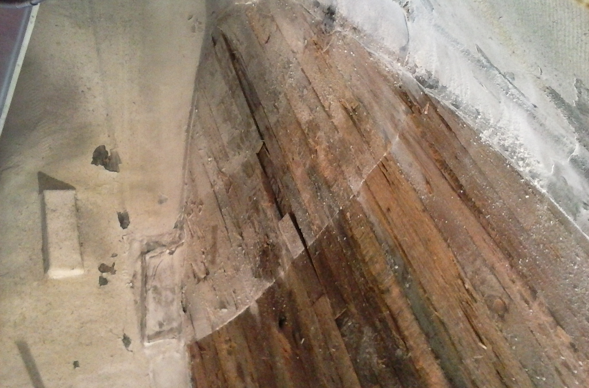

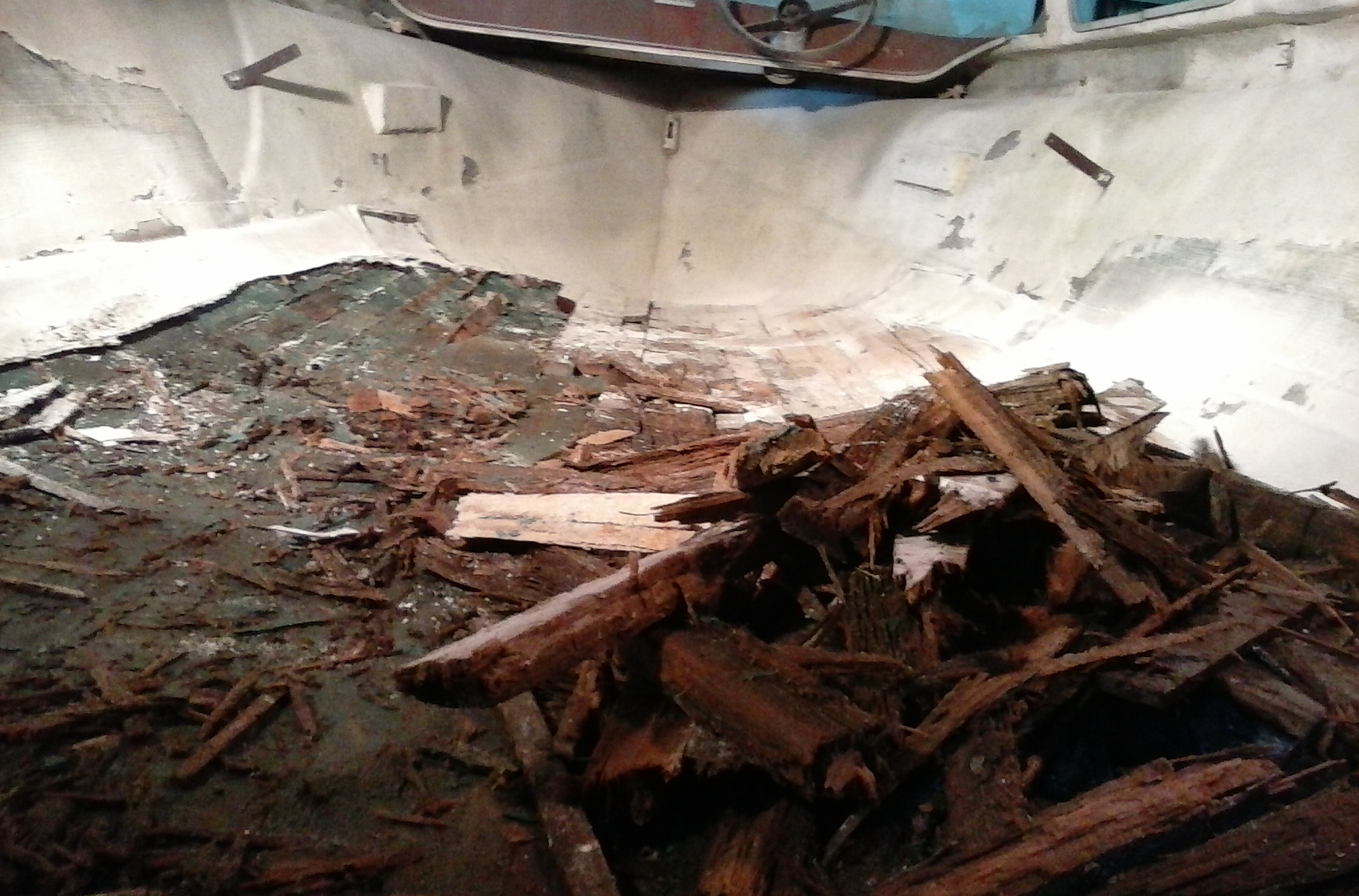

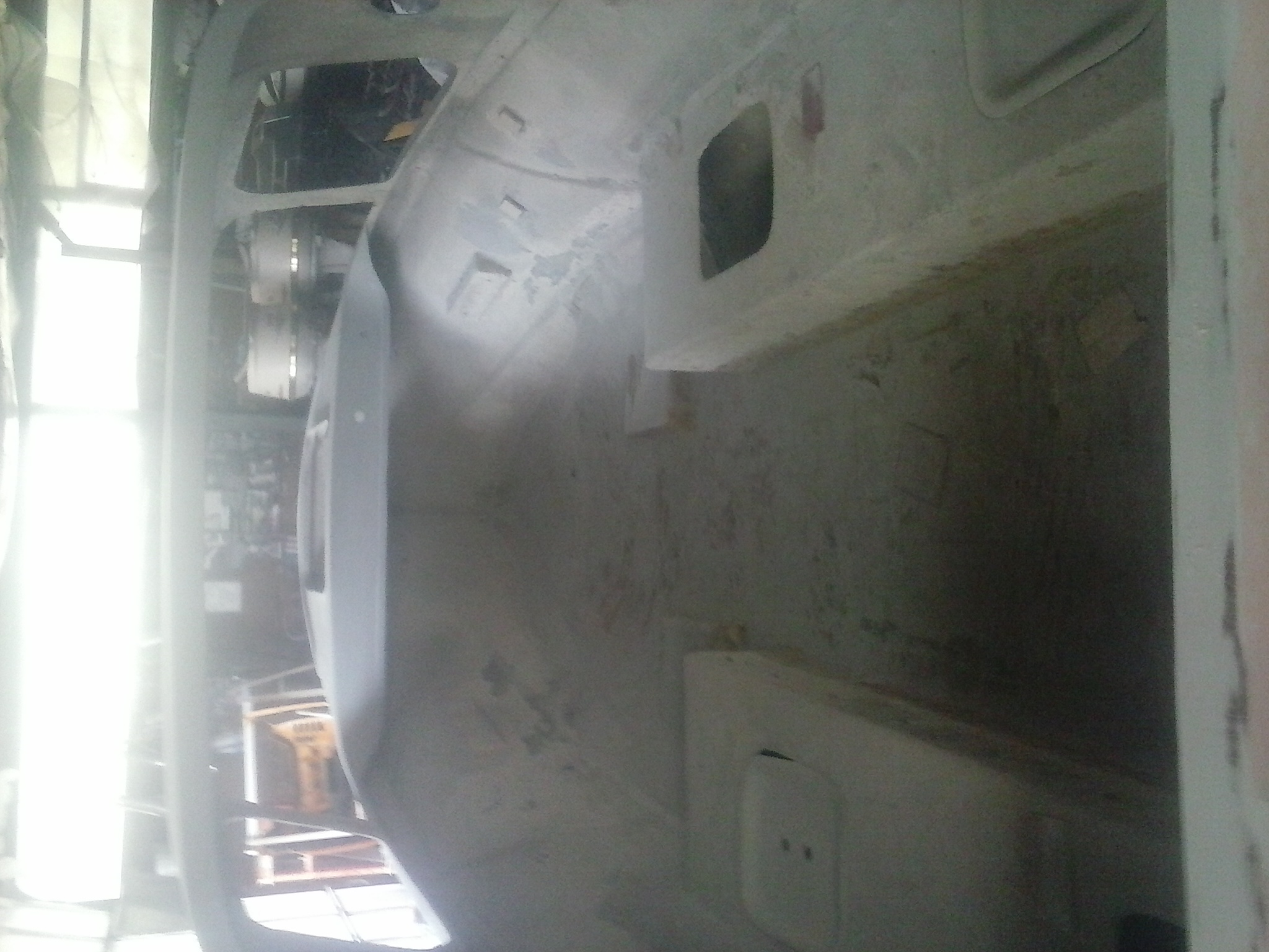

Finally got her in the garage!

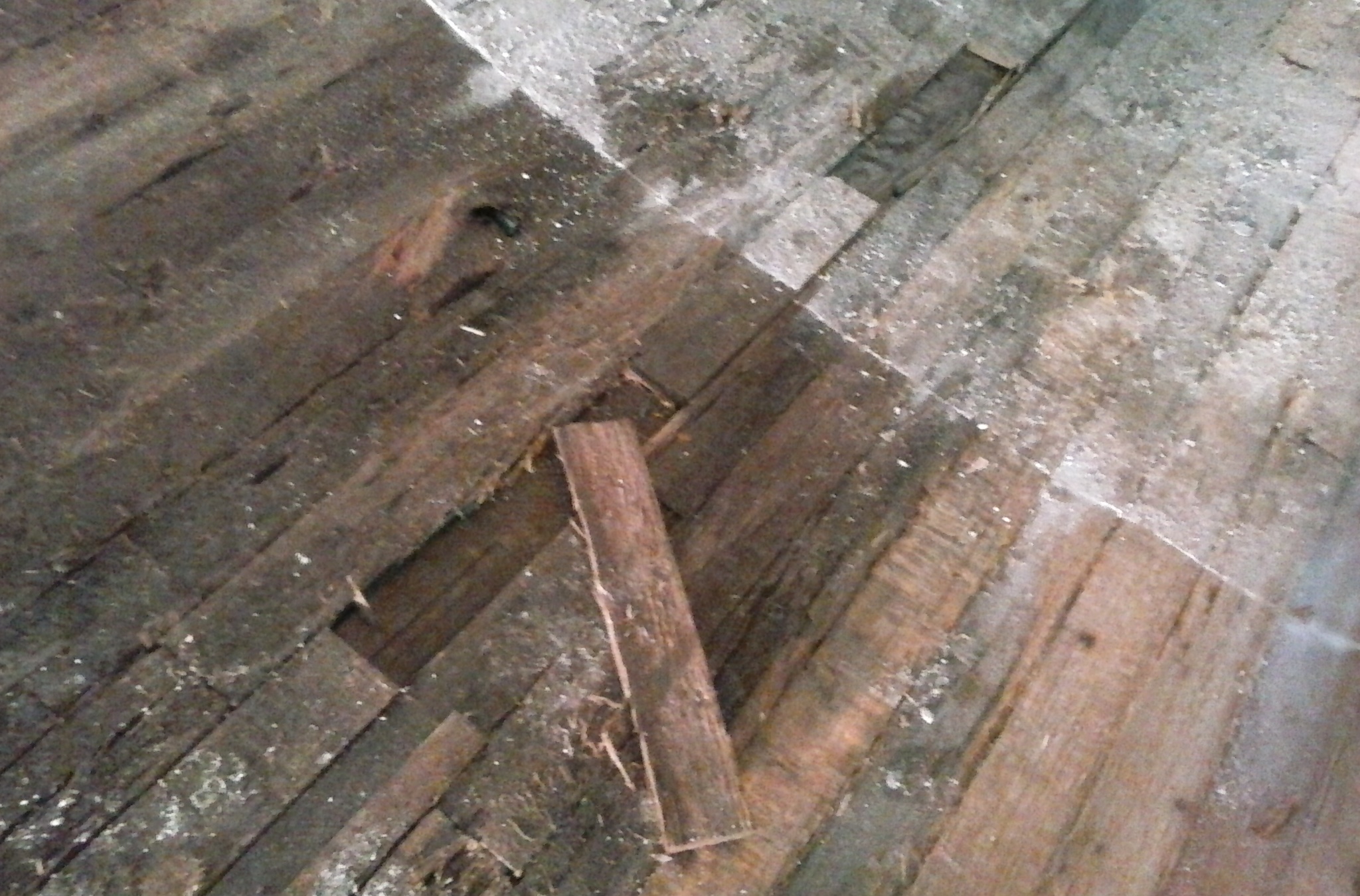

After getting the seat out, I started cutting into the floor!
The floor was very wet and rotten, made for a fairly easy removal!
So now to remove the rest of the transom, I'm thinking of using plywood to put back in the floor? Any thoughts?

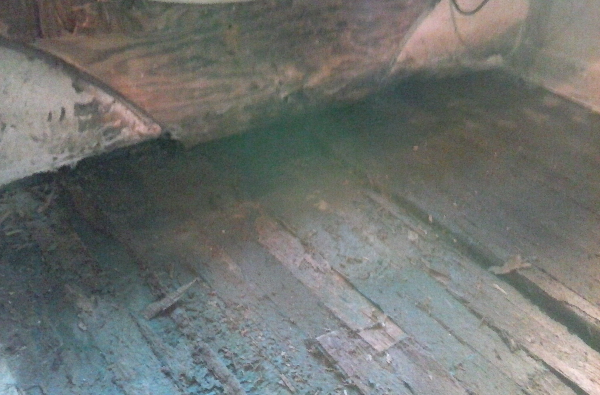

Re:1960 Whitehouse victoria 12 years 2 months ago #98943
What is under those floorboards?
Re:1960 Whitehouse victoria 12 years 2 months ago #98949
  • matty83
  • matty83's Avatar Topic Author
  • Junior Boarder
  • Junior Boarder
  • Posts: 79
  • Karma: 6

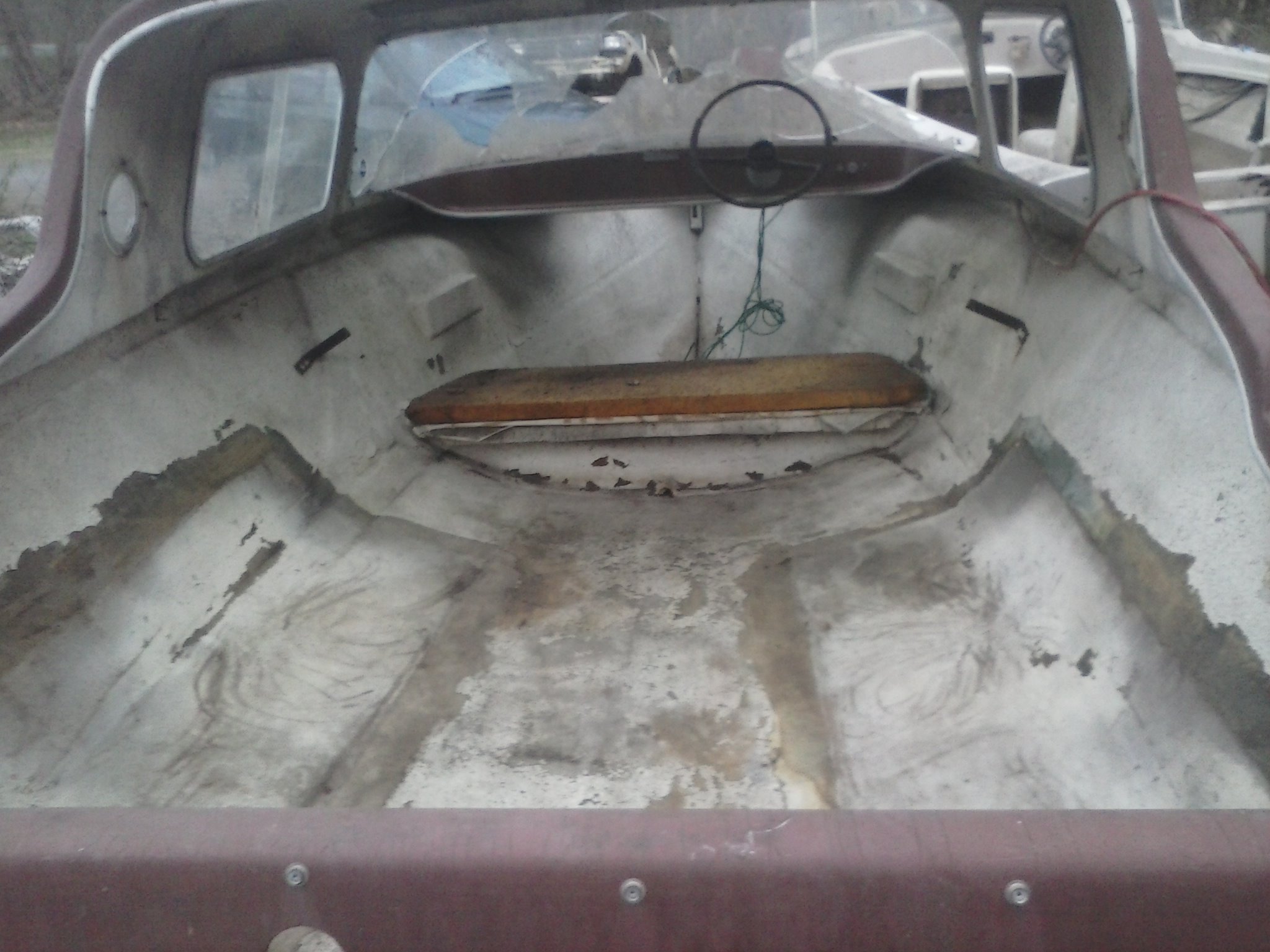

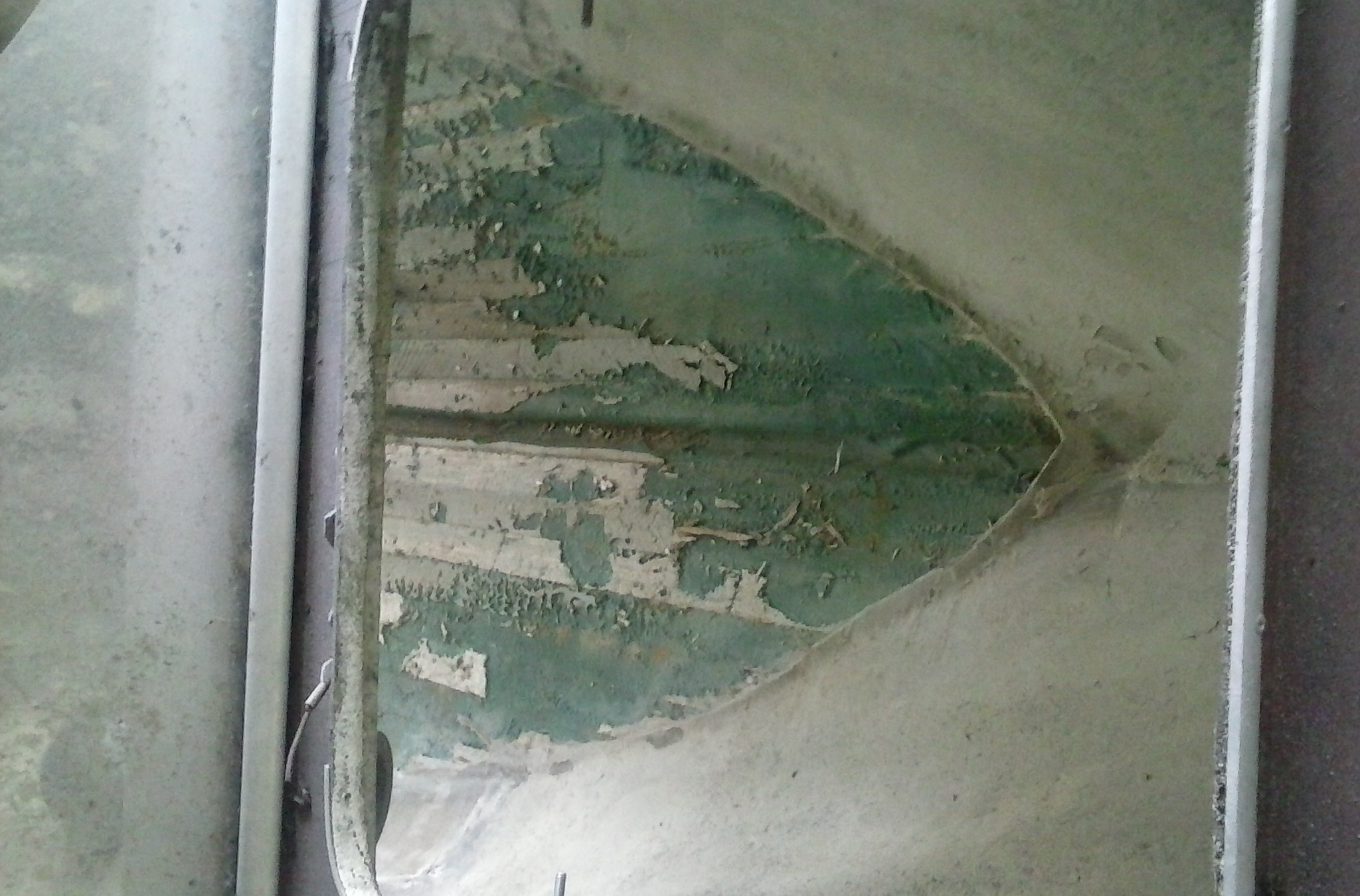

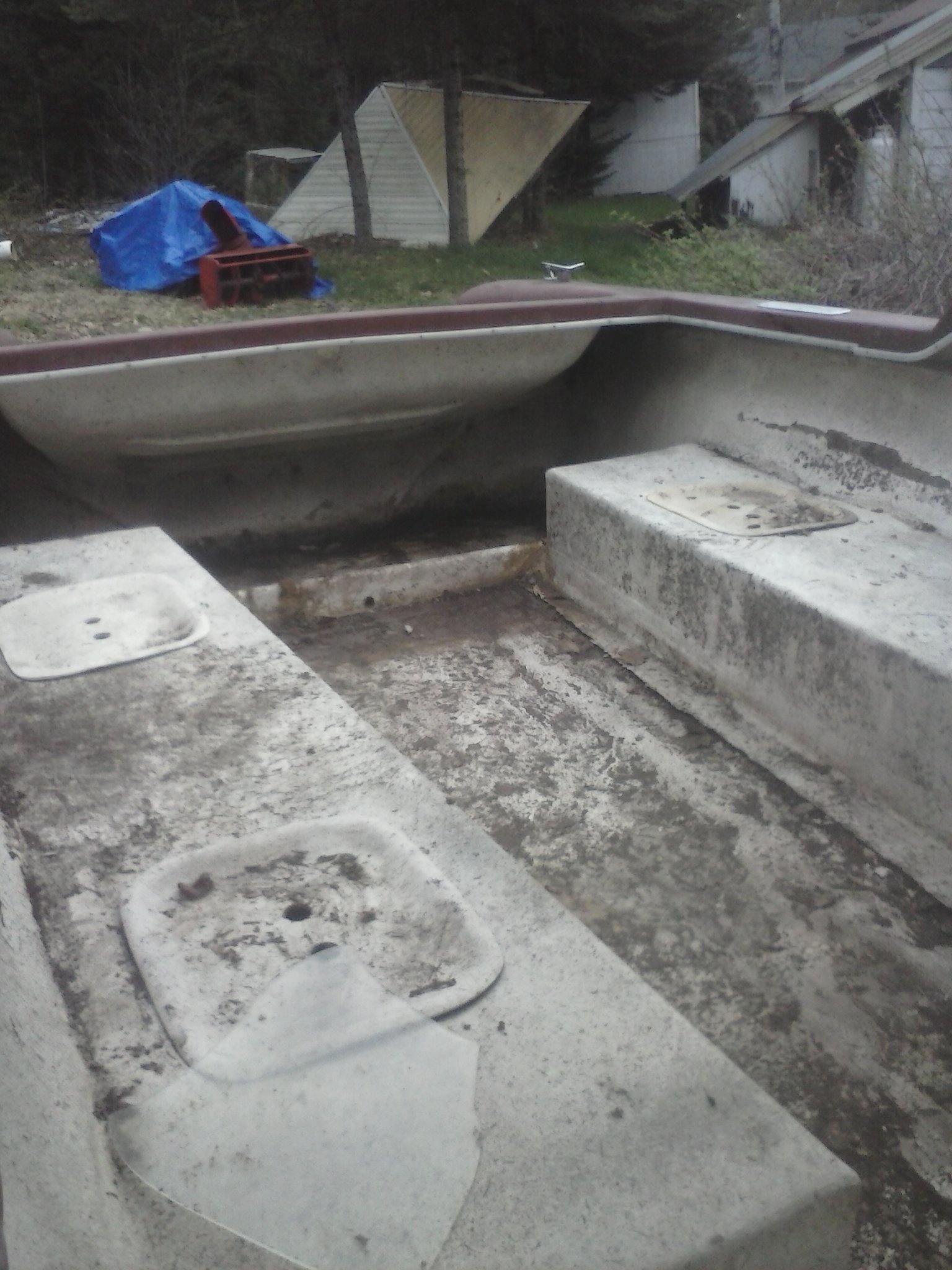

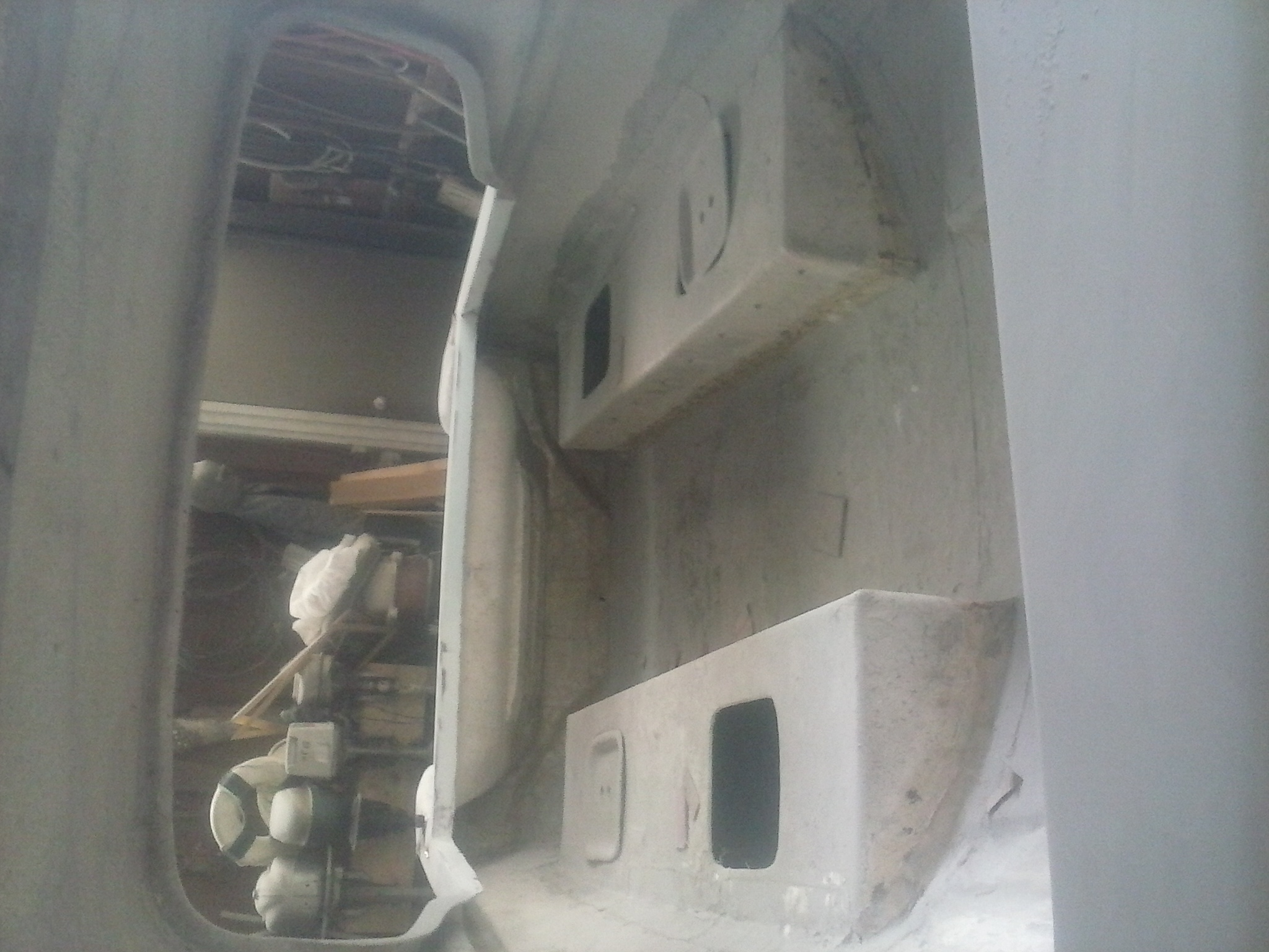

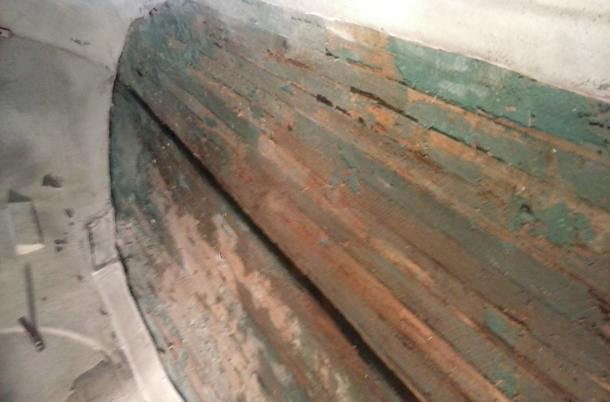

Jim that green color is the bottom of the boat. The floor boards where 3/4 thick by 2in wide. They pretty much covered the bottom with resin and stuck the wood right to the bottom. I'm thinking about 2 or 3 layers of plywood would hold up nicely! And I would be able too make the curve if I put them in one at a time. Matt
Quick pic through the front hatch!

I know it wouldn't be following the original construction Matt, but what about laying down a couple of 1"x2" "stringers", and filling the void between with pour in foam? Maybe some of the gang with more experience can chime in with their opinion, but I'm thinking it might be a good bit lighter than laying in layers of plywood? It might also give you the opportunity to level out the floor some, as well as providing some floatation.
Just a thought, that's what usually gets me in trouble! :laugh:

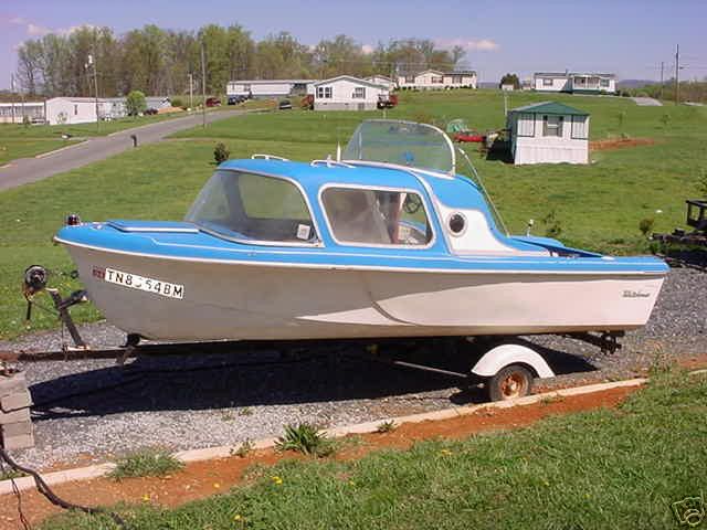

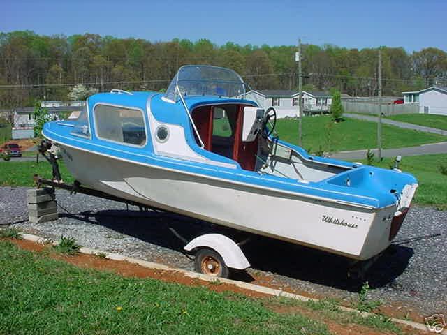

Here's an old ebay photo of a Whitehouse cruiser like yours:
Re:1960 Whitehouse victoria 12 years 2 months ago #99045
  • matty83
  • Junior Boarder
  • Junior Boarder
  • Posts: 79
  • Karma: 6
Awesome pics! Looks like the Polaris model. Thanks Andy!

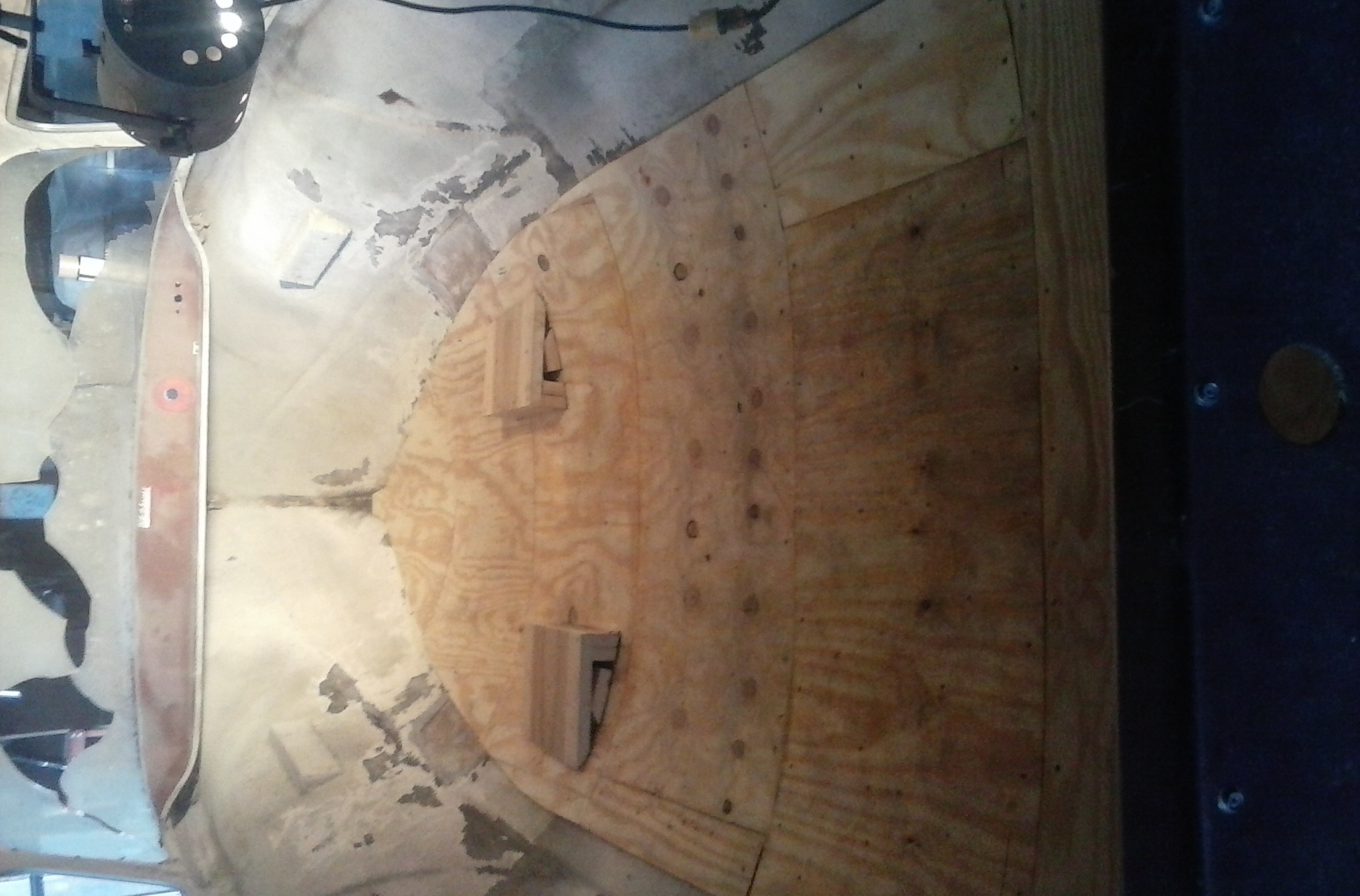

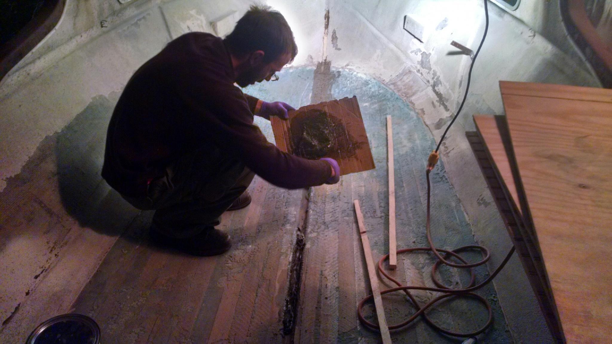

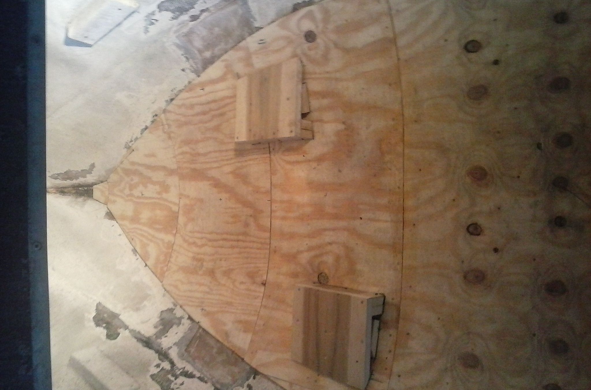

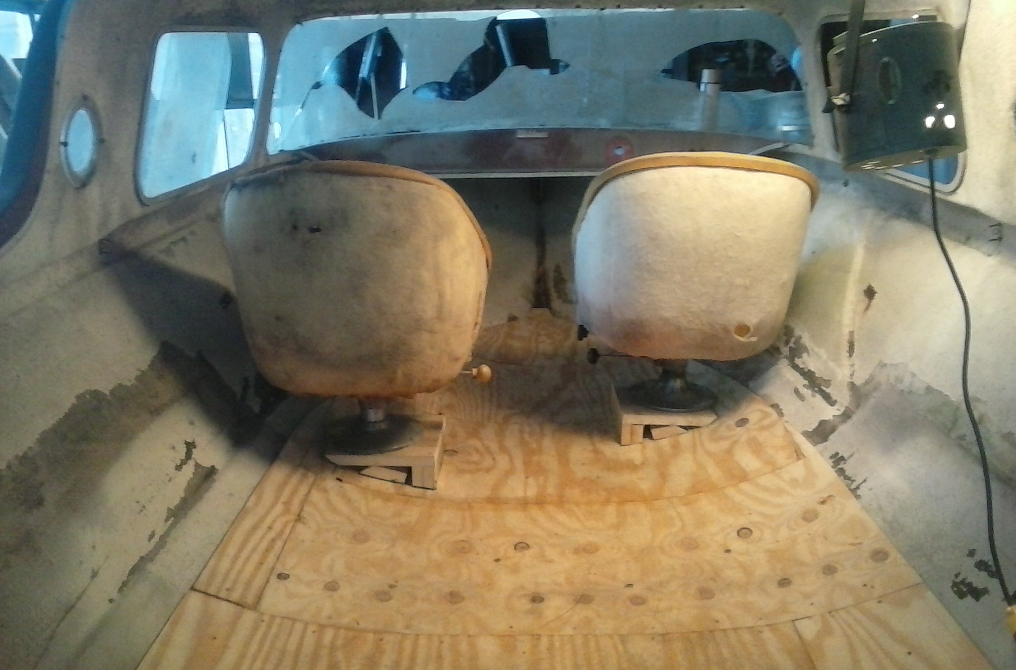

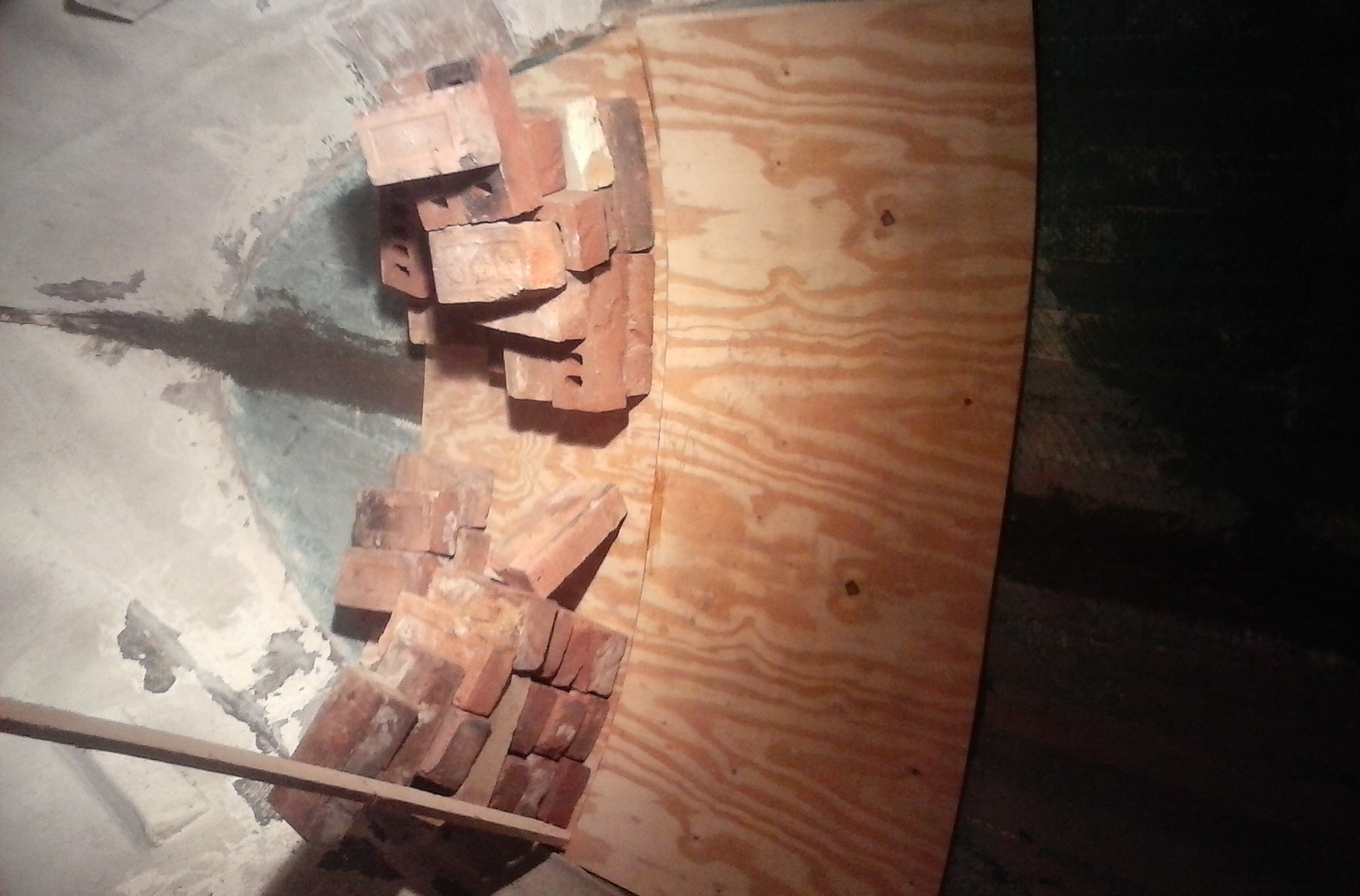

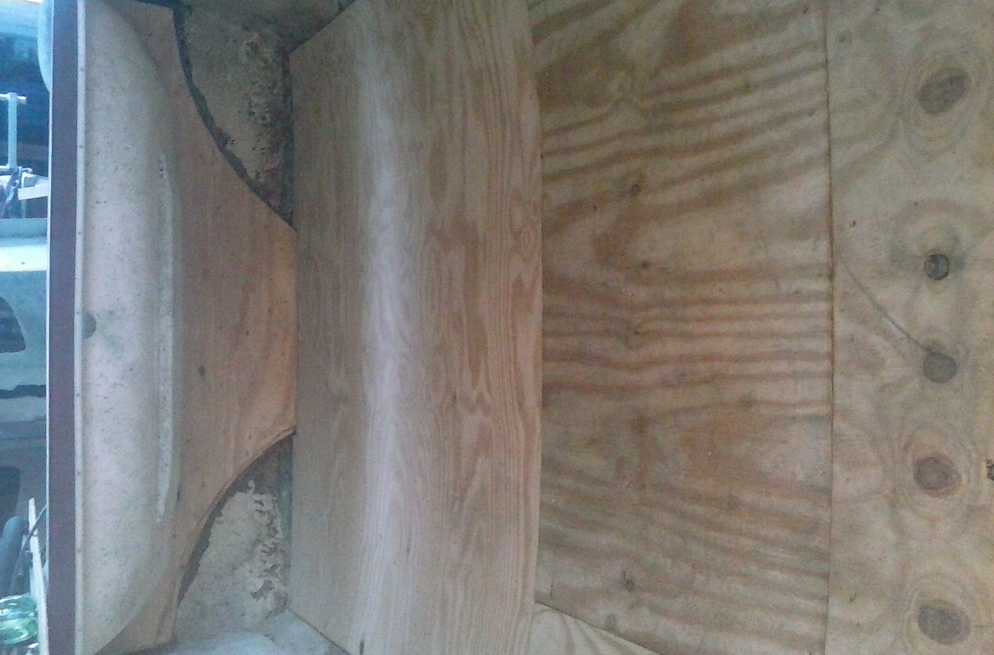

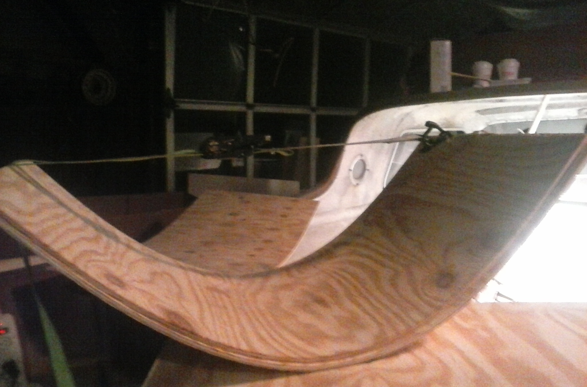

Finally warming up a little bit, so back to work!
Still shooting for mid summer on the lake!
I'm going to layer plywood in the floor, so I needed to fill the spin so that my resin did run out from behind the wood
3/4 X 3/4 strips imbedded in dura-glass worked out nicely!
Some pre bending with a ratchet strap!
Started getting first layer in. I decided to do the first layer with shorter pieces because they bend easier. I hope to get all the floor in this coming week, then hopefully pedestals for my captains chairs!

Re:1960 Whitehouse victoria 11 years 6 months ago #108462
  • matty83
  • Junior Boarder
  • Junior Boarder
  • Posts: 79
  • Karma: 6
Finally got all the wood in! B) the transom came out great! the pedestals should work out great as well off set for leg room and comfort. Recycled captains chairs! They look like a heap now but they'll look like a million bucks later! Hopefully I will be able to start glassing the floor this weekend, 2 layers of wood and 2-3 layers of glass should strengthen her up nicely!

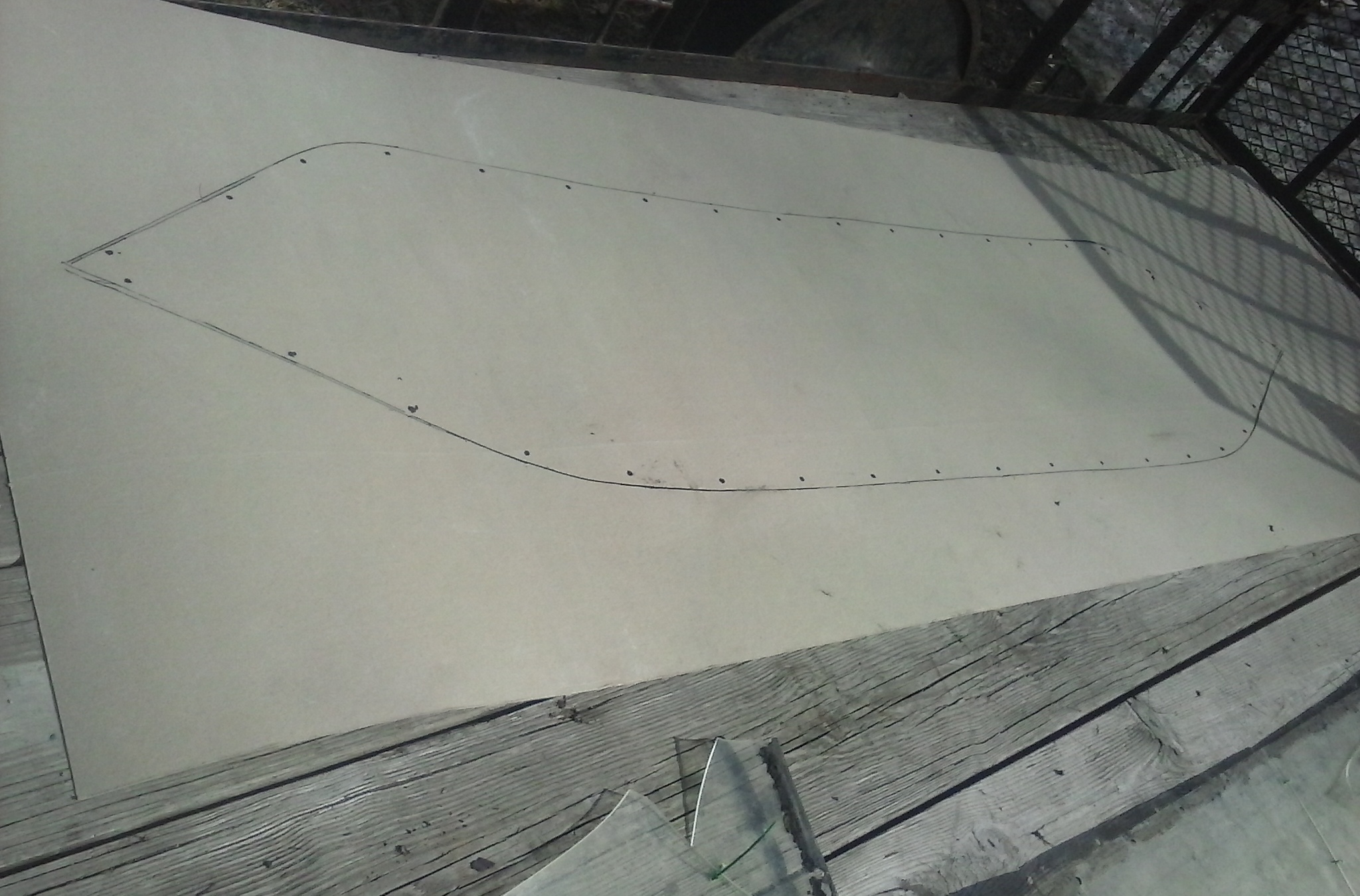

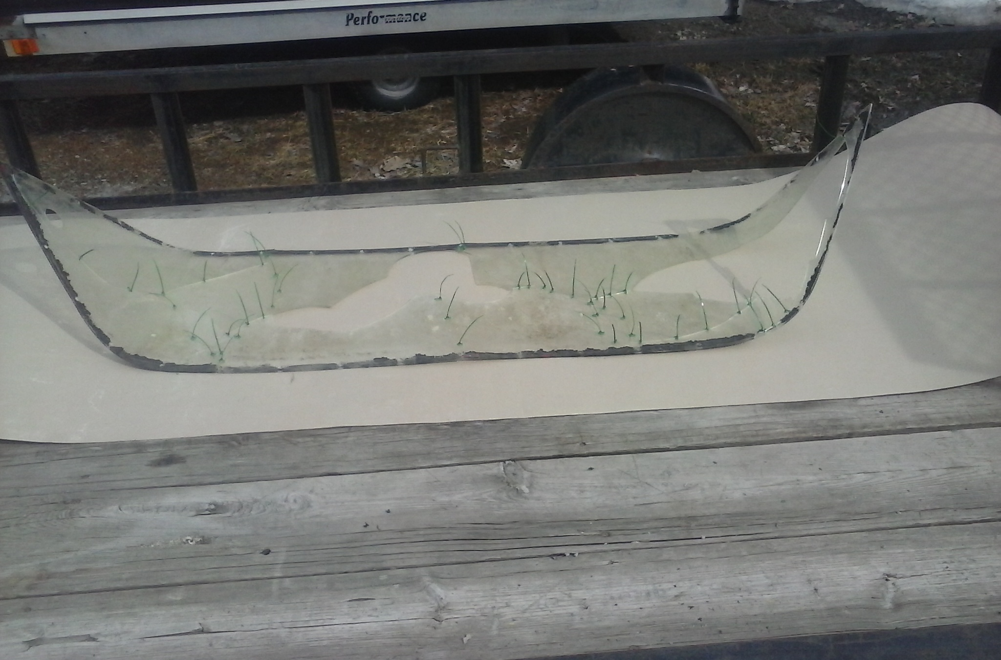

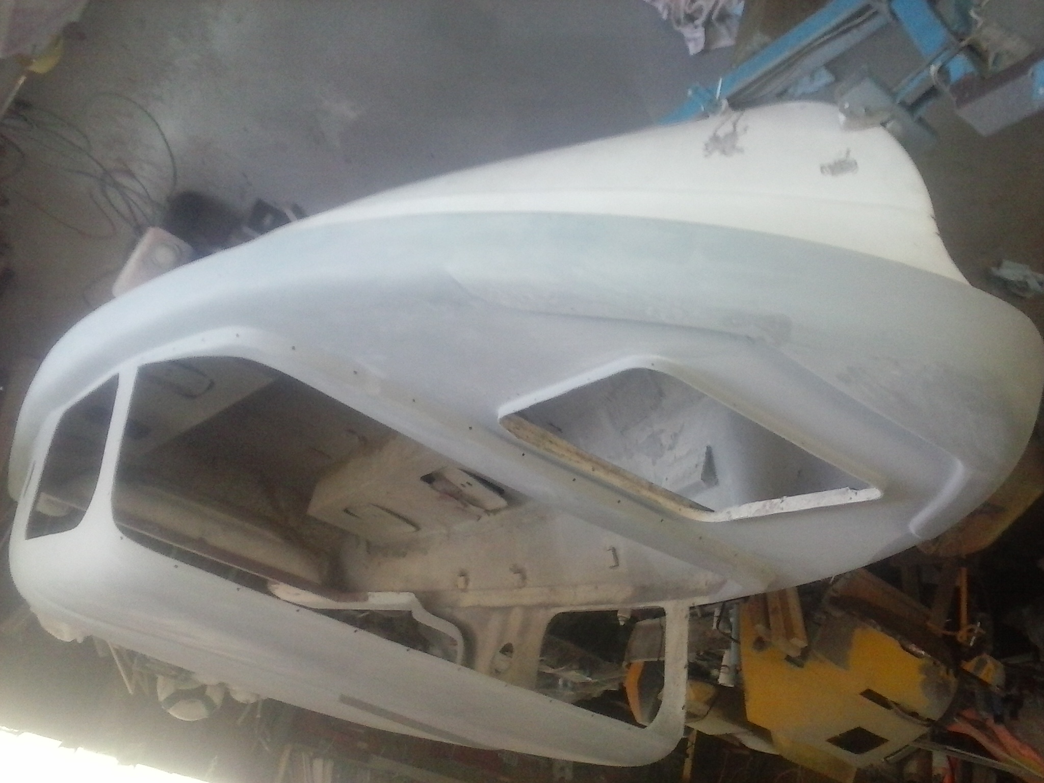

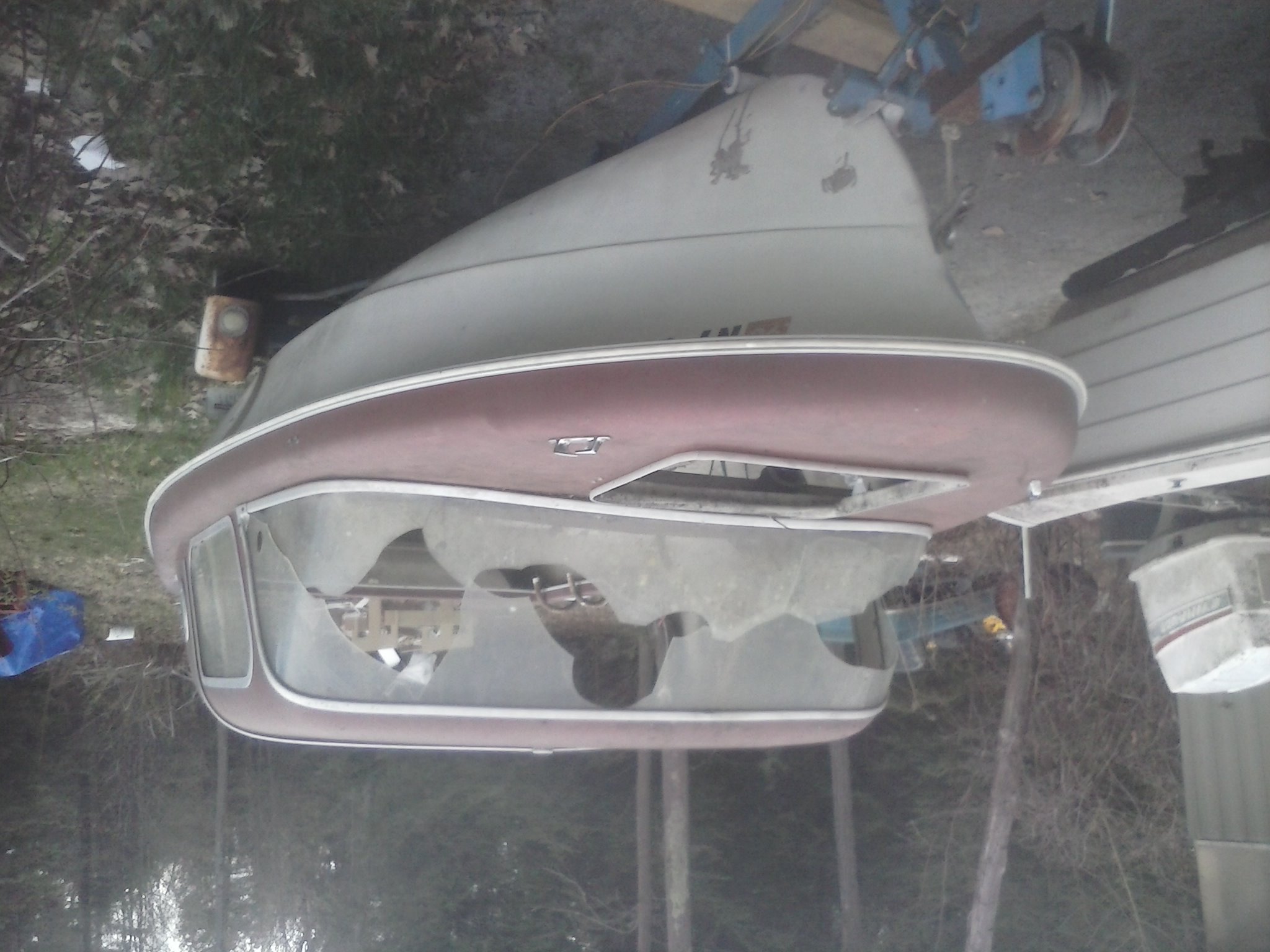

I figured while I was fiberglassing I'd give the windshield a go! Surprisingly I had enough of the windshield left to zip tie and make a pattern. Wish me luck! Matt
Actually the pattern came out decent.think I'm going try Polly carbonate instead of plexiglass.

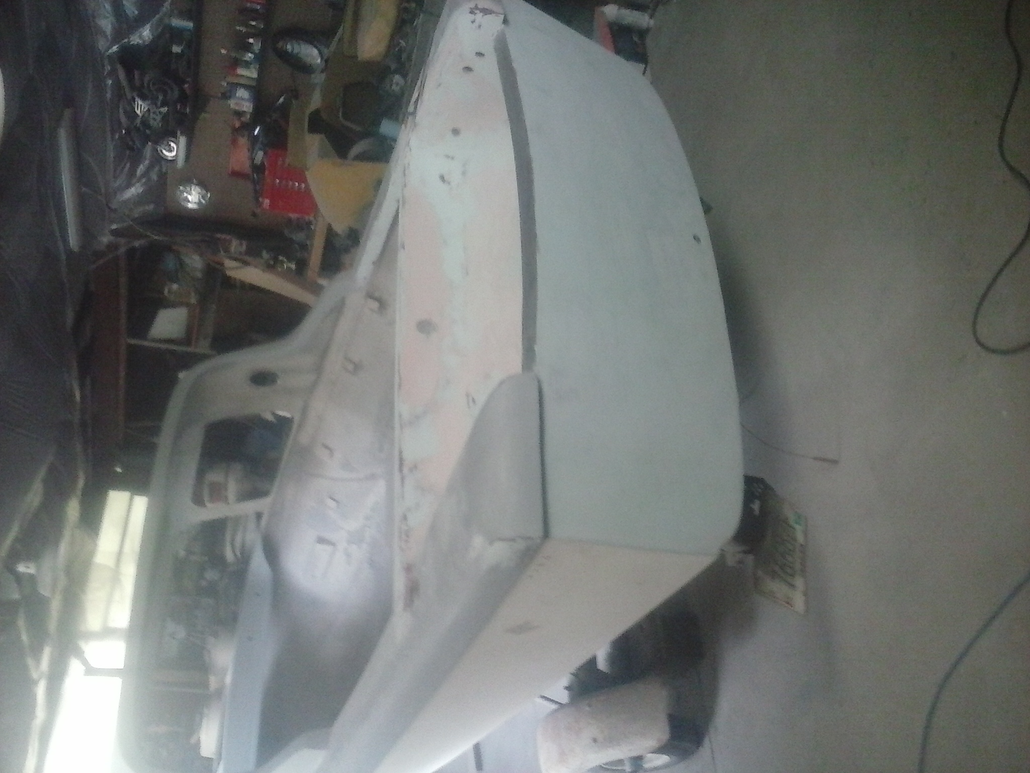

1960 Whitehouse victoria (just about done!) 9 years 1 month ago #134189
  • matty83
  • Junior Boarder
  • Junior Boarder
  • Posts: 79
  • Karma: 6
Been a long haul but she about ready for water!

1960 Whitehouse victoria 9 years 1 month ago #134191
  • Dr.Go!
  • Dr.Go!'s Avatar
  • Posts: 1719
  • Karma: 19
  • Thank you received: 125
Wow-that looks great! Nice work. Can't believe I missed this thread. You have accomplished a ton of work. Congratulations and hope you are one the water soon!

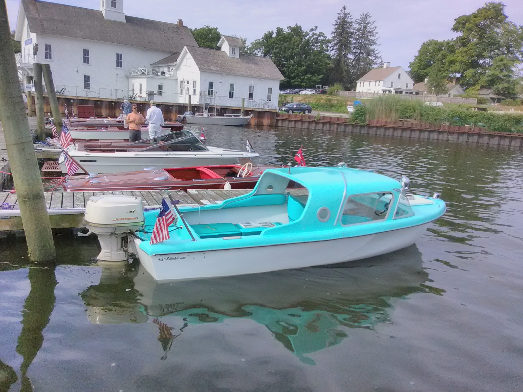

1960 Whitehouse victoria 8 years 3 months ago #137029
  • matty83
  • Junior Boarder
  • Junior Boarder
  • Posts: 79
  • Karma: 6
I attended the 34th vintage treasures, aka mahogany memories last weekend. What a great time we had, awesome venue, great bunch of people, and of course slot of great boats! It was such a long and stressful road to get her theree, but she did great. Second place outboard and people's choice! A week later and I'm still on cloud nine!
1960 Whitehouse victoria 8 years 3 months ago #137031
  • Dr.Go!
  • Dr.Go!'s Avatar
  • Posts: 1719
  • Karma: 19
Wow - thats a beauty. Congratulations on the awards showing your hard work paying off. That is a really sharp rig you have there. Enjoy the fruits of your labor and thanks for sharing!
