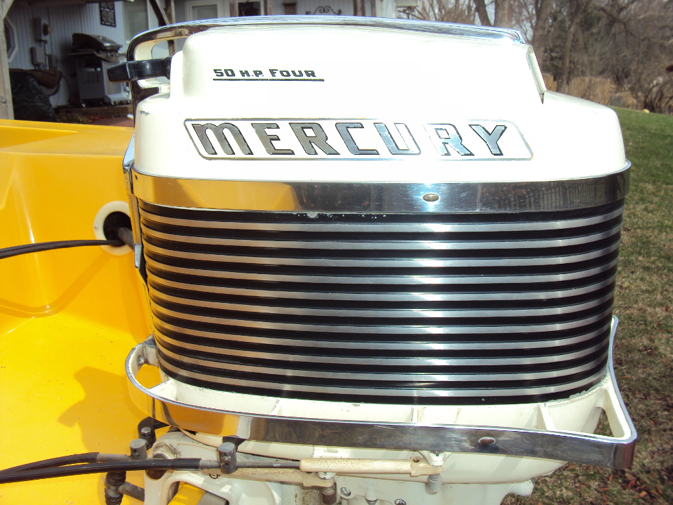

Thanks to you and Frog for the welcome.

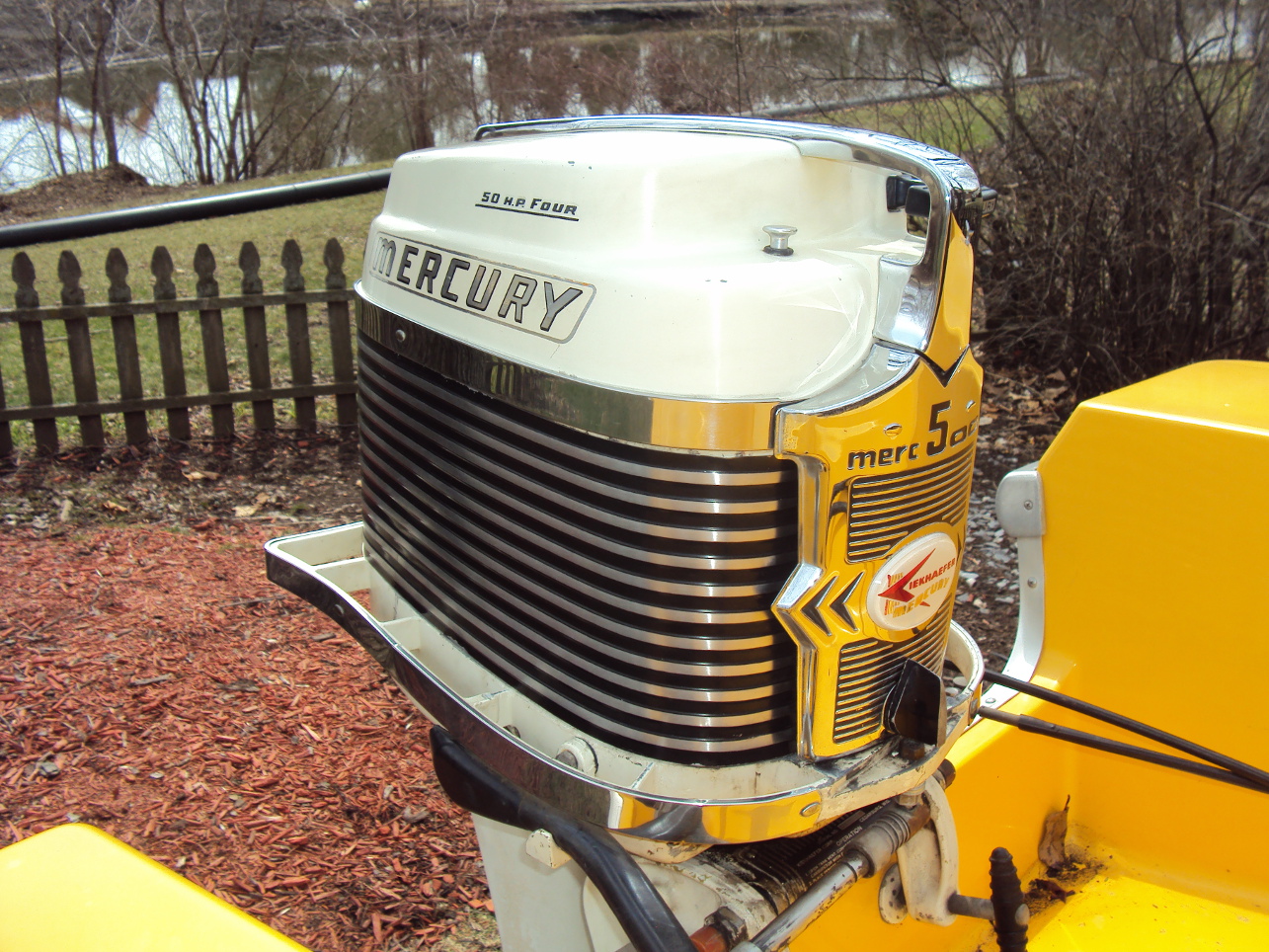

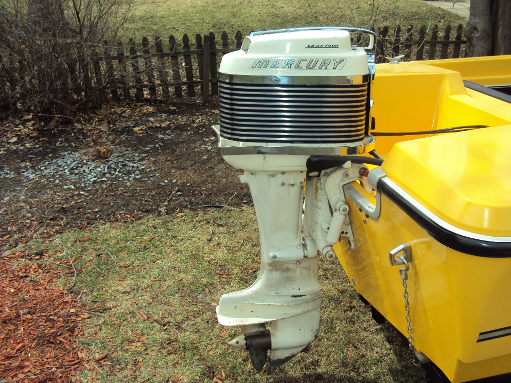

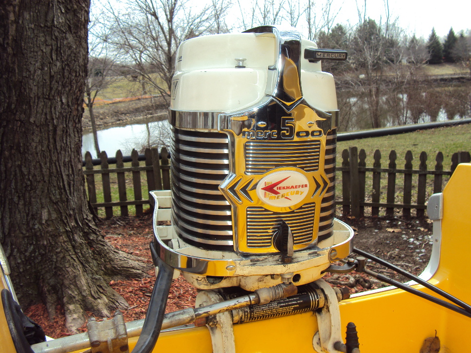

Here is the motor I have to complete the restoration.
"ain't she purdy"
1961 Merc 500 50HP FGS [img] [img]http://www.fiberglassics.com/media/kunena/attachments/legacy/images/DSC06801.JPG
Re: 1959 Glastron Fireflite total restoration 12 years 6 months ago #93259
  • SteveH
  • SteveH's Avatar
  • Posts: 413
  • Karma: 11
Beautiful motor!

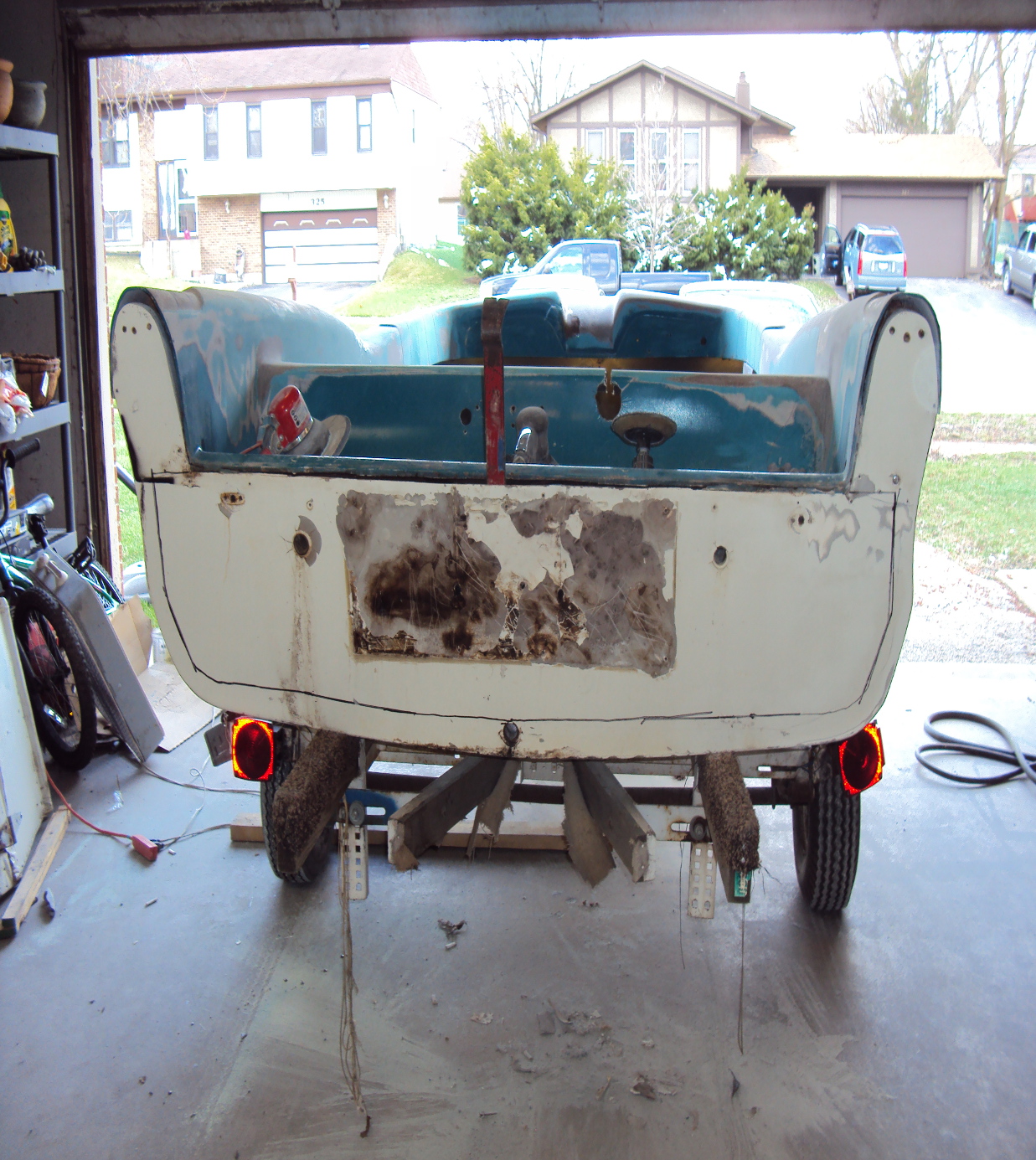

Re:1959 Glastron Fireflite total restoration 12 years 6 months ago #93283

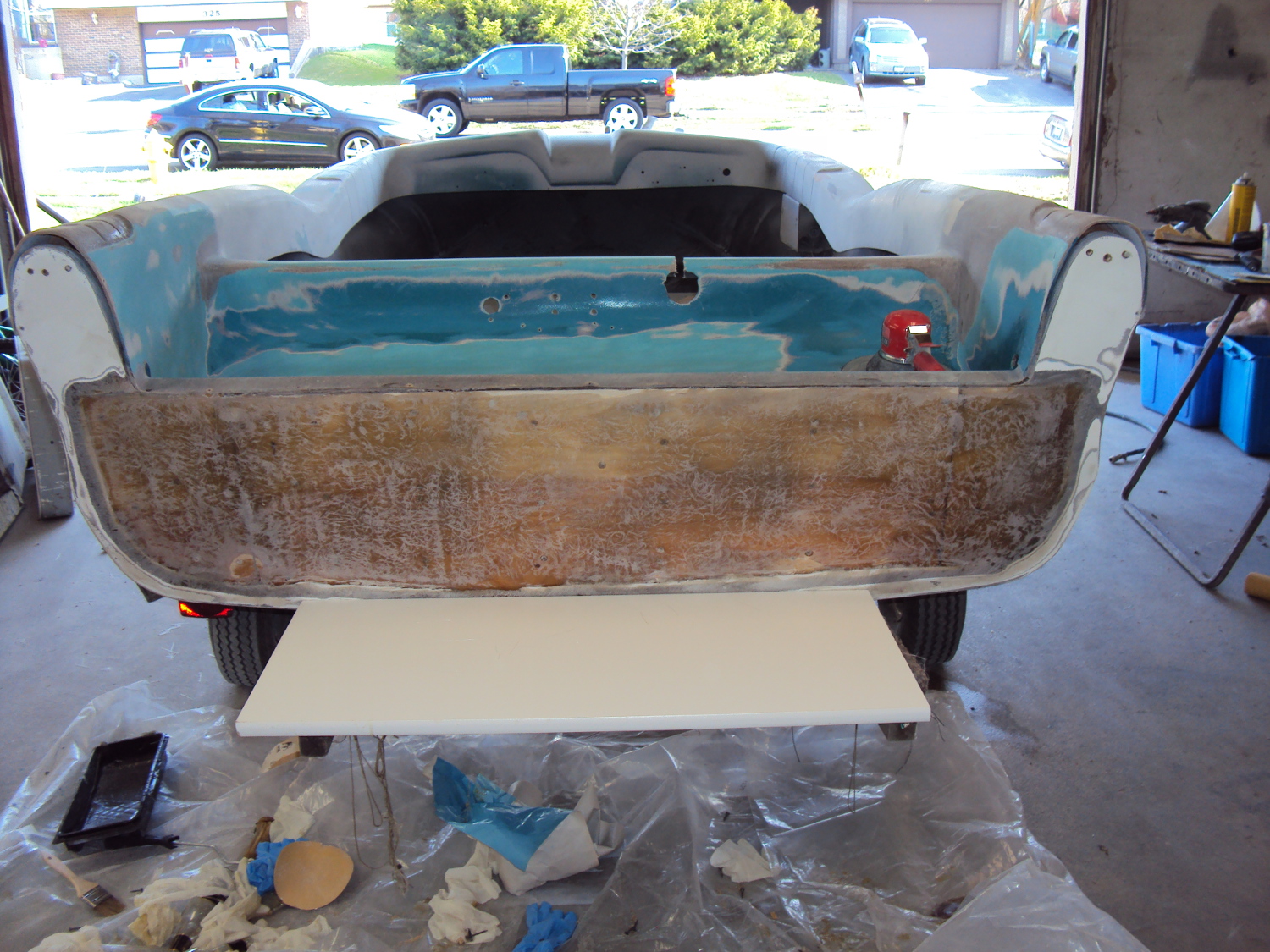

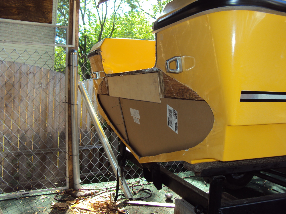

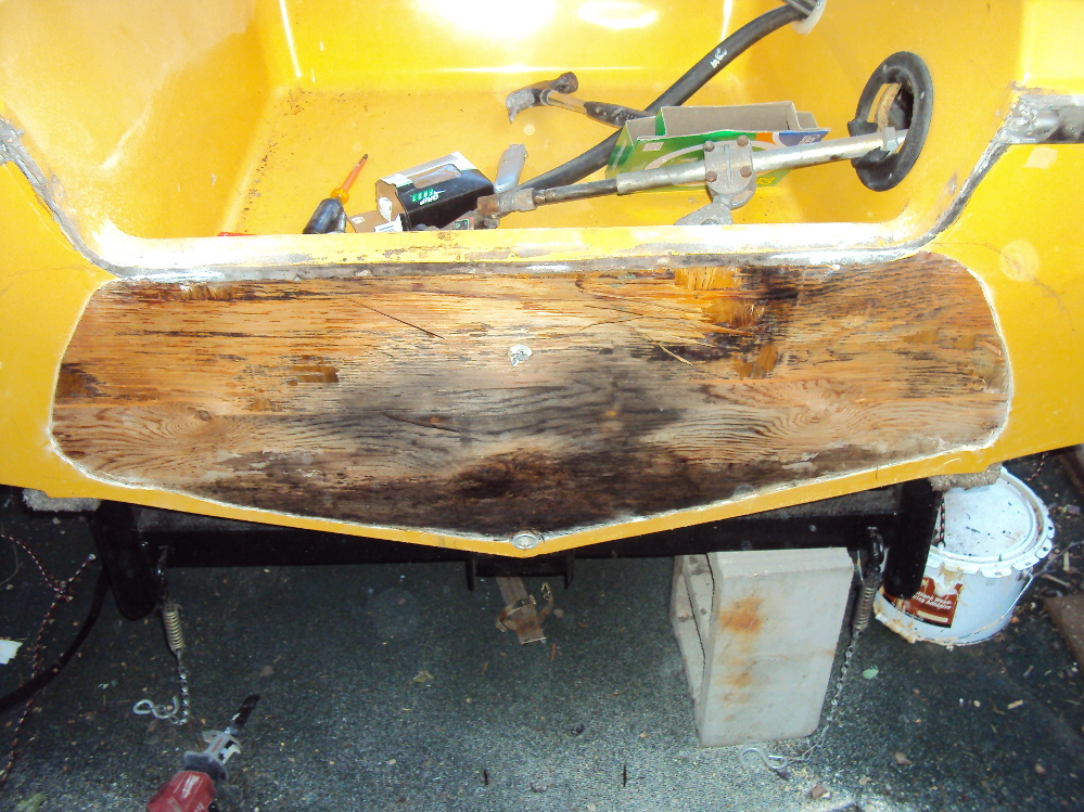

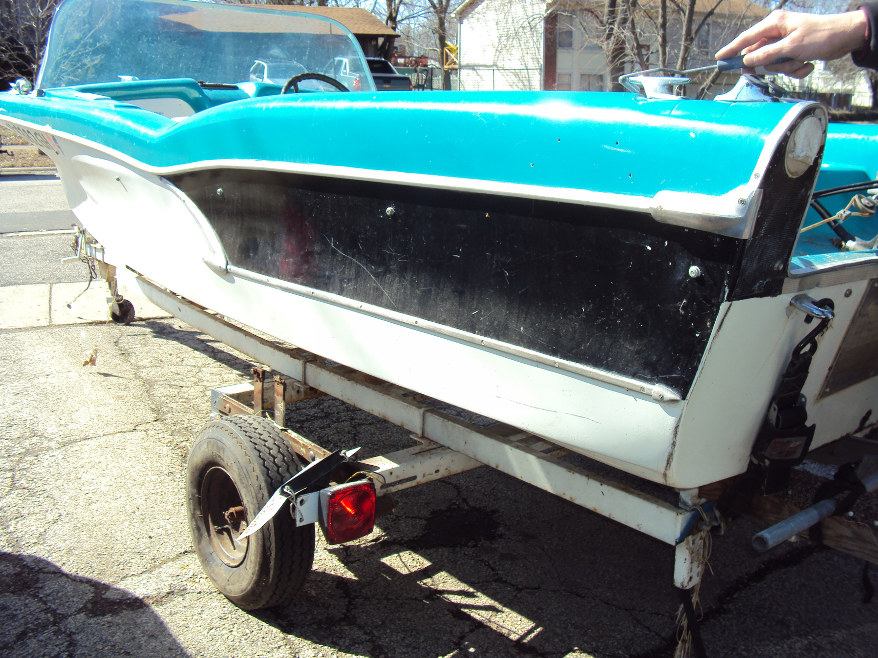

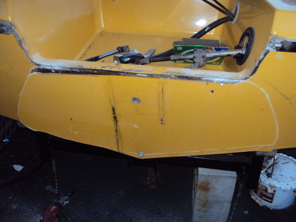

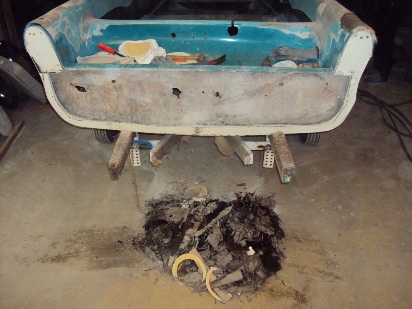

Lets take a look in here >>>>>>>>>>>>>>>>>>>>>>>

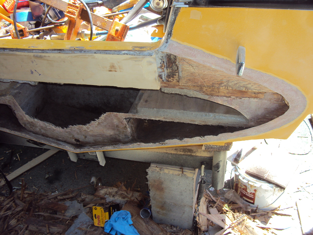

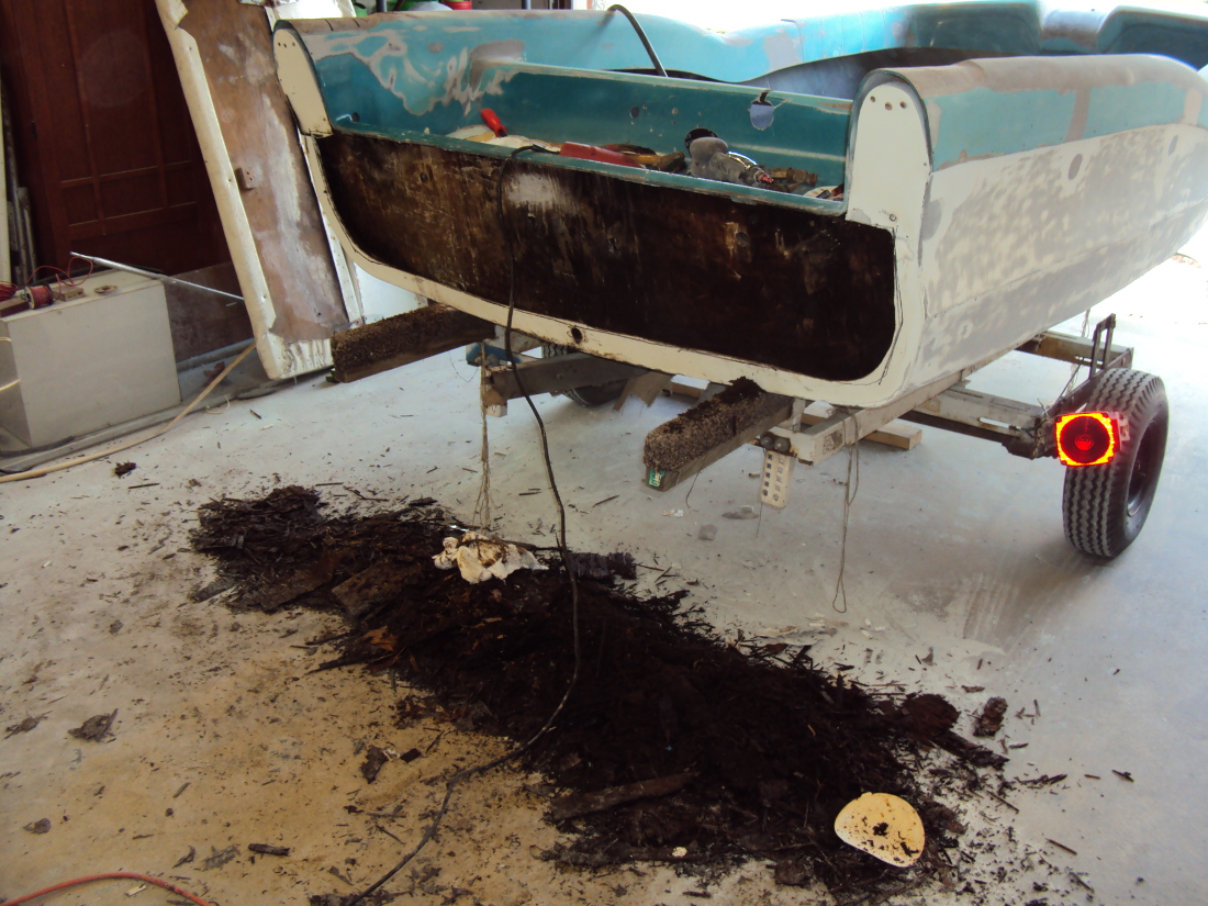

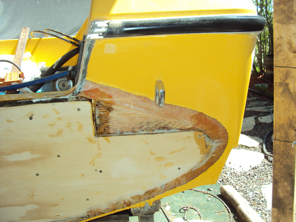

Is the transom "shot" ?
Never paid attention when I was 16, when I purchased it. Just wanted to get on the water and pick up babes.
Now 34 years later we are gonna do a mega restoration.
a closer look ?
It's SSSSSSSHHHooooooooooooooooooooT !
Marked for cutting Is there a cry icon ? Boo hoo as there is only sawdust.

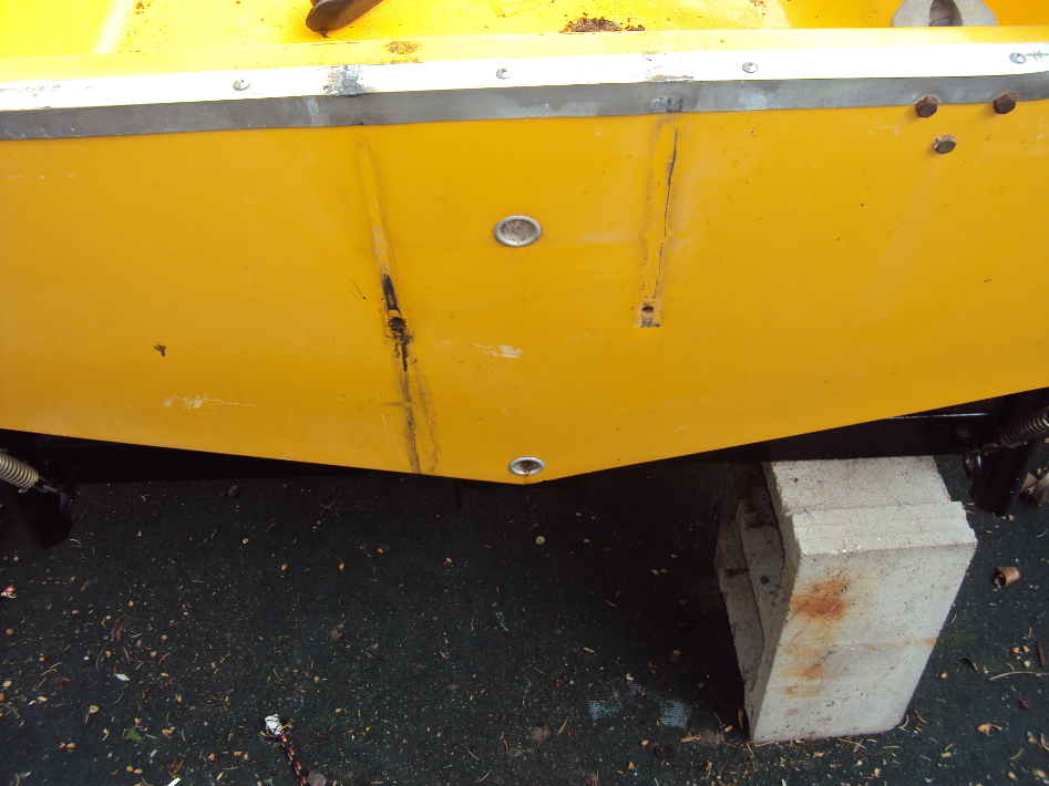

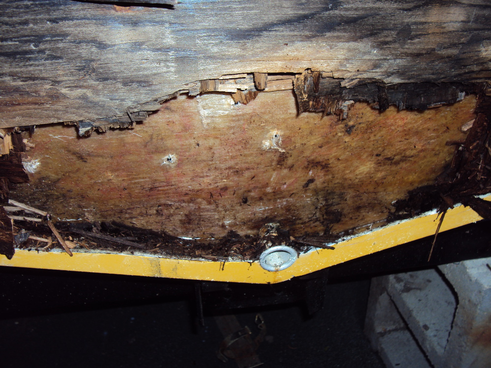

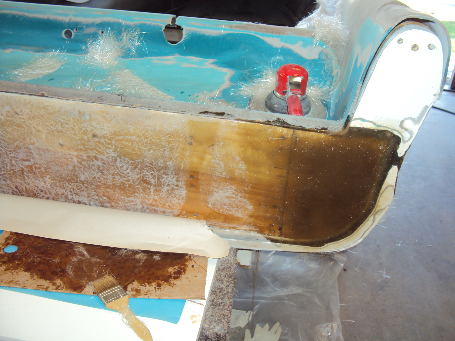

My guy that is doing this restoration is a personal friend and has glasswork running throughout his family 'experts' he says "no problem" "easy buttons"
Could this screw have been "sabatoogie" May have started the whole transom rott ?

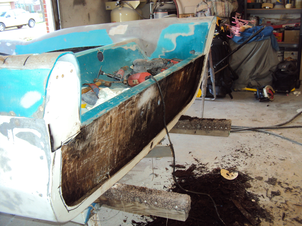

All surfaces and substrates abraided with proper profile ready for rubdown of acetone and fiberglass/wood transom rebuild.
All grinding complete with debris

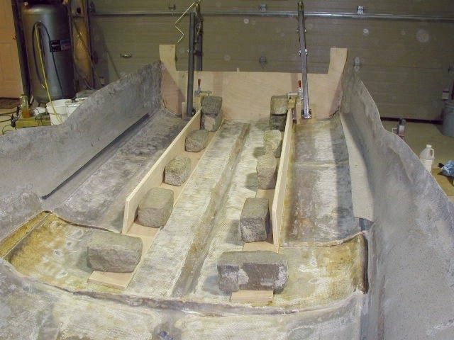

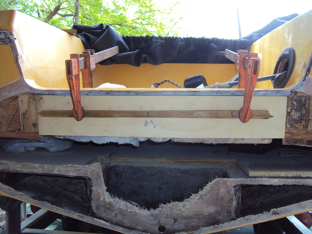

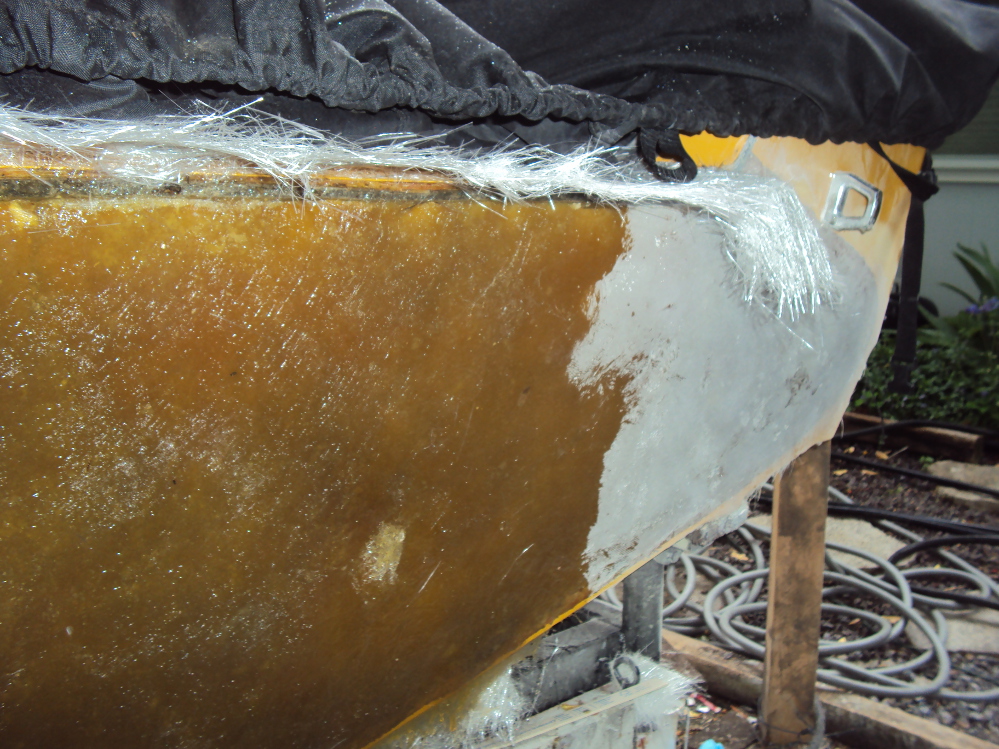

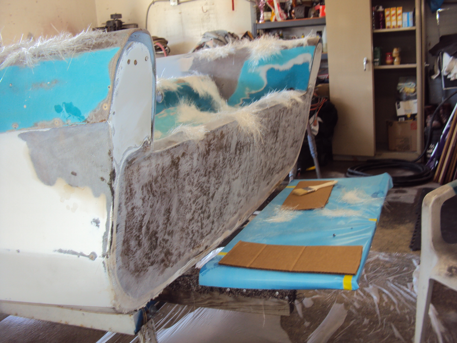

Re:1959 Glastron Fireflite total restoration 12 years 6 months ago #93290

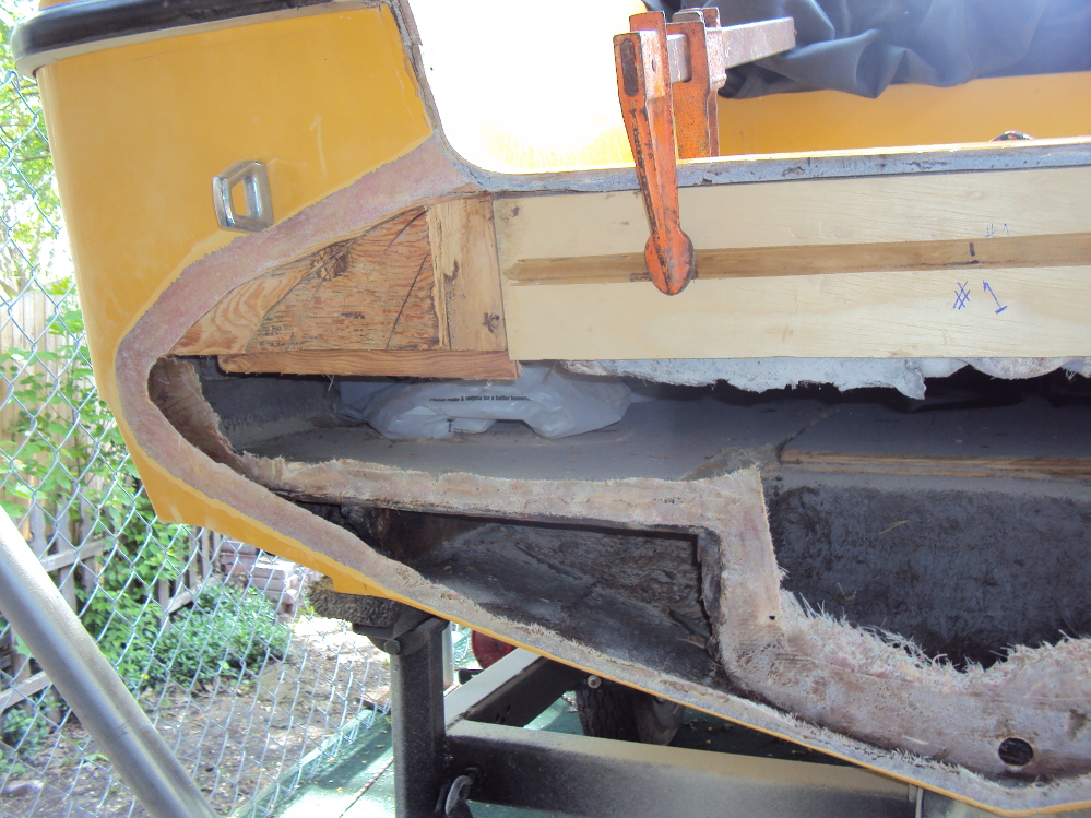

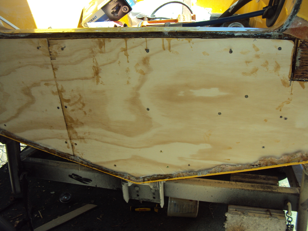

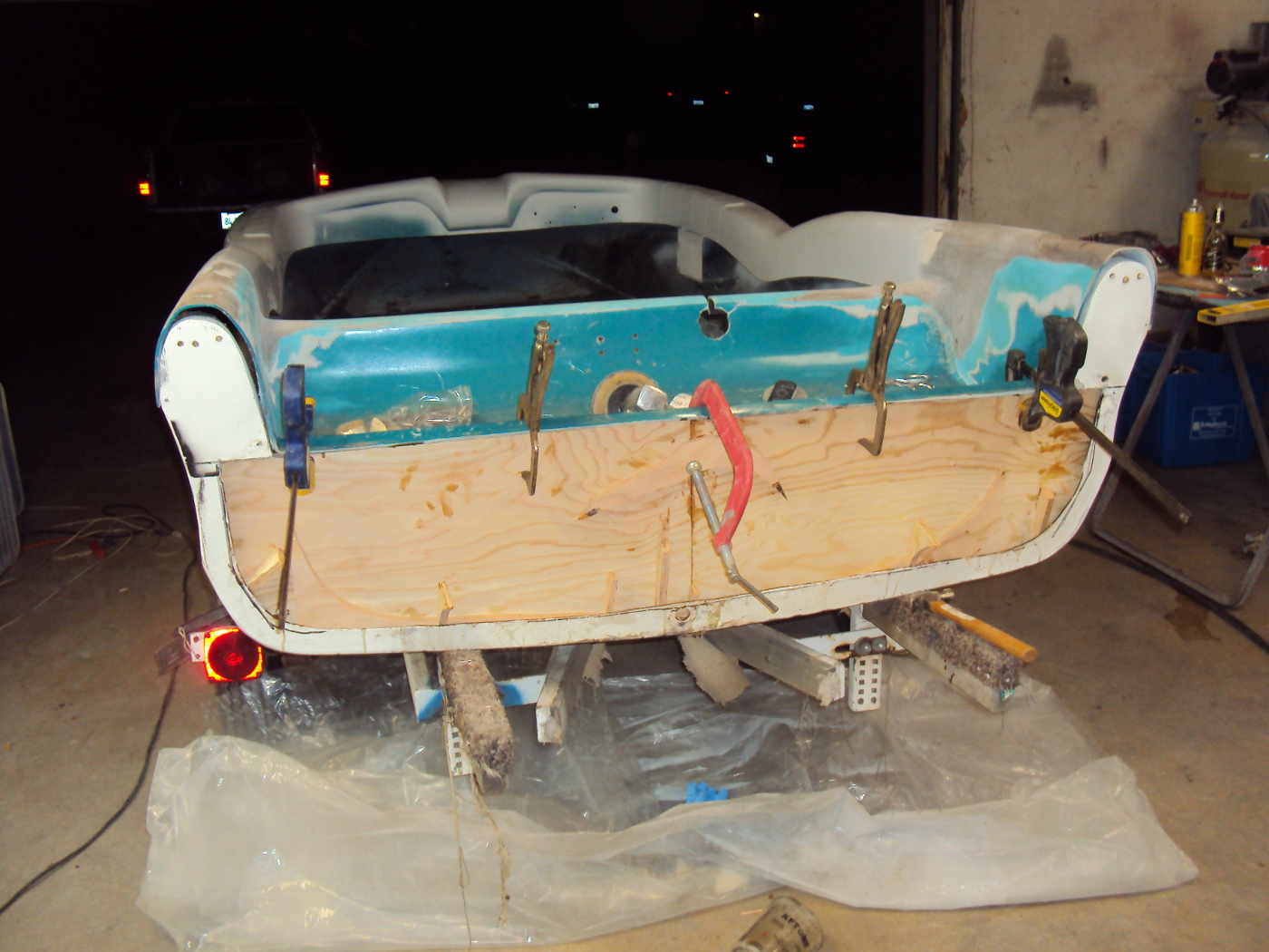

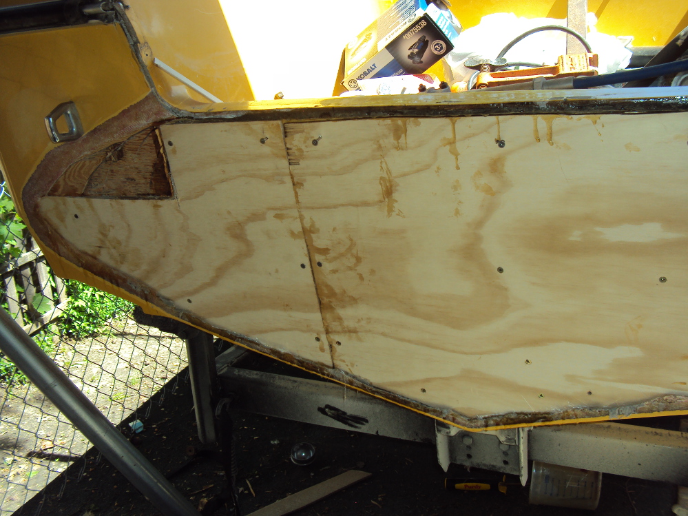

Rebirth of the ark ! My guy says "watch this" I said watch what ? he said were gonna build the transom back better than the original by making a 1-3/4" thick laminated beam using 1/2" marine plywood. I said lets rock, that means I help.

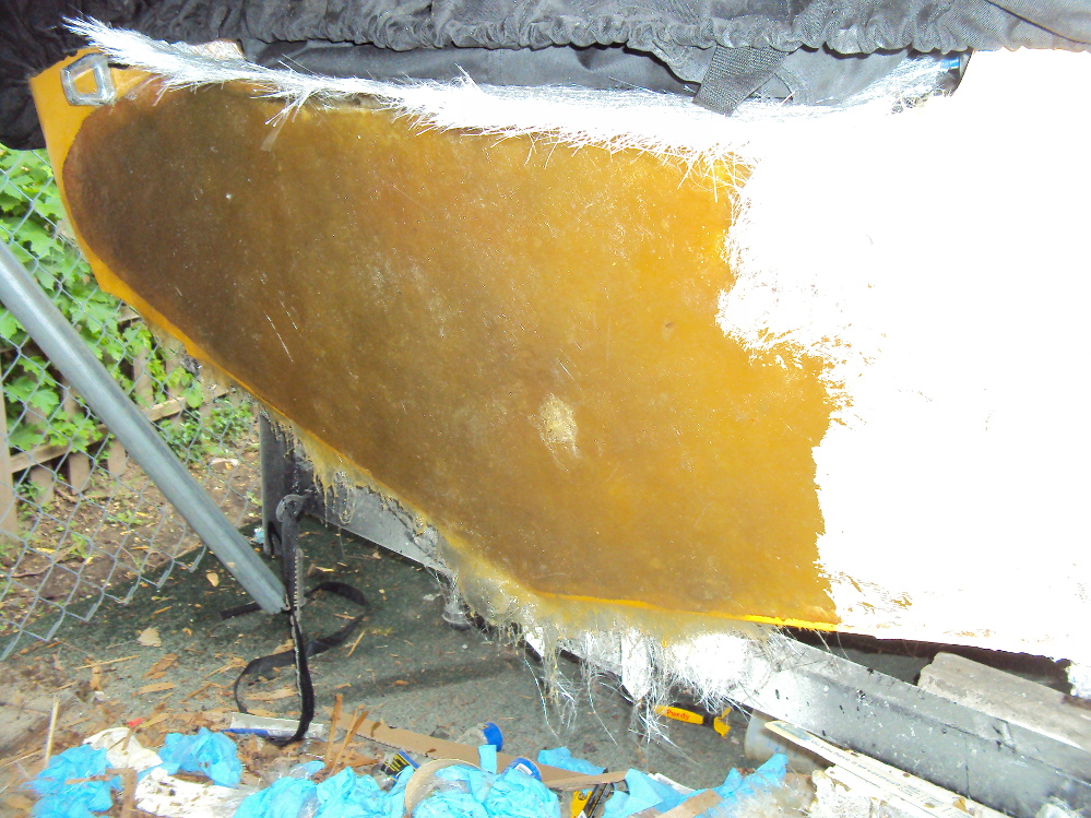

Here is first layer 1/2" Marine over two matts of fibeglass on the spillwell backside. First wood layer was "wet" applied to back of transom and spillwell fiberglass.
Profile grind of fiberglass cutout
Just look at that profile............nice !
Dry fitting of second "keyed" sectionlayer of transom fiberglass/wood sandwich.
No ferrous screws were harmed in any rebuild aspect of this project. They were all removed before closure. Only stainless screws were used.

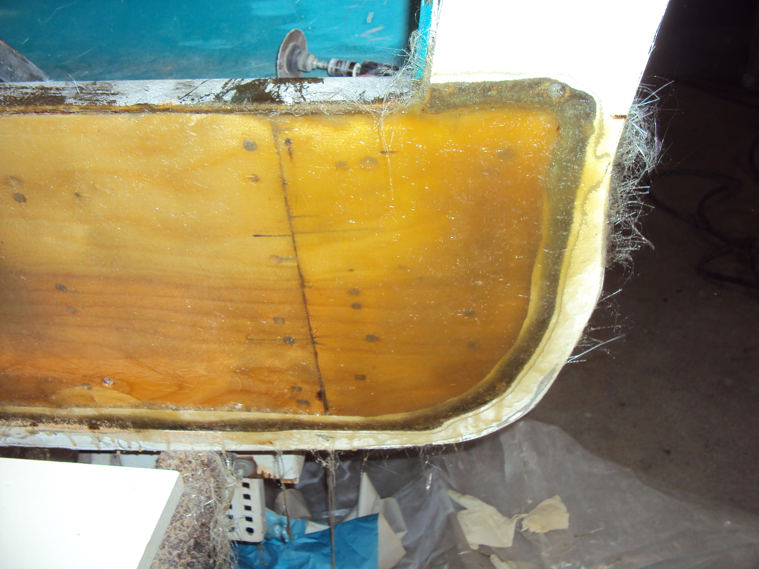

Grinded and ready for more mutiple burns and fiberglass installation.
Hand build of fiberglass matting installed in random small pieces to improve strength. (8) 8 sq. ft. matts were used in the transom rebuild.
WOW is that alot of work, to build that thickness of fiberglass. We hit this thing with a hammer and its like a rock !

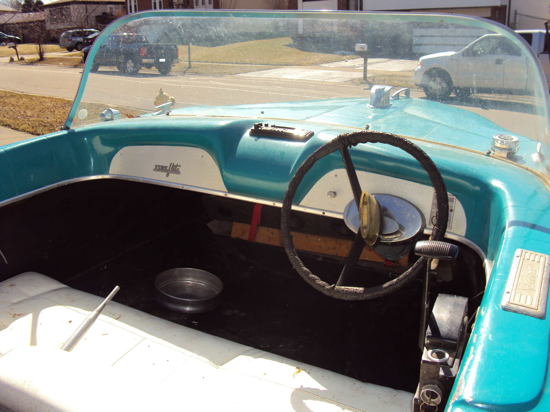

Re:1959 Glastron Fireflite total restoration 12 years 6 months ago #93494

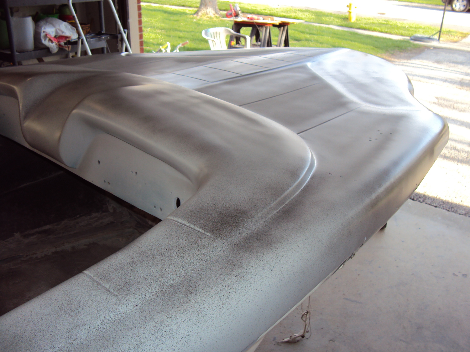

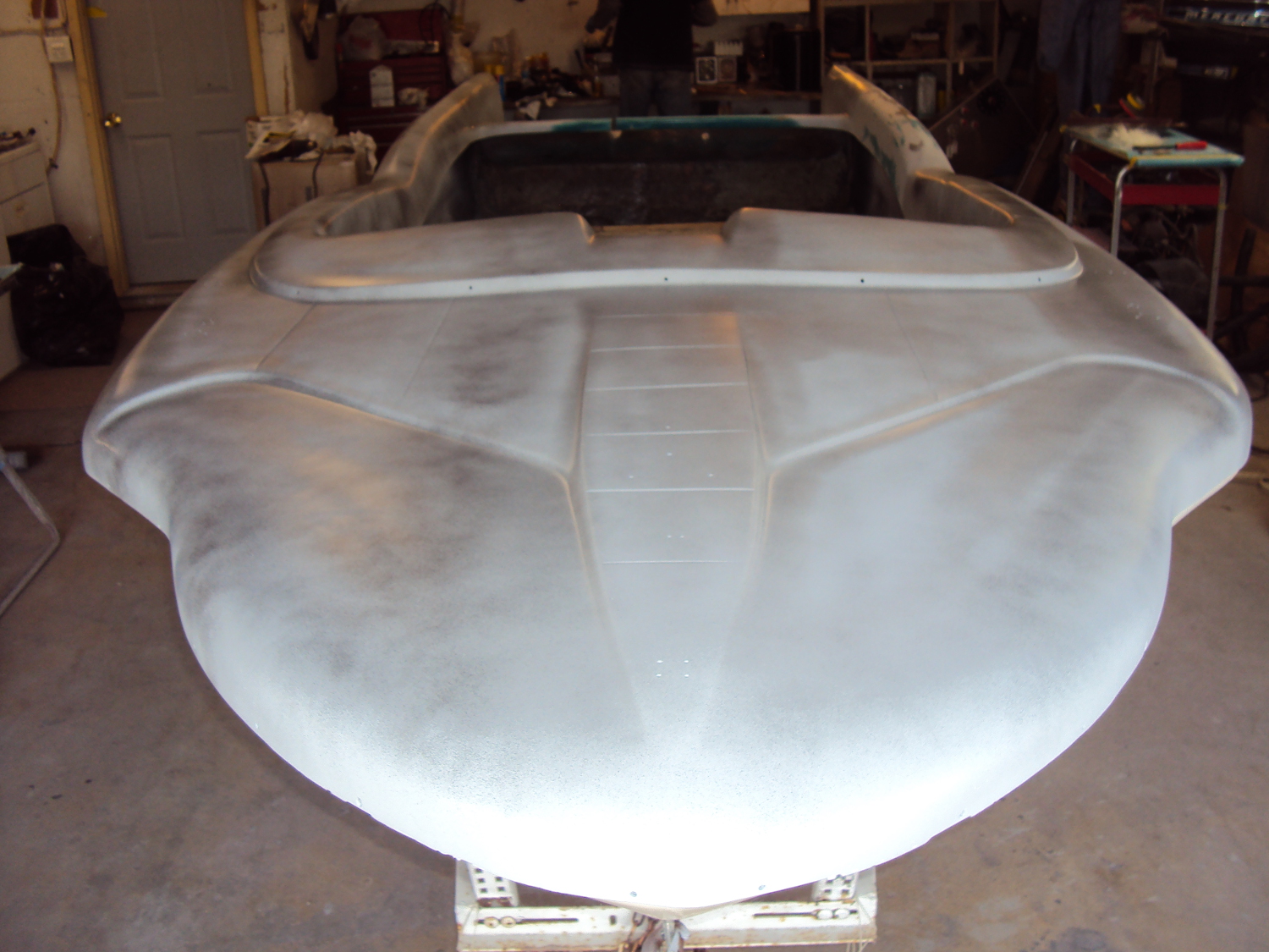

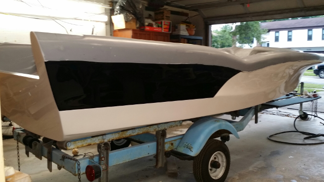

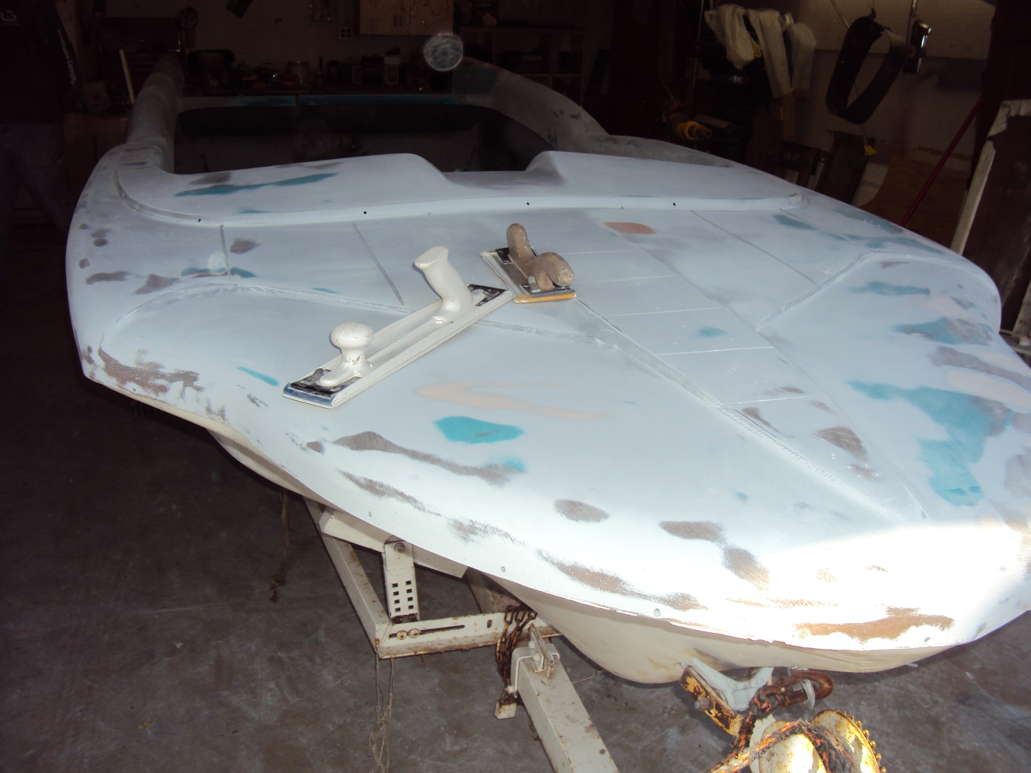

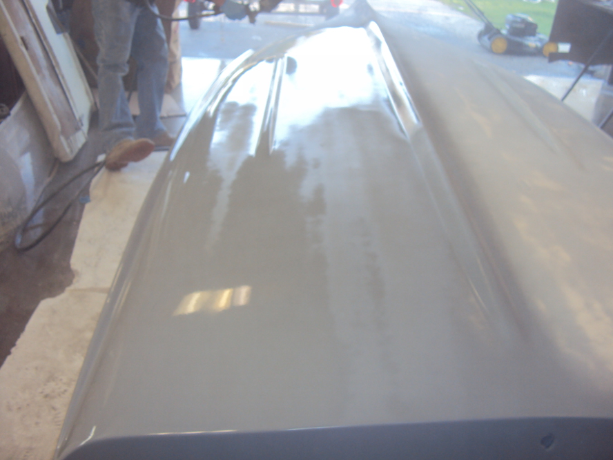

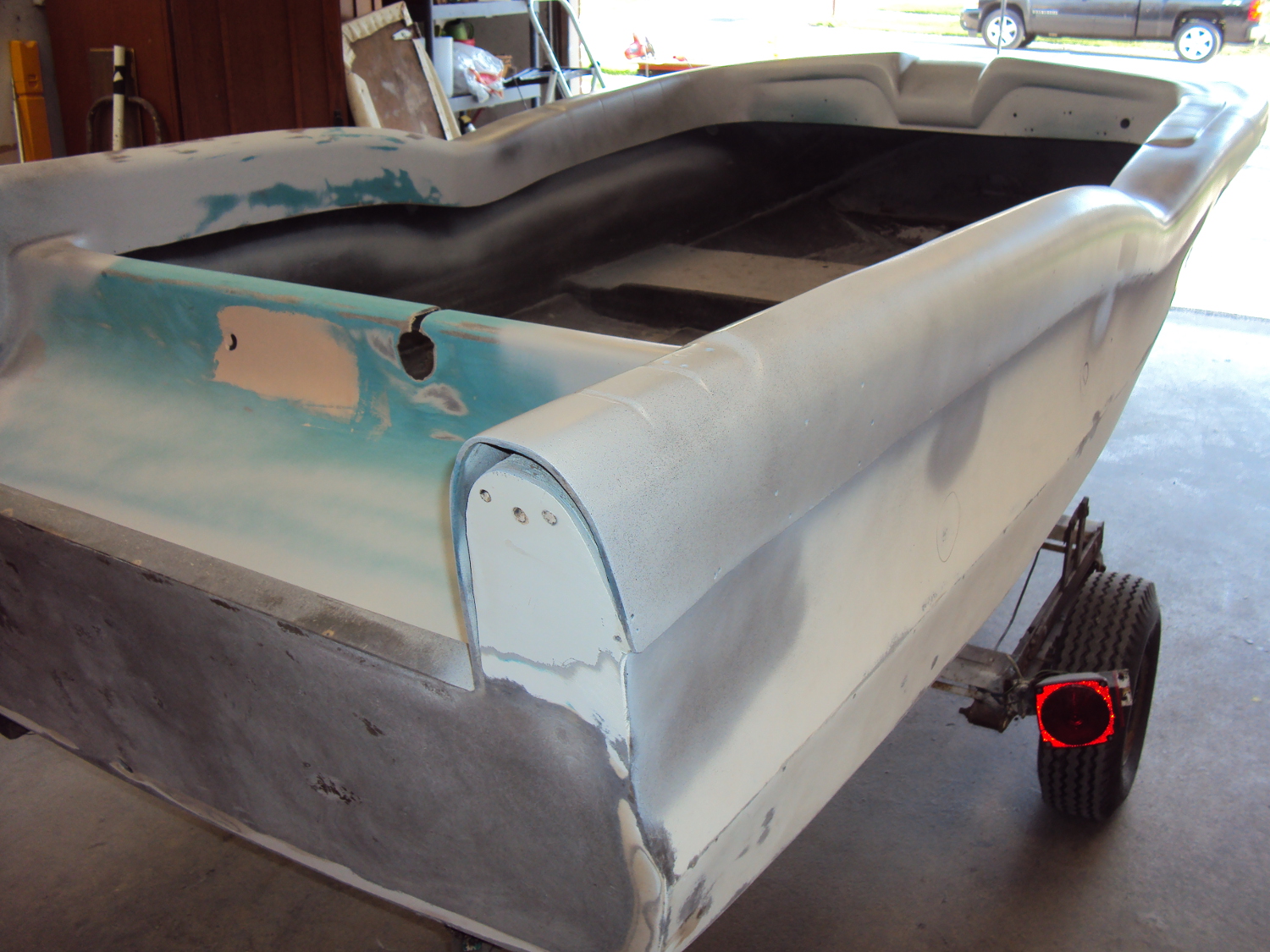

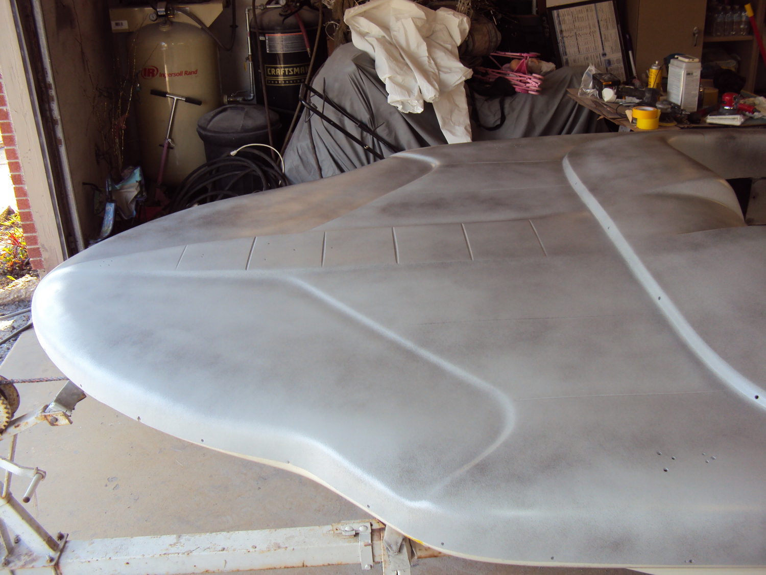

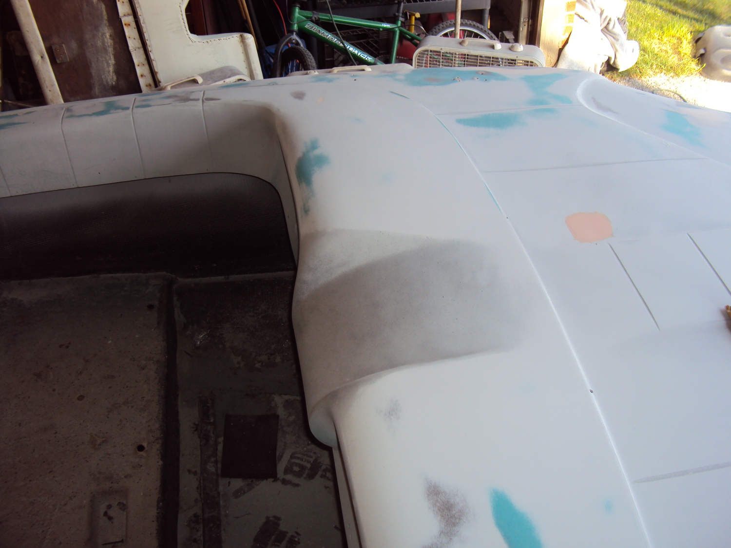

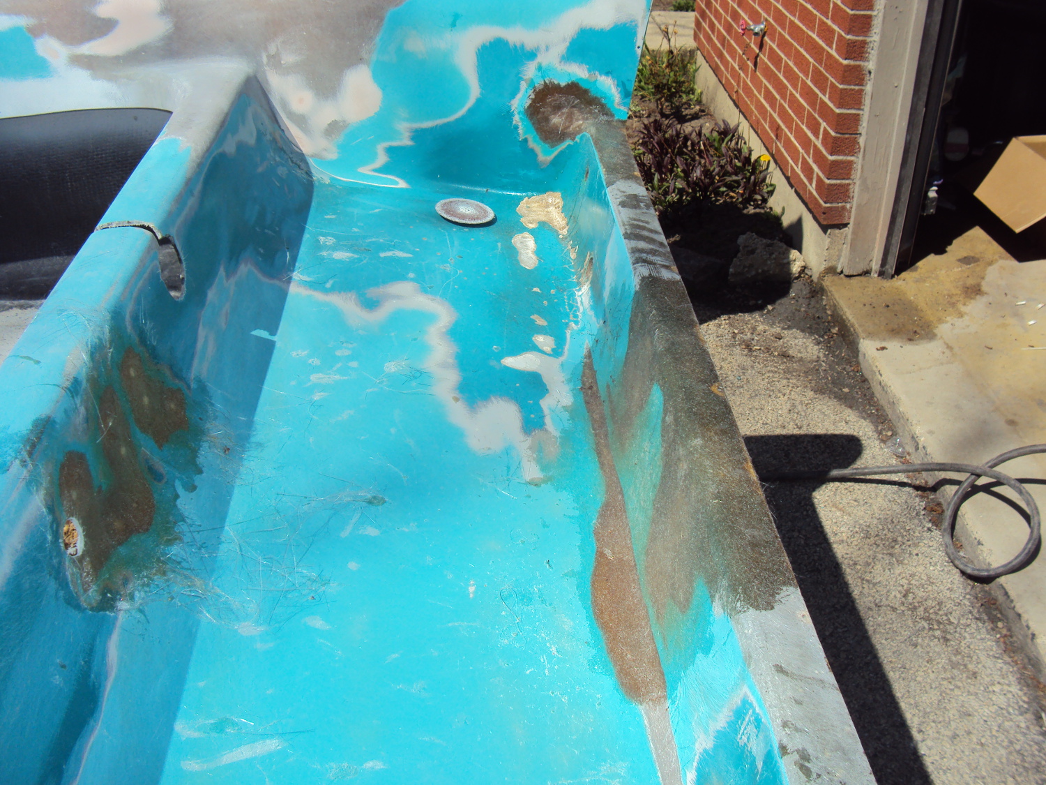

Some updated activity

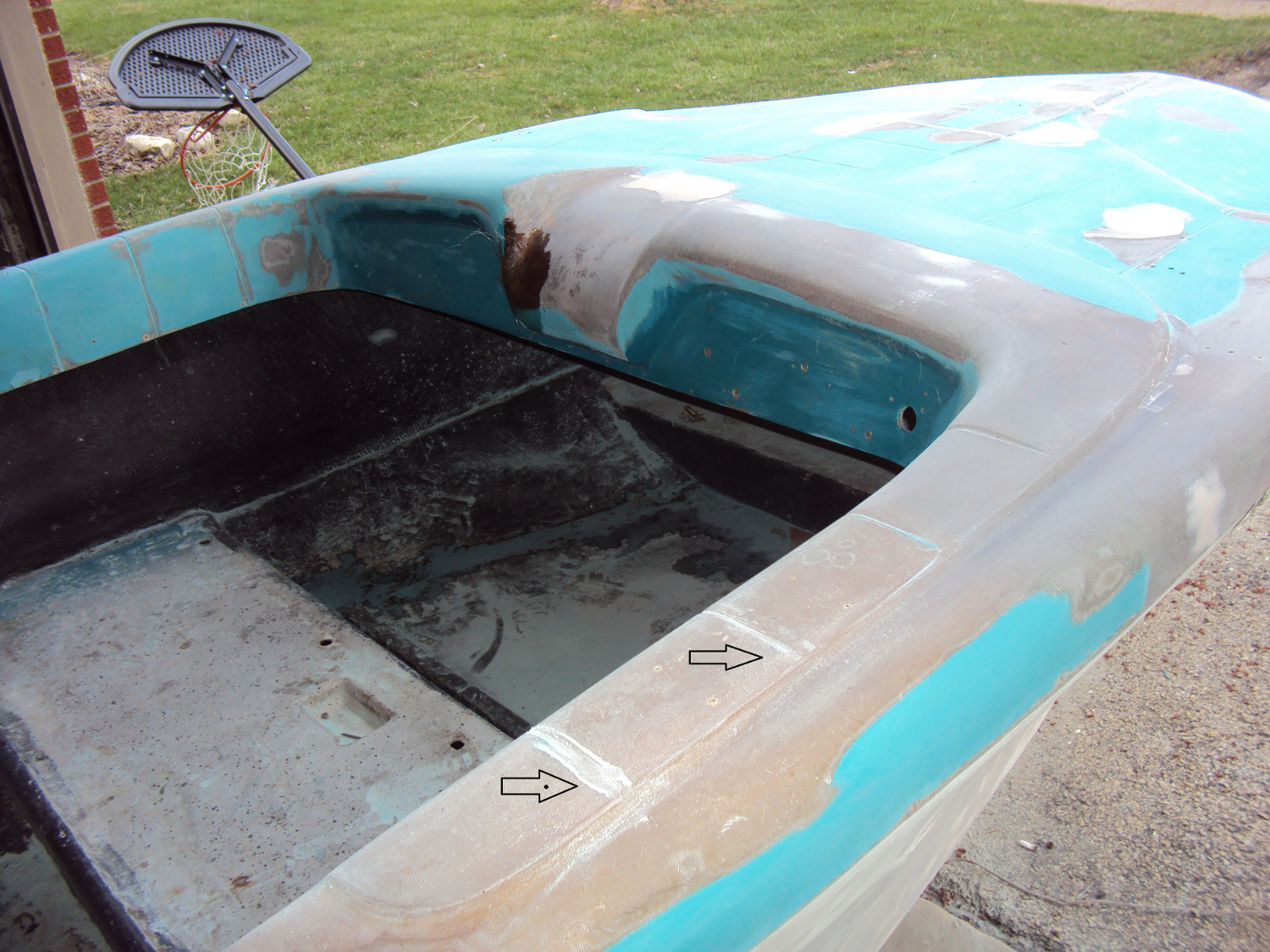

Some other fiberglass being installed [img] [img]http://www.fiberglassics.com/media/kunena/attachments/legacy/images/DSC06980.JPG
See the bodylines that are highlighted ? they were lost in the original paintjob 34 years ago. The body lines on this model are incredible as you will see later in the photos
Sand and then sand again and then sand some more !
I decided to close off my mistake of 34 years ago by cutting a hole in the dash for a monster cassette player -- radio all gone !

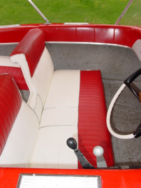

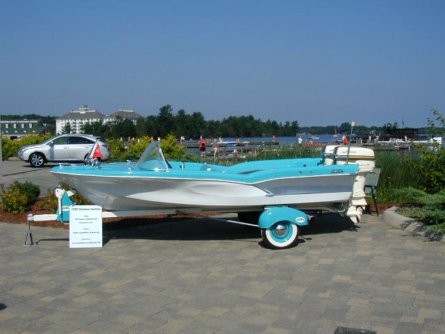

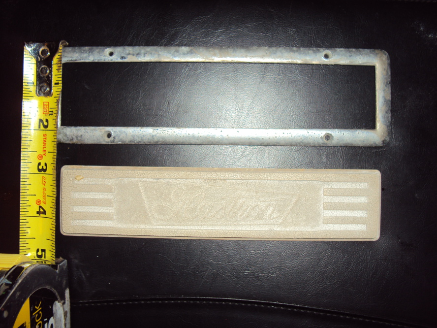

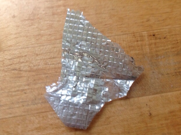

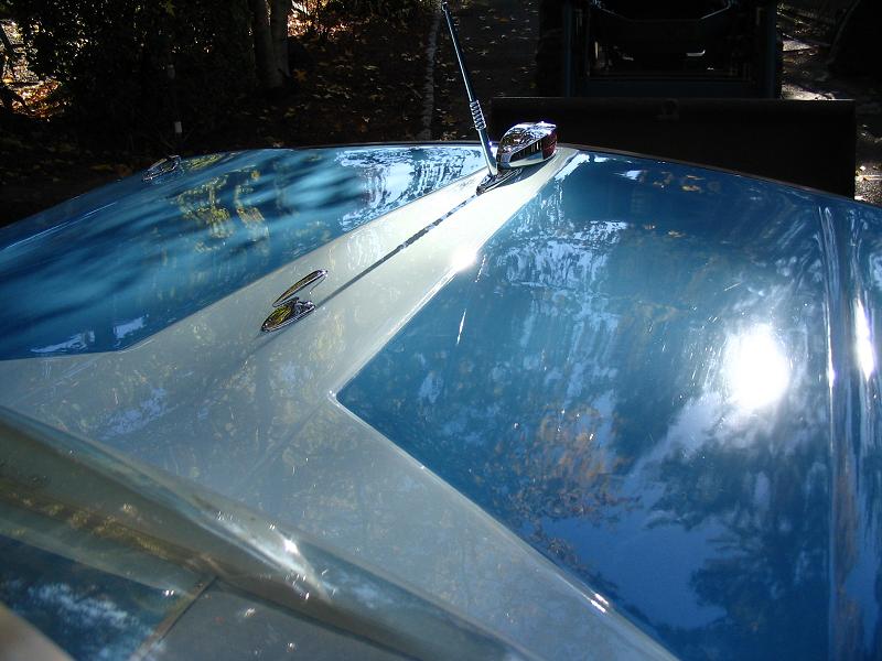

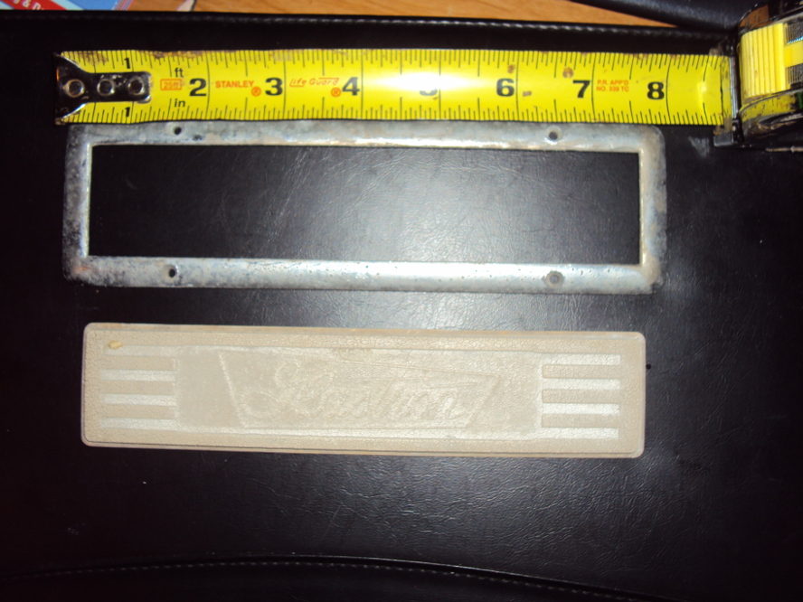

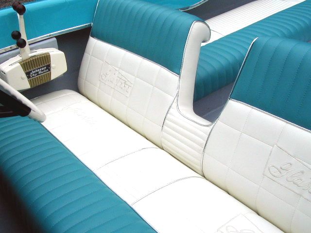

Are you going to replace the mylar that was in the hull cove? Here's a picture of a sample that was under a casting on mine. Note that it is not plain, but has 1/8" squares. I believe that this is available through hydroponic gardening supply stores. They use the mylar with the squares as a reflector since the square help eliminate hot spots.
Also, do you have the original seats with the Glastron signature?

I am not going to replace the mylar. I still have those molds of the stepplate inserts on my mind. Does anyone have a picture or the original seats with the Glastron insignia ? Would like to see the design.
I need to find a windshield. I had a "Taylor" jobbie on there but I want an original duplicate.

Re:1959 Glastron Fireflite total restoration 12 years 6 months ago #93530

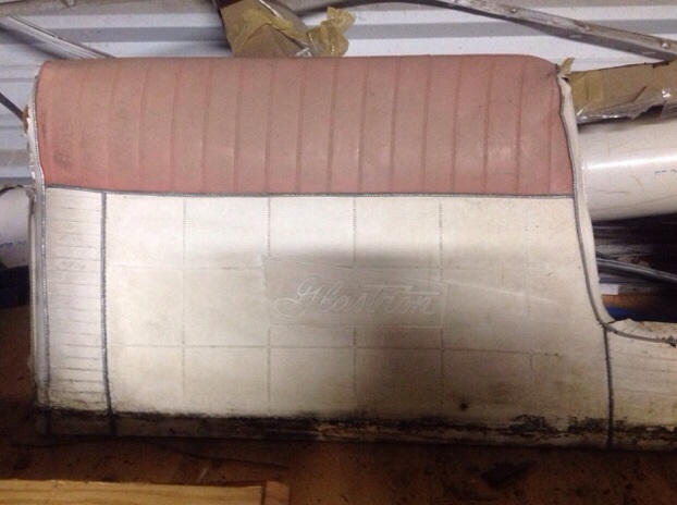

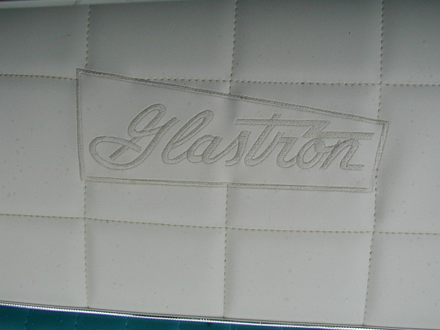

Do you mean this?
I have the back of the original front seat (that probably had been protected by the hardtop). The logo is cut into the naugahyde. If we can find someone to do it, I will take one side apart and send it as a sample. You would need 2 for the front seat and 2 for the back.
Also, someone posted some info on reproducing step pads in the Main Forum.
Todd
Todd (aka thetudor)
1964 Custom Craft Aqua Ray
1959 Glastron Seaflite
1959 Tomahawk Spirit
Re:1959 Glastron Fireflite total restoration 12 years 6 months ago #93546
Oh shit yes ! Looks like some other kind of pattern on the ends vertically.
Are those square pleats or cut lines ?
Nice example ! I know your boat is a 17' correct ? Mine is 15' but the simularities are many including the seat pattern. Anyway to illuminate the "Glastron" part and take a picture or a close picture with flash to see the insignia better.
If you get a chance can you take some more closeup pictures around the seat and post them.
TIA !

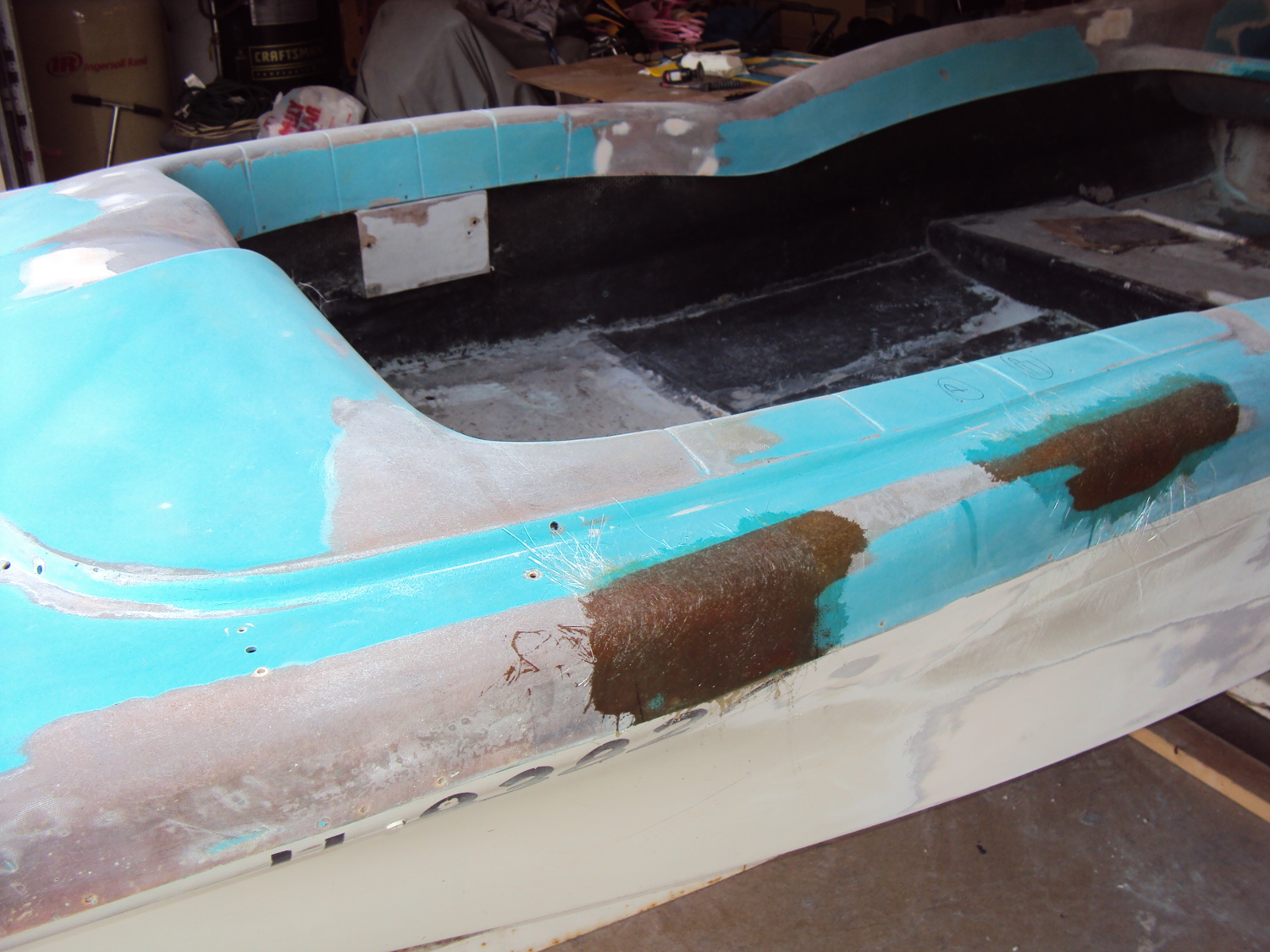

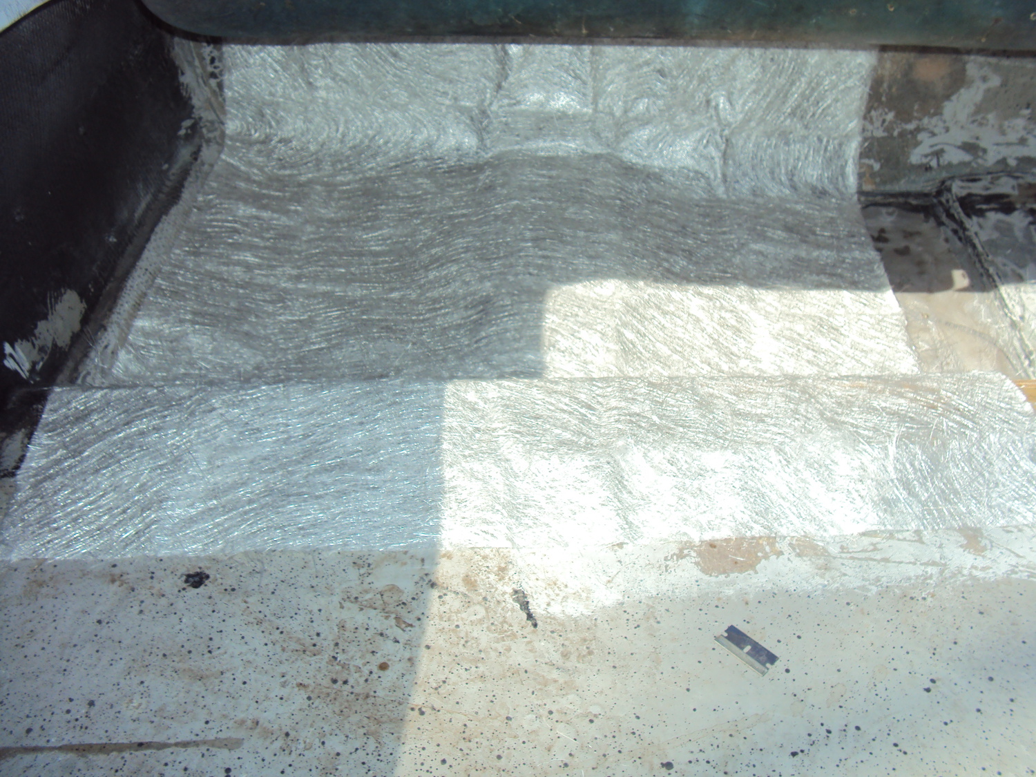

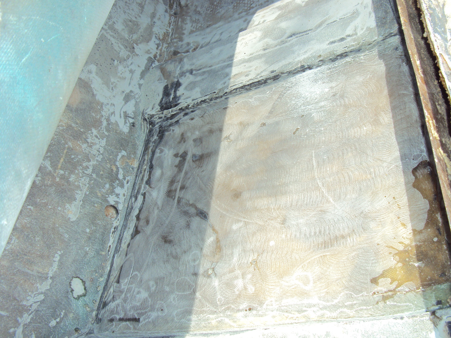

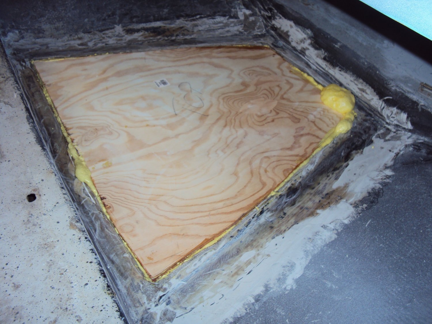

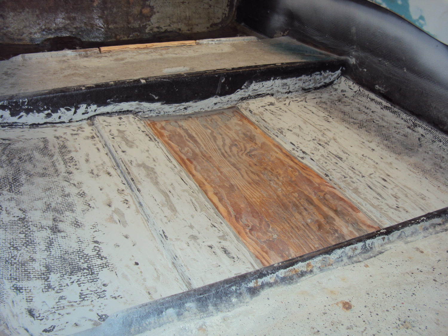

Re:1959 Glastron Fireflite total restoration 12 years 6 months ago #93585

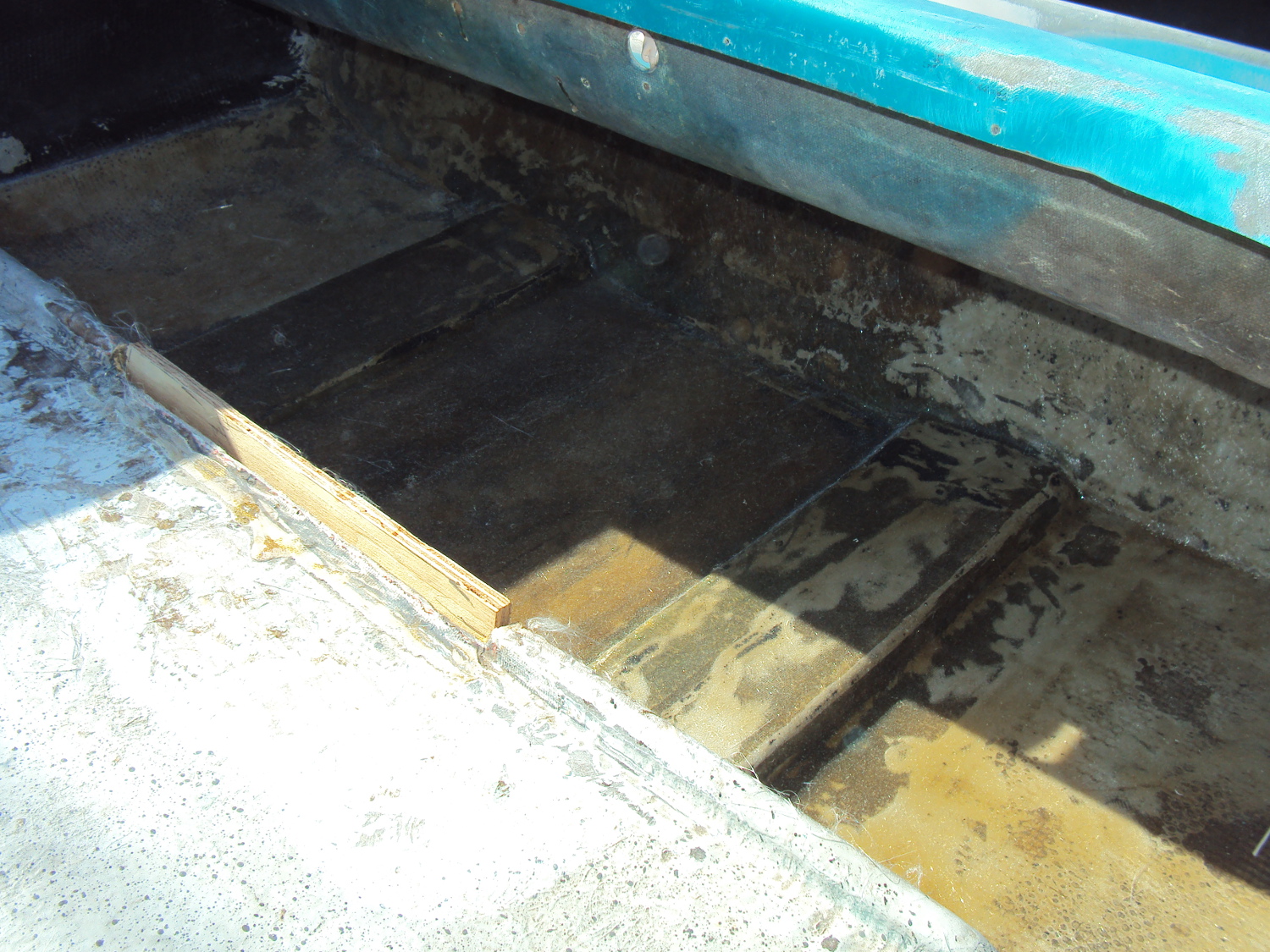

Some repairs to the interior of the boat. In the rear stow section I wanted another matt overlay of fiberglass on the floor and transom just to seal anything on the floor and the penetrations from the transom rebuild. I remember the back getting very greasy from the gas tanks over time. I am installing an aluminum fuel cell with a through hull filler neck in the spillwell. (will see this later in photos)
Grinded prep work done ready for acetone wipedown and matt overlay.
I dont know why someone (previous owner) cut the rear seat mount ? It was filled with foam previously and now will be filled back in with marine 1/2" and fiberglass. In the picture below the overlay has been applied to the transom and stow area.

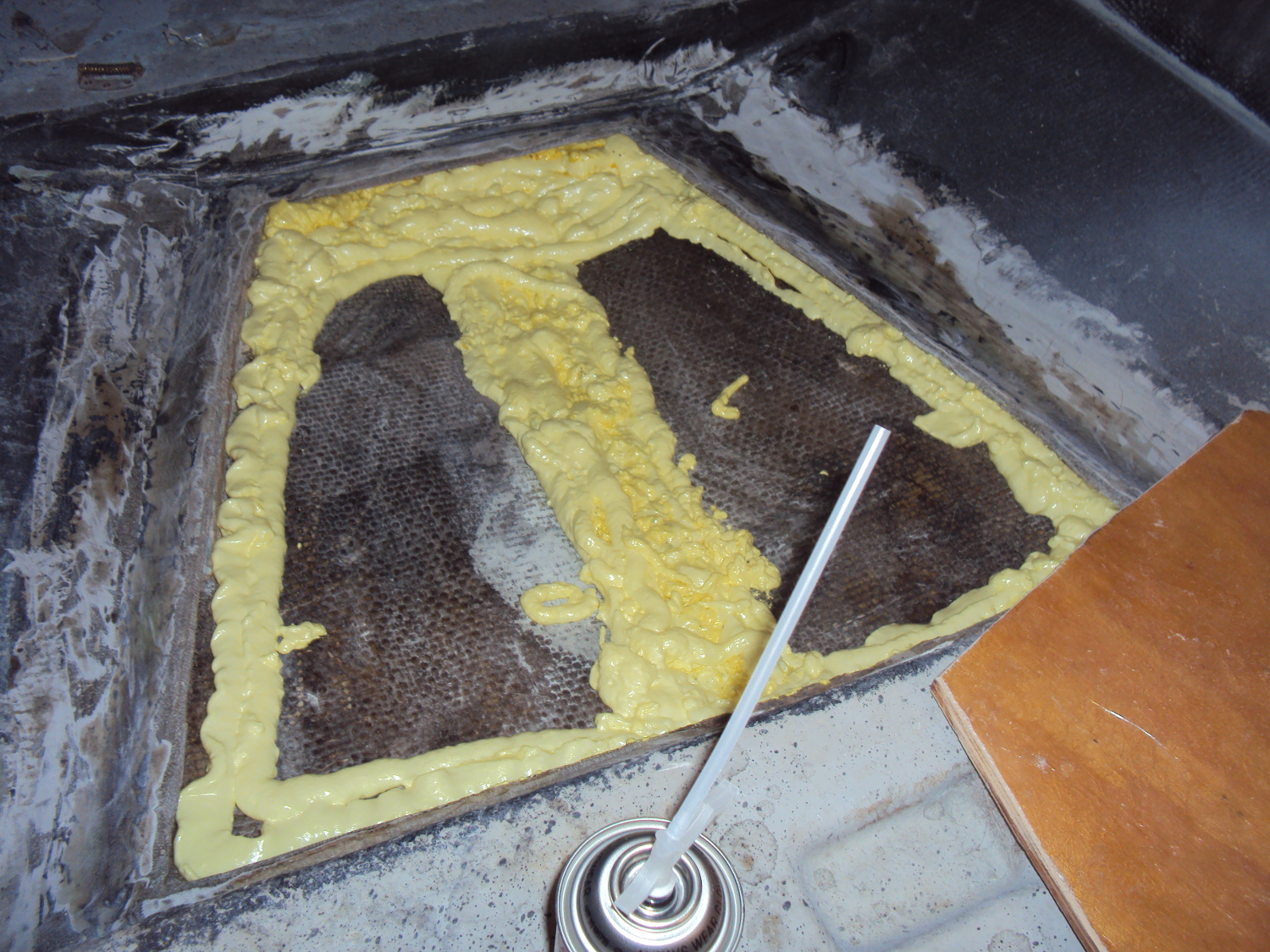

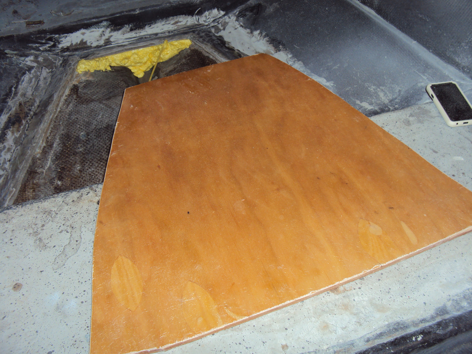

In this image the front floor plywood was replaced. The underside of the plywood was laminated with a fiberglass matt before installation.
This area was full of water when I peeled the old piece of plywood off. Filled it with foam and stripped it in.

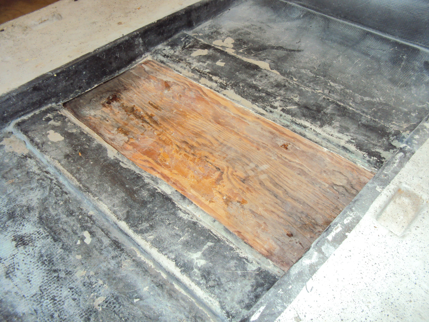

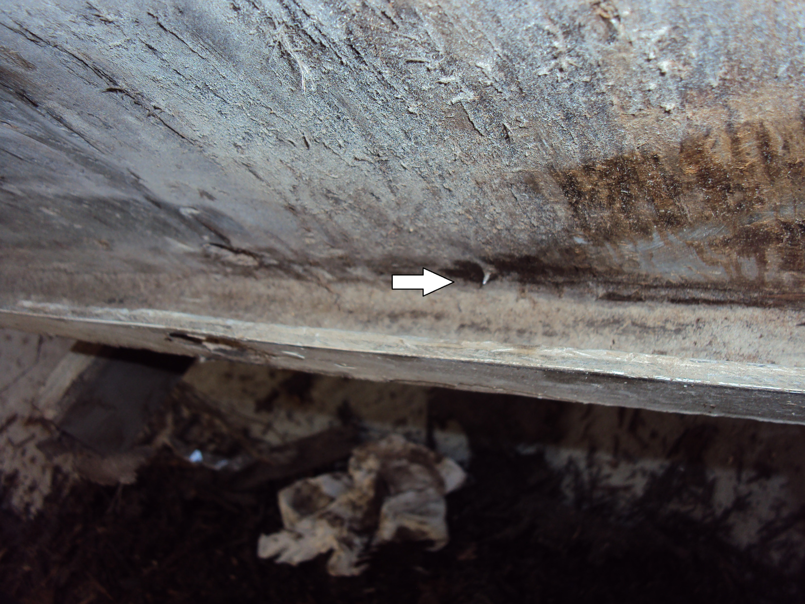

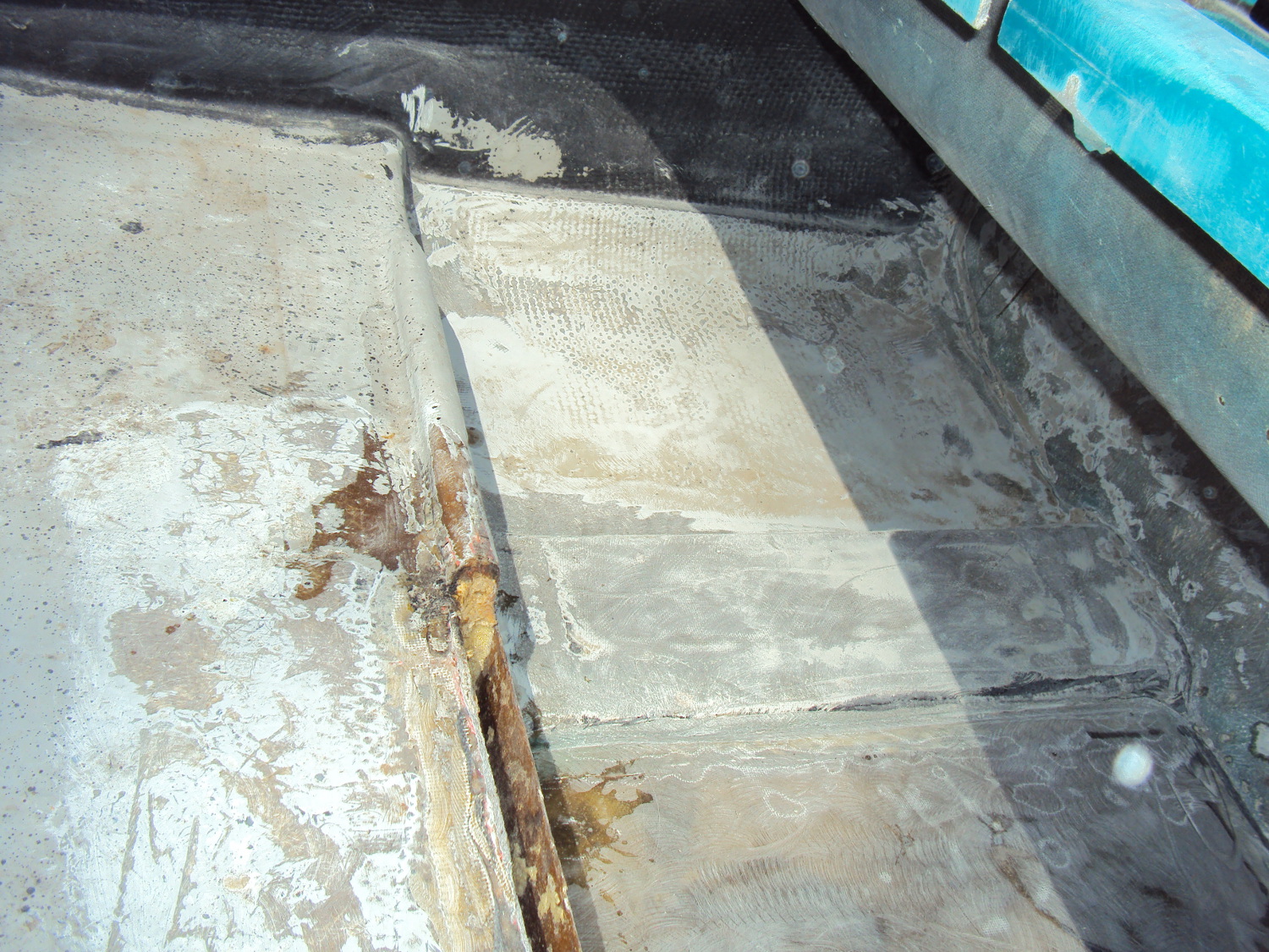

Re:1959 Glastron Fireflite total restoration 12 years 6 months ago #93617

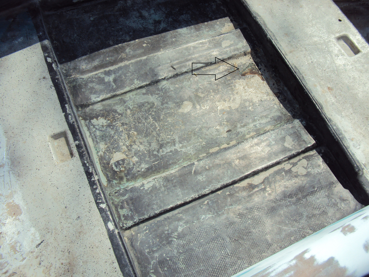

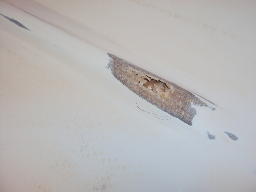

Check this out ; I spot a spot on the rear floor between the rear seat and front seat pictured below. I tell my guy and he says take it out until it wont come out anymore ! Mm'k
Here is the area on a larger scale.
See that tiny little spot ?
BAMM !
This is where it stopped ! :(
The wood turned out to be in excellent condition.
Decided to matt the whole floor in together with the repair.
All grinded with profile ready for acetone wipedown, striping in and matt finish. :laugh:

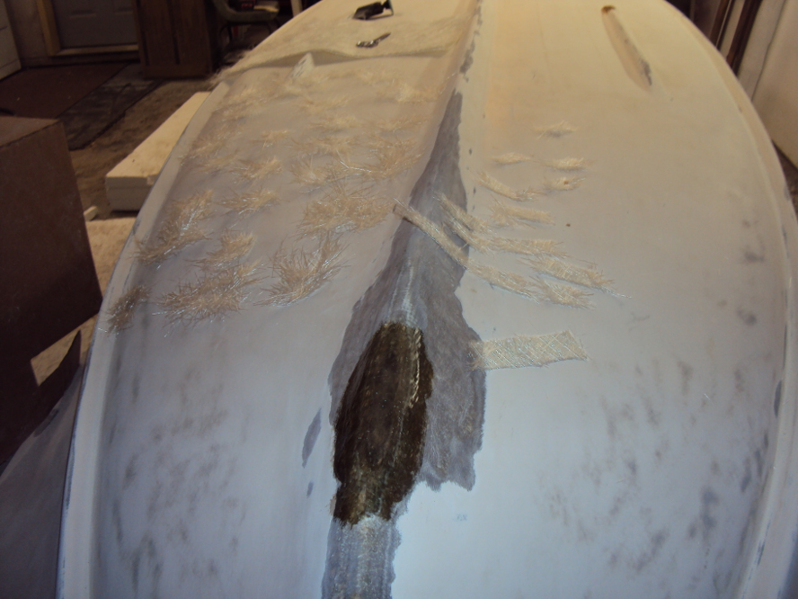

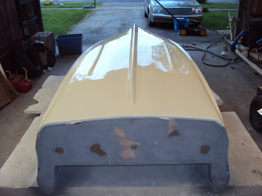

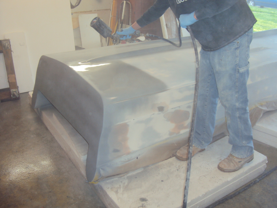

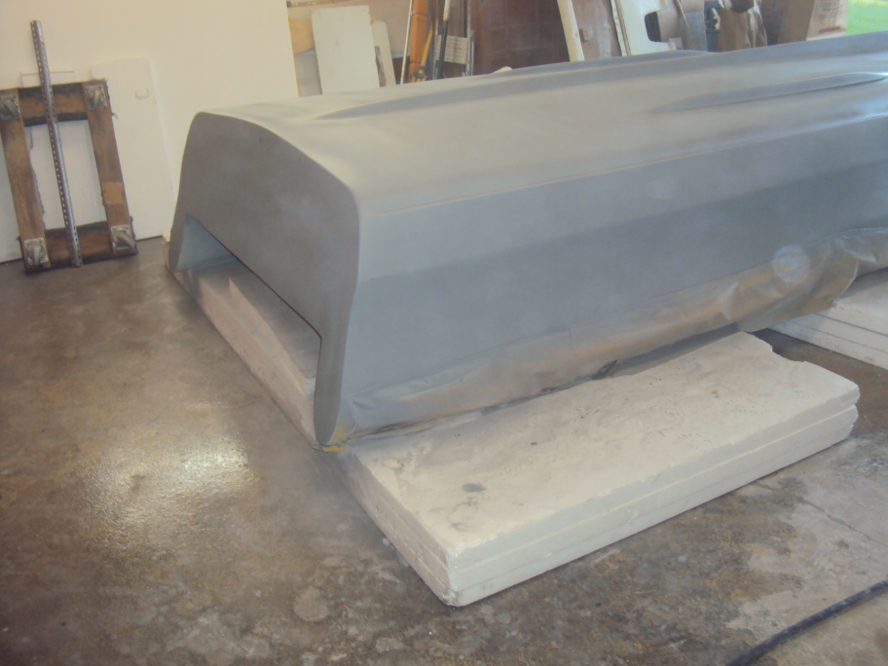

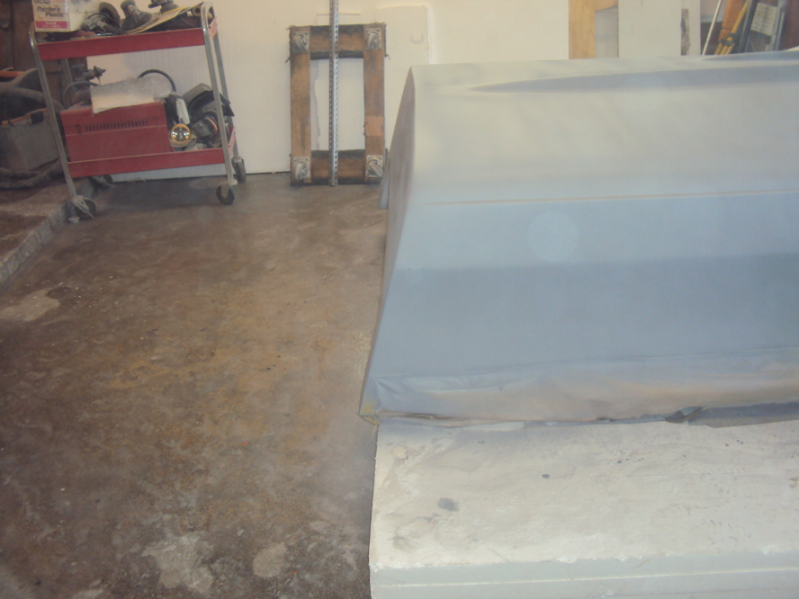

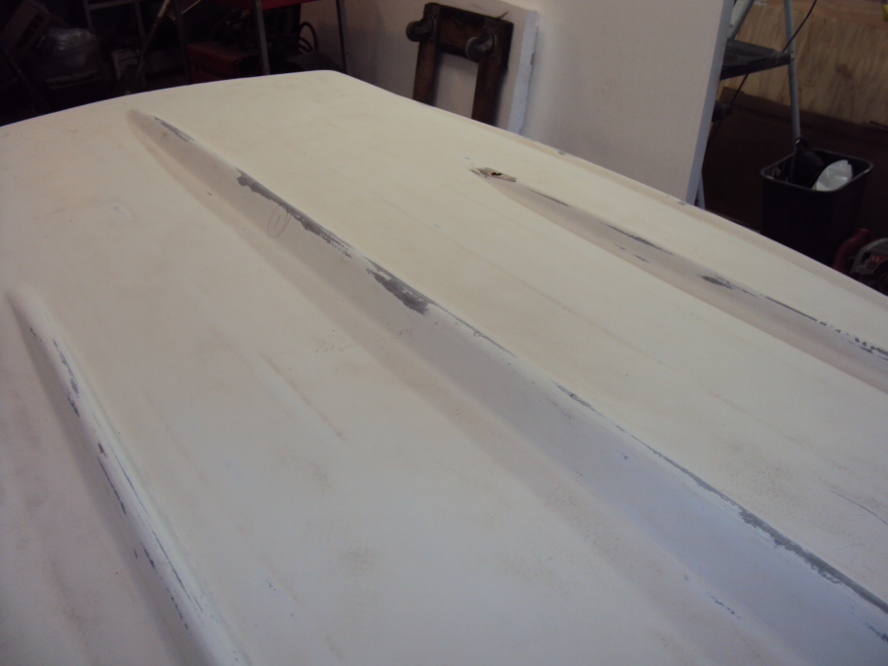

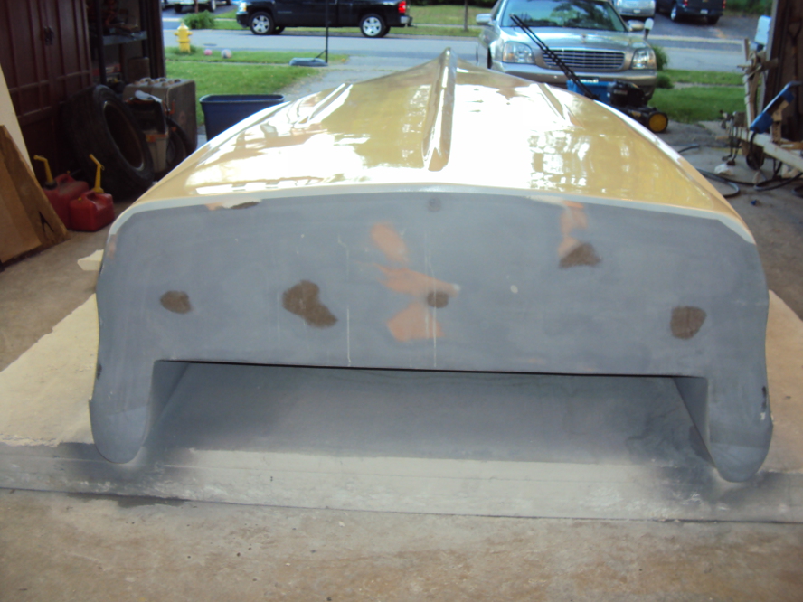

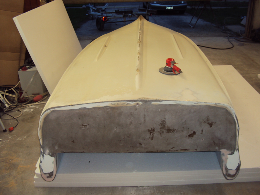

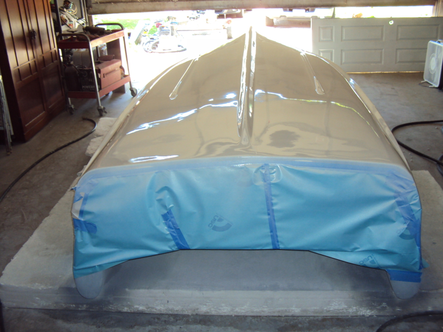

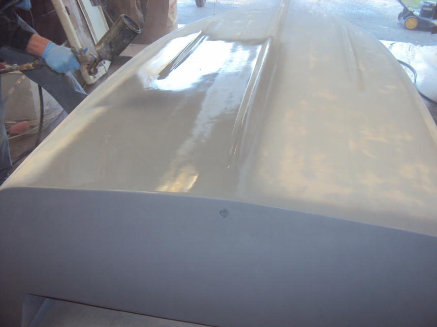

Here we flipped the boat over on some medium density foam that you can buy from Home Depot for $10 a sheet. The original boat specs say the boat weighs 375 Lbs. It was very light !
:laugh:

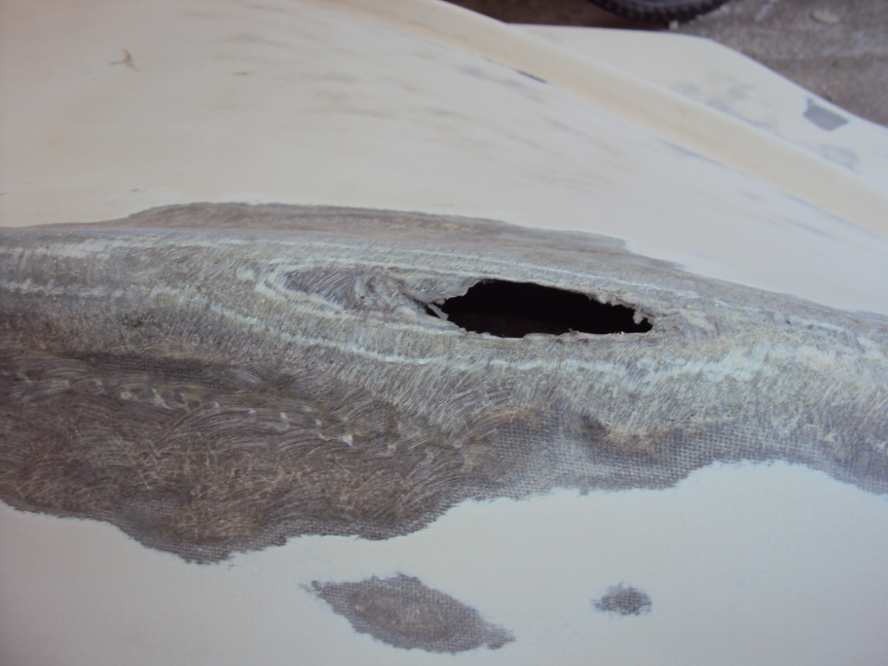

Sanded and "sounded" the bottom of the boat and found a couple of soft spots. This is where the boat was beached constantly going to "partay" when I was a kid.
Again using small "random" pieces for strength and build. Use larger pieces and its a weak and shitty repair ! "Thats what my guy says".
Other area of repair. Small weak spot. My guy is one picky SOB !@
I like that !
Shazaam !
Done !

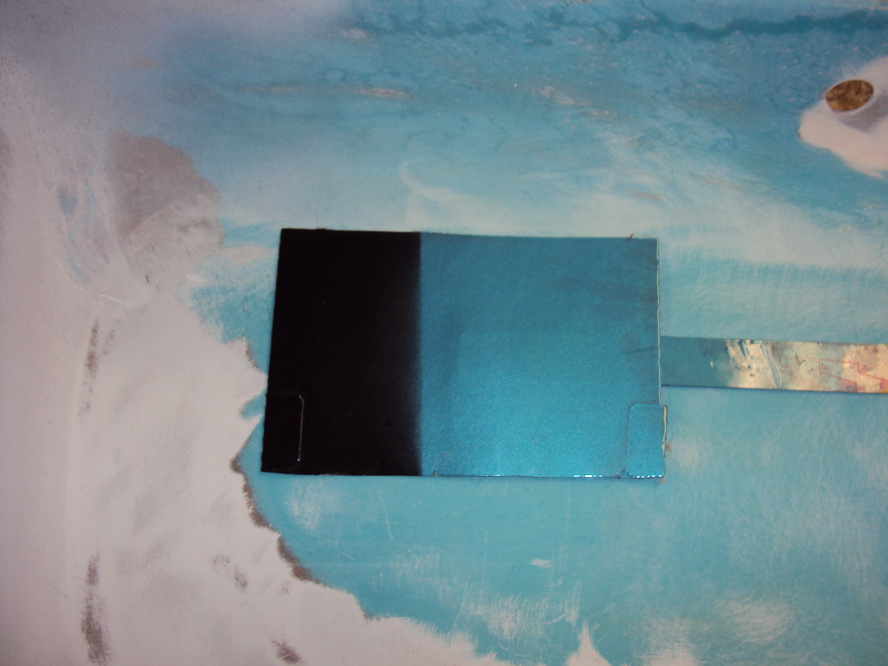

Re:1959 Glastron Fireflite total restoration 12 years 2 months ago #99087

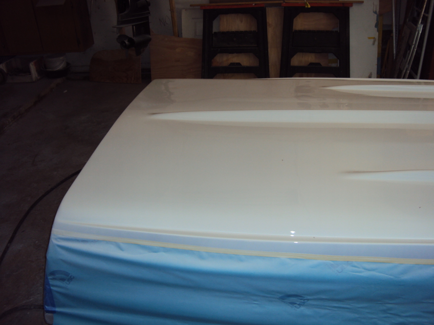

Paint was created from a color chip/exact match for a 1961 Pontiac Tempest that came out in mid 1960. Had a OEM paint specification and sample book from that era for all cars. Some of the colors in that book..... wild !
It's a pretty close match but the new paint has more metallic in it.
The original color to the boat in 1959 would be Tahitian Coral.
The original paint color you see is in the spill well area.

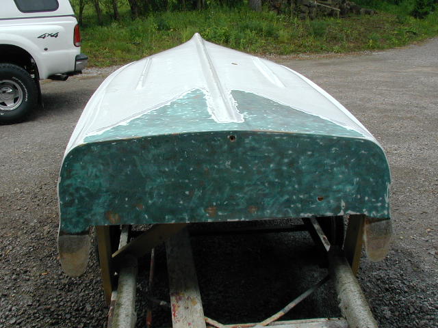

Re:1959 Glastron Fireflite total restoration 12 years 2 months ago #99191

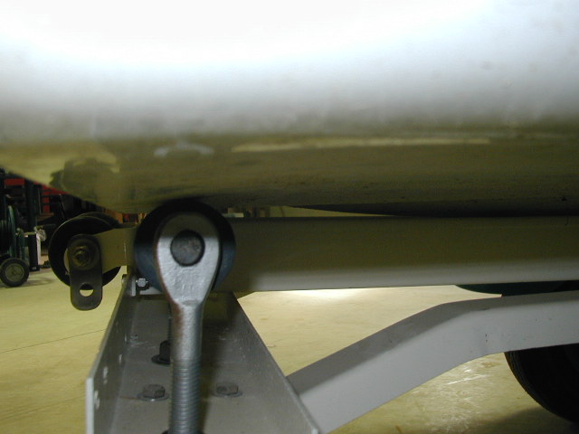

Looks like you're making great progress, however, I do have a concern. Have you put a straight edge on the bottom of the hull from the transom forward? It looks to me by the reflection in the pic " shazam, done" there is a hook in the hull. Mine had the same issue, caused I believe from the rear roller being too far ahead of the transom. I was able to remove much of it when I replaced the wood on the rear floor, the rest was filled from the bottom. Not trying to rain on your parade, but save you some disappointment when you get it wet
Cheers
Bill
Re:1959 Glastron Fireflite total restoration 12 years 2 months ago #99195

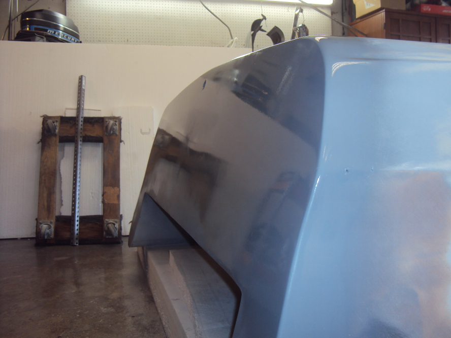

The Boat always sat on "bunks" not rollers. Is that the support that was at the back of your boat originally ? "rollers". Is that from the original trailer in 59' ? Mine never had the original trailer, but I am looking for a restored one.
Here you can see the bunks clearly extend 8 inches out and at least a foot and a half under the boat. My guy would have seen something like that in a Newyork minute. Also, I have been a finisher all my life and I would have seen something like that in a Chicago minute :laugh: He is not only restoring the boat, but teaching me as I help him, doing alot of the grunt and sanding work.
I like learning everything I can while I am still tickin'
Since learning how to do transoms from my guy,I practiced on the boat I was forced to take for free with the engine purchase for this project shown above (transom was shot). The yellow 72' Silverline. Completed 100% of it from start to finish with no help from anyone in three weekends. I will throw up a post of the project as it came out perfect.
I'll check, but here are some more photos of the process.

Have had a long winter. I will have some updates coming within a few weeks. Going to be casting some of the chrome pieces from a portable foundry I am building. I'm going to use the "lost wax" system to create the new emblems and chrome pieces. Get this, I am going to cast the pieces out of 100% pure Silver. I bought 20 ounces to cast my stuff. This way I don't have to send the stuff to a chromer. It will almost be polished when it comes out of the cast. Silver is the most reflective element on the planet. It wont pit, decay or deteriorate. Just polish it up once and a while. I also have done castings of the step pads, in different rubbers. I will get those to whom I promised, this year. A few contributors have requested a set. Anyone have any thoughts on my silver idea ?
I've always wanted to metals cast. We're gonna do it together.
May have to rethink my silver vs brass/chrome idea as i complete my foundry. Anyone have any insight to this idea >?
Should be an interesting year to finish this boat. Again I will not cut any corners, nor sacrifice any part of this boat to 'just get it finished'. all the bodywork is 99.9% complete. Just need to apply the color finish coats to the top of the boat. See you in a few weeks. ! :cheer:

Re: 1959 Glastron Fireflite total restoration 11 years 6 months ago #108940
Nice motor
If it aint broke dont fix it bkm marine services

Re:1959 Glastron Fireflite total restoration 11 years 6 months ago #108959
i have a pic, somewhere of a 59 larson in tahitian coral. it belonged to a member who has disappeared like so many. his name was ken faulkner, from minneesota i think. a beautiful color. he sent me a color chip. when i was trying to decide what color to paint the mantaray. i had 2 gallons of it made up at a local paint shop, but decided on the 2 tone bikini blue. i gave the paint to mt. dora gary...gary simpson. ron
Re:1959 Glastron Fireflite total restoration 11 years 5 months ago #109865

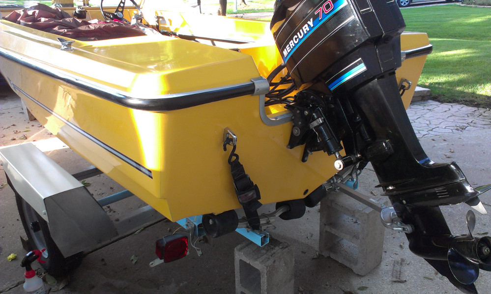

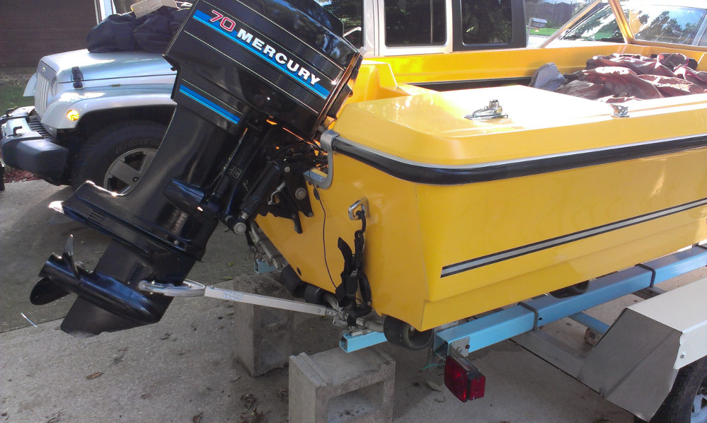

I referenced earlier up in this thread, that I had completed a transom on a boat (72' Silverline) that I acquired for free (I had to take the boat, too get the motor for the 59') Here are some pictures of the rebuild.
I was shown once, how to do a transom rebuild and this one I completed without any help.
I have completed the boat and have an engine on it. I will follow within the next few weeks, pictures of it completed and ready for the water.

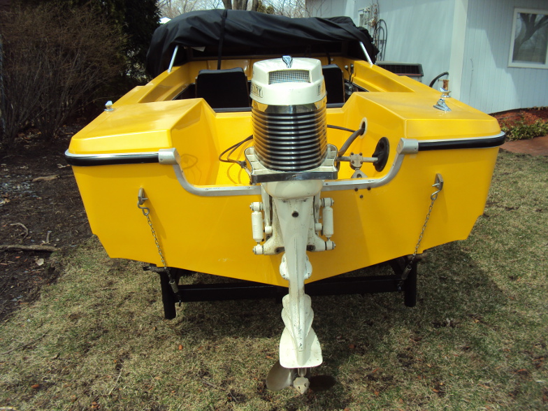

Here's the rebuilt transom with a 70HP powertilt Merc. :laugh:
