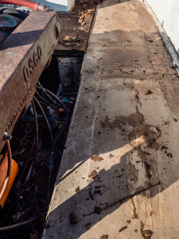

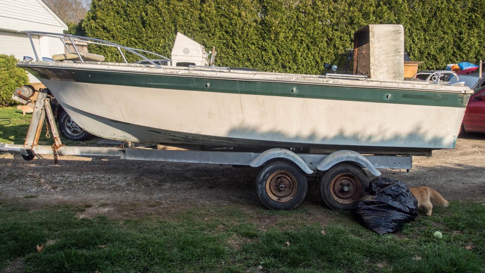

Hello all! My father picked this up sunday from CT. It's a 1967 Buehler Turbocraft Nimrod with a chrysler 318. It's pretty complete as far as engine,steering and drive components go.
The downside is it has a squishy deck, manifolds and timing cover water crossover are all cracked bad, engine turns over as does the drive. We think the engine wasnt winterized at all which cracked most of the cast iron parts

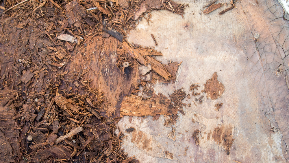

It had carpet over generic plywood screwed through the top layer of glass, so you can imagine what that did as it got waterlogged over the years!Water seeped through the screws and swelled up the deck, it has a bulbous shape now.
Spent a few hours removing the rotted top layer of carpet and plywood to get to the glass, next step is cutting it open to get to the stringers. Here are some photos
What it looked like before we ripped out the top layer of carpet
Where its at now

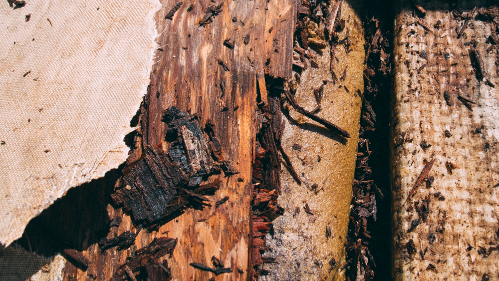

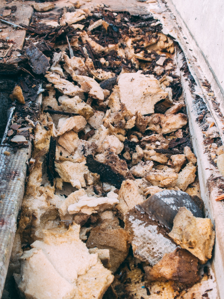

Saturday we worked all day on her, pulled off the manifolds, ground down the marinetex on the block to decode the serial, and its not the original engine but a late 70's 318. Nothing special, so we wont feel ashamed to update the engine with one from a 86 fifth avenue.
We tore open the deck finally and what we found wasnt a surprise. The foam was holding massive amounts of water, so we will be removing ALL the foam from between the stringers, we will also be removing the inner sides as well in order to reach the outer stringers. Do it once do it right!
