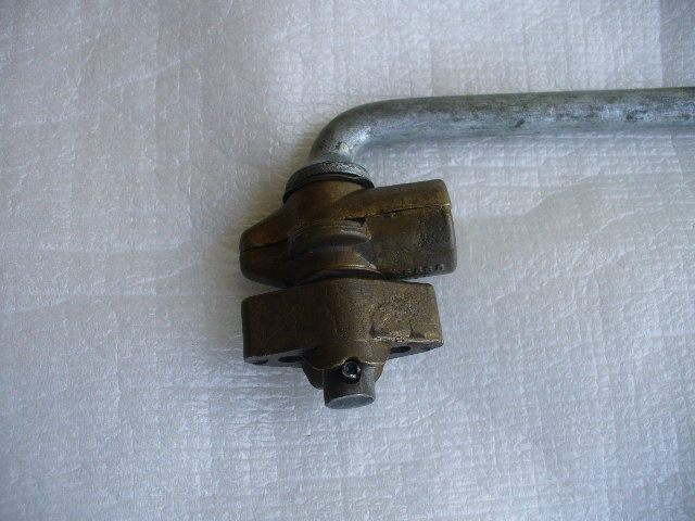

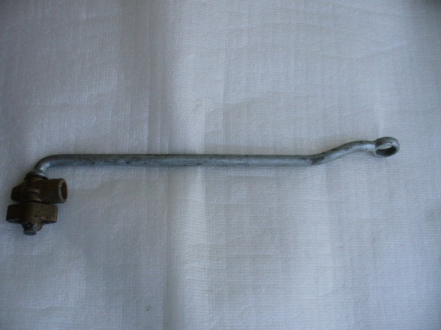

The biggest problem I always have had is the steering cable/rod end. I can't find any picture of what this remotely looked like. This time though, I'm armed with a 3D printer and 3D designing skills, and plan on prototyping something of my own to make it work. My printer only prints plastic, and I'm just testing fit and function on land with the parts. I will be sending the files off to have it printed in stainless steel, which has 40% bronze infuzed in it.

Hi Nate,
Here is a link arm with the correct adaptor to connect your steering.
Thanks,
Joe

Re:1960 Dorsett Sport Lexington w/ Merc700 12 years 7 months ago #92192
Hey Joe,
Thanks for the pictures! I guess I have seen those pieces seperately online but never could see that they would sandwhich the rod end I have. My motor connecting rod is a little different and has a threaded end instead of a roll pin hole. There must be a reason they abandoned this design. It sure seems like a lot of important parts held together by one roll pin.
I'm going to continue on my own design that will be printed in stainless steel. I think it will be stronger and safer in the long run. I just have som tweaking on some dimensions to do after I get the steering wheel centered. Then I'll be sending it off to be printed.

Re:1960 Dorsett Sport Lexington w/ Merc700 12 years 7 months ago #92220
Hi Nate,
The change to threading the end and adding a lock nut is due to the cost savings. The bronze coupler nut and the labor to press-in the roll pin at the factory are more costly than threading and including a nut in the carton. It was once deemed important to allow for relatively quick installation and removal of outboards from the boat (the coupler nut does not require a specific sized wrench or socket, and requires but a quarter turn to disconnect) to allow the outboard to be stored indoors separate from the boat. The factory design also places the end of the link arm immediately adjacent to the end of the steering cable (you have a small amount of spacing), which minimizes the bending forces applied to the end of the steering cable (as opposed to greater spacing).
Regards,
Joe
